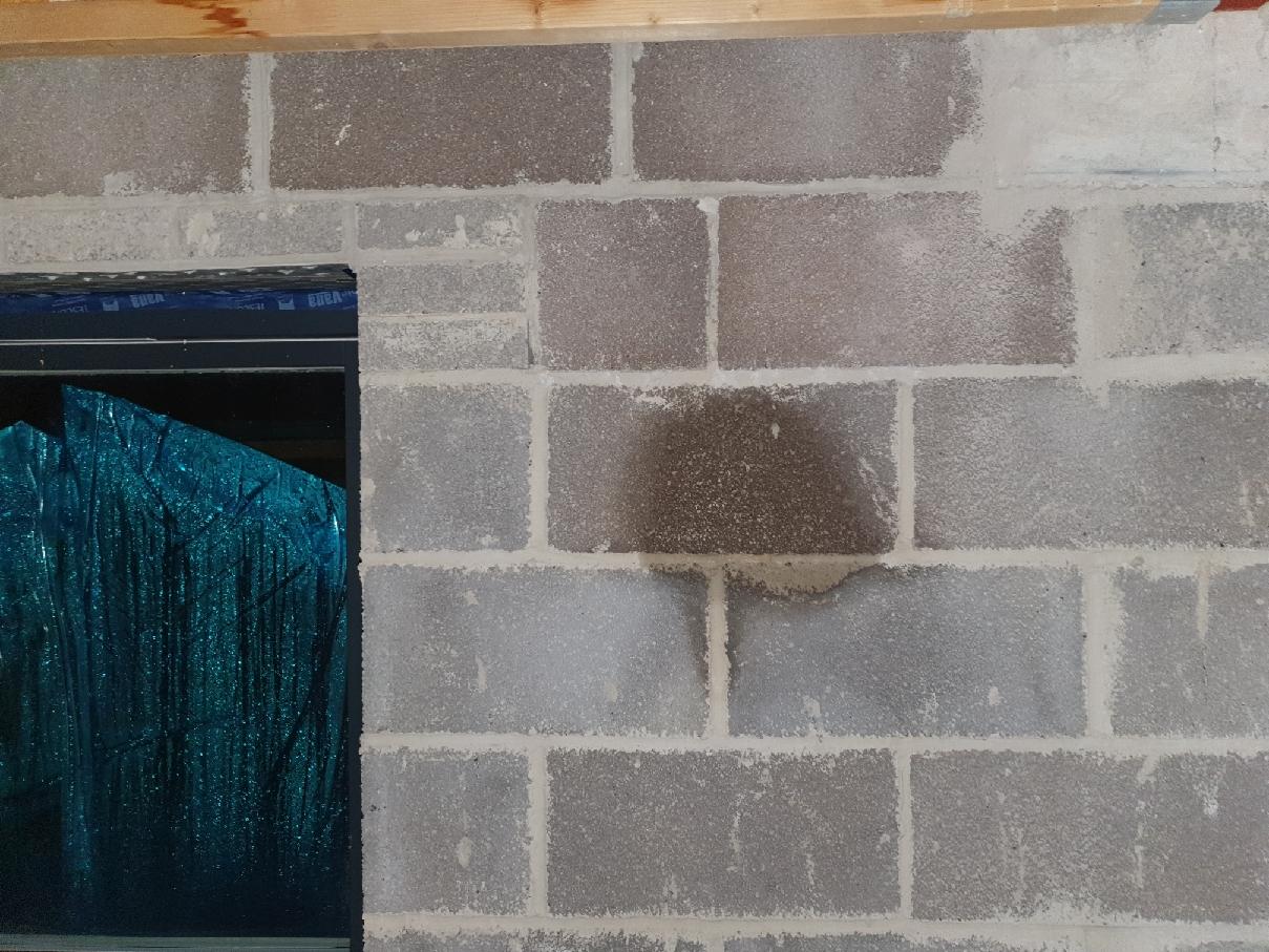

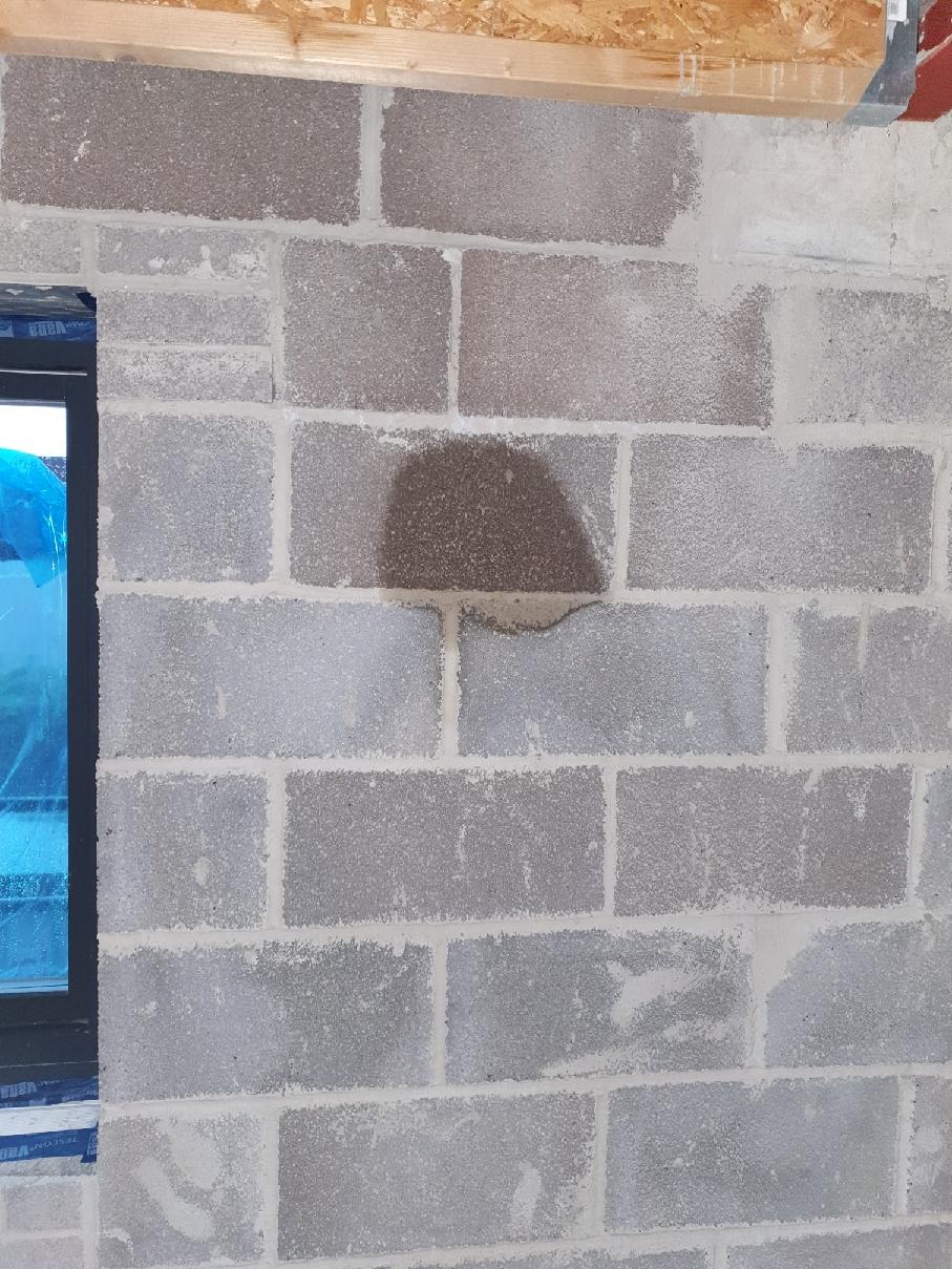

Moonshine Posted October 17, 2022 Share Posted October 17, 2022 (edited) My build is water tight and its great to have it dry inside, however it is not rendered. There is a location where a scupper drain is dripping (no hopper fitted yet)with very heavy rain causing the outside block work to get soaking, and on a couple of occasions a wet spot has appeared on the internal leaf of the block on the cavity wall (150mm fully filled cavity) This issue will highly likely go away when its rendered and the hopper is fitted but i want to make sure that whatever is causing this sorted just in case its a weakness somewhere. My best guess is it is a wall tie that either has a large build up of mortar on it, or is angled with the drop into the inner leaf. my thoughts are to put a core drill through the inner leaf to investigate, knock off the snot. Question is, is this likely to be the issue, and if so where to core drill, is the tie likely at the base of the wet patch? Edited October 17, 2022 by Moonshine Link to comment Share on other sites More sharing options...

Russell griffiths Posted October 17, 2022 Share Posted October 17, 2022 Have a look on outside, I bet there’s a snot catching water on a bed joint, knock that off first. Link to comment Share on other sites More sharing options...
Mr Punter Posted October 17, 2022 Share Posted October 17, 2022 I think the tie may be at the bottom of the damp patch. You could run a grinder along the joint bed and see if you can locate the wall tie. It could be quicker to take the block out rather than core drill. Fingers crossed the beads are well bonded! Once it is rendered it will be dry. Link to comment Share on other sites More sharing options...
saveasteading Posted October 17, 2022 Share Posted October 17, 2022 11 minutes ago, Russell griffiths said: Have a look on outside Also while it is raining. An issue in the cavity is indeed likely to be bringing the water inside, but if the source is cured then that should be the end of it. Otherwise....cut out the inner block, sort, and build back. Link to comment Share on other sites More sharing options...
Moonshine Posted October 17, 2022 Author Share Posted October 17, 2022 1 hour ago, Mr Punter said: I think the tie may be at the bottom of the damp patch. You could run a grinder along the joint bed and see if you can locate the wall tie. It could be quicker to take the block out rather than core drill. Fingers crossed the beads are well bonded! Once it is rendered it will be dry. I think that you are right that the tie is likely to be at the bottom of the wet patch, and that is a good idea to use a grinder to find it. Link to comment Share on other sites More sharing options...
