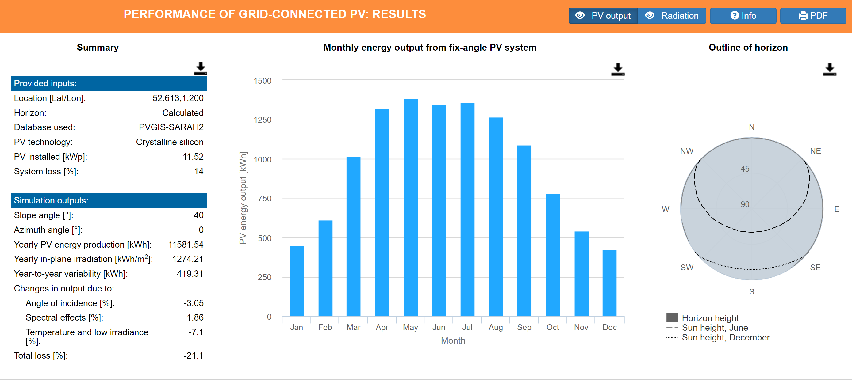

Radian Posted November 12, 2022 Share Posted November 12, 2022 1 hour ago, patp said: 212.6 kwh from 10th October to 4th November and 94.2 kwh from 4th November to 10th November So average of 8.5kWh/day in October, 15kWh/day in Novemeber. Something's almost doubling your consumption this month - any idea what it might be? 46 panels on 3-phase sounds like 11.5kW peak coming from older 250W modules unless the inverter is throttled. Should still be generating enough to null some of your consumption. My little 3.2kWp array generated 8kWh today, down here on the South coast where it's been sunny all day. On an intermittently cloudy day like yesterday it only managed half that. That meant 12kWh imported from the grid plus 4kWh self generated = 16kWh = typical day for the three of us in a 4-bed detached property around 300m2 Your generation should be at least three times ours so 24kWh today, 12kWh yesterday roughly speaking. That should be covering your usage but we don't have a figure for your generation - only what you import. What metering do you have? Link to comment Share on other sites More sharing options...
SteamyTea Posted November 12, 2022 Share Posted November 12, 2022 (edited) 2 hours ago, patp said: It is above the horizon! Shorter hours of daylight as well as the 'sunbeams' travelling though more out the turbid atmosphere. Solar power follows the product of 3 sine waves (or 3 cosine was depending on how you want to work it). In other words, it is not linear. What does PVGIS have to say about your setup? Edited November 12, 2022 by SteamyTea Link to comment Share on other sites More sharing options...
Radian Posted November 12, 2022 Share Posted November 12, 2022 55 minutes ago, SteamyTea said: What does PVGIS have to say about your setup? I already peeked with a huge set of assumptions: Link to comment Share on other sites More sharing options...
patp Posted November 13, 2022 Author Share Posted November 13, 2022 It is not that I do not realise that solar will be much less during the autumn/winter but that I am thinking that it is not connected to our supply at all. As I said the contractor had problems and we have only had the sparky that does the house electrics here. He confesses that the solar is not his "thing". Once the solar was installed, therefore, could it be that it is not supplying us at all? We have a small box (emlite) that tells me that, since installation, we have generated 8500 kwh. Have any of those kwh gone to towards our consumption or could it be that it is not configured right and is just going straight to the grid? As I said above we were due to have their solar guy come out and talk us through all the ins and outs of solar generation but that did not happen. Link to comment Share on other sites More sharing options...
Radian Posted November 13, 2022 Share Posted November 13, 2022 20 minutes ago, patp said: We have a small box (emlite) that tells me that, since installation, we have generated 8500 kwh. If this meter sits between the Solar PV inverter and your house mains wiring, then it's showing the power you're generating - which necessarily supplies your house consumption, and any excess which goes out to the grid. Only if it were connected to the wrong (incoming) side of your utility meter could your Solar PV be not supplying you at all. This would be an unlikely mistake to have been made by the electrician, but not impossible. Can you post photos of the contents of your meter box? 1 Link to comment Share on other sites More sharing options...
ProDave Posted November 13, 2022 Share Posted November 13, 2022 Can you show a picture of your solar PV meter with as much of the visible wiring connected to it showing in the picture as possible, and a picture of your main incoming house meter and your house consumer unit. Then we might be able to piece together if it is wired correctly or not. Link to comment Share on other sites More sharing options...
billt Posted November 13, 2022 Share Posted November 13, 2022 If it's a 3 phase PV system but the house is only on one phase then you're likely to be only consuming 1/3 of the PV output. Link to comment Share on other sites More sharing options...
