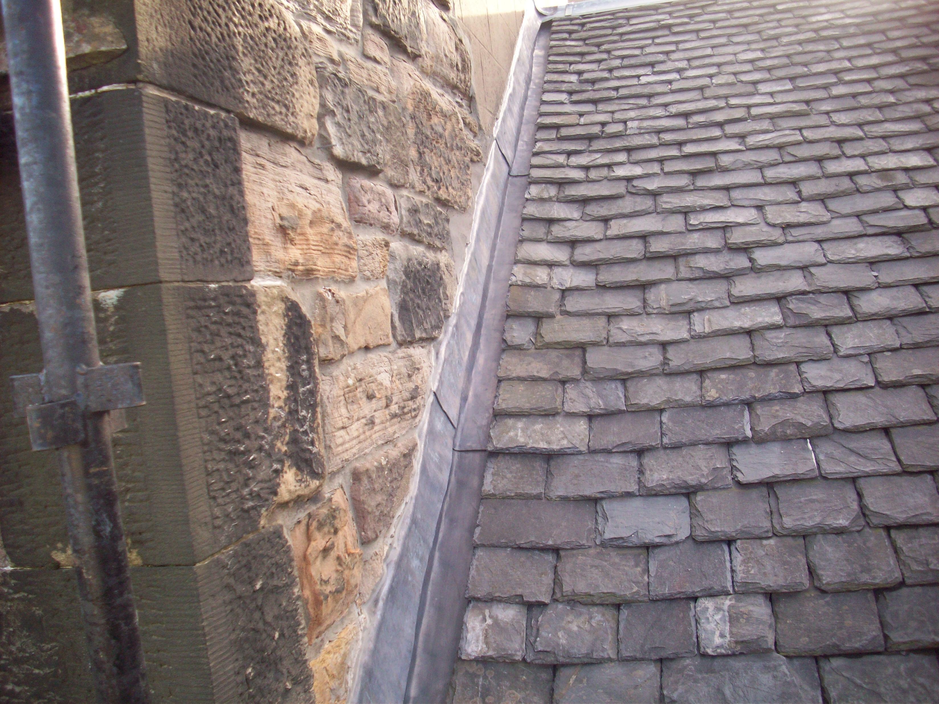

Oxbow16 Posted October 9, 2022 Author Posted October 9, 2022 (edited) This is all I've got at the moment, but here's a couple of photos showing what's there.... Edited October 9, 2022 by Oxbow16

PeterW Posted October 9, 2022 Posted October 9, 2022 Got a photo ..? This sounds like it would be better done with a hidden gutter below the slates and cut into the stonework. 1
PeterW Posted October 9, 2022 Posted October 9, 2022 Ok just seen the photos - hidden gutter would be better there and just a clean line of slates cut to fit within an inch or so of the stonework 1
Oxbow16 Posted October 9, 2022 Author Posted October 9, 2022 I did read about hidden gutters but wasn't sure how appropriate it would be given the way the wall bends. It bulges out as you get toward the apex. Would that not be a problem and make a hidden gutter difficult? The other issue is that there are sarking boards and I'm not sure how close they get to the wall. I'd also need to check how much depth there is until your on top of the purlins, although I suspect there would be enough... Thanks :)
Oxbow16 Posted October 9, 2022 Author Posted October 9, 2022 On 09/10/2022 at 08:06, makie said: There is nothing technically wrong with it, that's how it's done most of the time in Scotland. Expand @makie - do you mind if I just clarify, seeing as you responded before I posted photos... Now that you can see the job, do you think it would still be ok for the soakers to tuck long lengths of lead in beneath those slates? Most likely without removing or lifting any of them? And just to add, for the soakers he'll be re-using the lead you can see in the photos. Many thanks
ProDave Posted October 9, 2022 Posted October 9, 2022 Soakers are in effect another form of hidden gutter. Their job is to catch any water that is not caught by the lead flashing on top of the tiles, most likely blown under by wind. So they still need to form a proper gutter so water flows down and out at the bottom. So there will need to be some form of upstand or turn up in the lead to prevent any such water just running off the side. So I think it highly unlikely you will get the detail right, just by shoving some lengths of lead under the tiles in situ without removing any. 1
Jenki Posted October 9, 2022 Posted October 9, 2022 As the above replies, if your roofer thinks he's going to slide 1.5m of lead under the slates without removing them then he's not a roofer but a magician. The slates will need to be removed. I'm assuming this is remedial work? Then this will possibly be due to leaks? Then surely you want to ensure the wood (joists and battens ) are sound before spending money covering them up? If it's leaked inside, then you can be sure it was leaking for a long time before it came inside. As it's stone I'd opt for individual soakers as the upstands can be dressed individually to the stonework, same for the stepped flashing. That said a grp hidden gutter would work well with some stone dressing. 1
makie Posted October 9, 2022 Posted October 9, 2022 On 09/10/2022 at 11:37, Oxbow16 said: @makie - do you mind if I just clarify, seeing as you responded before I posted photos... Now that you can see the job, do you think it would still be ok for the soakers to tuck long lengths of lead in beneath those slates? Most likely without removing or lifting any of them? And just to add, for the soakers he'll be re-using the lead you can see in the photos. Many thanks Expand Long lengths no. My comment was in reference to a Watergate slated in (see picture), not long soakers. It would be near impossible to do what your roofer is proposing and I doubt it would work. No matter what happens that lead can't be used for soakers. Soakers should be code 3 with those slates. 1
