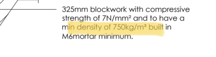

Kelvin Posted October 7, 2022 Posted October 7, 2022 Hi I have finally got the SE pack back (well 4 drawings plus details) it's only taken them 9 weeks. Long story. The house is a CPS timber kit (302mm) The blockwork foundation detail is 325mm blockwork with a compressive strength of 7N/mm2 and a minimum built density of 750kg/m3. I was hoping to use an insulated block but they all seem to have a maximum density of 730kg/m3. Any suggestions? I also have concerns about thermal bridging which I've asked them about.

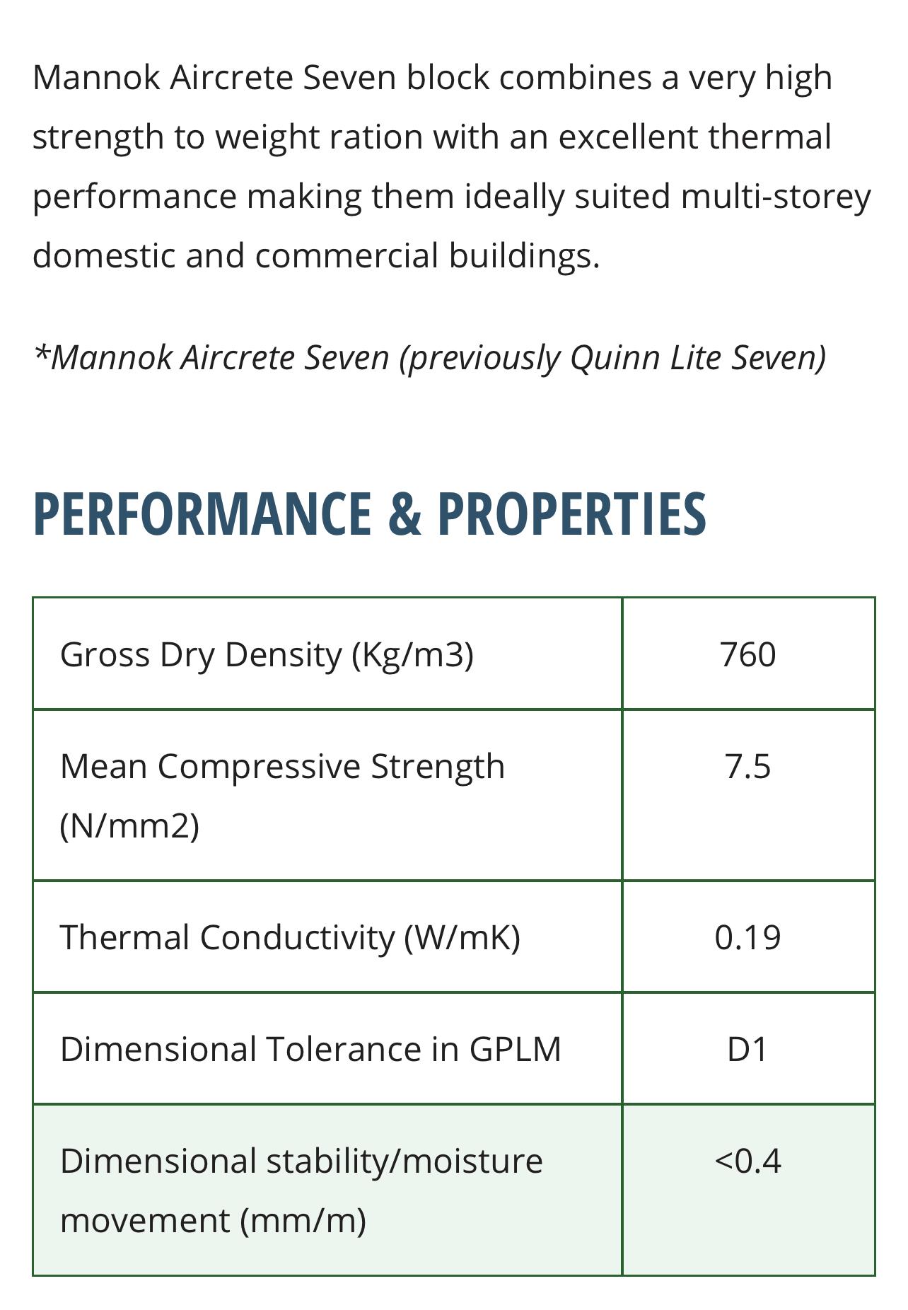

Kelvin Posted October 7, 2022 Author Posted October 7, 2022 More googling and I've come across this: Mannok Lite Block 440 x 215 x 100mm 7N (Each) Gross Dry Density 760kg/m3 Average Compressive strength 7.5 n/mm2 Thermal Conductivity 0.19W/mk

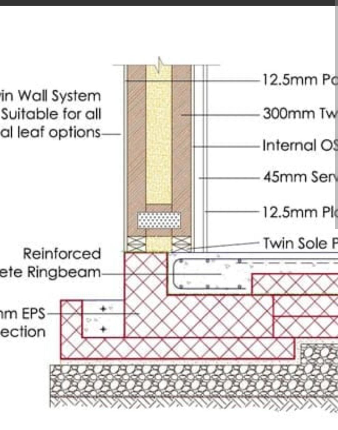

Thorfun Posted October 7, 2022 Posted October 7, 2022 you're having those awesome twin stud wall (I believe called Larsen truss?) which I presume is being filled with some form of cellulose pumped in? if so, why have you not considered a passive insulated slab? would get rid of all of your thermal bridge concerns at the slab level. 1
Kelvin Posted October 7, 2022 Author Posted October 7, 2022 It's a good question. 6 months ago I knew nothing about any of this. I've been following architect's advice (timber kit company is Heb Homes) this is their standard foundation design and typically Scottish apparently. Since then I've become a bit more informed and now understand the consequences of some of the decisions better and started looking at passive insulated rafts. I have a meeting with HH on Monday to discuss all of this. 1

Iceverge Posted October 7, 2022 Posted October 7, 2022 Some details show twin wall timber frames supported on one side only allowing continuous insulation from the floor to the wall. Either insulated raft on the inside or supported on a block and strip foundation on the outside. Maybe you could explore this.
Kelvin Posted October 8, 2022 Author Posted October 8, 2022 (edited) Thanks. It doesn’t look to me that the kit load point is on one side though. I’ve spoken with Isoquick and they’ve come back with a couple of options and a cost estimate although they need the load points too of course. I’ve also spoken with the timber kit supplier (the MD in fact) and we’ll follow it up on Monday. They have done Isoquick foundations for their builds in the past but my guess is that is likely to have been with their SIP kits rather than the CPS we are doing. He did say that a thermal bridge like this wouldn’t get past building control anyway. He made a curious point (to me anyway) He said that the SE won’t consider insulation as part of the structural design as he’s only focused on holding the building up. It’s the architects job to figure out the insulation detail. That seems odd to me as surely one drives the other? Edited October 8, 2022 by Kelvin

Kelvin Posted October 8, 2022 Author Posted October 8, 2022 Cheers. I can see a way how to build up the block wall to achieve the same outcome with my foundation. I’ve also found an insulated block that meets the design strength spec.

Gus Potter Posted October 8, 2022 Posted October 8, 2022 On 07/10/2022 at 10:32, Kelvin said: The blockwork foundation detail is 325mm blockwork with a compressive strength of 7N/mm2 and a minimum built density of 750kg/m3. I was hoping to use an insulated block but they all seem to have a maximum density of 730kg/m3. Any suggestions? I also have concerns about thermal bridging which I've asked them about. Hope this helps give some pointers that will help you frame your questions in the way you want. A 7.0 N/mm^2 unit strength dense concrete block wall weighs about 1800 to 2100 kg per m^3. An aerated (say Celcon ) concrete block wall weighs about 400 to 900 kg/m^3 and has a varying unit compressive strength. Remember that the light weight blocks contain air pockets.. the more air pockets the less concrete material to resist the loads so lower compressive strength but better u value. To make an aerated block the same unit strength as a dense block you need to use more cement for example and that is one reason why they are more expensive. The density is not usually a primary issue, it's the block strength that is considered first. In principle there is no reason why you can use an insulating block provided it has the same compressive unit strength. Just check you are not in aggresive ground for example.. always check with your|SE before you swap out materials. Also, check the mortar mix in case the blocks need a different spec. If the mortar is too strong it plays havoc with aerated blocks.

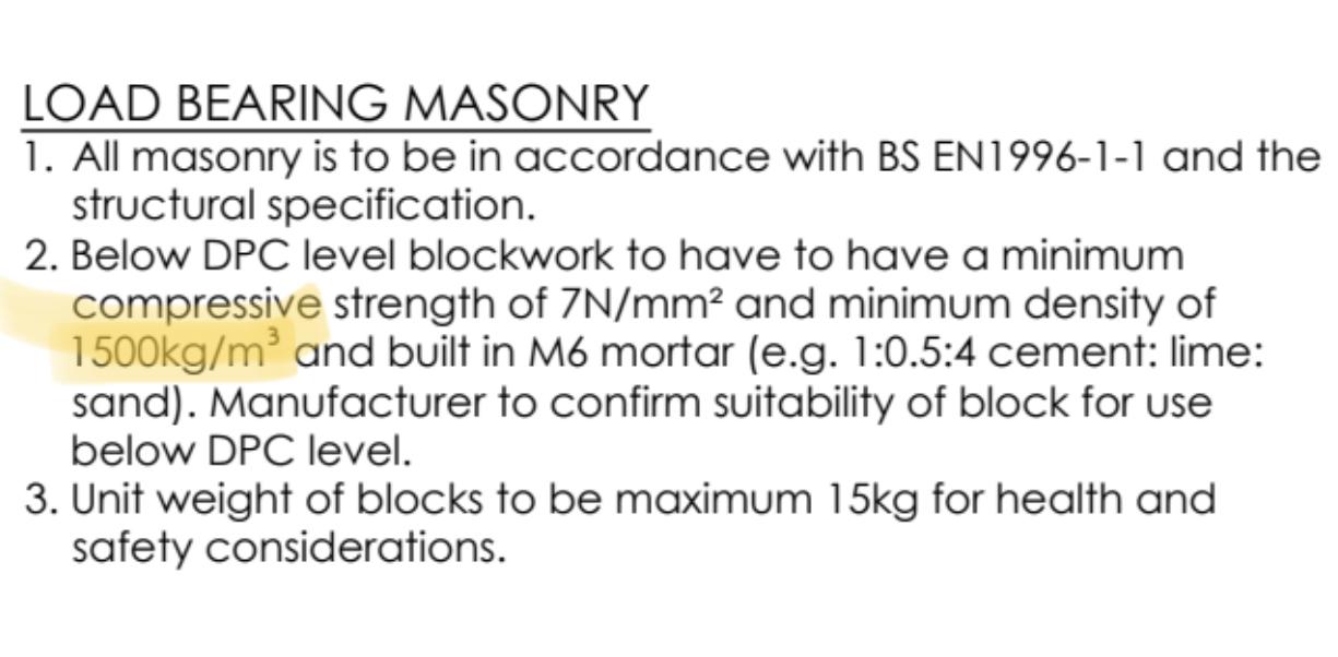

Kelvin Posted October 8, 2022 Author Posted October 8, 2022 It’s these blocks. Mortar is M6 mix. However, there’s something that appears contradictory in the SE notes but it might be my lack of understanding. It states two different minimum densities.
JohnMo Posted October 9, 2022 Posted October 9, 2022 Looks like a bit of cut and paste engineering which hasn't captured all the changes needed. I would ask him to clarify.
Kelvin Posted October 9, 2022 Author Posted October 9, 2022 Yes what I assumed. I’ve emailed them about it. It’s another source of frustration. I don’t know if it’s normal but the lack of attention to detail is shocking to me. Since the start every single document I’ve been sent is full of errors. Ironically the SE drawings were delayed in being sent to building control as the kit company wanted to scrutinise them to make sure there were no errors (because of my moaning about all the other errors). What concerns me though is while I can easily spot these kinds of errors I don’t have enough technical knowledge to spot anything that’s technically incorrect. Nor should I of course but it is sapping my confidence.

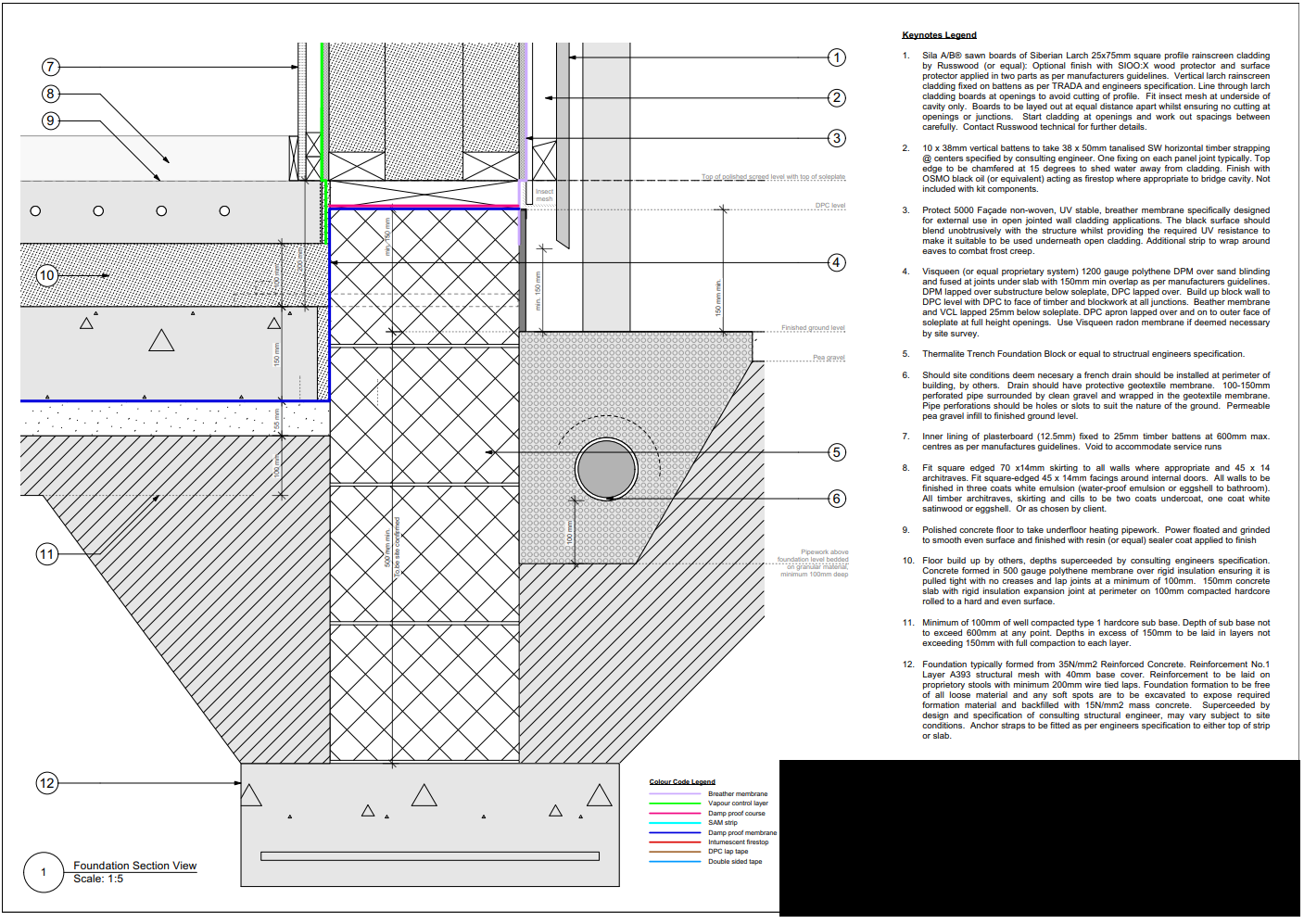

Kelvin Posted October 11, 2022 Author Posted October 11, 2022 Here's an example of a typical construction drawing. It's not entirely clear from the keynotes but it looks like they fit 100mm of perimeter insulation above and 150mm below floor insulation.
Mr Punter Posted October 11, 2022 Posted October 11, 2022 A course of Marmox Thermoblock or Foamglas Perinsul blocks under the sole plate should largely eliminate the cold bridge.

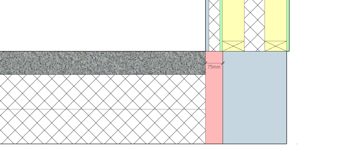

Iceverge Posted October 11, 2022 Posted October 11, 2022 Or you could use the denby dale detail but with a narrower cavity so that both side of the twin wall TF landed both sides of the insulation. Mind you from your drawing it look like you have a 50mm service cavity. 15mm plasterboard, 50mm SC overlap the sole plate by 10mm you could have a 75mm perimeter insulation. This would perform excellently.
Kelvin Posted October 11, 2022 Author Posted October 11, 2022 The Foamglas stuff isn’t dense enough. The sole plate is 300mm wide so what would the blockwork build up look like using Marmox? The service cavity is 25mm.
