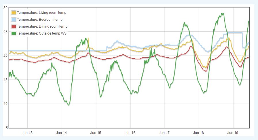

SteamyTea Posted June 18, 2017 Posted June 18, 2017 As we have had a few sunny days recently and pretty close to the longest hours of daylight, has anyone suffered increased overheating? Decent temperature data is always welcome, but a general response is also useful.

Jeremy Harris Posted June 19, 2017 Posted June 19, 2017 Something odd is going on today, as it's hotter outside, yet cooler inside, so much so that the slab cooling hasn't come on yet. It's 32.1 deg C outside, from the sensor standing off from the sheltered North wall (the hottest I've seen so far this year) yet it's only 22.2 deg downstairs and 22.6 deg C upstairs. The MVHR cooling has just come on (it comes on at 22.5 deg C upstairs), but I suspect that the slab cooling may not come on at all today (it comes on at 22.5 deg downstairs). We're currently generating just over 6 kW, and consuming around 3 kW, with my car on a slow charge. I'm tempted to pull the USB stick from the logger and see what all the data looks like.
