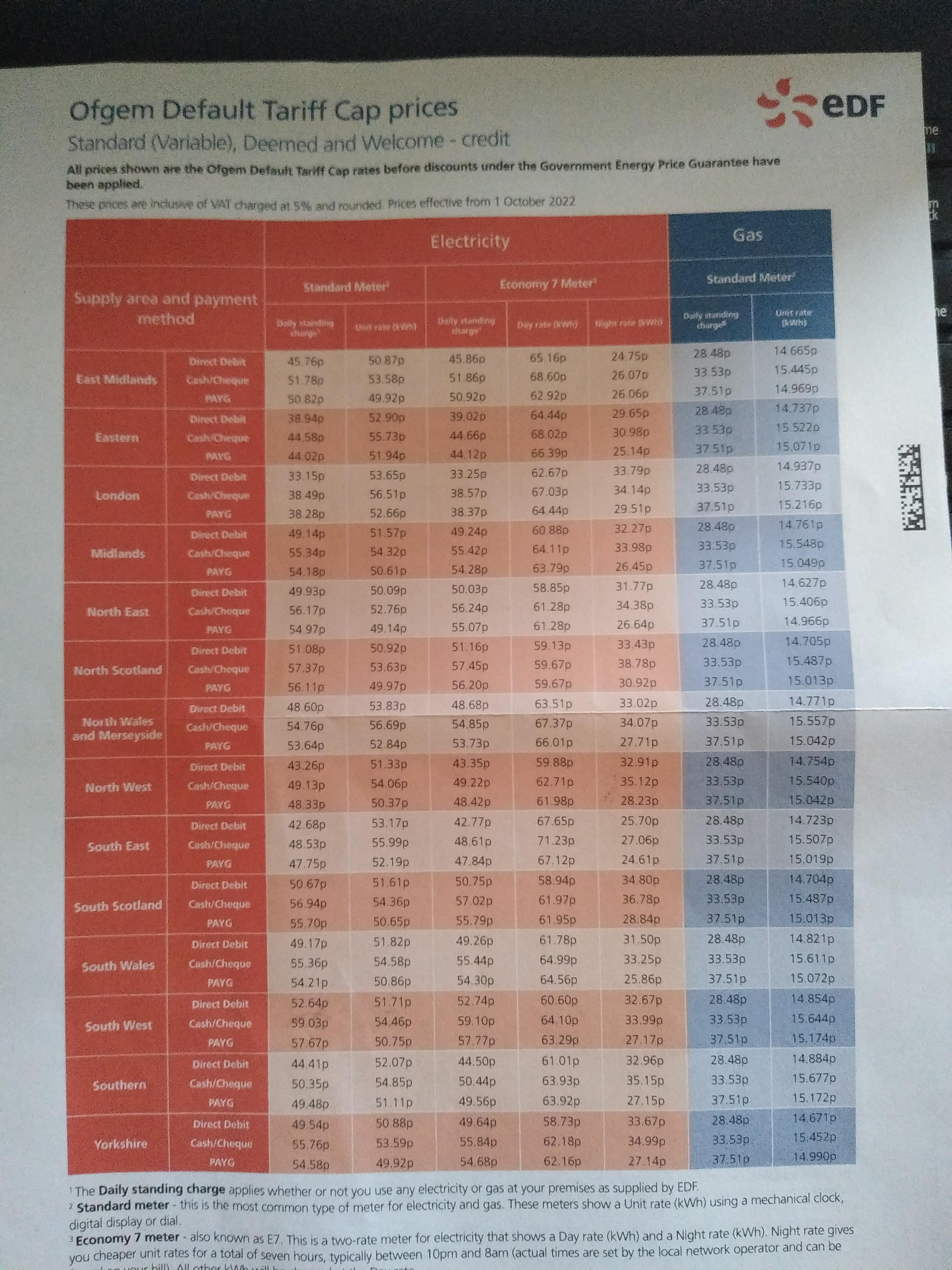

Well the letter arrived today.
Lots of different prices depending where you are in the UK and what sort of billing you have.
I have the most expensive billing, quarterly and I am in one of the poorest parts of the UK, so I pay more for my energy.
You all ready:
Daily charge: 59.10p/day
Day Units: 64.10p/kWh
Night Units: 33.99p/kWh.
If I had gas, with EDF, it would be 33.53p/day and 15.644p/kWh.

@Radian
Standard variable rate, on quarterly billing is:
Daily charge 59.03p/day, unit price 54.85p/kWh.
Currently using 1 kWh during the day and 2 at night.
E7
1 x 59.10p [daily charge] + 1 x 64.10p [day rate] + 2 x 33.99p [night rate] = 191.18p [201p with VAT]
Standard Rate
1 x 59.03p [daily charge] + 3 x 54.46p [energy charge] = 222.41p [234p with VAT]
For the winter I use around 13 kWh/day, spit 2 day rate and 11 night rate.
So
E7
1 x 59.10p [daily charge] + 2 x 64.10p [day rate] + 11 x 33.99p [night rate] = 561.19p [589p with VAT]
Standard Rate
1 x 59.03p [daily charge] + 13 x 54.46p [energy charge] = 767.01p [805p with VAT]
I just need to get my night usage down a bit, hopefully the secondary glazing and fixing the doors will help.
I could save a little by going to monthly direct debit, but as I never got my £90 bank charges back after a meter reading mistake, I am reluctant to do that, very reluctant as EDFs blamed the bank, the bank blamed EDF, I paid, but not the £2500 they initially wanted, or the £1999 they wanted 2 days later, or even the £999 they wanted 3 days after that.
I paid the £246 I owed and sucked the bank charges up.

I am not sure.
Probably because it is not a capped rate as such, just an average household usage, which I think is something like 3.5 MWh/year electricity and 15MWh/year gas.  Those two should add up to £2500 (or whatever the numbers actually used are).
So while I will pay less than £2500 a year, because I am a low user ~3MWh/year this year) I get crucified on the standing charge, but the £400 grant and the £150 council tax rebate brings my unit rate down to the presently capped unit rate.
May put a meter reading in tomorrow, and add 2 MWh to it.

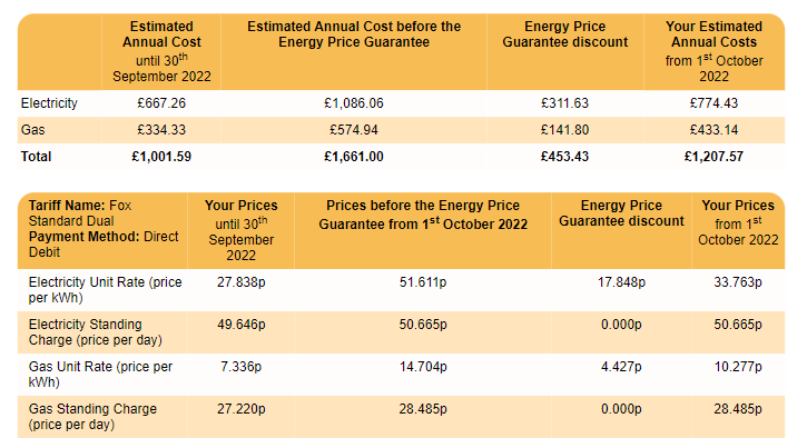

I switched to a new energy company this week. They insisted on quoting the uncapped rates, but were clear that I would actually pay the capped rates.
It's a single-rate tariff but I assume the same will be true of multi-rate tariffs - after all the interventions, your blended rate will actually be ~33p rather than 50p or so.
Fingers crossed, anyway.

Is this for your own house? Seems very high compared to my new prices with SSE. Currently standing charge 51.62p, electricity 28.41p. From 1st October standing charge 52.64p, electricity 33.86p. I'm also in Cornwall on quarterly billing so there must be something wrong.
From the letter they sent.

I just find it strange the way that the new tariffs are presented, looks to me like they can charge what they like, but once the £400 grant is deducted, it falls into line with the typical £2,500 a year.
I find it strange as well. My prices don't include the £400, which is a six month, one off grant, and not connected to the price cap.

The £400 reduces a typical bill from £2500 to £2100 under the price cap.

Email from Octopus last night confirms my expectation that we'll not benefit from the energy price guarantee as our average kWh rate (on Go) is below the capped rate.
