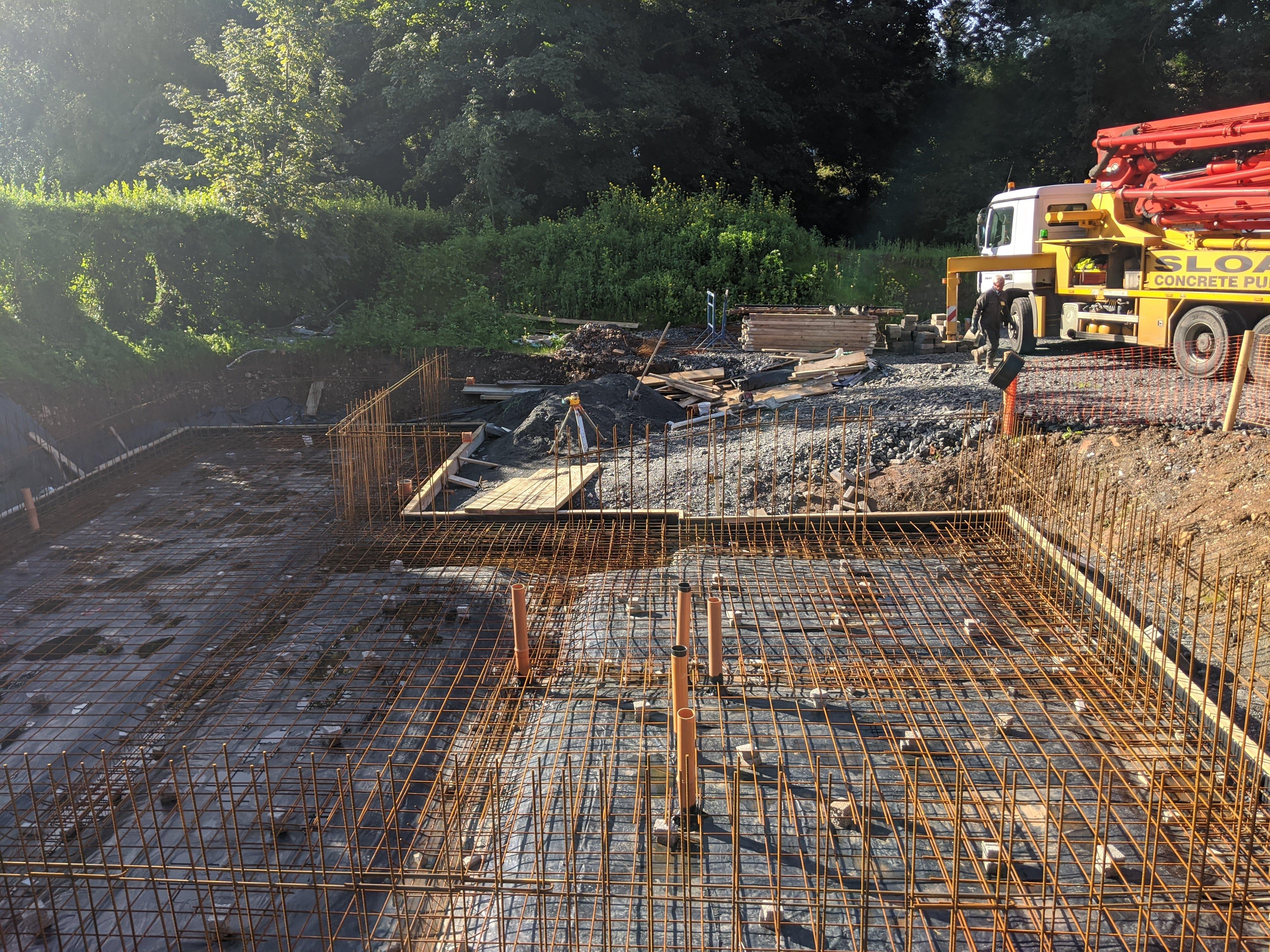

Mr Punter Posted September 28, 2022 Share Posted September 28, 2022 If you are concerned about mesh buildup, instead of lapping you could butt the sheets and join them with H10 splice bars. Because the slab is fairly small you could then use the smaller merchant sheets of mesh, which are much easier to handle. Ask the SE to confirm if this is acceptable and the lap required. If the SE is doing the structural design for the whole house it may be better to just stick with them. You could request that they omit a layer or downgrade to, say 252 mesh but I doubt it will make a huge difference in cost and they may not agree to do it. Link to comment Share on other sites More sharing options...

Conor Posted September 28, 2022 Share Posted September 28, 2022 52 minutes ago, Field_of_Dreams said: I'm not trying to recalculate what the SE said. I am asking how to best work out how many sheets and what size will fit the spec from the SE. Is there not a mesh/bar schedule on the drawings? We just sent the drawings off the the supplier and it all arrived on the back of a lorry a week later. As our walls were also RC, we didn't need to use links or overlaps, the U shaped starter bars did that, so despite having three layers at the ring, was simple enough. Link to comment Share on other sites More sharing options...

George Posted September 28, 2022 Share Posted September 28, 2022 1 hour ago, Field_of_Dreams said: Thanks for the info! Do you have a picture of this? Not sure what it is and a google search showed too many different things for me to be certain what was correct. It's just short lengths of B10 (10mm diameter) bar. usually you overlap by 400mm, so a 800mm length of B10 to lap 400mm onto each sheet. I think it would be more fiddly than lapping sheets, but all reinforcement work is fiddly! I have to say, speaking as a structural engineer, 3No layers of A393 in the top of a slab seems excessive. I didn't put that much into industrial warehouse slabs. Is it on piles/vibro-stone columns or particularly poor ground? Link to comment Share on other sites More sharing options...

Field_of_Dreams Posted September 28, 2022 Author Share Posted September 28, 2022 4 hours ago, George said: It's just short lengths of B10 (10mm diameter) bar. usually you overlap by 400mm, so a 800mm length of B10 to lap 400mm onto each sheet. I think it would be more fiddly than lapping sheets, but all reinforcement work is fiddly! I have to say, speaking as a structural engineer, 3No layers of A393 in the top of a slab seems excessive. I didn't put that much into industrial warehouse slabs. Is it on piles/vibro-stone columns or particularly poor ground? thanks for the info. Do you run a B10 bar alongside each of the bars on the mesh? The ground is medium/high plasticity clay and there are several large mature sycamores within 4M of the building. There was also a eucalyptus on the site that has been removed but also impacted on the design, according the SE. Link to comment Share on other sites More sharing options...
Field_of_Dreams Posted September 28, 2022 Author Share Posted September 28, 2022 5 hours ago, Conor said: Is there not a mesh/bar schedule on the drawings? We just sent the drawings off the the supplier and it all arrived on the back of a lorry a week later. As our walls were also RC, we didn't need to use links or overlaps, the U shaped starter bars did that, so despite having three layers at the ring, was simple enough. No schedule on the drawing and I have not sent the drawing to a mesh supplier yet…was trying to figure it out before I did that 🙂 The walls will be ICF but they are not linked to the slab via any steel. Link to comment Share on other sites More sharing options...

Mr Punter Posted September 28, 2022 Share Posted September 28, 2022 7 hours ago, Field_of_Dreams said: Thanks for the info! Do you have a picture of this? Not sure what it is and a google search showed too many different things for me to be certain what was correct. This is just lengths of rebar probably 800mm-1000mm to tie the sheets of mesh together where they butt up, so each end of mesh has a 400mm-500 lap and they will be every 200mm along the mesh. I am not sure that steel fibres will work for you. They are not a direct replacement for steel mesh but if the SE considers it acceptable then fine. Link to comment Share on other sites More sharing options...
