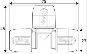

MortarThePoint Posted September 27, 2022 Author Share Posted September 27, 2022 Here are some dimensions Link to comment Share on other sites More sharing options...

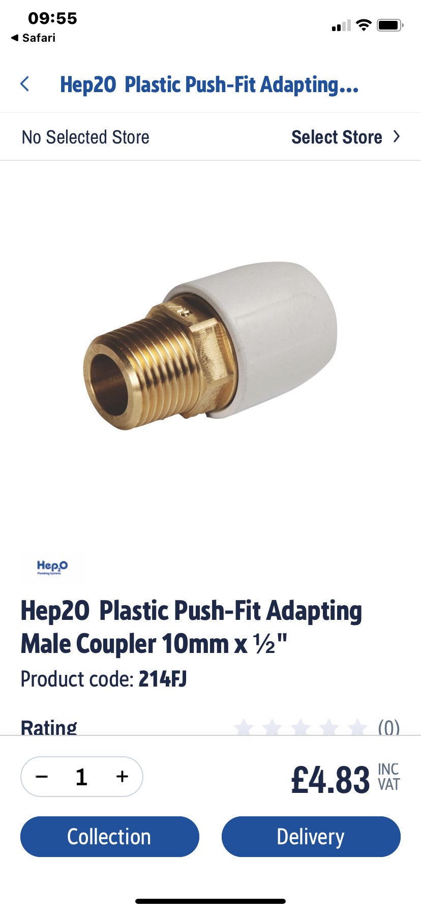

Nickfromwales Posted September 27, 2022 Share Posted September 27, 2022 52 minutes ago, PeterW said: How..???? I’ve buried hundreds of these as has @Nickfromwales and I don’t think I’ve ever seen an issue… Use the correct insert, don’t try and use chrome pipe as tails, and then just clip back and plaster over. If you’re worried about pipe movement you can wrap the pipe with fibre insulation as plaster bonds onto it. Yup. Fit and forget with Hep2o. 2 hours ago, MortarThePoint said: I have to feed a basin and high level cistern both mounted on blockwork. 10mm pipe coming down from ceiling so want to use a tee to feed the high level cistern and would also need elbow to make the corner to bring pipe out of wall at each. Use a bullnose T ( 10x10x15 centre ) so you have 15mm coming off the tee, then you can go to chrome and compression onto a stub of copper. For the basin I’d just leave a neat recess out of site with the 10mm pipes ending in 2x 10mm M&F bends with 2x 10x 1/2” Hep2o vs brass adaptors, and the flex is from the taps straight onto those. 1 Link to comment Share on other sites More sharing options...

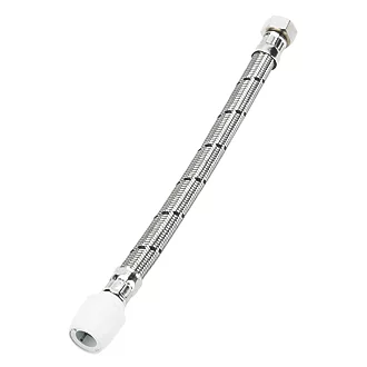

MortarThePoint Posted September 27, 2022 Author Share Posted September 27, 2022 25 minutes ago, Nickfromwales said: Use a bullnose T ( 10x10x15 centre ) so you have 15mm coming off the tee, then you can go to chrome and compression onto a stub of copper. For the basin I’d just leave a neat recess out of site with the 10mm pipes ending in 2x 10mm M&F bends with 2x 10x 1/2” Hep2o vs brass adaptors, and the flex is from the taps straight onto those. Do you not rate the Hep2O tap tails? https://www.screwfix.com/p/hep2o-push-fit-flexible-tap-connectors-15mm-x-x-300mm-2-pack/1250f Link to comment Share on other sites More sharing options...
PeterW Posted September 27, 2022 Share Posted September 27, 2022 44 minutes ago, MortarThePoint said: Do you not rate the Hep2O tap tails? https://www.screwfix.com/p/hep2o-push-fit-flexible-tap-connectors-15mm-x-x-300mm-2-pack/1250f They are ok but don’t forget to put the isolator in Link to comment Share on other sites More sharing options...
