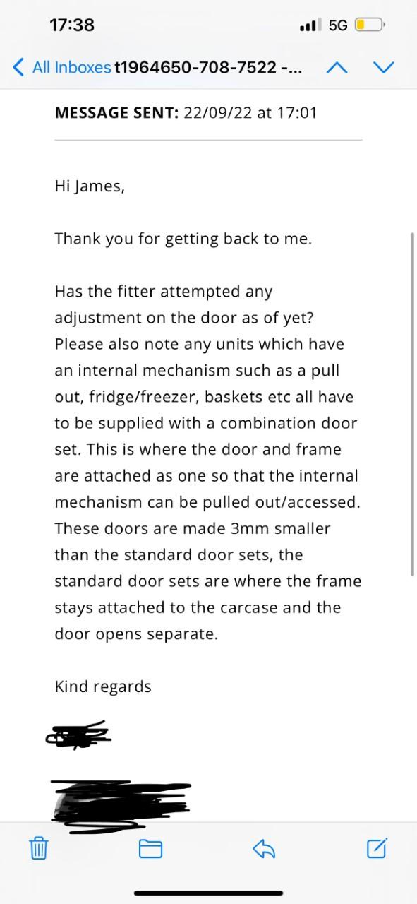

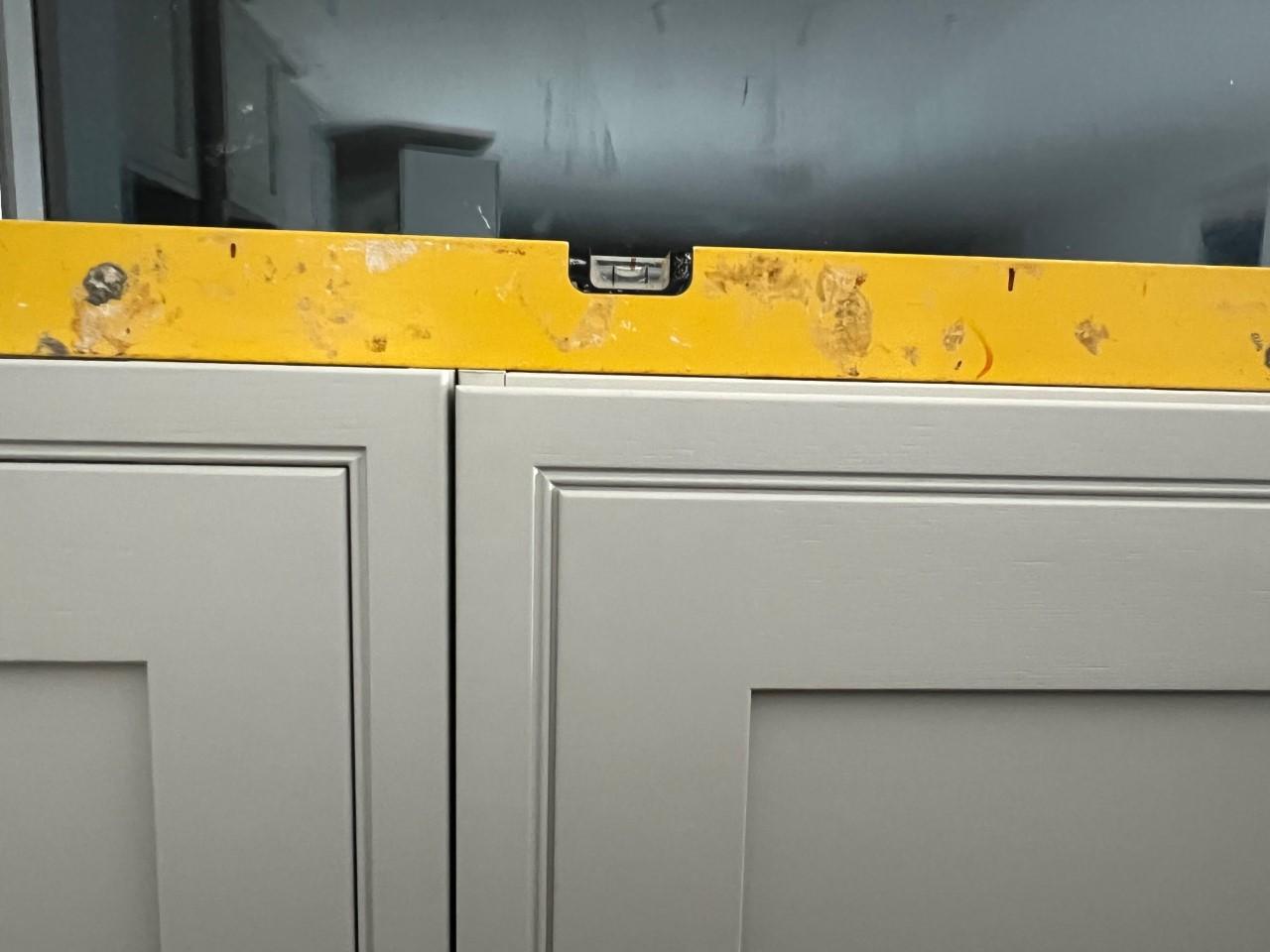

James94 Posted September 23, 2022 Share Posted September 23, 2022 Is this the norm, I have started to install the kitchen units and have noticed there is some difference in door heights and I cant seem to work out what to do for the best. I have attached a picture to try and explain it better and also one of a response from the manufacturer. any advice would be greatly appreciated. Regards James Link to comment Share on other sites More sharing options...

joe90 Posted September 23, 2022 Share Posted September 23, 2022 The door on the left is a bit high in my opinion, leaves very little clearance to the worktop!!! What height are the rest? Link to comment Share on other sites More sharing options...

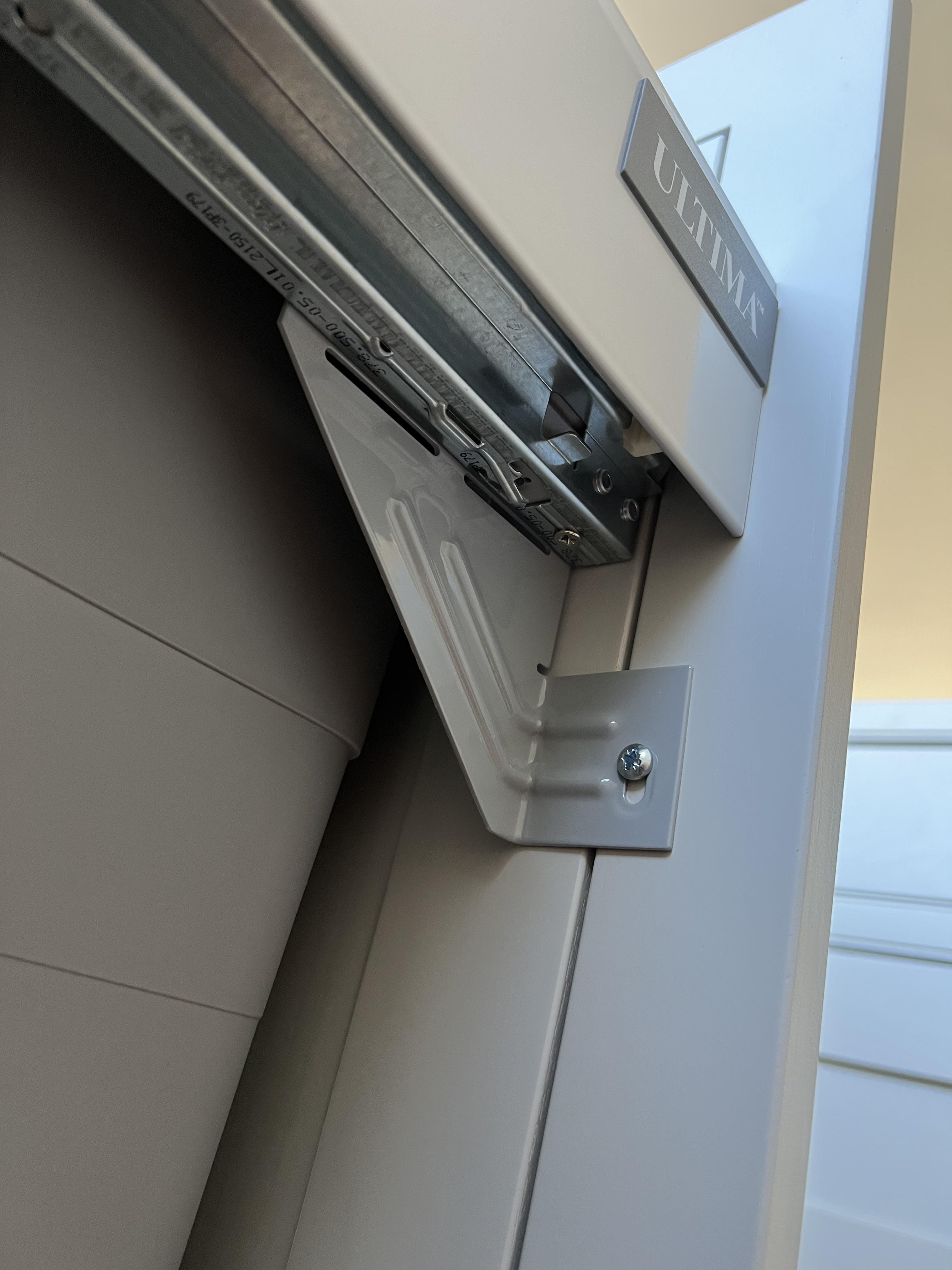

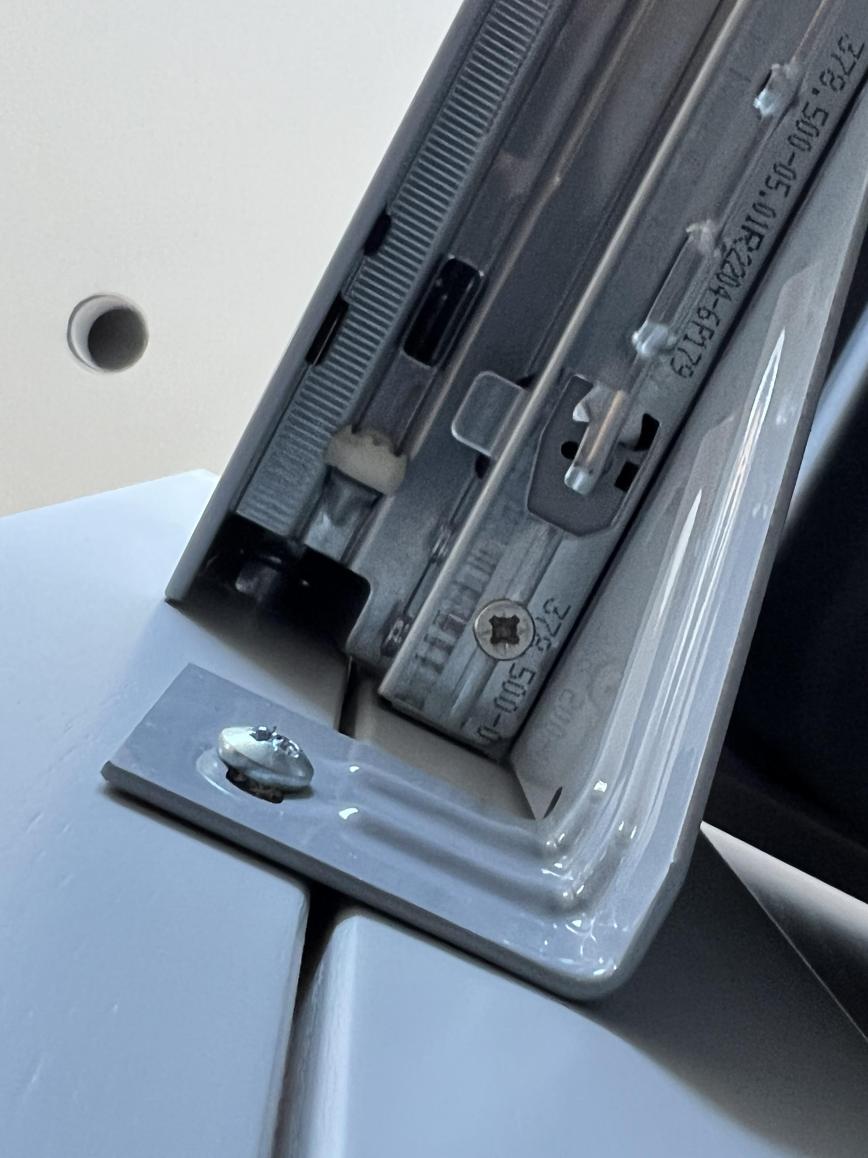

ProDave Posted September 23, 2022 Share Posted September 23, 2022 6 minutes ago, James94 said: The unit on the right which is lower, is a pull out bin with a combination door so I’m not sure if this can be adjusted What make of kitchen units? Show us a picture of the inside of this pull out bin unit, particularly where the door joins the pull out frame. Link to comment Share on other sites More sharing options...

ProDave Posted September 23, 2022 Share Posted September 23, 2022 The screw through the metal frame is in a slot, loosen all the screws, adjust the door height, re tighten screws. 1 Link to comment Share on other sites More sharing options...

Radian Posted September 23, 2022 Share Posted September 23, 2022 3 hours ago, James94 said: a response from the manufacturer So the 'combination door' is 3mm shorter? Nobody seems to have asked about the bottom edges of the two doors? Is it that you 'get' there must be height difference (I don't) and just want some suggestions about hiding it? Link to comment Share on other sites More sharing options...
Jonny Posted September 23, 2022 Share Posted September 23, 2022 This is done on purpose, the pull out doors need clearance on the worktops. Where as the in frame drawers/doors don’t need this same clearance. Once the worktop is on it won’t be so noticeable. Link to comment Share on other sites More sharing options...

Radian Posted September 23, 2022 Share Posted September 23, 2022 And if the gap was supposed to be hidden under the worktop then the top border should be 3mm thinner to keep the inset panel the same size. But you can see in the photo that the inset panels don't align either. I just don't get it. Link to comment Share on other sites More sharing options...
joe90 Posted September 23, 2022 Share Posted September 23, 2022 IMO the door on the left (and others if the same) need lowering by a couple of mm by loosening the fixing screws into the frame and sliding the hinge down in the slot) the bin door needs raising (using the slot like @ProDave says above) to match the height of the other door(s). Simples 😎 Link to comment Share on other sites More sharing options...
Radian Posted September 23, 2022 Share Posted September 23, 2022 Some day, some one will get a ruler out and measure the full height of the doors. If different, no amount of adjustment will make it all line up, so once again, I don't get it. Link to comment Share on other sites More sharing options...
ProDave Posted September 23, 2022 Share Posted September 23, 2022 1 hour ago, Jonny said: This is done on purpose, the pull out doors need clearance on the worktops. Where as the in frame drawers/doors don’t need this same clearance. Once the worktop is on it won’t be so noticeable. That might be true for a dishwasher,but this is a pull OUT door for a bin so should be identical. If this door really is 3mm shorter than the rest , it is the wrong door and needs replacing. P.S my dishwasher with it's pull down door operates quite normally with it's standard door exactly the same height as all the other doors. I don't believe anyone really does use shorter non matching doors. Link to comment Share on other sites More sharing options...
Jonny Posted September 24, 2022 Share Posted September 24, 2022 I’ve just fitted an in frame kitchen from mayflower and had the same issues. The door sizes were 4mm smaller from the fixed in frame to the pull out in frame. The pull out bin door takes the inframe section with it. Rather than leaving it attached to the cabinet Link to comment Share on other sites More sharing options...
