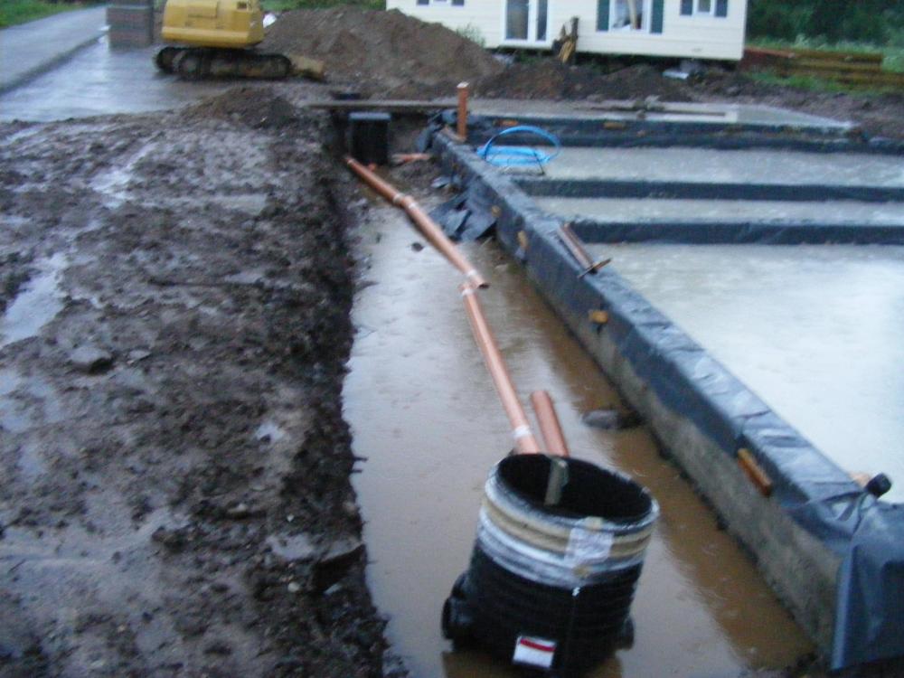

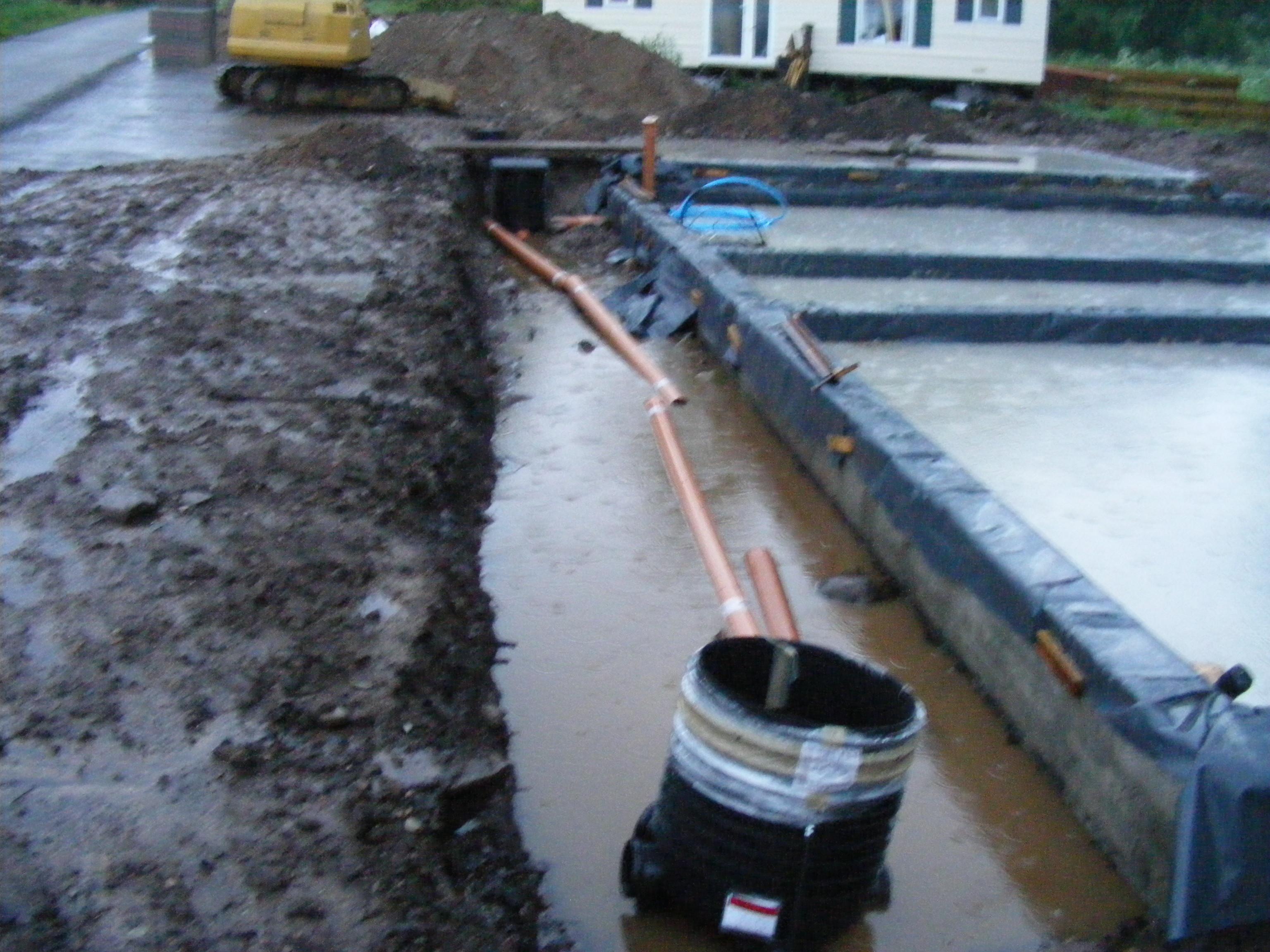

ProDave Posted September 22, 2022 Posted September 22, 2022 What they don't tell you: You dig your trenches, lay the drains nicely set in pea gravel and leave the trench open for building control to come an inspect as they demand. THEN you get torrential rain. That photo is after the rain in the trenches had gone down a lot. TIP: Put your drain test bung in at the bottom and fill all the pipes with water so they won't float if this happens. 1
ToughButterCup Posted September 22, 2022 Posted September 22, 2022 It was following your tip (Test bung above) that caused the explosion in the photo further up this thread. Thanks, mate. On a more positive note, I found this really helpful when working on your own .... Oil filter grip re-imagined 1

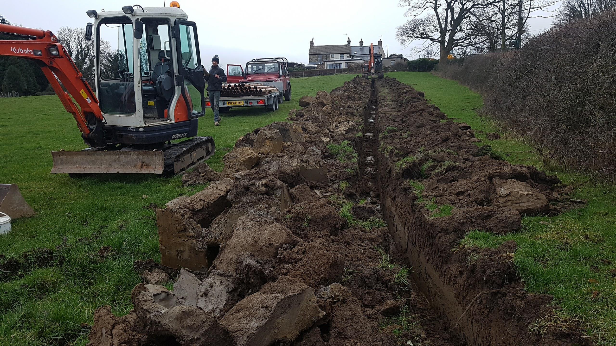

ToughButterCup Posted September 23, 2022 Posted September 23, 2022 7 hours ago, saveasteading said: ... 6. People don't understand bulking of excavated ground. (a: Leave lots of room for the excavated material. b) It won't go back in the hole however well compacted. ... ...and if you can, take the top layer of soil off, put that on one side of the trench, then dig down to the required level placing that spoil on the other side of the trench, like this 1

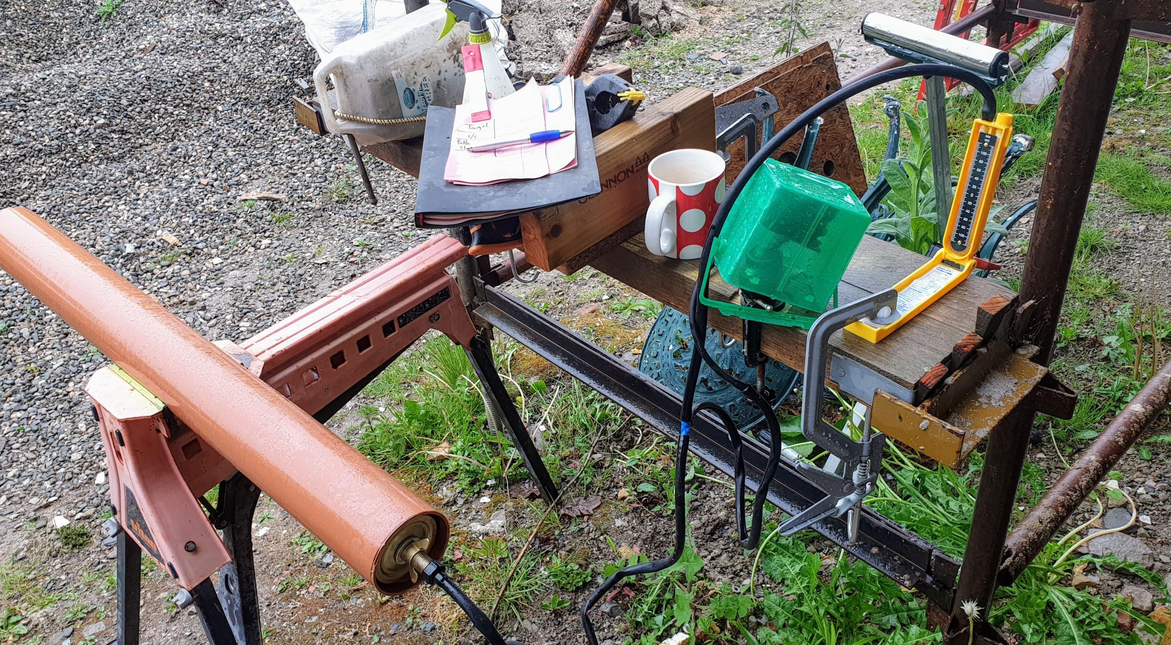

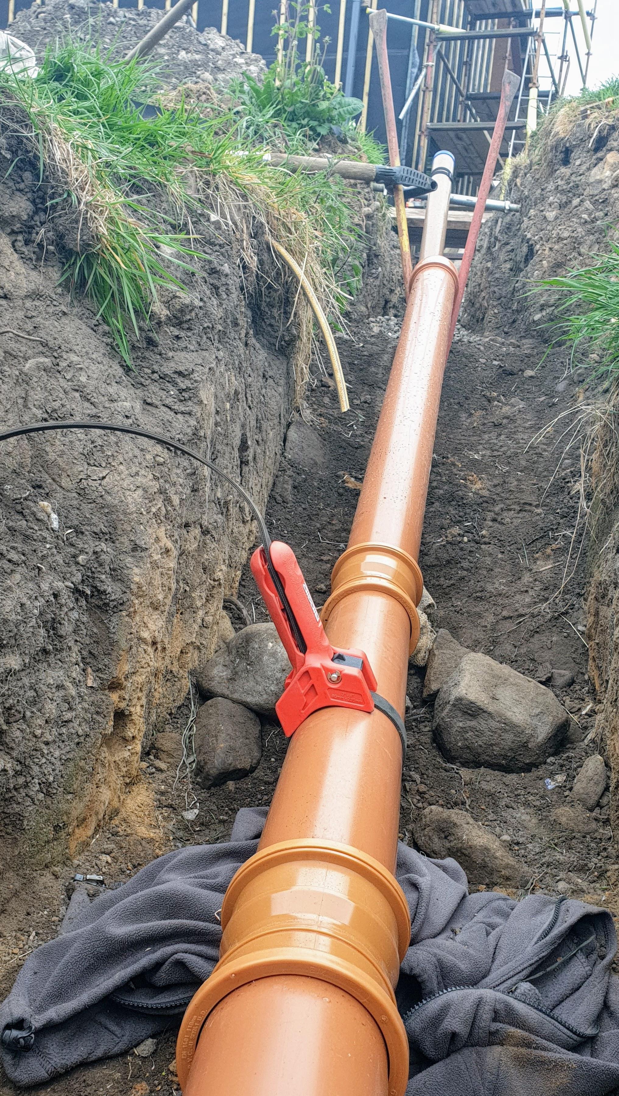

ToughButterCup Posted September 24, 2022 Posted September 24, 2022 16 hours ago, saveasteading said: ... if the pipes are cut beautifully. I realised somewhat later than I should have done, that setting up for making routine operations easy is very important . Cutting a 4" pipe is easy - but it's not easy when you're wet and tired in the bottom of a trench have dirty hands on your own not sure you measured the pipe correctly haven't got the right tools easily to hand I found that a super-jaws clamp is almost exactly the same working height as a scaffold end-step : that means you can handle long pieces of pipe on your own, and focus on making the cut accurately. You can comfortably apply washing up liquid, and then clean your hands off before you jump back into the ditch. A simple clean sheet of board lying next to you in the ditch so you can place and retrieve tools without clogging them up with clay is worth 10 times its cost. 1
joe90 Posted September 24, 2022 Posted September 24, 2022 3 minutes ago, ToughButterCup said: A simple clean sheet of board lying next to you in the ditch so you can place and retrieve tools without clogging them up with clay is worth 10 times its cost. That logic comes with age and maturity, I bet most of us (when younger) rushed into jobs, lost tools, slid about cussing and wasting time when trying to do it quickly, perhaps it’s because I am retired but I have found that better organisation and slower working ends up with less stress, a quicker job in the end and a better job 🥳 I had no stress during my build because of this attitude.
saveasteading Posted September 24, 2022 Author Posted September 24, 2022 3 hours ago, ToughButterCup said: Cutting a 4" pipe is easy Have always used a saw but I was expecting there to be a tool for it, which would be worthwhile with 50 or so cuts to do. We wouldn't cut a copper pipe with a hacksaw when there are rotary cutters. Or a saw guide big enough for a 110 pipe? The slight variation I always get results in the longest dimension being against the stopper in the connection, and a gap elsewhere of 1-2mm. doesn't matter esp if away from the base. But in a slip coupling situation the error is doubled and a likely catcher for any slow moving stuff, running out of energy. Perhaps two factory ends would be wise. ToughButterCup you appear to be testing a single pipe, hence testing the equipment. We had to do that as it failed after a few uses, due to its own hose connections (there are 6). A replacement kit works much better as it has more rubbery hoses. How can that little collection of plastic (factory cost £5??) be so expensive at between £40 and £60? The dearer one, though better, didn't include a water dripper, which is essential. I guess most kits are used once and so out multiple tests were too taxing. On 22/09/2022 at 08:10, ProDave said: leave the trench open for building control to come an inspect as they demand We invited them but they told us just to carry on, as they have since the start. We had sent some photos at various stages including pre-backfill drains, so presumably that was enough. I wonder if they trust self-builders more than contractors, as it will be their own problem hence QC.
