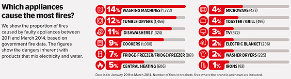

Triassic Posted June 16, 2017 Posted June 16, 2017 (edited) The simple answer is YES. An internet search lists a number of recalls and reports of incidents involving heat pumps. Which did a report based on Government information, here is a simple graphic of the results Edited June 16, 2017 by Triassic Source added

Triassic Posted June 16, 2017 Posted June 16, 2017 If you look at the risk of a fire from an ASHP you may wish to move your washer and drier into an external utility room, as we have just done.
