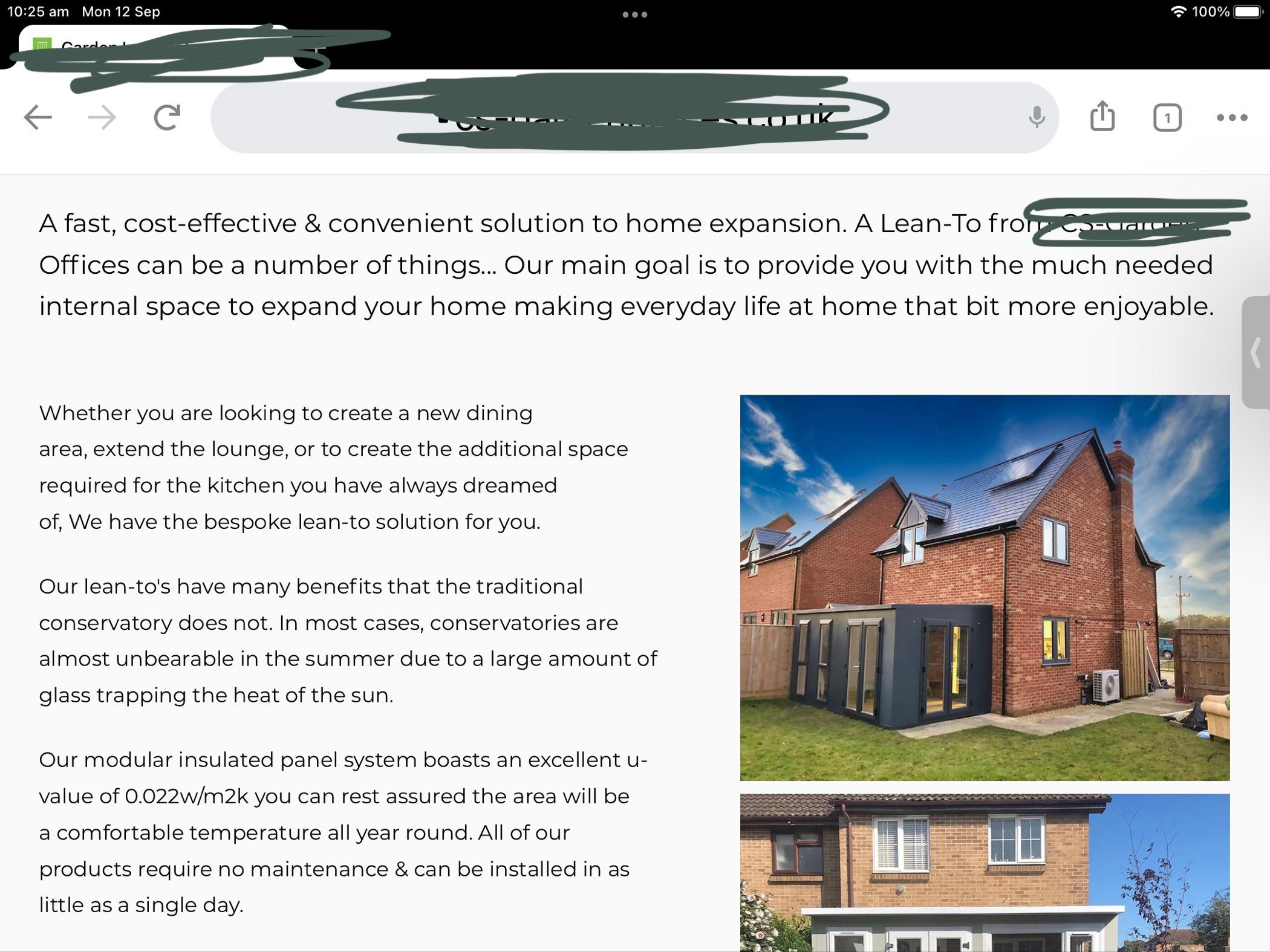

Riley99 Posted September 19, 2022 Author Posted September 19, 2022 (edited) Thank you for your response, This is what we have it’s a fully insulated lean-to (see photo) Made a big mistake by going to the council especially when we could have got an indemnity insurance but followed advice from estate agent to satisfy the buyer. In hind sight should have gone through the solicitors. We have now put in double glazed external doors between the house and the lean-to. Hopefully having a kitchen in the conservatory is ok? Edited September 19, 2022 by Riley99 Name of company was on photo
ProDave Posted September 19, 2022 Posted September 19, 2022 "Our modular insulated panel system boasts an excellent u-value of 0.022w/m2k" A typical passive house might achieve 0.1w/m2k and be considered good. This is claiming 1/4 the heat loss through the wall than a typical passive house. They loose all credibility in my book. It is as far as building regs are concerned a conservatory. Even if it was an "extension" built under permitted development it would have required building regs approval. the only solution I see for the sale is re instate an "outside door" between the house and extension and hope the buyers accept it as a conservatory.

AliG Posted September 19, 2022 Posted September 19, 2022 11 minutes ago, ProDave said: "Our modular insulated panel system boasts an excellent u-value of 0.022w/m2k" I think it is probably 0.22 as it looks like they are built using maybe 100mm PIR in both the walls and roof. 100mm PIR with little else would give 0.22 U-value A conservatory does not need a building warrant if separated by outside doors. But moving your kitchen does need a building warrant if it involves moving plumbing and/or the extractor fan.
MJNewton Posted September 19, 2022 Posted September 19, 2022 (edited) 4 hours ago, ProDave said: It is as far as building regs are concerned a conservatory Ah, but is it? Using the definition from this LABC Guidance Note it has to have at least 50% glazing in the walls (seems okay from the photo) *and* 75% glazing in the roof (but this one looks solid?)… Edit: I missed that Building Control have already been involved so it’s down to them how they interpret legislation that uses undefined terms, and if they say it’s a conservatory (or could be!) then I suppose it is! Edited September 19, 2022 by MJNewton

Ferdinand Posted September 20, 2022 Posted September 20, 2022 On 19/09/2022 at 16:40, ProDave said: "Our modular insulated panel system boasts an excellent u-value of 0.022w/m2k" A typical passive house might achieve 0.1w/m2k and be considered good. This is claiming 1/4 the heat loss through the wall than a typical passive house. They loose all credibility in my book. It is as far as building regs are concerned a conservatory. Even if it was an "extension" built under permitted development it would have required building regs approval. the only solution I see for the sale is re instate an "outside door" between the house and extension and hope the buyers accept it as a conservatory. I think you've both got the wrong end of this stick. 0.022w/m2k is the *material* U-value of PIR, so I think they are telling you about the material not the actual panel value, and being quite misleading in their blurb. So if it is 100mm PIR (which would be very generous for a panel system), that will be a u-value of 0.22 for the wall (ignoring the other elements), which is good for an insulated conservatory, but will not give comfortable year round temperatures unless shading, heating, cooling and ventilation are right. F
