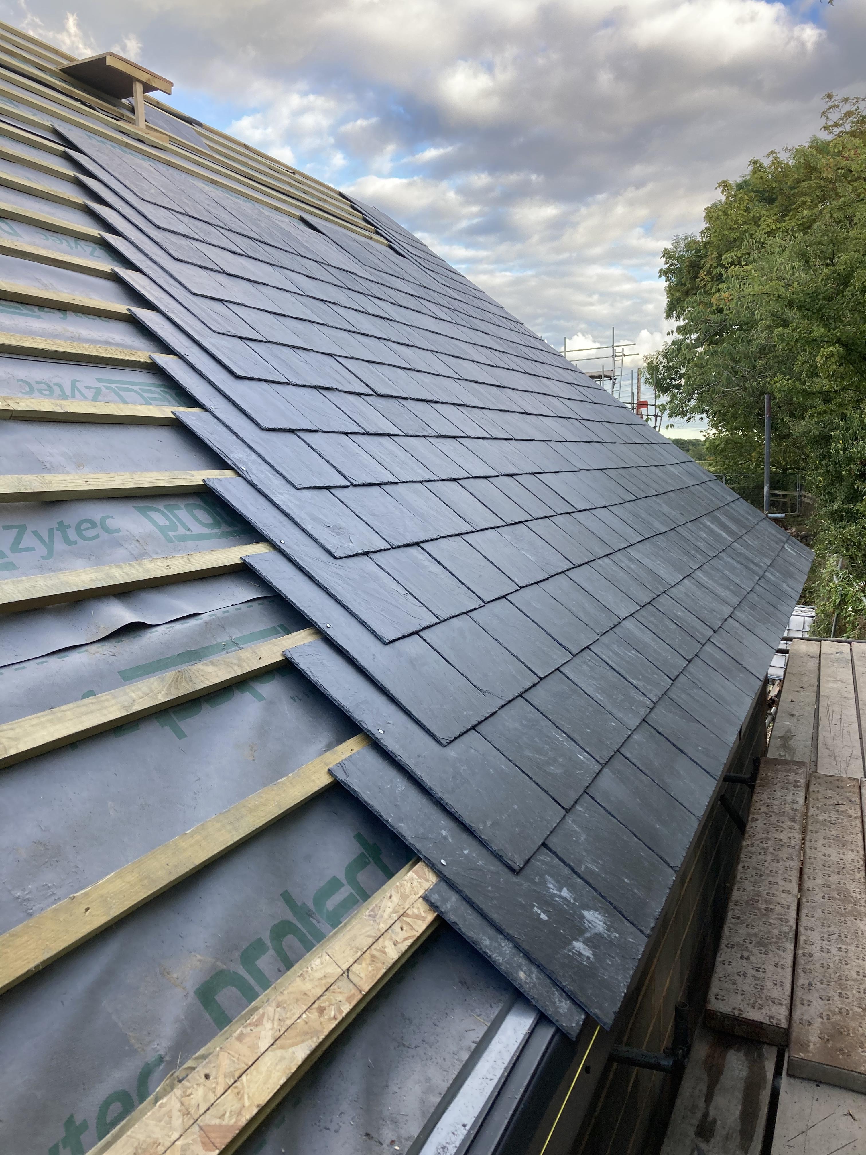

nod Posted September 10, 2022 Posted September 10, 2022 Myself and my wife got our slating gear out of retirement today and made a start on the workshop 600 x 300 £2.85 each 300 used 3100 to go 1 1

bassanclan Posted September 10, 2022 Posted September 10, 2022 Looks like your eaves course has run out a bit
nod Posted September 10, 2022 Author Posted September 10, 2022 27 minutes ago, JohnMo said: Looks good, still looks funny, living in Scotland, where they use sharking boards and no battens unless they are using concrete tiles. Slates 1
Hobbiniho Posted September 10, 2022 Posted September 10, 2022 looks good so far, do you have any vertical lines to make sure you keep your spacing even? i always enjoyed working with slate roofs although up here it was direct to sarking

Simplysimon Posted September 25, 2022 Posted September 25, 2022 looks good, should have gone with hooks though, nice and easy to replace any. bend hook, slide slate out slide new slate in on a slate ripper to catch the top of the batten, bend hook back, job done. try that with double nailed slates. 1
makie Posted September 25, 2022 Posted September 25, 2022 3 hours ago, Simplysimon said: looks good, should have gone with hooks though, nice and easy to replace any. bend hook, slide slate out slide new slate in on a slate ripper to catch the top of the batten, bend hook back, job done. try that with double nailed slates. Repairing a double nailed slate is easy if you know what you're doing. It's a 2 minute job.
Simplysimon Posted September 26, 2022 Posted September 26, 2022 18 hours ago, makie said: Repairing a double nailed slate is easy if you know what you're doing. It's a 2 minute job. please enlighten me

makie Posted September 26, 2022 Posted September 26, 2022 2 hours ago, Simplysimon said: please enlighten me Ask any qualified roofer. I am one. It's a simple job. Two ways. Either the same method here and install a slate hook or simply take one nail from each of the above slates also to allow them to turn. Then double nail the repaired slate and glue the two above back into position.
Simplysimon Posted September 26, 2022 Posted September 26, 2022 2 minutes ago, makie said: install a slate hook so not as installed 2 minutes ago, makie said: glue the two above back into position and a bodge
makie Posted September 26, 2022 Posted September 26, 2022 1 minute ago, Simplysimon said: so not as installed and a bodge It's a repair. it's in the name. And no glue is not a bodge. If the slate has a fixing already then it can be used. Unless you want to tell architects working on historic Scotland buildings they are wrong.
