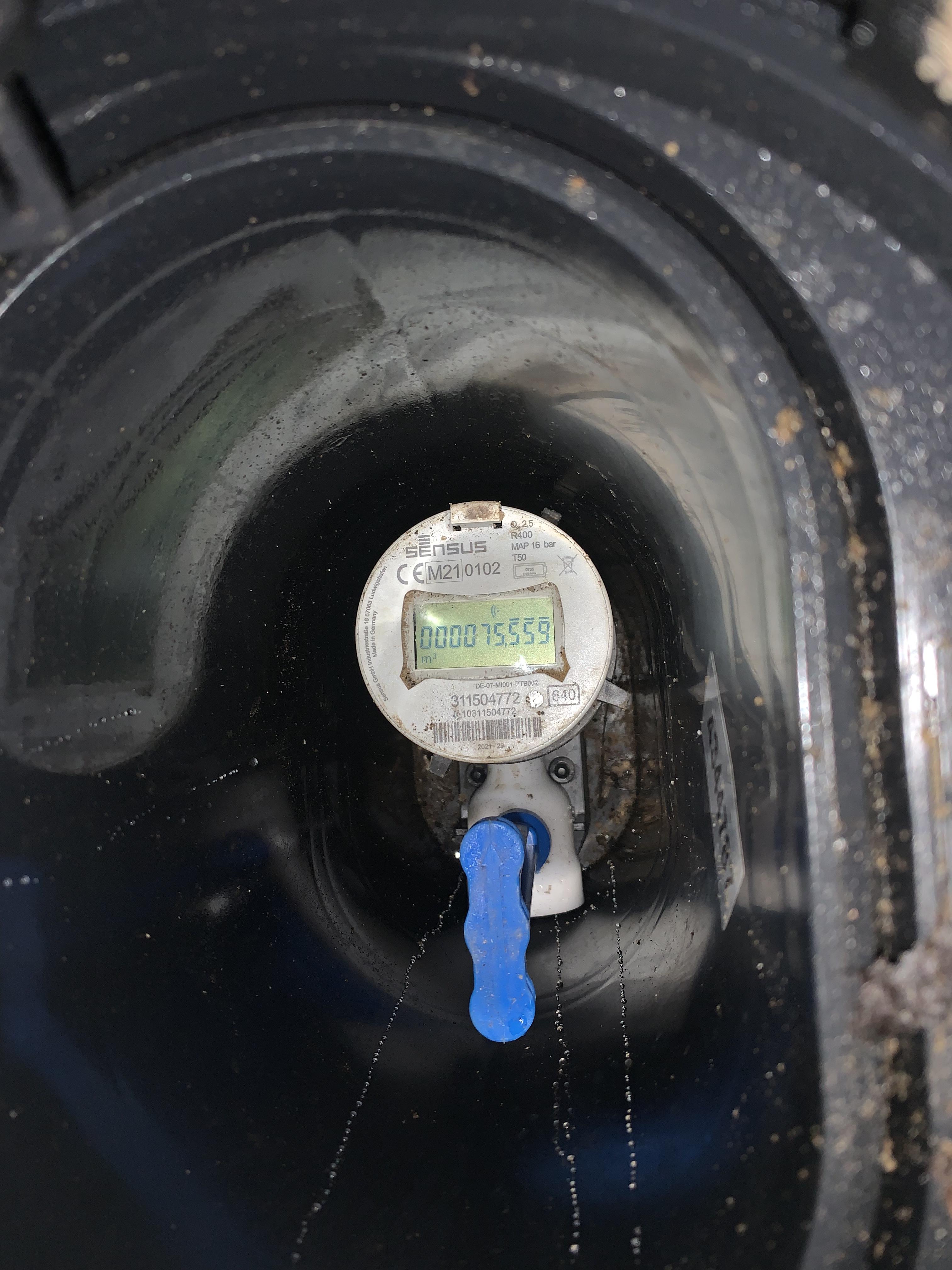

Adsibob Posted September 1, 2022 Author Share Posted September 1, 2022 Anyone know what this is? Found it on the public pavement outside my house. Link to comment Share on other sites More sharing options...
Canski Posted September 1, 2022 Share Posted September 1, 2022 Water meter and stop tap. Is it raining where you are ? Link to comment Share on other sites More sharing options...
Adsibob Posted September 1, 2022 Author Share Posted September 1, 2022 13 minutes ago, Canski said: Water meter and stop tap. Is it raining where you are ? There was a very very tiny amount of drizzle, hardly noticeable. Why do you ask? Link to comment Share on other sites More sharing options...
Canski Posted September 1, 2022 Share Posted September 1, 2022 I saw droplets of water. I’m sorry, I don’t know if that’s on or off. Link to comment Share on other sites More sharing options...

Adsibob Posted September 1, 2022 Author Share Posted September 1, 2022 17 minutes ago, Canski said: I saw droplets of water. I’m sorry, I don’t know if that’s on or off. I tried turning it. It only turned in one direction, and only a quarter turn. So it basically has only two options: on or off. Neither do anything for me. We have a water softener salt based system. Could that be the culprit? I checked and it still has a few shards of a block of salt left, so I doubt it. Just so strange to be without water like this. I paid something like £4k to have our connection to Thames Water upgraded which was done about 6 months ago. Feels very much like a downgrade right now! Link to comment Share on other sites More sharing options...
Marvin Posted September 1, 2022 Share Posted September 1, 2022 We're the numbers changing when you looked at the meter? Link to comment Share on other sites More sharing options...
Marvin Posted September 1, 2022 Share Posted September 1, 2022 Looking at your picture of the meter, the blue lever is in the on position. If the meter numbers are not increasing with the valve open you have no leaks. Link to comment Share on other sites More sharing options...
Marvin Posted September 1, 2022 Share Posted September 1, 2022 With no leaks it would mean a valve has been turned off somewhere presumably in the home. Is the softener in a cupboard or in a position where the isolating valves could be accidently closed. The other one is the mains valve in the house is off presumably in the kitchen? Or finally, have you paid the bill. Why does the always happen last thing at night???? Link to comment Share on other sites More sharing options...
