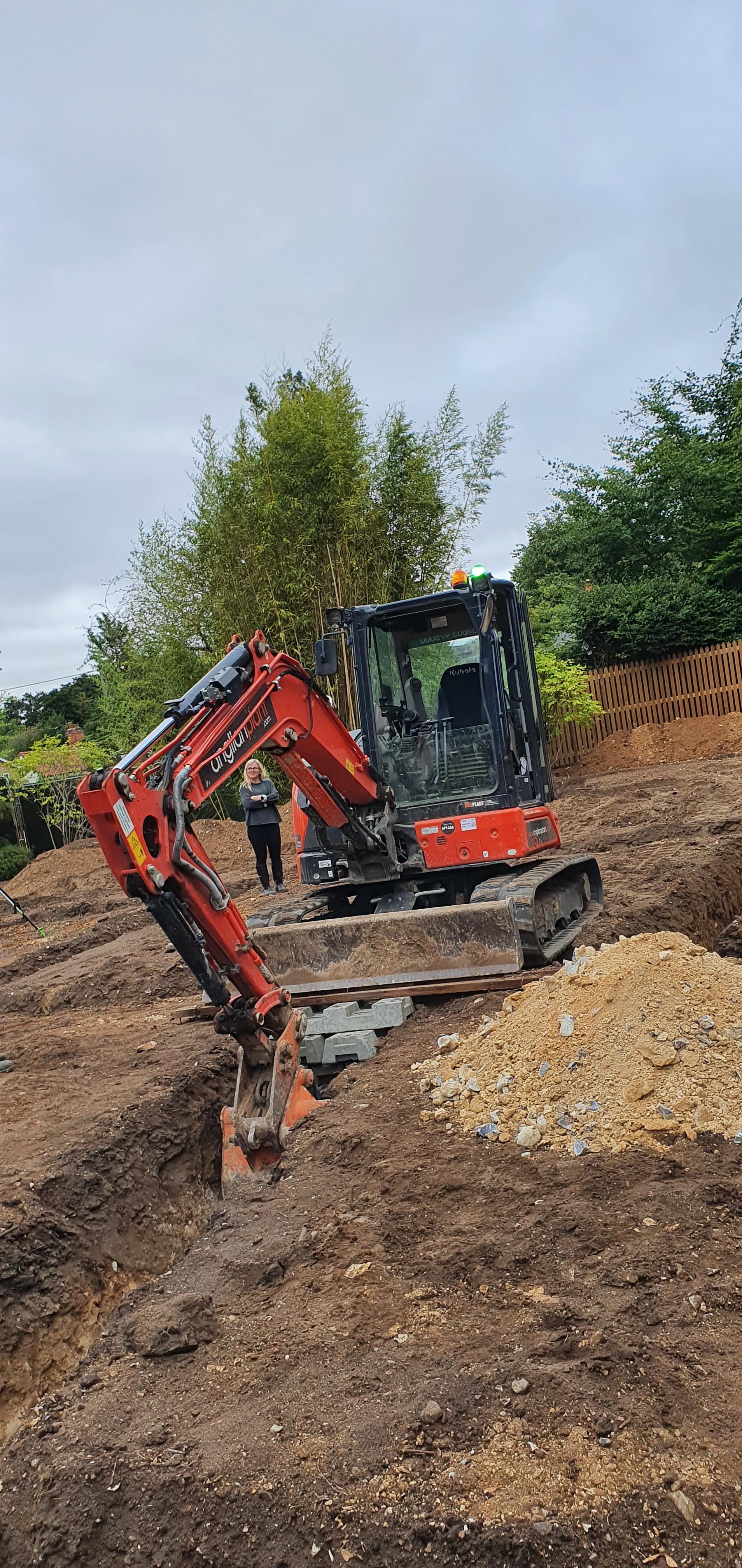

Mulberry View Posted August 26, 2022 Author Posted August 26, 2022 Just now, nod said: It does get easier from here on This time and last I’ve had a torrid time digging out In my humble opinion a 5 tone machine isn’t man enough in tough ground I ended up hiring a dozer to move all the spoil 500 per day for the machine plus 300 per day for the fuel Groundwork’s is the only unknown part of your build The rest should be plain sailing Many others have said that once we're out of the ground, we're in the clear. I took that for granted a bit. The 5T machine has done OK to be honest and I'm grateful that it's a littleun' now that I'm climbing out onto risky precipices. I'm only experienced up to 3T and even that to me is a big machine, so this 5T has been a step out of my comfort zone. The footprint of it is noticeably bigger. It felt far shadier than it looks here. About 2 foot of the rear of the tracks is on soil and the bar was supported on a stack of Heras blocks due to it needing to be directly in line with another trench. We had to pull several like that.
