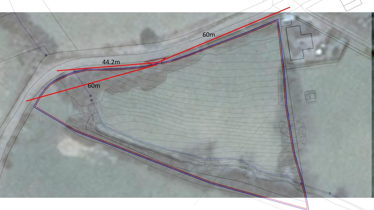

We shouldn’t have any problems with visibility. While there is a bend 43m away on the west side we have clear line of sight all the way around the bend and down the hill especially since I cut all the hedging back. However, the direct line of sight to the bend is under 60m. It’s a 40mph limit road but the traffic is typically going much slower than this so not sure if I ought to take a belts and braces approach and get a traffic survey done. I can get someone out to do a 7 day survey for £450 ex VAT. Any experience in this area?

I have that document. The diagram example is similar  to my situation albeit a small boundary wall follows the edge of the verge to the road rather than cutting across the land. I've done some rough measurements and it seems to be fine. However, my thought was more about doing a traffic survey to show that the speed of the traffic is well below the speed limit especially coming round the bend and up the hill just to cover all bases.
Dont draw a line to the bend. I would draw a line of the required length for a 40mph road (60m?) from your driveway to wherever it meets the road around the bend. Shade the area that would need to be kept clear of obstructions over 1m. In your case it won't be a triangle because of the bend in the road.

Thanks. I wasn’t going to draw a line to the bend on the submitted drawing. The picture above was just for reference. Over the weekend I cut the remaining hedging back to the boundary. I measured 2.4m in from the verge to the midpoint of the drive entrance then 1.05m up from the finished planned ground level and I can see well beyond 60m to the west (towards the bend) and to just over 60m east back up the hill.
