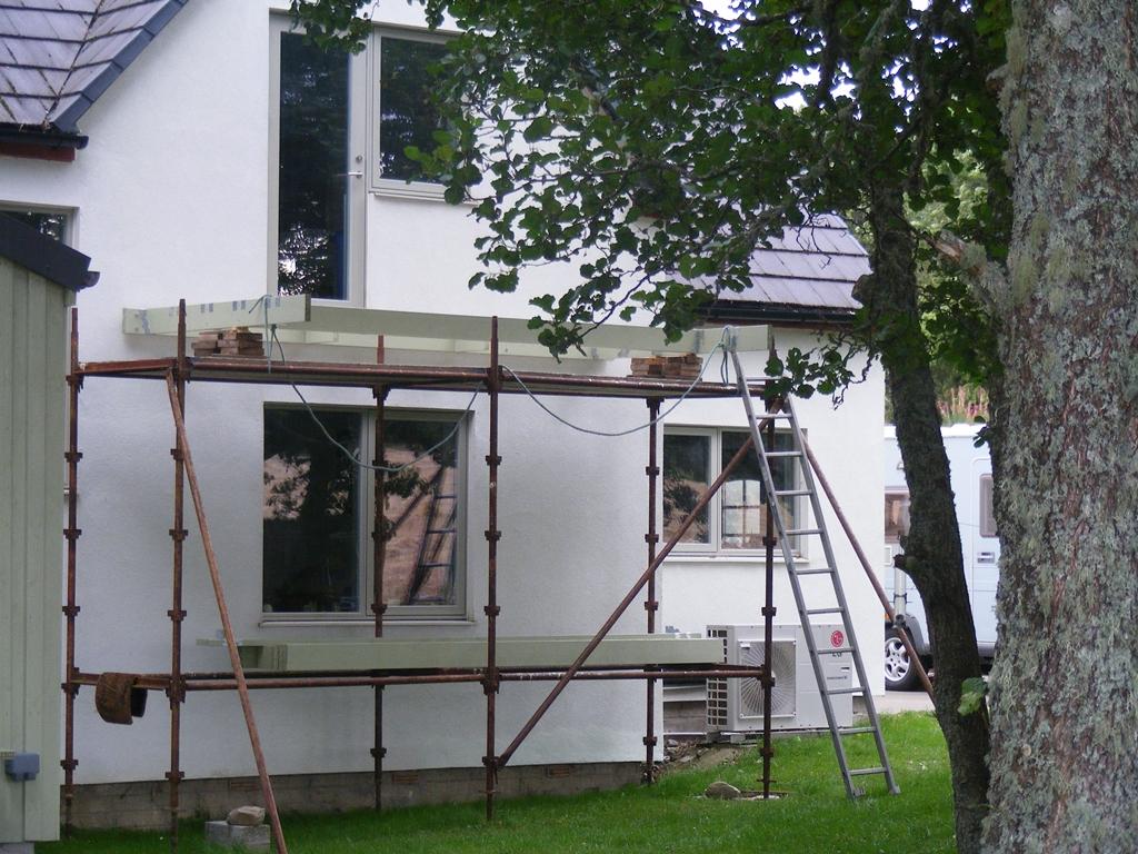

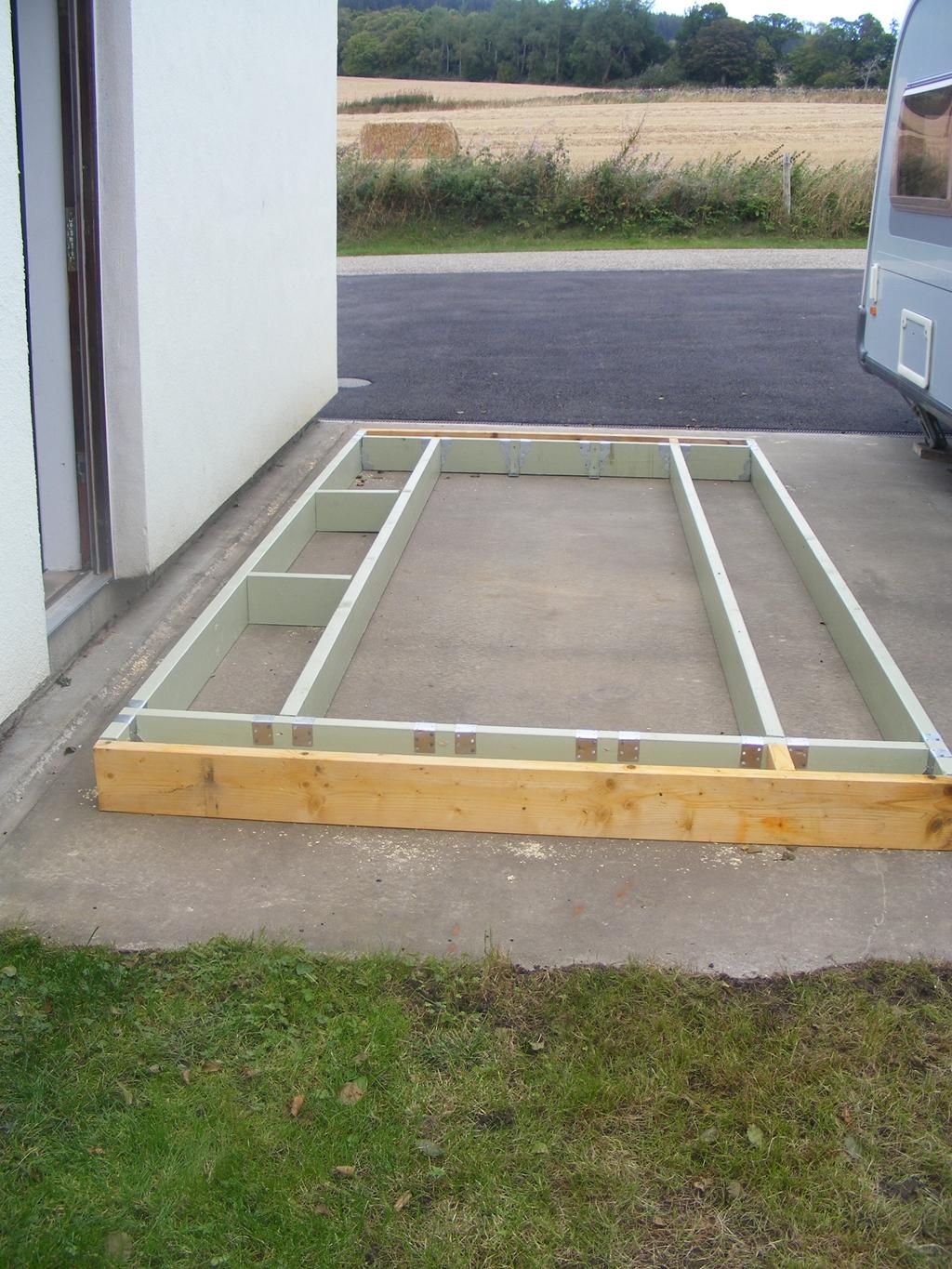

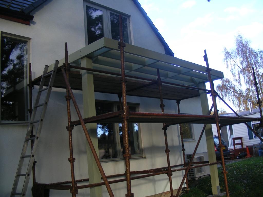

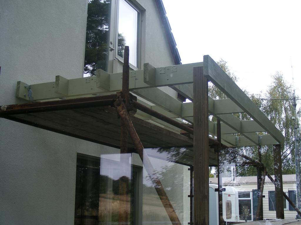

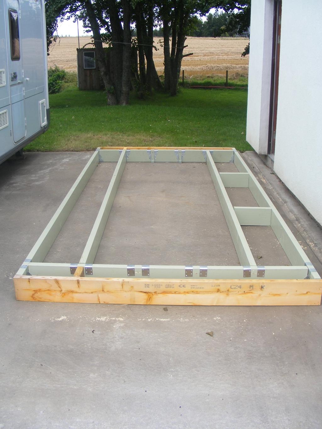

ProDave Posted September 24, 2022 Author Posted September 24, 2022 So tangible progress today. First assembly of the deck frame. this has been a work in progress for a couple of weeks. As soon as I got the timber I cut it all to length so I could get it in the dry, in the static caravan. And then I have been painting, and painting and painting. Each joist will be getting 2 coats. It takes several hours to dry, so all I can do is one coat in the morning, and then later in the day turn it over to paint the other side. And there is room only to do 2 joists at a time. So that's a throughput of 1 painted joist per day. Today there was finally enough painted joists to put most of it together to see if it all fits. That's the first time it has all been put together. Phew, i got the measurements right. The 2 missing long joists are still in the paint shop. The two end joists and most of the remaining dwangs (nogins) are still to start being painted. I have now dismantled it again and re assembled up on the scaffold, jacked it all up into position on packers got it into the exact position above the post support pads and then marked the holes through to the wall ready for drilling and trying my spacer idea. TIP: I am fixing to the wall with M12 long coach screws. I have drilled 13mm holes through the wall joist for this. I find a standard sharpie marker pen is a perfect snug fit in a 13mm hole, perfect to mark through all the hole positions onto the wall. 1 1

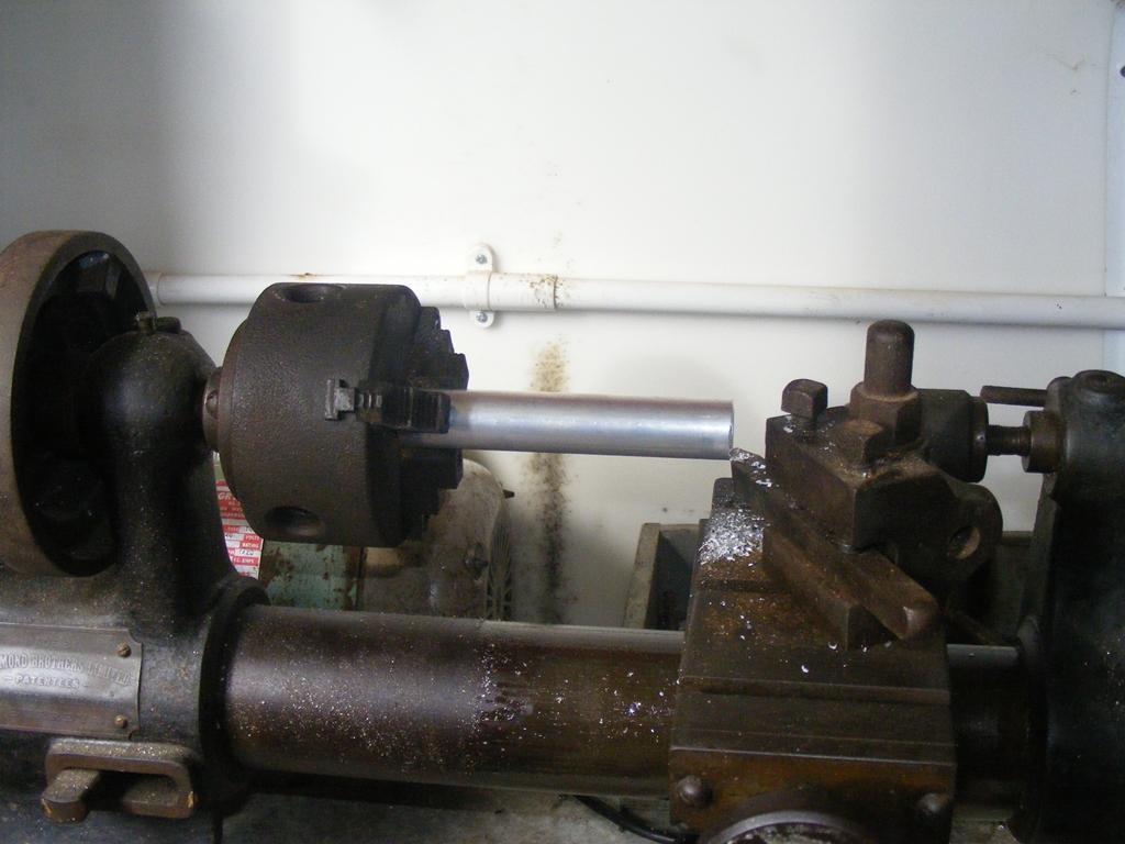

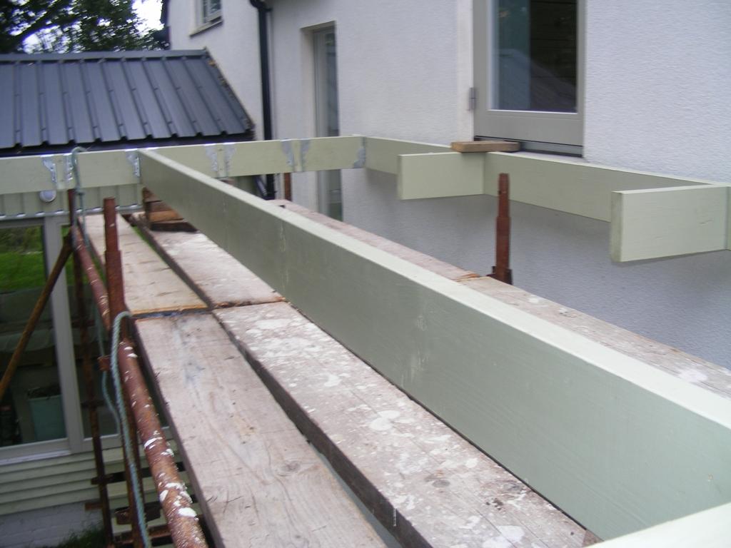

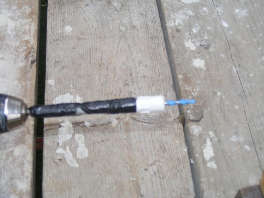

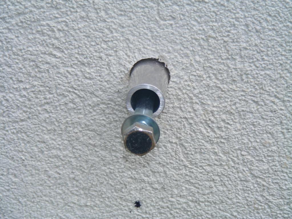

ProDave Posted September 25, 2022 Author Posted September 25, 2022 More progress today. Attaching the frame to the wall. Drill a hole in the wall, drilling through the wood fibre EWI until the solid ring beam is reached. Insert an aluminium spacer and a long coach screw will then fix the timber to the wall. On final assembly that gets lots and lots and lots of sealant in and around that hole. The very good news is the wood fibre I was drilling into is completely bone dry. First time I have done such an exploration since it was put up something like 5 years ago. The spacers were made from aluminium tube, cut to length roughly with a hacksaw and then faced off on my vintage lathe. I needed to drill a pilot hole for the coach screws into the solid wood. The drill bit is a lot smaller than the bore of the spacers and I wanted the hole somewhere close to the middle. Time to improvise, a "jig" made from a spare sealant tube nozzle and duck tape. And here is the basic start of the frame now attached to the wall, the outer edge is supported on packing blocks from the scaffold at the moment. Next thing needed is the posts, and for that I am awaiting post feet. I think my neighbour who runs a steel cladding business is going to make them for me. Meanwhile back to painting the last bits of the frame....... 3

ProDave Posted October 2, 2022 Author Posted October 2, 2022 That's a bit more done. The endless painting has finished (for now) and all the pieces are assembled. Taken from inside the sun room looking up, hence the odd reflections looking through the glass. Awaiting post feet now, I am still not sure if my neighbour is making them or not, I have not heard. Once I have the post feet I can put the posts up, fit the last 2 end joists and remove all the packing and temporary props presently holdin the frame up. Now I turn my thoughts to posts for the balustrades, I think I am settled on 4" posts, which will dictate a wider handrail on top probably just a bit of painted decking board? 1

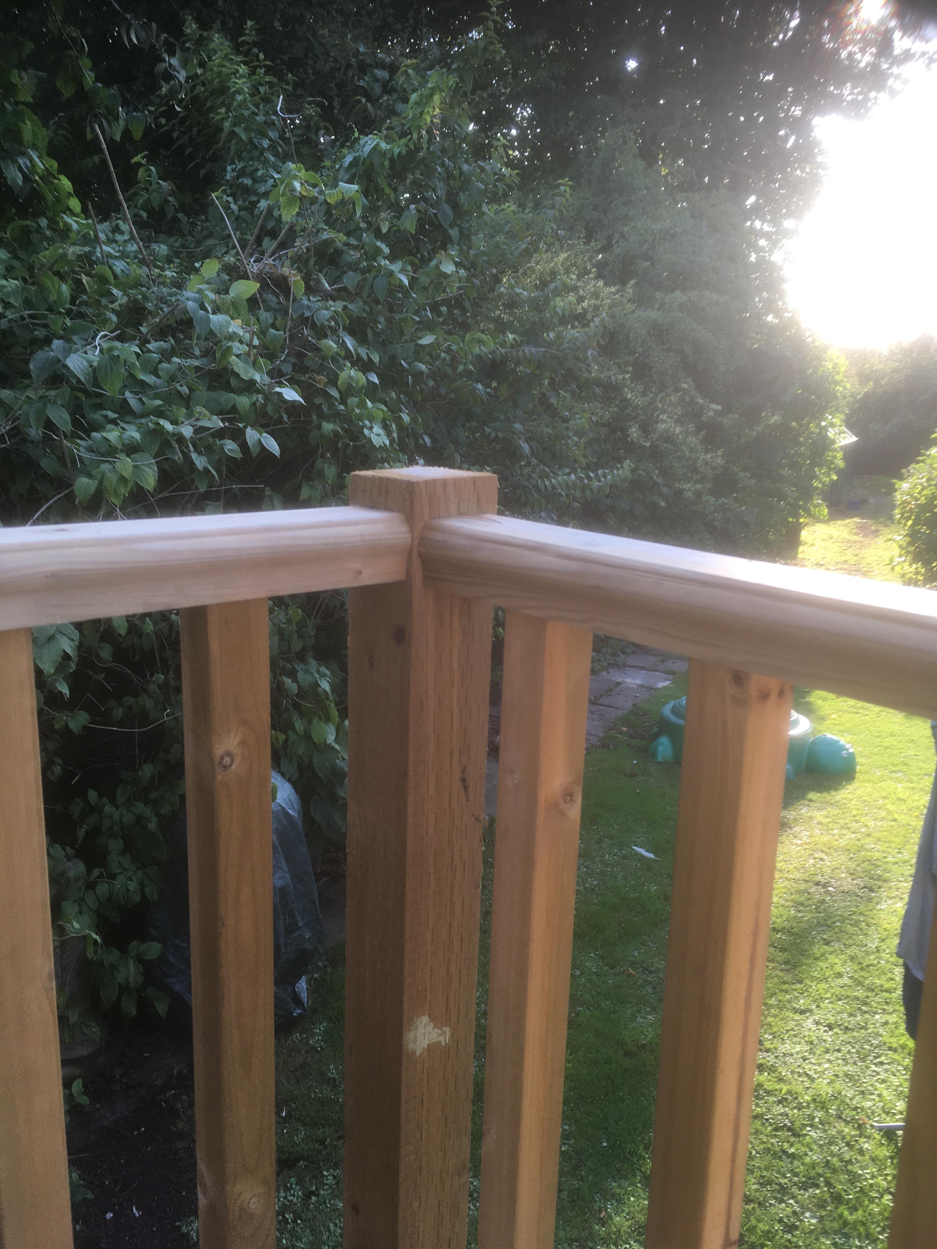

joe90 Posted October 2, 2022 Posted October 2, 2022 On 02/10/2022 at 13:54, ProDave said: Now I turn my thoughts to posts for the balustrades, I think I am settled on 4" posts, which will dictate a wider handrail on top probably just a bit of painted decking board? Expand This is what I did on my brothers decking recently with 4” posts and using standard handrail, the spindles can be replaced with glass if that’s what you want. (My brother is yet to put tops and acorn finials on)
ProDave Posted October 2, 2022 Author Posted October 2, 2022 How did you fix the rails to the posts? screws through the post into the end grain of the rail? I will probably be using steel rigging wire.
joe90 Posted October 2, 2022 Posted October 2, 2022 On 02/10/2022 at 20:54, ProDave said: screws through the post into the end grain of the rail? Expand Yes, two per rail (to stop twisting), countersunk into post with timber plugs to cover, 6” screws approx 3” into rail.

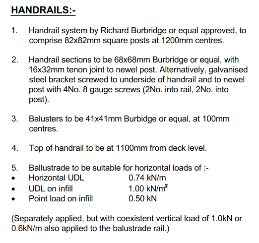

JohnMo Posted October 2, 2022 Posted October 2, 2022 The structural details from our structural engineer
JohnMo Posted October 2, 2022 Posted October 2, 2022 Be careful with fixings in the end grain as the pull out resistance is low.

joe90 Posted October 3, 2022 Posted October 3, 2022 On 02/10/2022 at 21:13, JohnMo said: Be careful with fixings in the end grain as the pull out resistance is low. Expand Hence the reason I used 6” screws with at least 3” into the end grain and two of them (I don’t like brackets showing 🤷♂️).
Radian Posted October 3, 2022 Posted October 3, 2022 On 03/10/2022 at 07:28, joe90 said: Hence the reason I used 6” screws with at least 3” into the end grain and two of them (I don’t like brackets showing 🤷♂️). Expand The brackets don't show because the handrail has a routed rebate for the tops of the spindles and the bracket fits up inside it. At least this is how most off-the-shelf handrails are supplied. Spacers then separate the spindles.

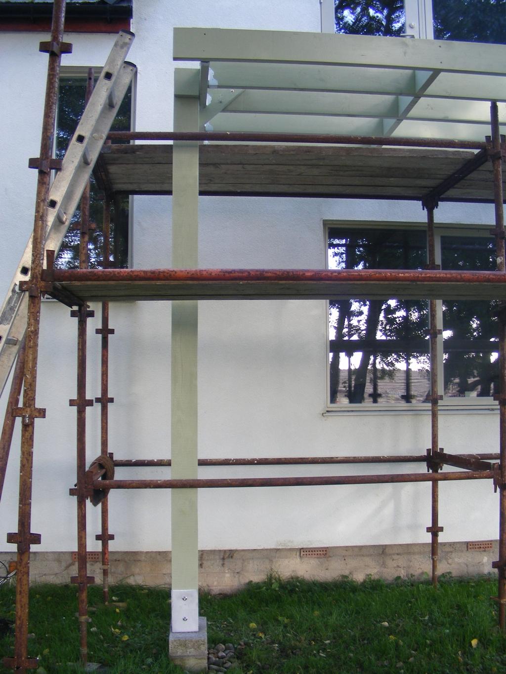

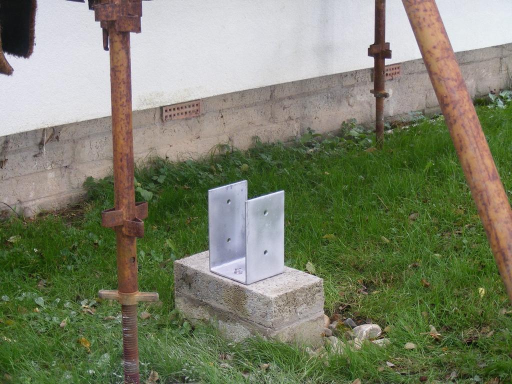

ProDave Posted October 10, 2022 Author Posted October 10, 2022 Yesterday evening my neighbour knocked on the door with two post feet. Today I have fitted them. Studs set in the blocks with resin, nuts not yet tightened down until it has had a good while to set properly. 3

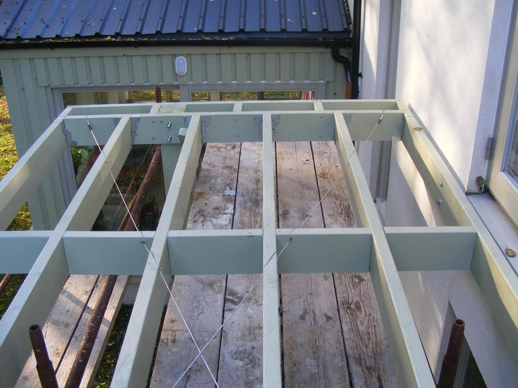

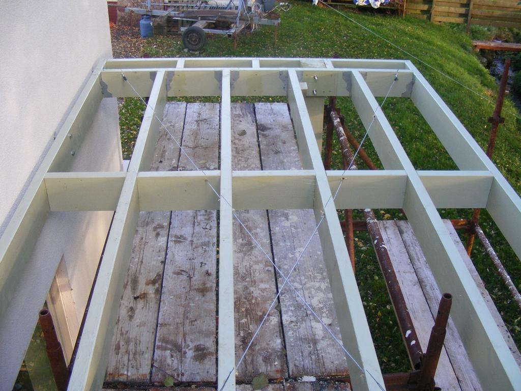

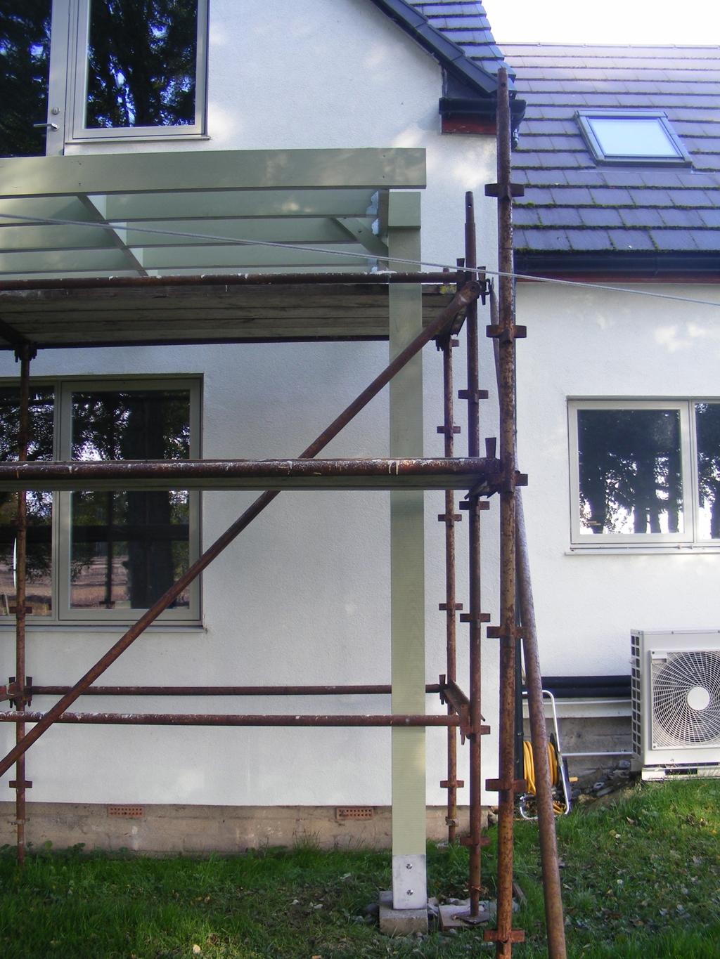

ProDave Posted October 14, 2022 Author Posted October 14, 2022 That's the posts in place, mounted in their post feet, and fixed to the frame with coach bolts. Just the end joists to fit then the long M12 studs and nuts through the two end joists and through the posts. For the first time the balcony is standing on it's own two posts, all the temporary support packing has gone. One issue. it needs some diagonal corner to corner bracing on the frame. As it is, it is just a little wobbly. Adding the decking planks will stiffen it up but I would rather it was solid before the planks are fitted. Ideas please? I could strap say 50 by 25mm battens underneath, but it is so visible from below I feel that would look a bodge. So my idea is two lots of diagonal tensioning with yacht rigging wire that could be drilled through the joists or fitted near the top and notched into the joists. any better ideas?
ProDave Posted October 28, 2022 Author Posted October 28, 2022 A bit more done today, the first chance I have had to do anything on my own house since our break last week. I now have the diagonal bracing wires as discussed before to stiffen the structure, and the final end joists fitted including bolting through the posts. So it is now a solid, self supporting structure. The bracing wire is not as expected. As soon as we got back I ordered a set of the balustrade wire as discussed above to try it out as the bracing wire. Only to find what I had ordered was coming from China and would take at least 3 weeks to get here. Amazon do not make it as clear as ebay that what you are ordering is outside the UK. So what I have used is galvanised aerial lashing wire and hooks, what you normally see strapped round a chimney holding an aerial bracket in place. I had some spare so this saved me waiting for the other stuff. I will be taking the scaffold down soon and doing the remainder working from the balcony structure itself, mainly to stop my ageing boards sitting out in the rain any longer than they have to and get them back into dry storage.

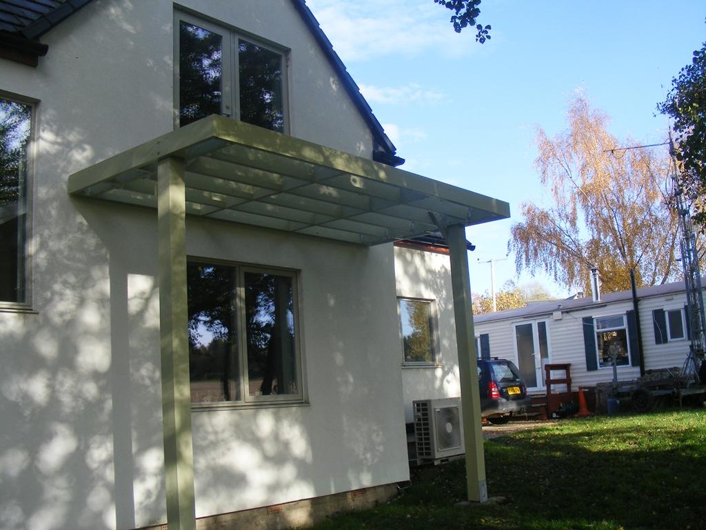

ProDave Posted October 29, 2022 Author Posted October 29, 2022 Scaffold gone, here it is, the balcony frame completed. Just the decking boards and handrail to add. 5
Radian Posted October 29, 2022 Posted October 29, 2022 Looking good! Are the little diagonal braces at the top of the posts really necessary with the deck bolted to the wall? (sorry if this has been asked before)
