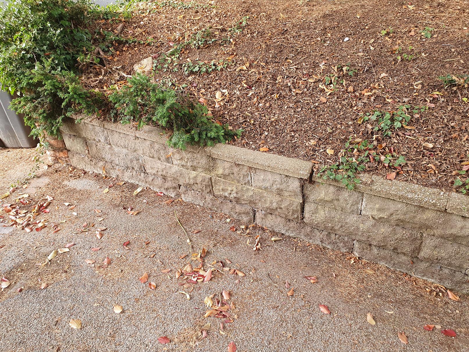

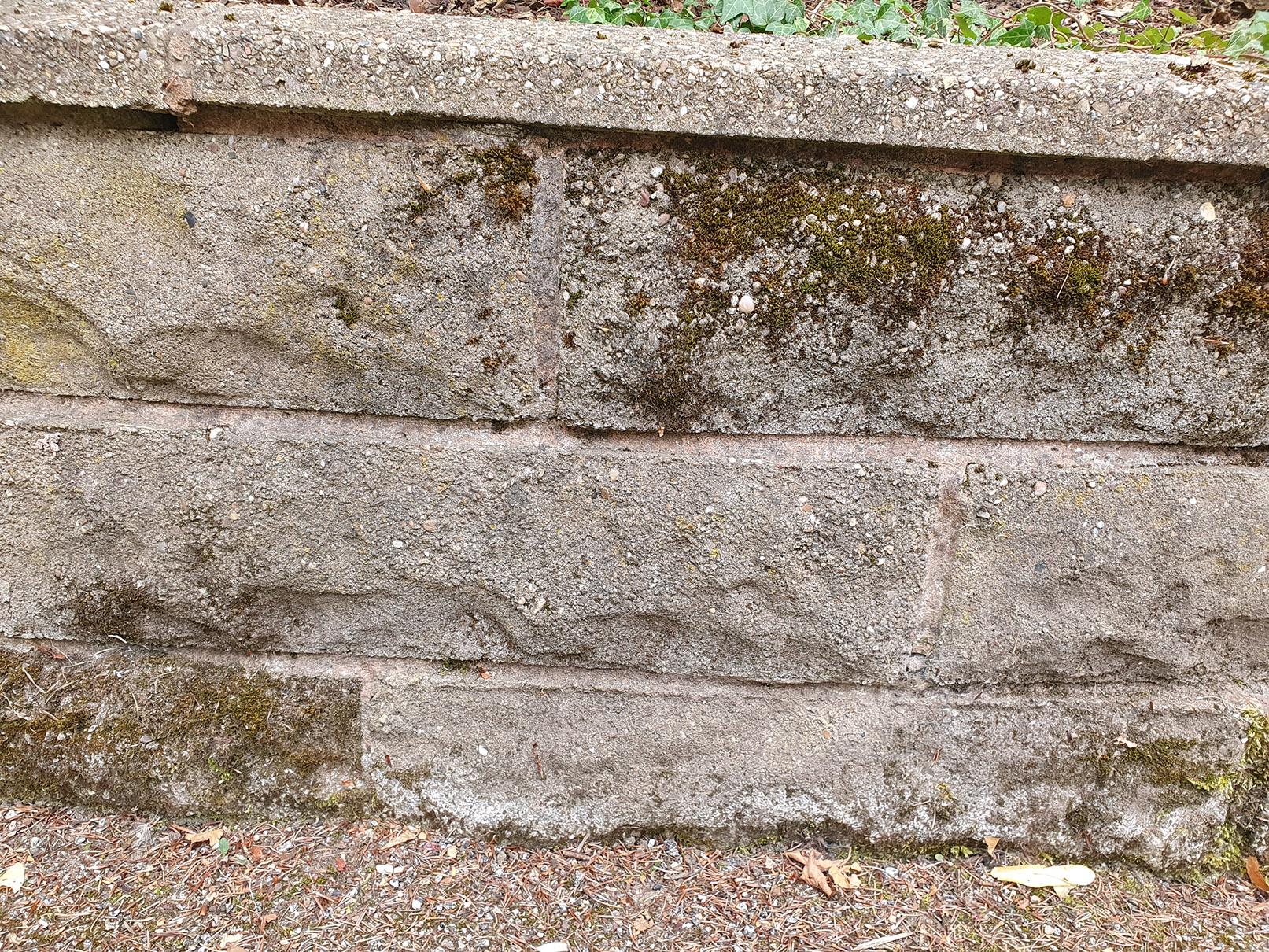

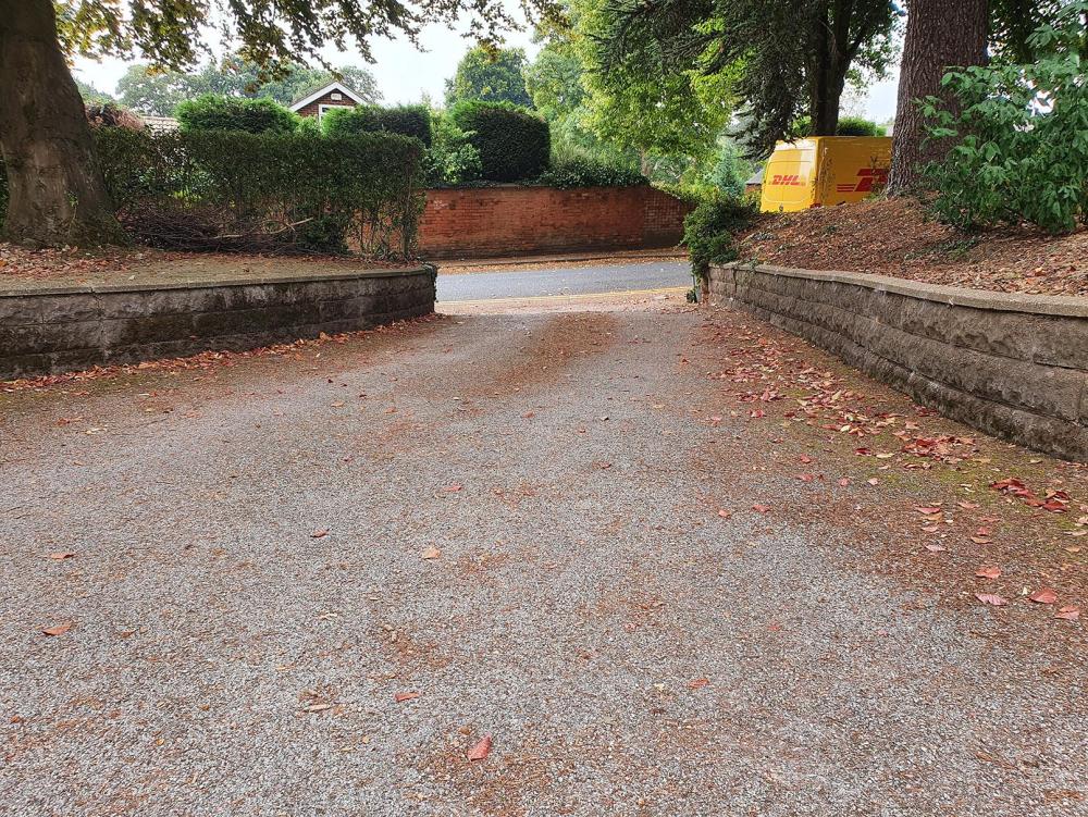

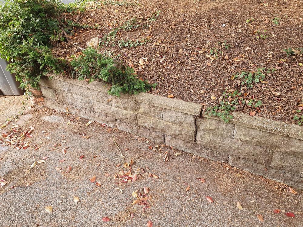

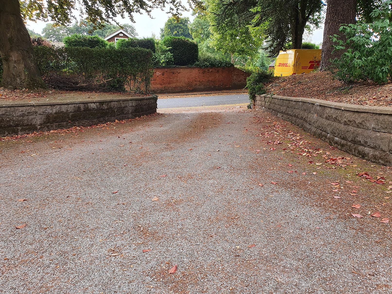

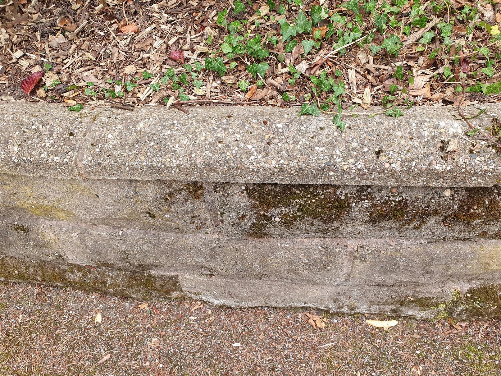

barnesy1977 Posted August 15, 2022 Share Posted August 15, 2022 Hi all, I'm looking for some advice and suggestions on how best to make good quite a long boundary wall. It's an old wall and doesn't look great, but I don't have the funds to completely remove it, and create a nice new one. The total length is 100m (and for info, the ave height ~0.5m), and I've attached some photos. I'm considering using brick slips as these are quite cheap to buy and the labour would be alot less than a complete rebuild (like this https://mybrickwall.co.uk/collections/brick-slips), then add some coping stones on top. Obviously any unstable sections would be dealt with. Does anyone have any experience of this sort of project, or any other good, cost-effective suggestions ? Please - only friendly, helpful/constructive comments : - ) Many thanks in advance Link to comment Share on other sites More sharing options...
Conor Posted August 15, 2022 Share Posted August 15, 2022 (edited) Brick slips won't work as they are put on a flat surface with a thin bed of adhesive. Also, that's a retaining wall, so there is always the risk of water coming through and pushing off any render or adhesives. I'd get the pressure washer out and give it a good clean. Some other suggestions, new coping stones would be easy, consider a contrasting colour to distract from the blocks. Or, you could use strategic planting (climbers or overhanging plants) to camouflage the wall. Lastly, you could fix timber to it and paint. Edited August 15, 2022 by Conor 1 Link to comment Share on other sites More sharing options...
Roundtuit Posted August 15, 2022 Share Posted August 15, 2022 What's it made out of? Stone, or concrete/render made to look like stone? I think I'd just pressure-wash it and repair the section that's moved a bit, and maybe change the coping stones. To use brick slips I suspect you'll have to render first to get a flat surface, and it doesn't really seem worth the hassle. Link to comment Share on other sites More sharing options...

Russell griffiths Posted August 16, 2022 Share Posted August 16, 2022 Sunday morning with a pressure washer, I bet it looks loads better, get the damaged bit rebuilt. Got to be worth a few hours to see how it comes up. 1 Link to comment Share on other sites More sharing options...
barnesy1977 Posted August 16, 2022 Author Share Posted August 16, 2022 Thanks for your replies. It's a concrete wall, but it's partly the miserable dull grey colour that makes the whole house/driveway look tired. We'll try a jetwash anyway to see what that does - I know it can work wonders sometimes. Would still be grateful of any other solutions or experience of similar projects incase jetwashing doesn't work Link to comment Share on other sites More sharing options...

Gone West Posted August 16, 2022 Share Posted August 16, 2022 1 hour ago, barnesy1977 said: Would masonry paint defo work/stay on ok without any problems ? I'm just asking the question really as I have no experience with this sort of things at all. Unlikely. You really need specialist paint for a concrete retaining wall. I used Durbocem on an old concrete block retaining wall in the garden last year and it still looks as good as when it was first painted. There are other manufacturers that have good reviews. https://andrewscoatings.co.uk/shop/interior-exterior-walls/damp-mould/durbocem/ https://www.brewers.co.uk/product/BN6065E 1 Link to comment Share on other sites More sharing options...
Iceverge Posted August 16, 2022 Share Posted August 16, 2022 You're inviting a world of misery on yourself by making the wall more noticeable. As it's beside the drive any clean finish will get filthy immediately and then demand constant upkeep. Before you get tempted try to paint a bit of board white and stand it beside the drive for a few wet days. It'll soon put you off. As said above straighten out the coping stones with a string and a bucket of morter. Give the drive a good brush. Most of our impression of tidiness comes from a neat "floor"! Consider a line of flowers/shrubs on top if you want a bit of colour. 1 Link to comment Share on other sites More sharing options...
markc Posted August 16, 2022 Share Posted August 16, 2022 2 hours ago, barnesy1977 said: Thanks for your replies. It's a concrete wall, but it's partly the miserable dull grey colour that makes the whole house/driveway look tired. We'll try a jetwash anyway to see what that does - I know it can work wonders sometimes. Would still be grateful of any other solutions or experience of similar projects incase jetwashing doesn't work Sorry folks, I really must read a thread before commenting, I saw this and thought it was a poured concrete retaining wall, looking back I now see it’s a block wall and giving way in a number of places. Forget paint or slips, as others have said, good clean and tidy up or you are looking at pulling it out and replacing altogether 1 Link to comment Share on other sites More sharing options...

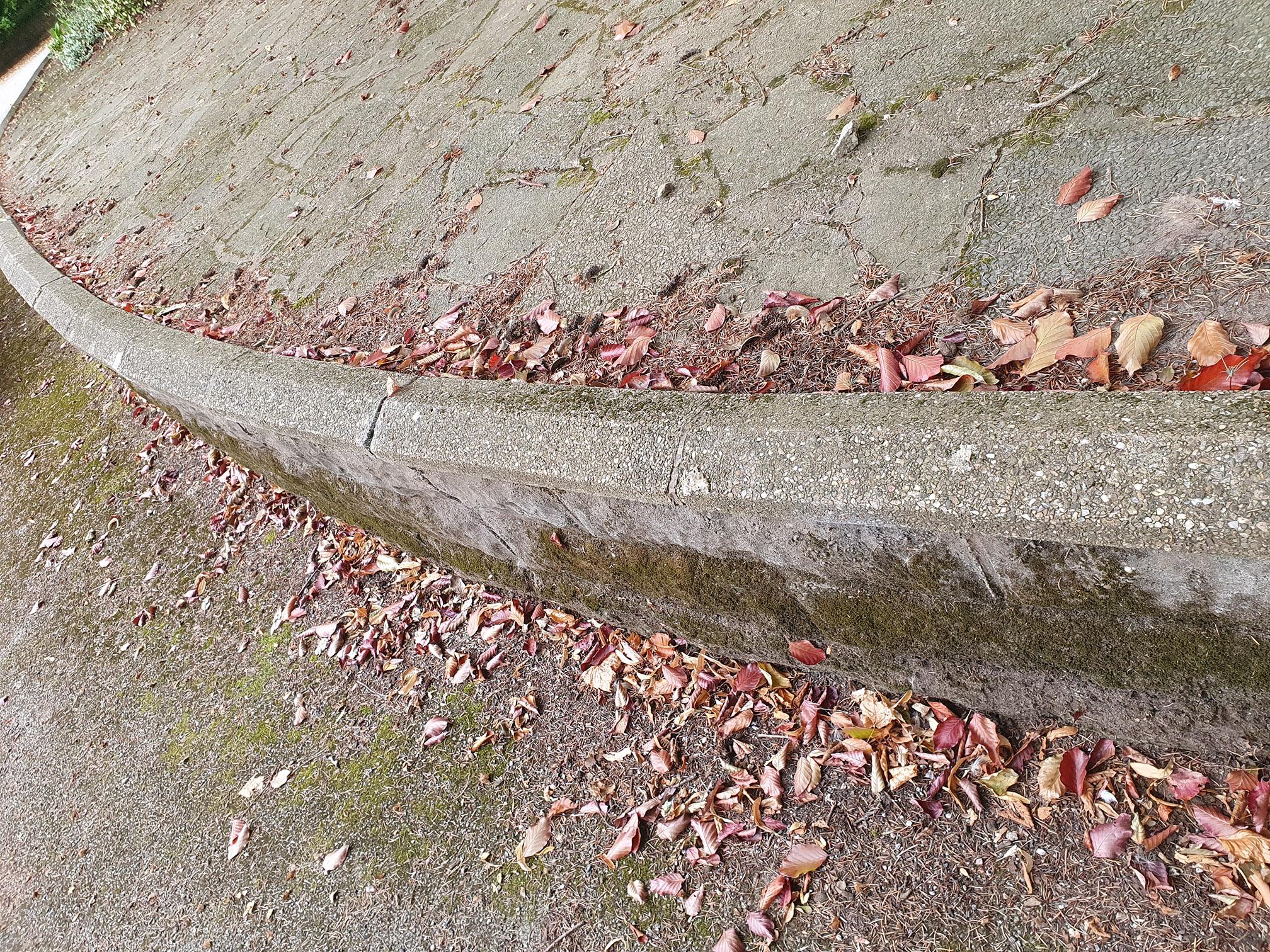

saveasteading Posted August 16, 2022 Share Posted August 16, 2022 It's OK. leave it. If people can't tell if it is concrete or stone then it can't be too bad. I agree with jet wash , repair, and distract, Your beautiful plants will get all the attention. I would also drill some drain holes through the mortar to let water out and reduce pressure that may lean the wall over. as is probably the cause in the last picture. Try through the mortar at the top of the perpend, perhaps every 2nd or 3rd block, and that should be quick and easy. Drill bit as big as the mortar will allow. 2 Link to comment Share on other sites More sharing options...
