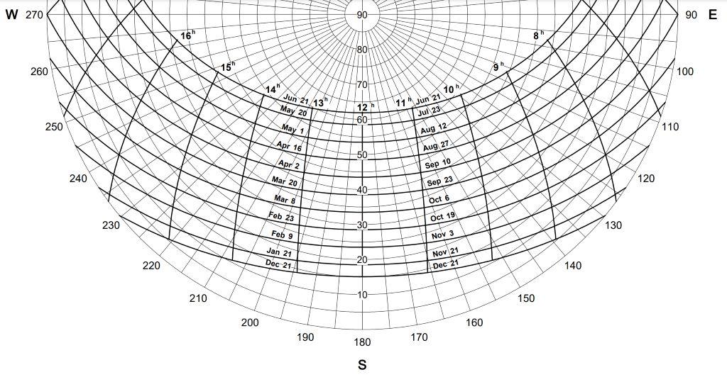

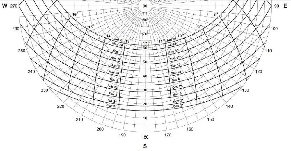

Radian Posted August 14, 2022 Posted August 14, 2022 50 minutes ago, SteamyTea said: Often the reason the modules seem to perform better in the spring and autumn is not temperature, just the altitude of the sun is the same as the roof pitch at noon. Agreed. Altitude of Sun for 51o 30'N (London) astro.ukho.gov.uk: So for the modules to be perpendicular to the Sun on during the Summer Solstice in London they should be inclined at about 28o whereas for the Winter Solstice they should be at 75o to get maximum output when facing South at midday. Anything less than perpendicular will create a loss. So for a 45o pitch roof, April/September will give best results.
