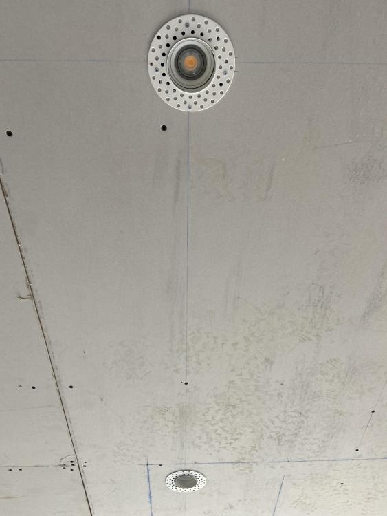

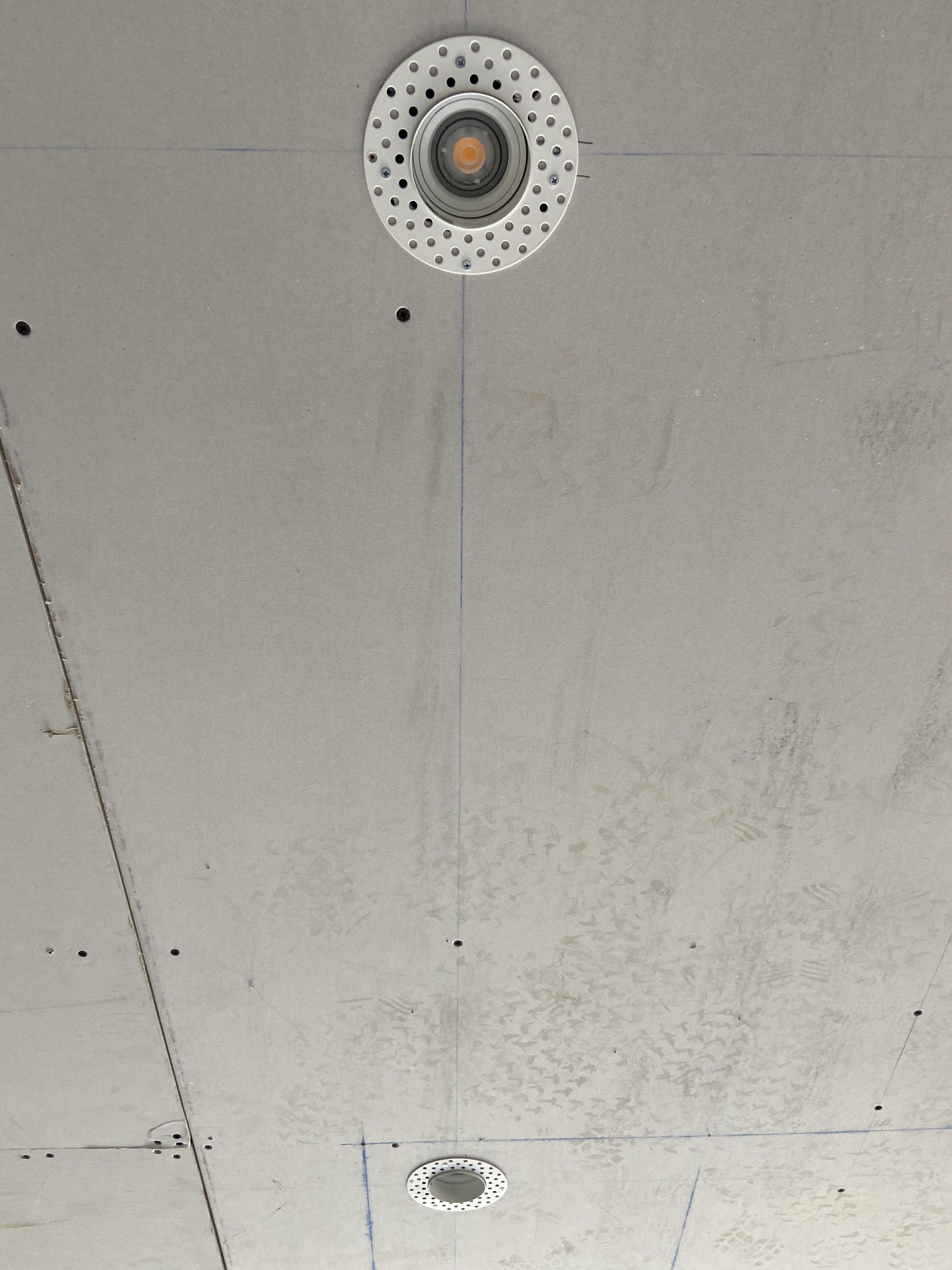

revelation Posted August 14, 2022 Share Posted August 14, 2022 We have had trimless lights fitting. Do they need taping around as you would do joints before skimming. I have attached an image showing the kind of light. If anyone has experience with them that would be much appreciated. Link to comment Share on other sites More sharing options...

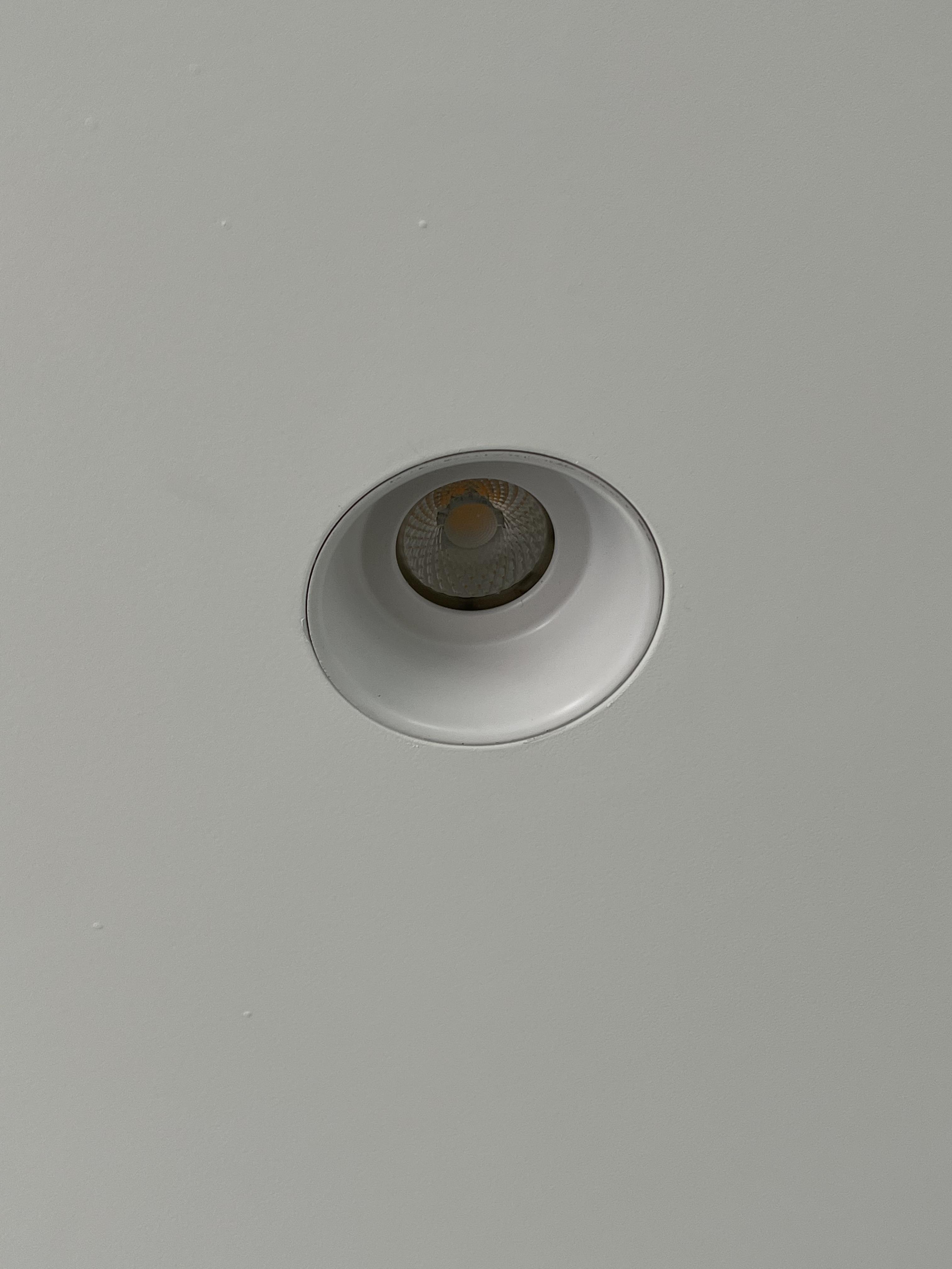

DragsterDriver Posted August 14, 2022 Share Posted August 14, 2022 They come out fine. Make sure the ‘guts’ are stripped out and tell the plasterer slowly and clearly they need to be spotless. Then remind him before he starts 😉 1 Link to comment Share on other sites More sharing options...

Nickfromwales Posted August 14, 2022 Share Posted August 14, 2022 (edited) Have installed a lot of these for my current 2 clients builds. They look a million dollars when skimmed and painted, IMO. I use decorators caulk around the hole, then push the fitting up into the caulk, and fit with a couple of temp screws. I use baby wipes to remove almost all of the displaced caulk and lea e to dry. The screws get removed immediately before plastering. Regarding scrim, I do that every time for belt and 2 braces. Cost = next to zilch so why wouldn’t you ? I apply the scrim around the hole before the caulk and fitting of the light. The tape goes half inside the perforated skirt and half is left exposed to pick up the plaster. I used a bi metal hole saw and cut discs out of foam to use to plug the holes in the light fittings, with the lamp retaining rings still fitted eg so they didn’t go walkeis or get damage in storage. Edited August 14, 2022 by Nickfromwales Link to comment Share on other sites More sharing options...

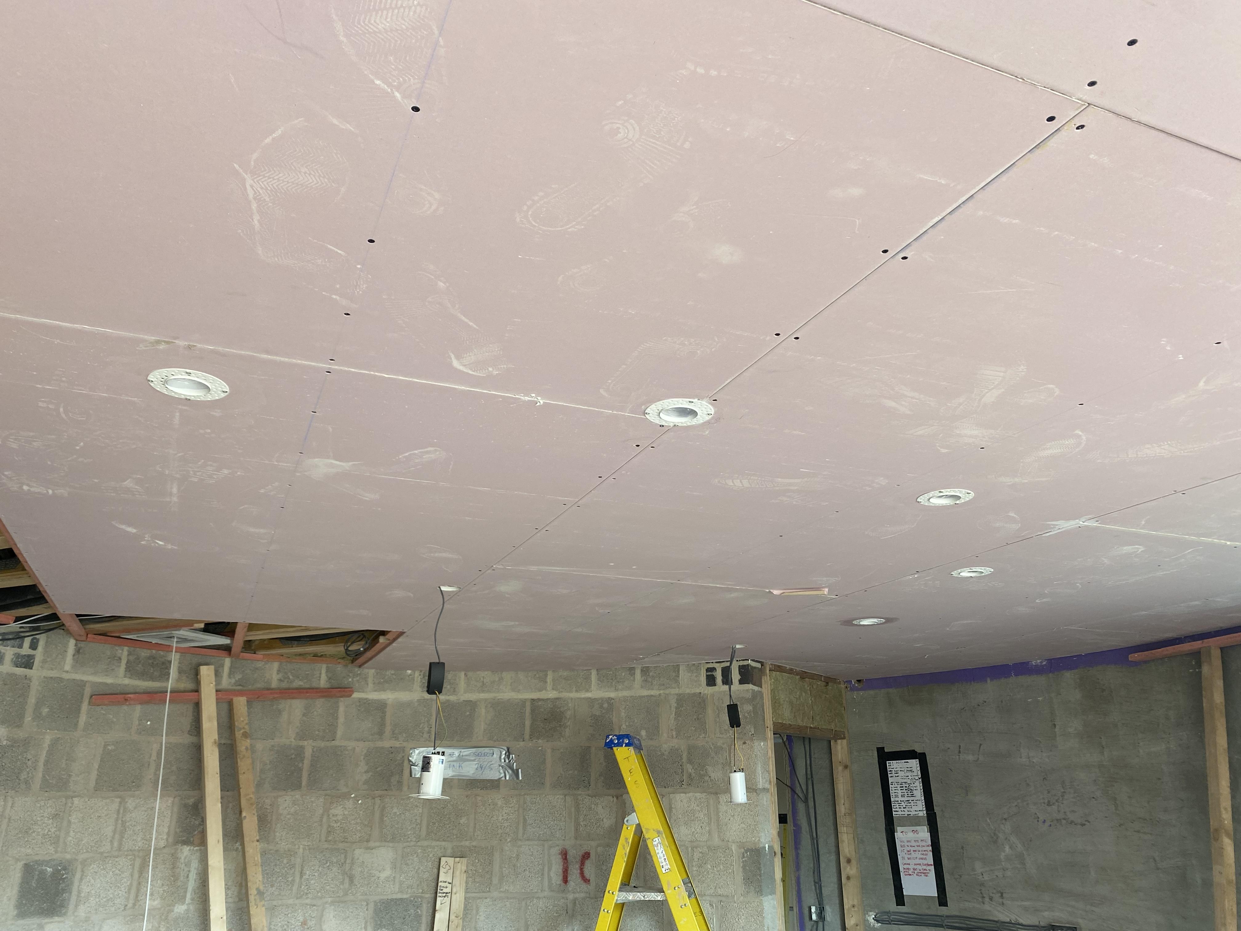

Nickfromwales Posted August 14, 2022 Share Posted August 14, 2022 This one shows the lights caulked, screwed and wiped. Plasterer scrim taped these before skimming, taped before on a previous job iirc but works either way tbh. Screws removed before skimming. Link to comment Share on other sites More sharing options...
Mr Punter Posted August 14, 2022 Share Posted August 14, 2022 5 hours ago, DragsterDriver said: They come out fine. Make sure the ‘guts’ are stripped out and tell the plasterer slowly and clearly they need to be spotless. Then remind him before he starts 😉 That does look very impressive. Could your average sparky, tacker, plasterer and decorator achieve this without messing up and blaming each other? 1 Link to comment Share on other sites More sharing options...
Thorfun Posted August 14, 2022 Share Posted August 14, 2022 2 hours ago, Nickfromwales said: This one shows the lights caulked, screwed and wiped. Plasterer scrim taped these before skimming, taped before on a previous job iirc but works either way tbh. Screws removed before skimming. we're you so happy with how they came out you ended up dancing on the ceiling? Link to comment Share on other sites More sharing options...

Nickfromwales Posted August 14, 2022 Share Posted August 14, 2022 3 hours ago, Mr Punter said: That does look very impressive. Could your average sparky, tacker, plasterer and decorator achieve this without messing up and blaming each other? Plasterer skims flush to the lip, painter rollers straight over. Easy thing to get great results with. Link to comment Share on other sites More sharing options...
revelation Posted August 14, 2022 Author Share Posted August 14, 2022 6 hours ago, Nickfromwales said: Have installed a lot of these for my current 2 clients builds. They look a million dollars when skimmed and painted, IMO. I use decorators caulk around the hole, then push the fitting up into the caulk, and fit with a couple of temp screws. I use baby wipes to remove almost all of the displaced caulk and lea e to dry. The screws get removed immediately before plastering. Regarding scrim, I do that every time for belt and 2 braces. Cost = next to zilch so why wouldn’t you ? I apply the scrim around the hole before the caulk and fitting of the light. The tape goes half inside the perforated skirt and half is left exposed to pick up the plaster. I used a bi metal hole saw and cut discs out of foam to use to plug the holes in the light fittings, with the lamp retaining rings still fitted eg so they didn’t go walkeis or get damage in storage. We did you remove the screws? We didn't use the screws that came with the lights but ones with a slightly smaller and flatter head. We have screws in the light fittings already so should we just scrim on top? Link to comment Share on other sites More sharing options...
markc Posted August 15, 2022 Share Posted August 15, 2022 9 hours ago, revelation said: We did you remove the screws? We didn't use the screws that came with the lights but ones with a slightly smaller and flatter head. We have screws in the light fittings already so should we just scrim on top? You remove the screws to prevent them staining or ‘popping’ the plaster 1 Link to comment Share on other sites More sharing options...
DragsterDriver Posted August 15, 2022 Share Posted August 15, 2022 17 hours ago, Mr Punter said: That does look very impressive. Could your average sparky, tacker, plasterer and decorator achieve this without messing up and blaming each other? Yes but like everything these days you need to explain several times what’s required. Link to comment Share on other sites More sharing options...
Nickfromwales Posted August 15, 2022 Share Posted August 15, 2022 1 hour ago, markc said: You remove the screws to prevent them staining or ‘popping’ the plaster Yup. Plus they do nothing when screwed into 12mm of plasterboard. The caulk holds them rock solid, when completely dry. Screws just come out and get binned. Link to comment Share on other sites More sharing options...
revelation Posted August 15, 2022 Author Share Posted August 15, 2022 8 hours ago, Nickfromwales said: Yup. Plus they do nothing when screwed into 12mm of plasterboard. The caulk holds them rock solid, when completely dry. Screws just come out and get binned. We put pieces of ply on the other side of the plasterboard so the screws had something to bite into on the other side. So it feels like a solid fixing. would you guys say regardless screws are a bad idea? Link to comment Share on other sites More sharing options...
Nickfromwales Posted August 16, 2022 Share Posted August 16, 2022 (edited) 17 hours ago, revelation said: We put pieces of ply on the other side of the plasterboard so the screws had something to bite into on the other side. So it feels like a solid fixing. That's a good job tbh, so defo worth the screws in that instance. Small head screws like No.3.5's leave more coverage for the skim over the screw head so be mindful not to use pan-head etc that's all as you dont want more skim on than the depth of the lip of the fitting ( which is what you're supposed to skim to ). Edited August 16, 2022 by Nickfromwales Link to comment Share on other sites More sharing options...
