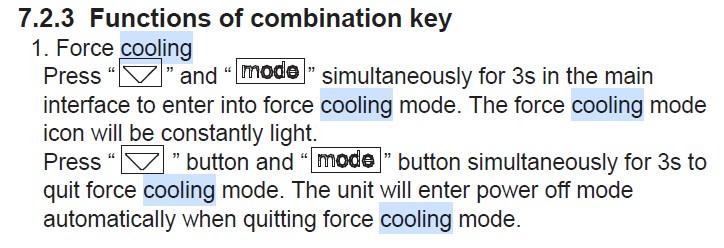

jack Posted June 20 Posted June 20 14 hours ago, ykhan16 said: I have a Midea, model MHC-V12W/D2N8-B. Desperately looking for some way to take the edge of this heatwave so reviving this thread. Anyone able to assist? Engineering and service manuals are available here. See this page for setting cooling mode. Midea is correct that you want to be sure that your system is correctly set up for cooling. 1
ykhan16 Posted June 20 Posted June 20 50 minutes ago, jack said: Engineering and service manuals are available here. See this page for setting cooling mode. Midea is correct that you want to be sure that your system is correctly set up for cooling. Thanks for locating this Jack! Could you clarify what you mean by correctly set up? Is this in terms of what the system components are and how its been installed/piped/wired? [Dont know the ins and outs but we have ASHP, HWC and UFH/radiators for heating and looks like a pretty standard install]. Or did you mean the set up on the controller? Dont want to mess up or break anything..

jack Posted June 20 Posted June 20 1 hour ago, ykhan16 said: Is this in terms of what the system components are and how its been installed/piped/wired? Yes, this. In addition to what @JohnMo says, I imagine your radiators won't do much for cooling, so should probably be turned off during summer (remember to turn them back on before the heating season!) You'll probably need a thermstat for cooling. Most thermostats for heating applications are configured to close (i.e., switch on) when the sensed temperature is below the set point. For cooling you'll want the opposite. I think (but am not 100% sure) that some thermostats can do both. If so, there'll be three electrical terminals: common, NO (normally open) and NC (normally closed). It's possible you can do something manual - i.e., no thermostatic control - by wiring a switch, or better yet a timer, across the cooling demand terminals. Either way, hopefully whatever wiring was used for your current thermostat has at least one spare core so you can use that rather than running another wire. I suggest you post answers to JohnMo's questions and go from there.

Conor Posted June 20 Posted June 20 For cooling just set the thermostat way way up so it never turns off. make sure all of your zones are open, diverter valve in right position, select a sensible flow temp (e.g. 12c) and see how it goes.
jack Posted June 20 Posted June 20 33 minutes ago, Conor said: For cooling just set the thermostat way way up so it never turns off. make sure all of your zones are open, diverter valve in right position, select a sensible flow temp (e.g. 12c) and see how it goes. This won't work in a set-up that has separate terminals for cool and heat demand (which is how mine works). You could temporarily rewire the thermostat across the cool demand terminals summer and do what you say. I don't know that I'd risk having the thermostat wired across both demand terminals. While I'm sure there's probably some sort of priority involved, simultaneously calling for heat and cooling feels like a bad idea!
