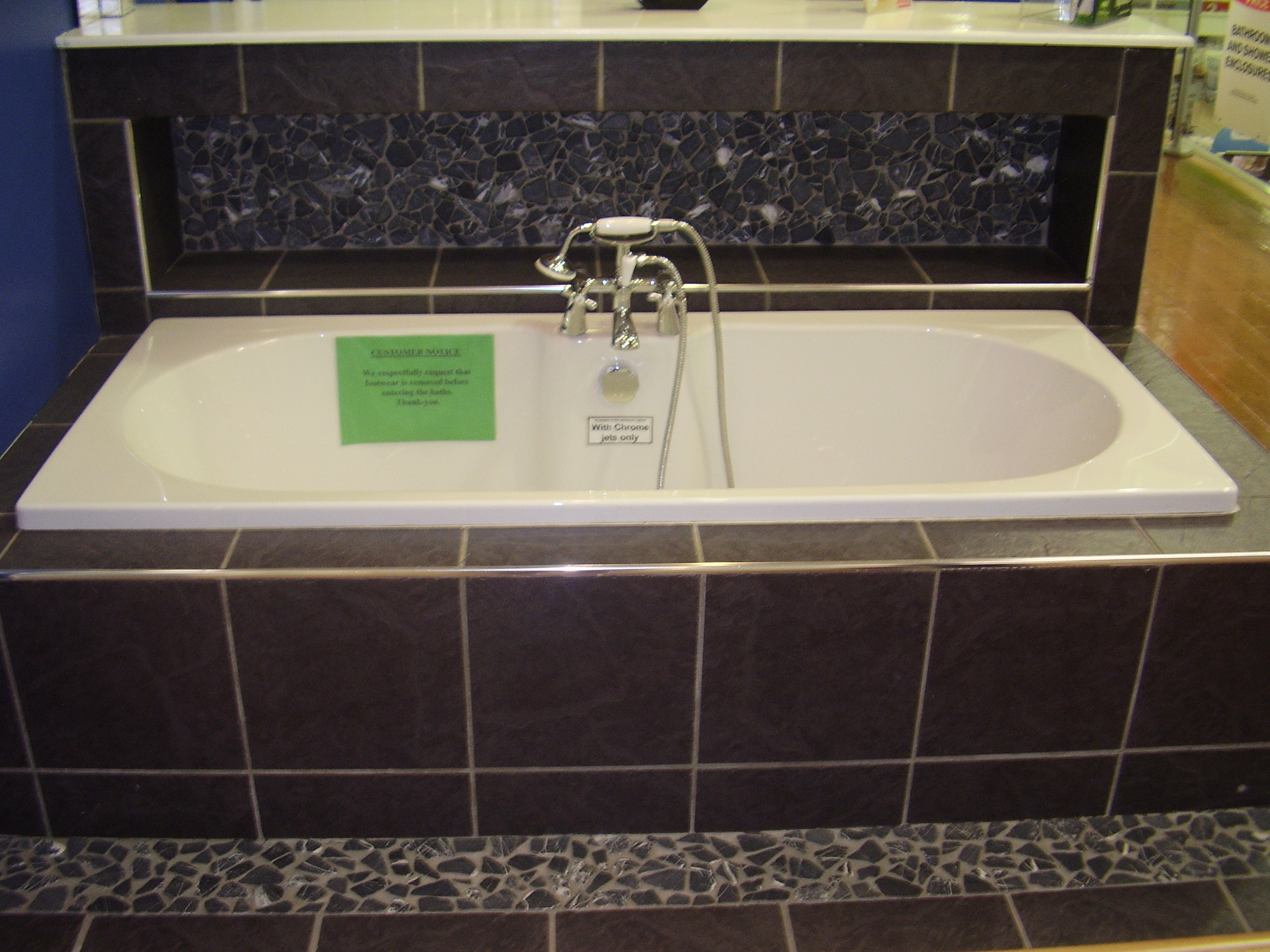

Onoff Posted July 3, 2016 Author Share Posted July 3, 2016 On 01/07/2016 at 09:25, sphannaby said: SWMBO has demanded we try and achieve a sunken look for the bath and I have attached a picture of something she was keen on. You sure it's not the SAME woman! This is what I was given: Link to comment Share on other sites More sharing options...
sphannaby Posted July 4, 2016 Share Posted July 4, 2016 Haha, it could well be. Shelf for beer and Kindle is integral I was informed! Out of interest what size have you made your outside ledge of tiles that the bath will sit on? My tiles are 300*600 so presume I should do it to suit those? Possibly 150 so it is half a tile? Link to comment Share on other sites More sharing options...

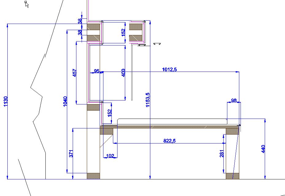

Onoff Posted July 4, 2016 Author Share Posted July 4, 2016 3 hours ago, sphannaby said: Haha, it could well be. Shelf for beer and Kindle is integral I was informed! Out of interest what size have you made your outside ledge of tiles that the bath will sit on? My tiles are 300*600 so presume I should do it to suit those? Possibly 150 so it is half a tile? This was an earlier section but what hasn't changed is the ledge width around the bath, only 100mm. Limited on that width because of room size, doorway etc. The beer/wine will fit so that's the main thing. PM me your email address and I'll link you to my Flickr album where you can look through all my pics that were over on eBuild. That is if you have trouble sleeping..... Link to comment Share on other sites More sharing options...

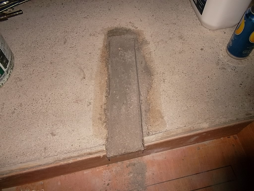

Onoff Posted July 17, 2016 Author Share Posted July 17, 2016 Wanted to tidy up where I'd knocked out the floor for the pump motor support. Mixed up 4:1 sharp sand to cement. Used SBR at 5:1 to mix up. Not the straightest/neatest (might have been the beer's fault) but after a coat of floor paint under there etc. Link to comment Share on other sites More sharing options...
Onoff Posted July 26, 2016 Author Share Posted July 26, 2016 Continuing the saga..... Knocked the floor out and made good in order to sink the motor support bracket: So that fits except the motor caught the side support. Have hacked that about but not very pretty so may re-do. Might even re-think this whole end of the carcass Now then, the feeds. Currently have hot and cold for bath plus mains for sink cold coming down in 15mm (they're not fixed yet). No problem to bend a convoluted length up minimising soldered joints to get from the copper to the bath tap position. I've shown a couple of bits of hose for the sort of line I was going to take with the bath feeds. BUT.....it's too long for flexibles. AND I want some form of easy disconnection should I need to remove the bath ever. IDEALLY I want the disconnections the wall side of the motor bracket: Any suggestions? (IGNORE please the can of SRB hiding in the stud! ) And LASTLY.....I'm having to play with the bath feet as in putting blocks underneath. Using plastic trouser shims just to get it right. These will then sit on the base of the recessed ply box as per second pic above of this post. Whats the norm doing this, just get the height required and make up all in timber? Cheers Link to comment Share on other sites More sharing options...
