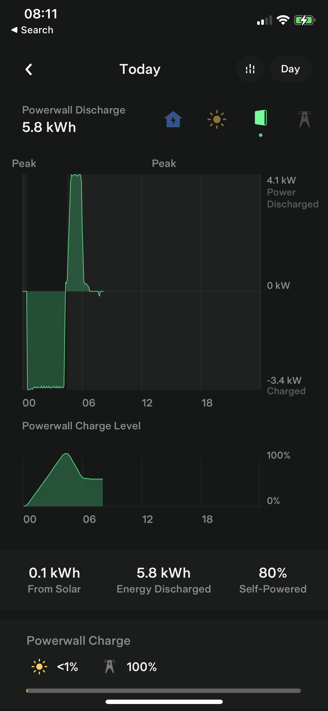

Pocster Posted July 28, 2022 Posted July 28, 2022 Yes . I suspected issues . Now they are confirmed. Best to share the rewards and the pain ! PW charges off SE ( correct I think ) Then greedy SE steals it back - around the loop we go . Even when PW charges from 00:30 to 04:30 SE gets ready to steal !! Talking to installer as we speak ; also notice SE app doing strange ( incorrect ) things . The lovely effect of cloud apps 🙄😞 1
Pocster Posted July 29, 2022 Author Posted July 29, 2022 The SE app has been strange recently. SE is set to only charge from solar and not to discharge between 00:30 and 04:30 otherwise PW grabs it all . This bit works . What SE is doing now I have no idea …. I suspect some firmware balls up on SE side …

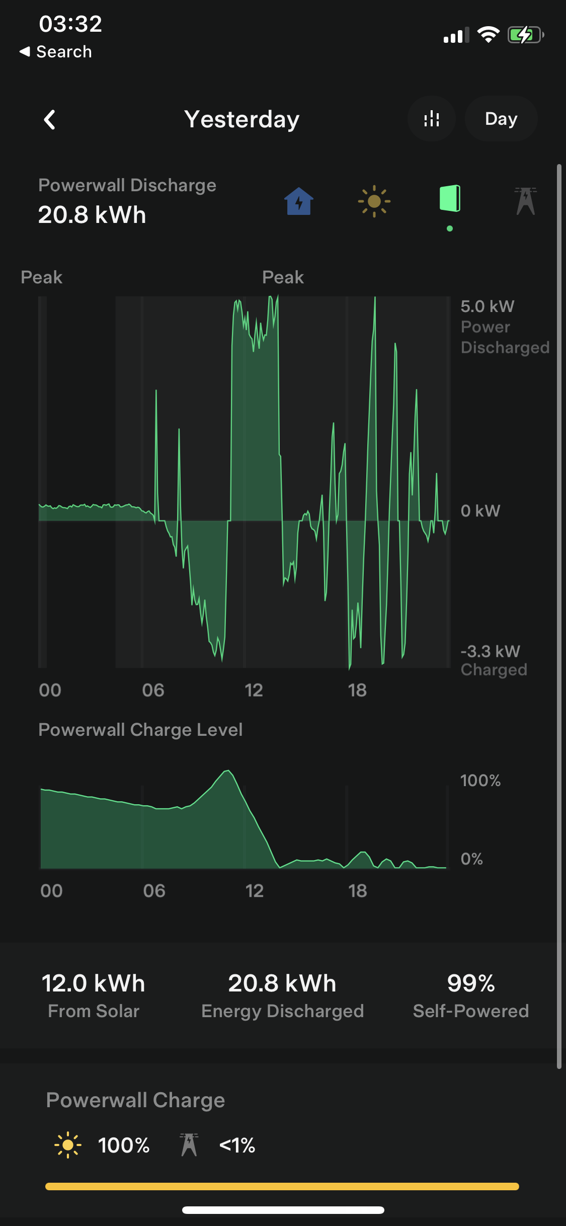

Pocster Posted July 29, 2022 Author Posted July 29, 2022 Apparently installer contacted SE and there are no known issues . So ! I’ll drain the PW into my EV when it’s low . I’ll do this deliberately at the end of the day so SE and PW have no chance of recovering via PV . I’m assuming the same will happen .
Pocster Posted July 30, 2022 Author Posted July 30, 2022 Right ! I’ve been thinking about this ….. I think the default SE option of “ maximise charge/discharge” is incorrect in this situation. Essentially ( I believe ) it means the SE will charge / discharge when it wants . This I’m 100% certain as I have proof means it will steal from the PW for its own needs . The solution to this is set a discharge only option . But that means it can’t charge from PV . So it might require that it charges from PV for most of the day then I change it to discharge only at a certain time . This should stop all the stealing I think . I need to empty SE and PW to test this . For winter I assume telling SE to charge only from the grid at off peak means ( hopefully ) the PW won’t steal from it … Makes sense in my head . Update when theory proven or disproven !

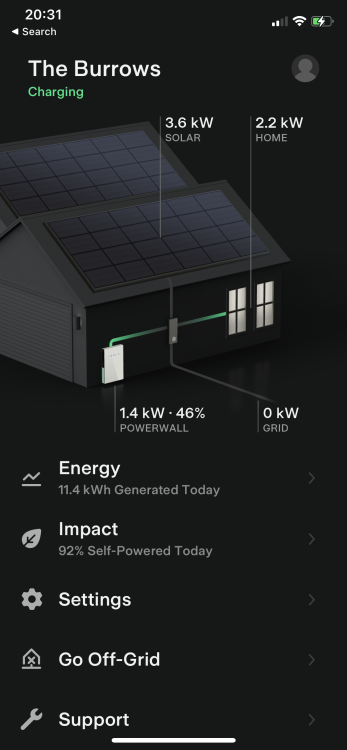

Pocster Posted July 31, 2022 Author Posted July 31, 2022 SWMBO is in with youngest grandson so we are eating kw like there’s no tomorrow. I notice in Tesla app our consumption is 3kwh. This is not possible . SE says solar input is 3kwh . Equally not possible ( SE at 97% ) . It’s stealing from PW !! Quickly go in SE online app set it to discharge only - house load drops to 0.4kwh . There proof !!! Might set SE and PW to both from grid tonight at off peak and see what happens …

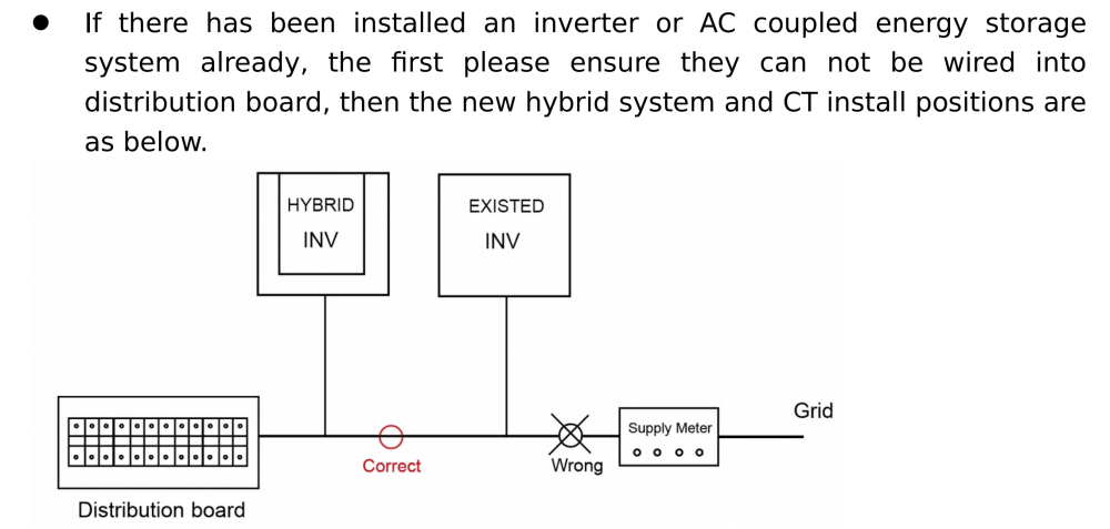

RobLe Posted July 31, 2022 Posted July 31, 2022 So both PW and SE are home batts, and there's no useful software settings on them to prevent interaction? I think the issue is that the combined system is underconstrained. PW presumably has a current clamp on the main Live tail, and is attempting to make the current there zero, using a software feedback loop with likely a PI(proportional + Integral) controller. SE is presumably the same. While you might think they would both sit there doing a similar thing - slowly feeding on PV say, an equally valid solution is for one to discharge into the other, while still overall feeding on PV. I think if the PW clamp were after PW+House+PV, then SE clamp after PW+House+PV+SE that this stops the PW responding to the SE as it can't "see" that current flow. The SE can still respond to the PW - but the overall feedback loop is broken, so I think this might fix it 🙂 One of the home batts will be exercised much more than the other doing this - the way around I described it, the PW will do all of the work until it cannot, being full or empty or having too high power flow, then the SE will mop up the rest. Disclaimer: I'm just a diy-er with ideas above my station 🙂 2
Pocster Posted July 31, 2022 Author Posted July 31, 2022 28 minutes ago, RobLe said: So both PW and SE are home batts, and there's no useful software settings on them to prevent interaction? I think the issue is that the combined system is underconstrained. PW presumably has a current clamp on the main Live tail, and is attempting to make the current there zero, using a software feedback loop with likely a PI(proportional + Integral) controller. SE is presumably the same. While you might think they would both sit there doing a similar thing - slowly feeding on PV say, an equally valid solution is for one to discharge into the other, while still overall feeding on PV. I think if the PW clamp were after PW+House+PV, then SE clamp after PW+House+PV+SE that this stops the PW responding to the SE as it can't "see" that current flow. The SE can still respond to the PW - but the overall feedback loop is broken, so I think this might fix it 🙂 One of the home batts will be exercised much more than the other doing this - the way around I described it, the PW will do all of the work until it cannot, being full or empty or having too high power flow, then the SE will mop up the rest. Disclaimer: I'm just a diy-er with ideas above my station 🙂 Did wonder about the location of the CT clamps . Will try my experiment first 😁
Pocster Posted July 31, 2022 Author Posted July 31, 2022 29 minutes ago, RobLe said: One of the home batts will be exercised much more than the other doing this - the way around I described it, the PW will do all of the work until it cannot, being full or empty or having too high power flow, then the SE will mop up the rest. This is exactly how I expected it to work . SE slave to PW
