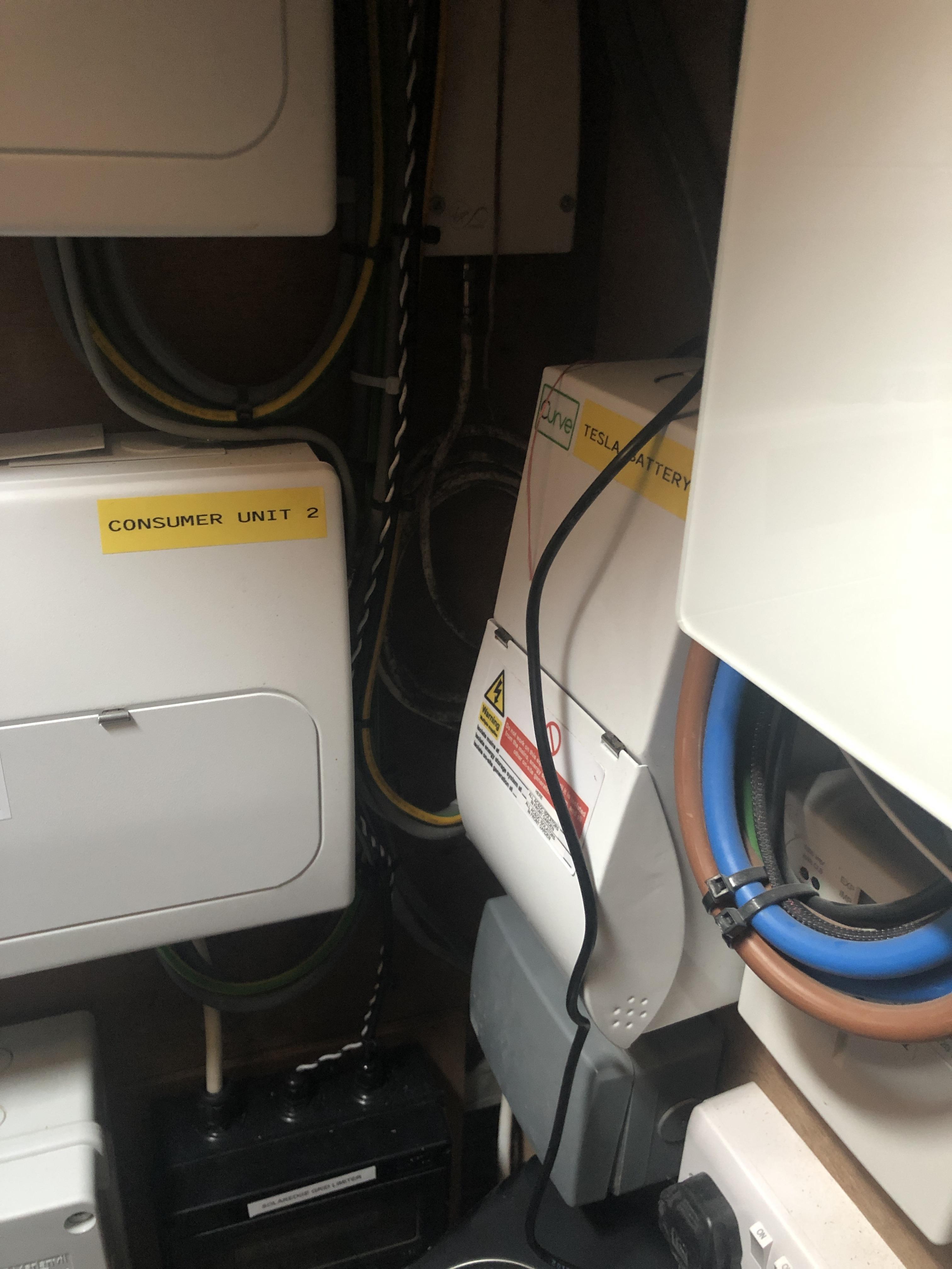

@pocster do you have the Tesla Backup Gateway in your system? I'm still trying to get my head around the actual hardware you've got there.
Yes I do . Obviously I don’t care about outages . Would photos of said wiring / Ct clamps help / confuse  you ?

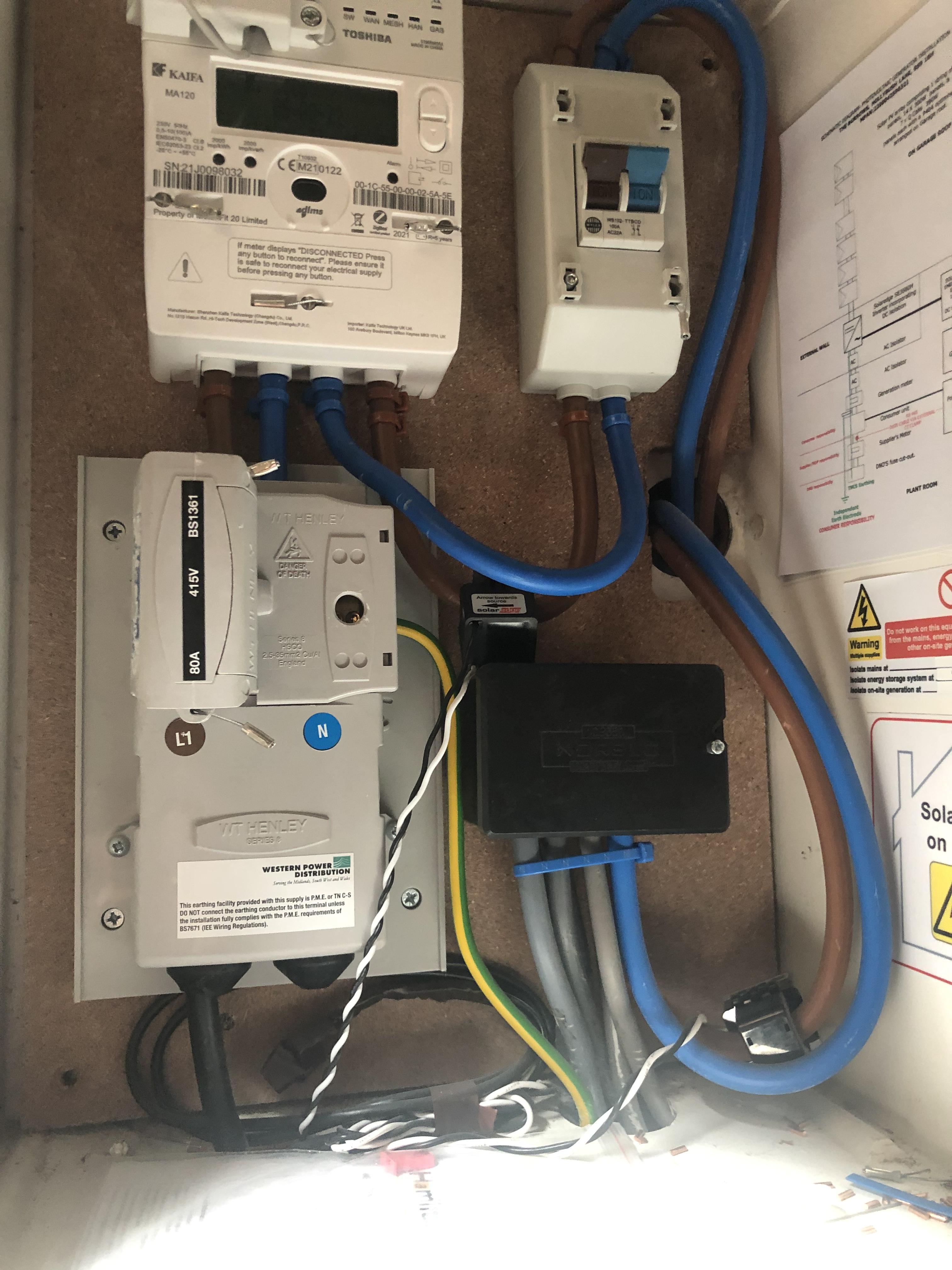

Some photos for you . SE guy came back a week or so ago to just “ do some labelling “ . I didn’t pay any attention- but look ! A schematic!!!!!! 😝

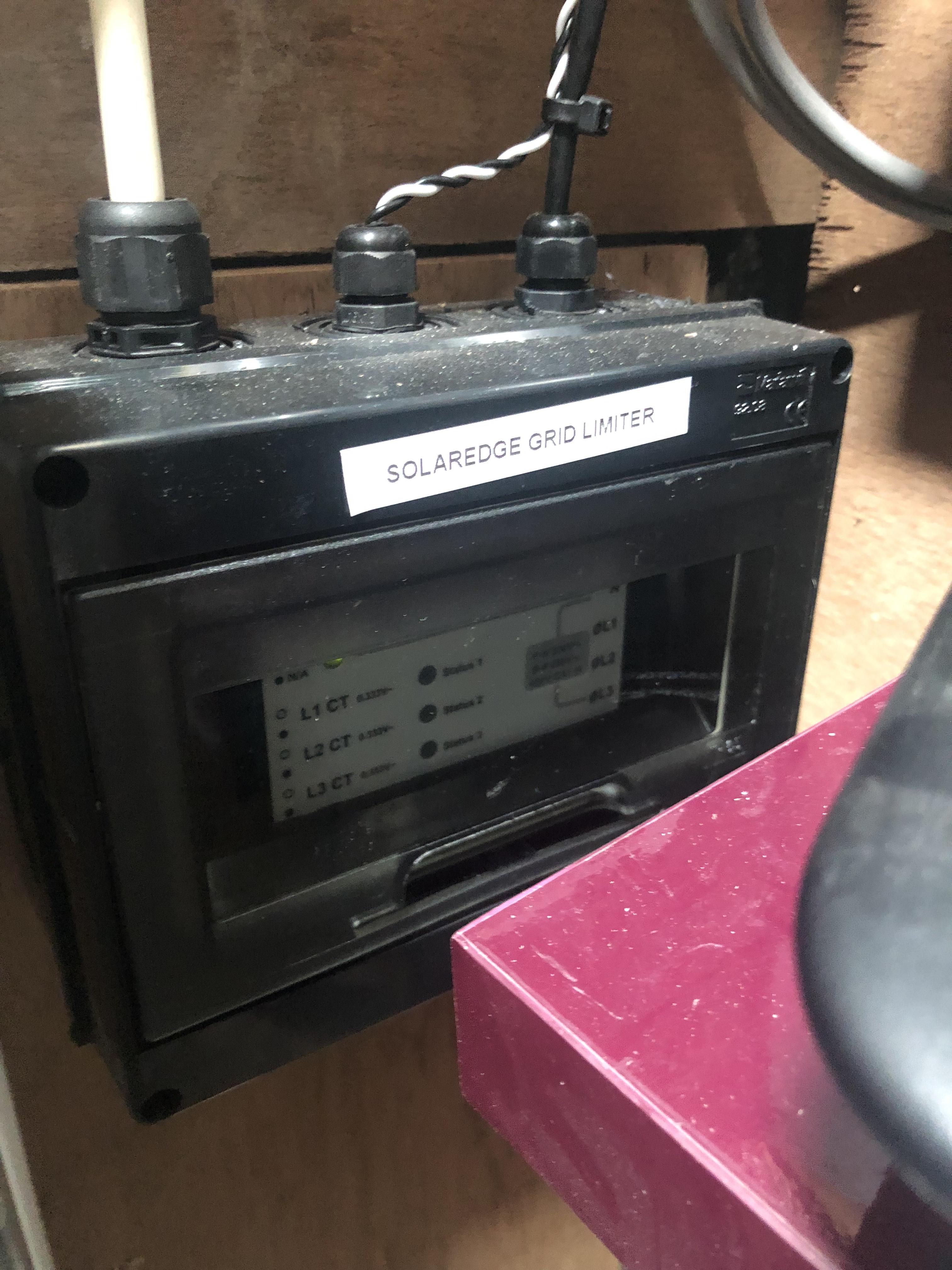

Handy, but your second photo shows a SE grid limiter that's not on the schematic. They've shown the position of the PW CT but not their own. Where is the limiter in relation to everything else?

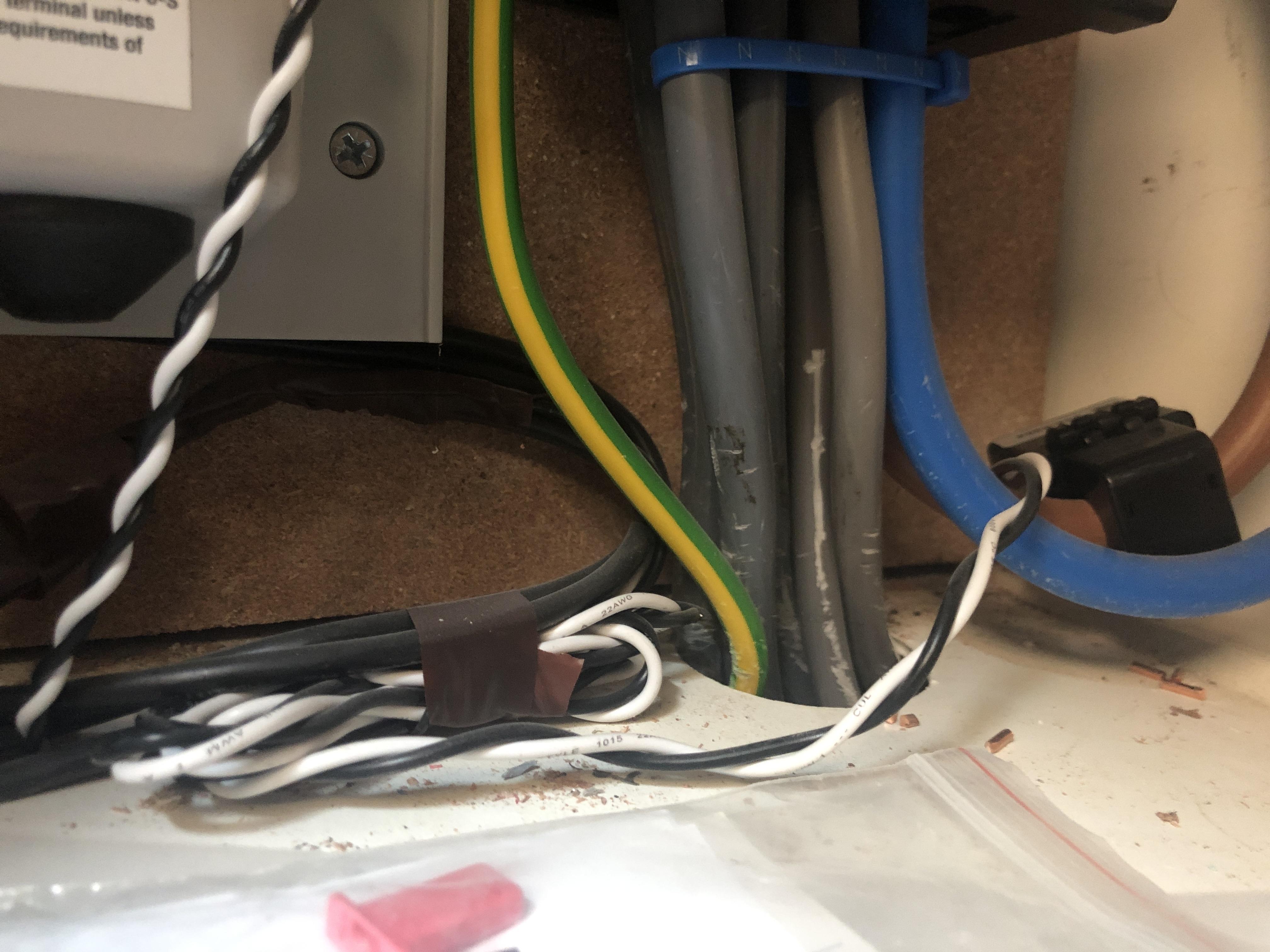

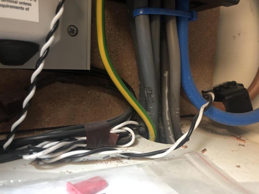

I can only see 2 CT clamps ; is that correct ?
Actually is this CT clamp on the right going no where ????
Where are the Tesla clamps ???
2 hours ago, pocster said:
Not sure how helpful that is .
Where? I can't see any!
I can't tie-up those photos. But doesn't the black/white twisted pair continue up out of the top of the photo?
The black and white from the SE limiter goes up into the consumer unit on the far left ….
You seem to have so much stuff in addition to what's shown on the schematic! It really needs documenting fully. Is the Tesla CT hidden in the consumer unit perhaps? The schematic shows it between the CU and the utility meter.
