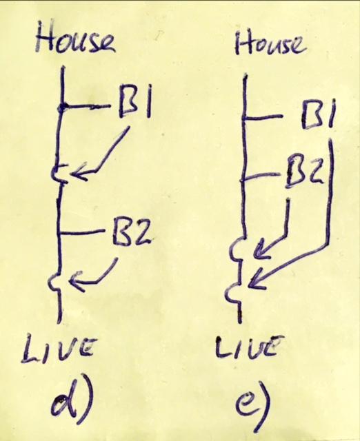

6 hours ago, RobLe said:
You don't need to worry about the voltages - the PW and SE will do all of that complicated stuff with their power electronics and control algorithms.  All you need to know is that the PW is trying to minimise the power flow through its CT; it will put out whatever current at whatever voltage is required to achieve this.
Imagine that you sublet a room in your house, where you had a single power feed in, and there was a PW battery, and a kettle which somebody turned on and off, maybe even a bit of PV.  The PW battery would effectively power the kettle.  You might not even know that they had done this, inside their sublet room.  Then imagine you fitted an SE battery to your whole house - this would work too, but nothing it does will affect the PW operation.
I am still unclear what you are saying here adding the SE without installing some sort of interventions is not going to work?
It's not my house, so I don't know for sure how it's installed...  a piccy of the CTs would help - I think they will be on the same wire, and I would be willing to bet money that it is actually installed like (e) below.  That is, each batt connects to the house consumer unit or a henley block next to the consumer unit.  Then each batt CT connects to the tail (the order of the CTs here makes no difference).  And wiring it like this is the cause of the issue, even though each battery may be individually wired as it's install manual - I'm guessing they haven't considered anybody would be ambitious enough to have 2 batteries.
In contrast, I think that (d) will fix the issue completely.  I'm not changing my mind, it's the same schematic as (c) I did a while back, and also the blurb I wrote some time back.  It is clear to me, although I'm having trouble convincing the internet!
If the PW and SE are wired in series, as (d) above, I think that they both will work.  When the sun shines, PW will gobble it up assuming PW=B1 in (d).  It's not a voltage thing, it's just where it's CT is positioned that matters.  When the kettle is on, the PW will provide.  When there is too much sun, the PW will be full and stop taking power.... then the SE will fill up.  If the PW were to fully empty, then the SE would get a chance to power something.
It might not be quite as above, as the PW can also be controlled by Tesla(?) - I think Tesla might tell it to power the grid sometimes and pay you for it - eg via Octopus "Tesla Tariff".   This could screw up if so, as SE will immediately thwart that behaviour, absorbing that power.  You might be better off with SE on the inner loop, so PW can discharge into the grid if you want that to actually work(don't bother if you don't want this!).  You'll also need to make sure any night battery charging times are synchronised between PW and SE.  Eg if PW charges in the middle of the night from the grid, but SE isn't programmed to do that, then SE will charge PW, which is inefficient.
By and large though I think d) is good..

I think with the symmetric scheme where each batt has a CT with 2 wires through it in order to negate the other battery current flow, and a 2kW kettle turns on, then:
Batt1 will provide 2kW
Batt2 will provide 2kW
So yes, the kettle will be powered by the batteries.  But then the main tail will export 2kW, surely not wanted?

No. During peak hours both battery system's aim should be to provide power in preference to importing it. To do this they look at magnitude and direction of power through their respective CTs and modulate their output to keep it to zero. Power thus flows from both battery systems into the kettle load, possibly a little lopsidedly but not massively so. Roughly 1kW therefore flows into the kettle from each and nothing to the grid.
You're suggestion that both will deliver 2kW 'come what may' might be based on your thinking that each system can't see the other's contribution. Indeed they can't. All they can see is the same house load drawing on the grid so both raise their outputs to compensate. This is where differences in control loops might become apparent but as they both see the same power flow to or from the grid, they will not blindly raise their outputs and start exporting (or importing).
