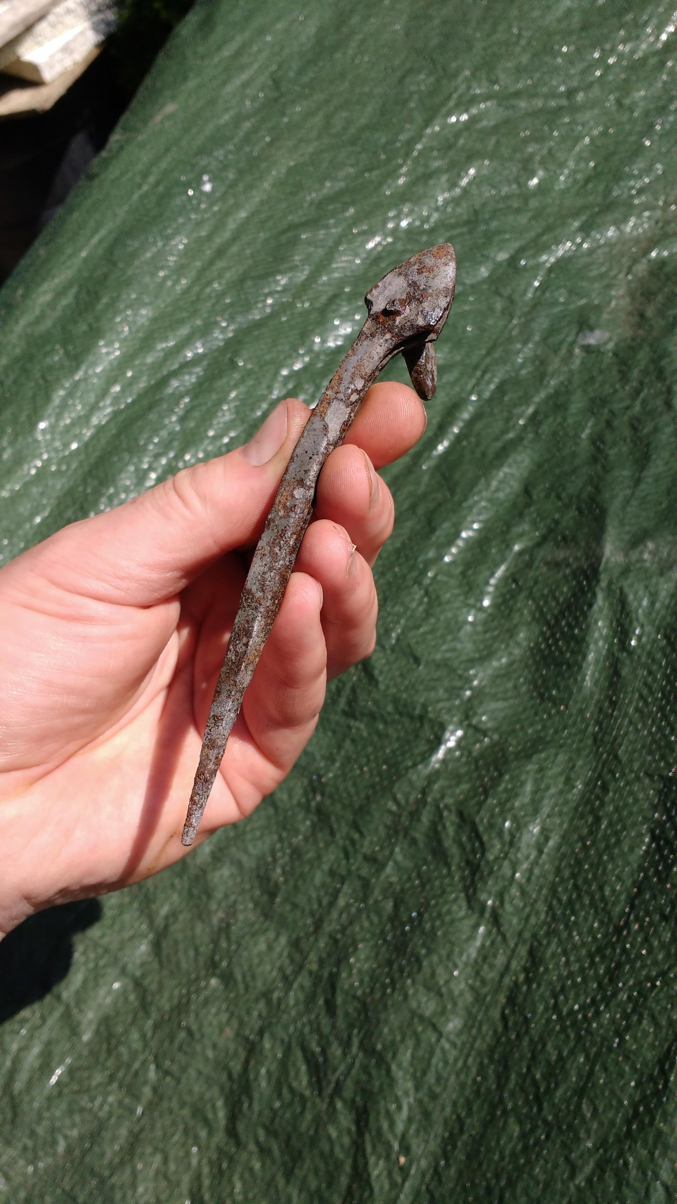

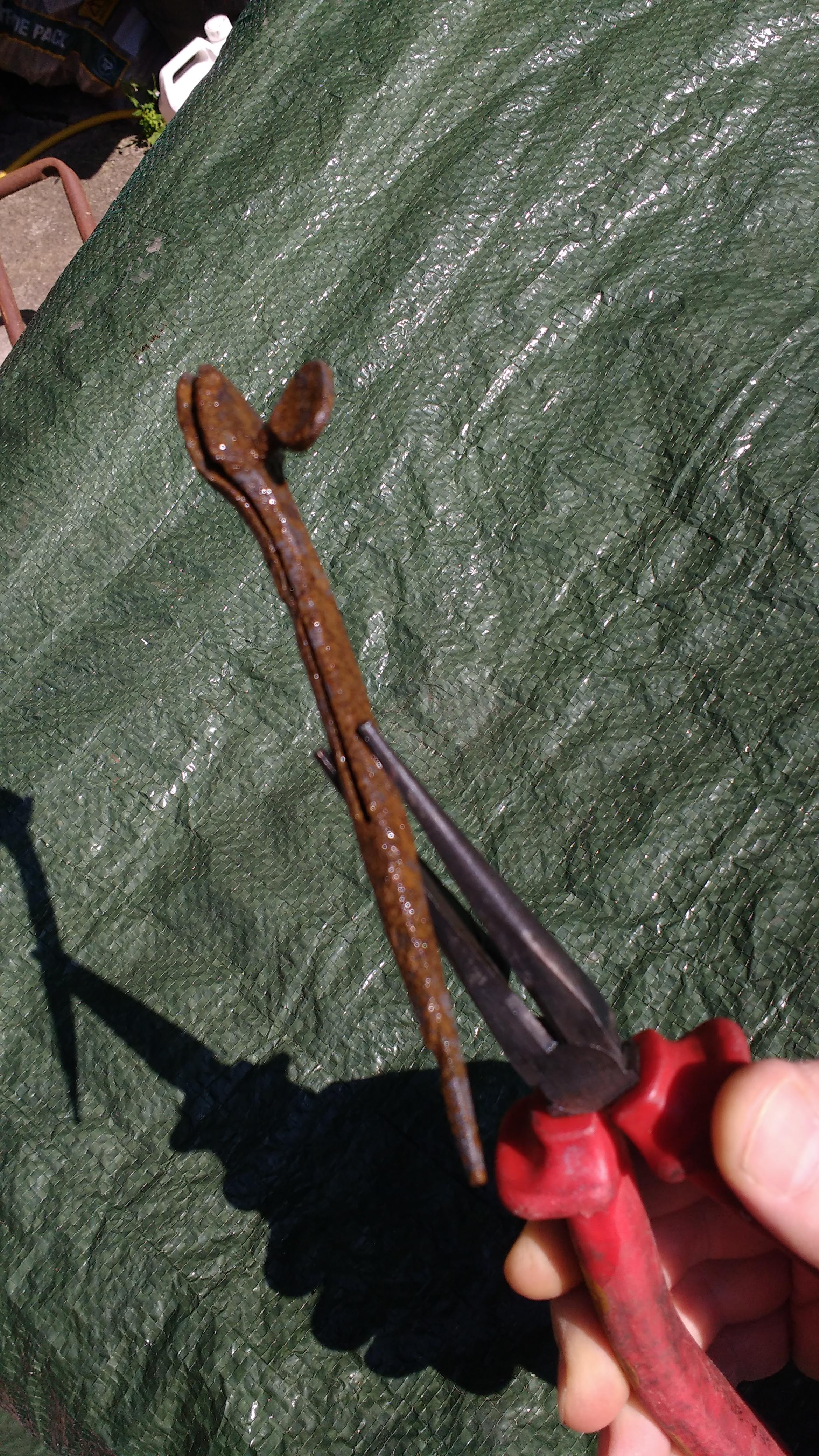

Onoff Posted August 22, 2019 Author Posted August 22, 2019 A vintage, leather worker's stitch marker. In at 13.15hrs: Out for a look see at 13.45hrs: Leaving it in hoping the adjuster screw will loosen up. Tbh it looks like it should be behind glass in a museum!

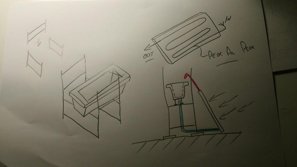

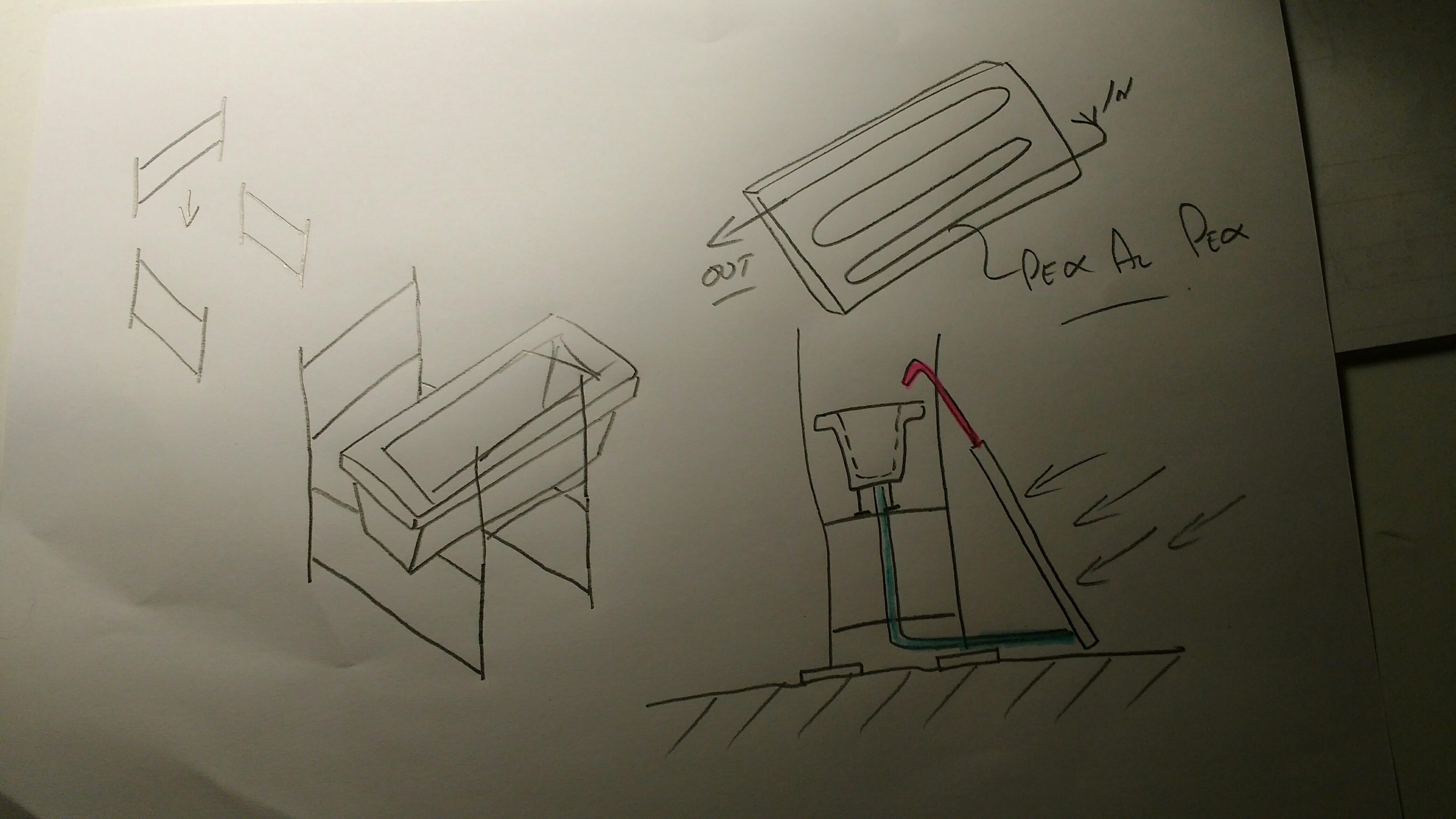

Onoff Posted August 24, 2019 Author Posted August 24, 2019 Adding flames to the fire stoked by @SteamyTea, I've just secured the old bath to be able to derust bigger things! First in will be a MK1 Focus rear cross member once I've liberated it from the associated suspension arms. That's tomorrow's job. Just hope there's enough metal left to make it worthwhile... Now then how big's the bath to calc how much citric acid...and how to heat? Thinking a loop of Pex-Al-Pex in the bath and a simple loop of black pipe in the Sun to thermosyphon...

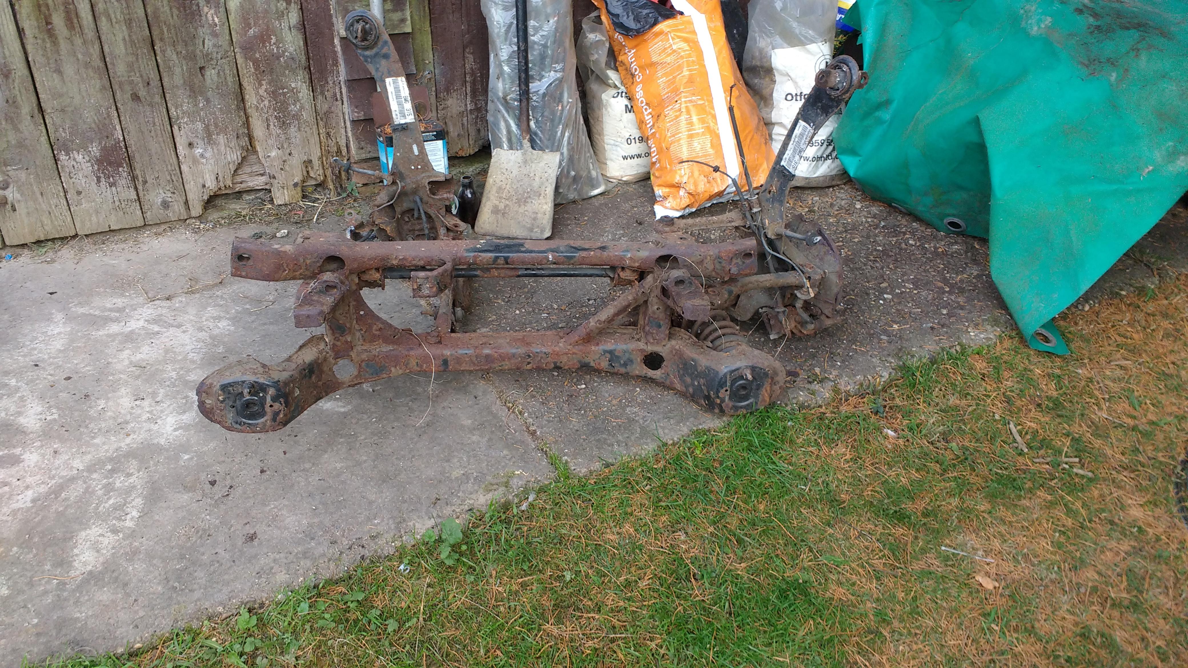

Onoff Posted August 25, 2019 Author Posted August 25, 2019 So, next candidate for the citric acid treatment. MK1 Focus estate rear cross member. What a pig stripping the arms off it. Cut probably 50% out with a slitting disc. Bless Ford for never assembling any suspension component with grease or anti seize! Got a couple of old baths available as I say if I want them, might do as a container. Maybe paint black and leave in the Sun? However, wondering if making up a "tank" with some Celcon blocks, lining with DPM and then putting a ratchet strap round the whole lot might allow a tank near the exact size and thus save on citric acid powder? Just hoping there's enough metal left to make it worthwhile. Also a few seized, cut off bolts still in there that I'm hoping will loosen enough to undo once in the bath.
Onoff Posted August 25, 2019 Author Posted August 25, 2019 Going for 19:1 for the big bath solution for the cross member 10kg of citric acid ordered tonight. Based on: 4:1 by volume = 250g / 1L 19:1 by volume = 250g / 4.75L Required volume is 1200 x 400 s 350 so 168L thus just under 9kg at 19:1 Should be here Wednesday.
Onoff Posted August 25, 2019 Author Posted August 25, 2019 Thinking to mount the bath up on 4 bits of slot together scaffold. Maybe a couple of bits of Unistrut lengthways if the bath feet don't sit right. Fill it up with 160L water. Then a quick homemade solar thermal panel o/of some leftover Pex-Al-Pex. Got a scrap OSB board I can mount it on and paint black. I could really go to town and frame it, glaze it and even insulate! Let it do its thing and thermosyphon. All out of scrap of course The first worry is maintaining 65degC?

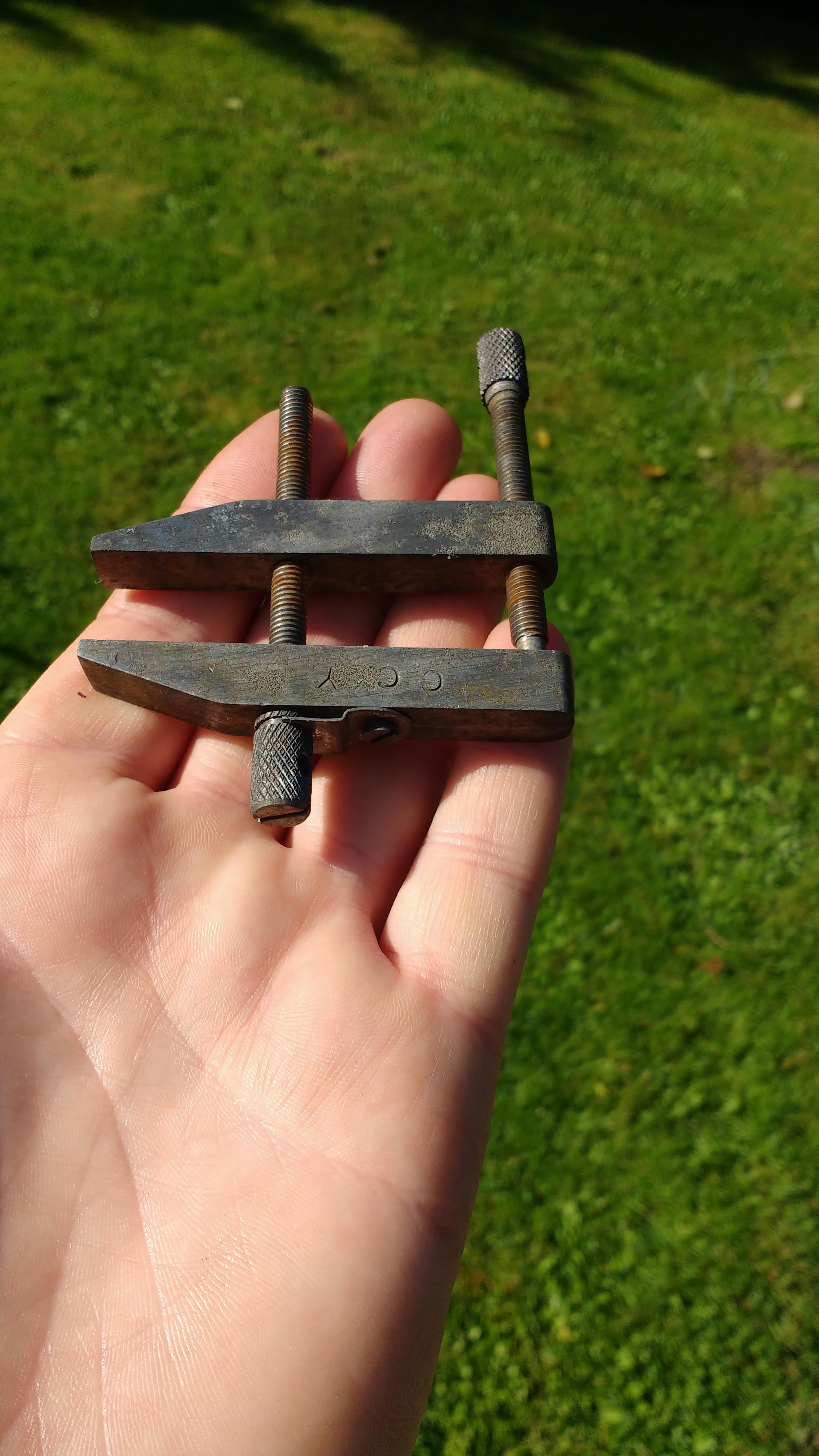

Onoff Posted August 26, 2019 Author Posted August 26, 2019 One of my pieces I made as an apprentice. This was rusted solid, stiff and otherwise fit for the bin. Came out of the bath yesterday and tbh I should have oiled it straight away. A few minutes back in the tank will get rid of the flash rust: (I even made the knurling tool that knurled the screws. Trying to find that).
