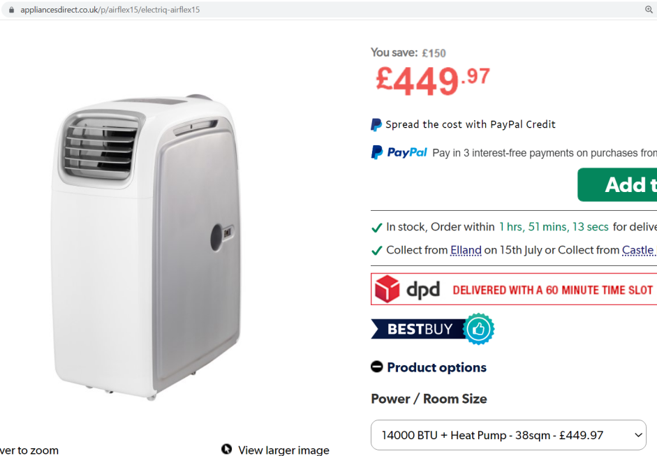

Ferdinand Posted July 13, 2022 Share Posted July 13, 2022 Thinking about the hot summer which is now upon us, and my heating for next window. I have GFCH and a big (10 kWp) solar array, facing E/W. I can't do anything physical to the house currently as half of it still stuck in a family estate. So I'm looking at this kind of thing - a portable a/c, which comes optionally with a heat pump, which I have not seen before. Or a slightly smaller version of the same. https://www.appliancesdirect.co.uk/p/airflex15/electriq-airflex15 Power consumption appears to be around 1.4-1.5 kW for 3.2-4 kW of benefit. Does anyone have any views? These are not as efficient as installed aircon / heat pumps. For heating I make that a CoP of 2.5 . But for my circumstances, with an aim for a solar driven cool or hear boost early in the day, this looks quite good. And might stop me boiling now and let me leave the gas off for at least part of this winter. And there's a returned and refurbed series of them available at £325. Any comments are most welcome. Ferdinand Link to comment Share on other sites More sharing options...
ProDave Posted July 13, 2022 Share Posted July 13, 2022 You definitely want the heat pump version, the little one is probably just an evaporative cooler? I have a similar thing, it will work as a cooler, dehumidifier or heater. to work as a cooler you need to put a big pipe out somehow to expel the warm air, without letting more hot air back in. I cut a bit of plywood to fit a small window opening and cut a suitable hole in that. Not very pretty. and be warned they are noisy, think f a large fridge running non stop. We could not stand the noise of it running overnight in a bedroom. Link to comment Share on other sites More sharing options...
Ferdinand Posted July 13, 2022 Author Share Posted July 13, 2022 15 minutes ago, ProDave said: You definitely want the heat pump version, the little one is probably just an evaporative cooler? I have a similar thing, it will work as a cooler, dehumidifier or heater. to work as a cooler you need to put a big pipe out somehow to expel the warm air, without letting more hot air back in. I cut a bit of plywood to fit a small window opening and cut a suitable hole in that. Not very pretty. and be warned they are noisy, think f a large fridge running non stop. We could not stand the noise of it running overnight in a bedroom. Good question. I have taken it as a real air conditioner, since it includes 'Gas'. ANd expensive enough to be an aircon. But wisdom would be most welcome. The manual is here: https://www.appliancesdirect.co.uk/files/pdf/AirFlex15_ r290 20201016.pdf Link to comment Share on other sites More sharing options...

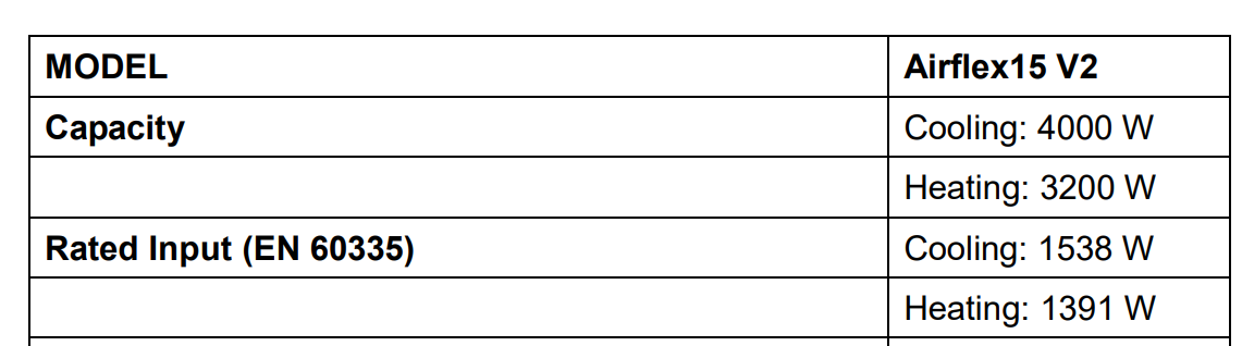

Radian Posted July 13, 2022 Share Posted July 13, 2022 From that manual: The air conditioner contains about 235 g of R290 refrigerant gas (propane). Link to comment Share on other sites More sharing options...
Ferdinand Posted July 13, 2022 Author Share Posted July 13, 2022 4 minutes ago, Radian said: From that manual: The air conditioner contains about 235 g of R290 refrigerant gas (propane). So air conditioner. Good. Link to comment Share on other sites More sharing options...
Ferdinand Posted July 13, 2022 Author Share Posted July 13, 2022 OK decision time. £324 for a scuffed one without WiFi and Google Hub / Alexa linkage controllable from a mobile telephone, but with its own 24 hour timer, thermostat, and remote, or £469 for a new one in the sale with WiFi? Hmmm. Since my intention is to run it off solar for a temperature adjustment in the morning, the non-Wifi one seems adequate. Unless the timer is a delay timer than has to be reset, which would then require a master timer on the plug socket. Link to comment Share on other sites More sharing options...
