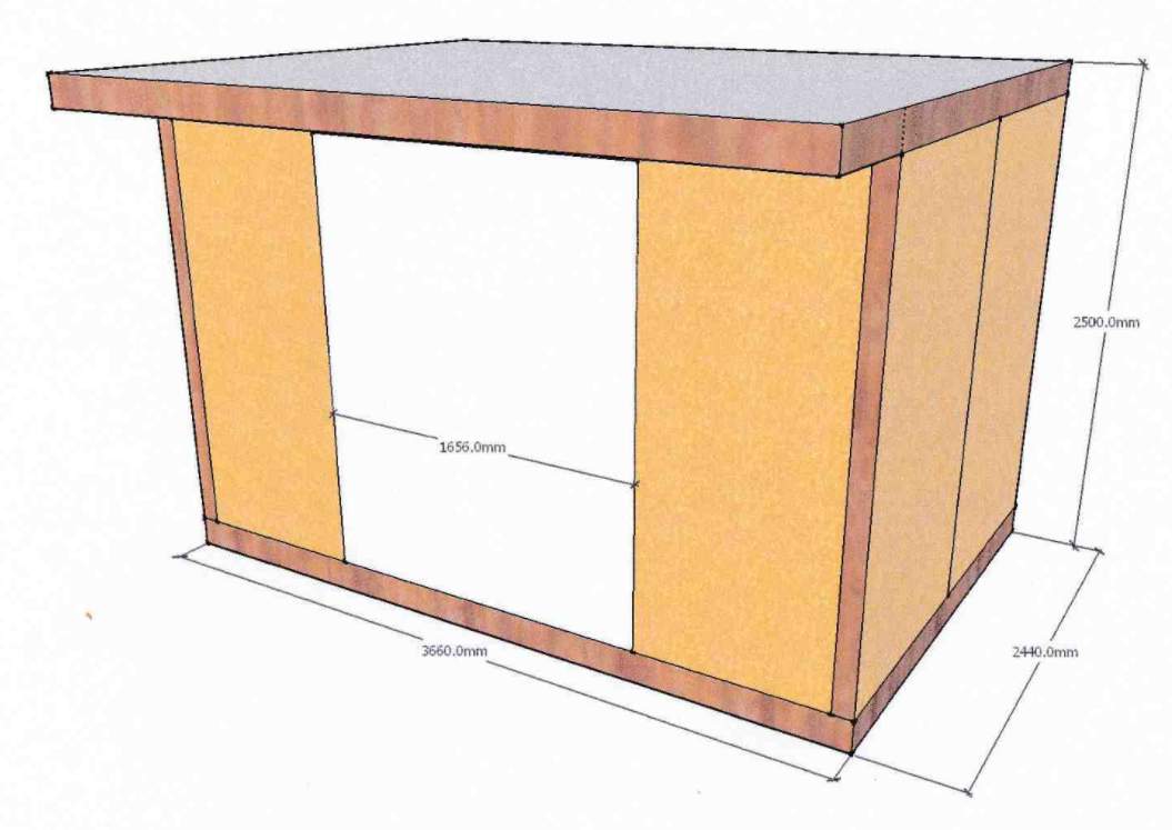

Ferdinand Posted May 31, 2017 Author Posted May 31, 2017 (edited) OK. A SIPs version. A basic structure to be practical and inexpensive. Obviously there are elephant traps in some places, and other suppliers. 1 - Basic building. A SiPs kit from Simply SIPS, which gives an insulated 8x12' kiosk faced with OSB3, with a 5ft wide doorway for £1199. 97mm SiPs with U value of 0.3, 2 - Doorway. I will pay between about £600 and £900 for a custom made and fitted PVCu door and glass side panel to a pair of French doors for that gap, including locks and fitting, with a U-value of 1,5 or so. Call it £700. 3 - Base. Possibly slabs or fence posts or a concrete slab, Cost not very much unless serious groundworks required. Allow £10-250. 4 - Cladding. What does it need? I know that I will pay around £7 per sqm for plastic shiplap-style cladding in white. It comes in 5m x 300mm lengths for £10 which are tricky to carry in a small car. The cabin will look very white from the outside, but be easy to clean. Call it £200 for the cladding, £40 for the laths, £60 for the membrane. Plastisol coated corrugated may be an alternative for cladding. 5 - Roof. It comes with a 1:40 fall towards the back. They recommend EDPM. Say £150 including adhesive etc. 6 - Summary Adding up I make that just over £2500 before work starts on the interior and services, if the base is concrete. A different approach to @Crofter for something reasonably insulated, with new materials, and which could relatively easily be dismantled. Ferdinand Edited May 31, 2017 by Ferdinand
Crofter Posted May 31, 2017 Posted May 31, 2017 (edited) That's very interesting- the SIPS price of £1199 compares to £790 for my BOTE stick build when comparing the same build elements. Not that much of a markup considering the much better performance and quicker build time. A more detailed costing might drop the price slightly, I've just used gross areas and rounded up where appropriate. If you have large openings for doors/windows then that will be a significant difference to the materials needed. Edited May 31, 2017 by Crofter clarity
Ferdinand Posted May 31, 2017 Author Posted May 31, 2017 (edited) 29 minutes ago, Crofter said: That's very interesting- the SIPS price of £1199 compares to £790 for my BOTE stick build when comparing the same build elements. Not that much of a markup considering the much better performance and quicker build time. A more detailed costing might drop the price slightly, I've just used gross areas and rounded up where appropriate. I am inclined to think that they have a big machine they need to run at 100%. Spoke to the chap this morning while doing the post, and they have not yet put up prices due to recent rises. Approx. 10% rise coming. What orientation would your cladding be? H or V? Edited May 31, 2017 by Ferdinand

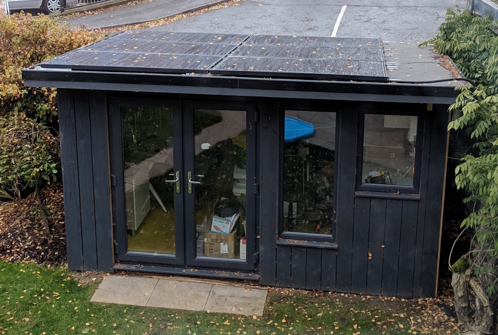

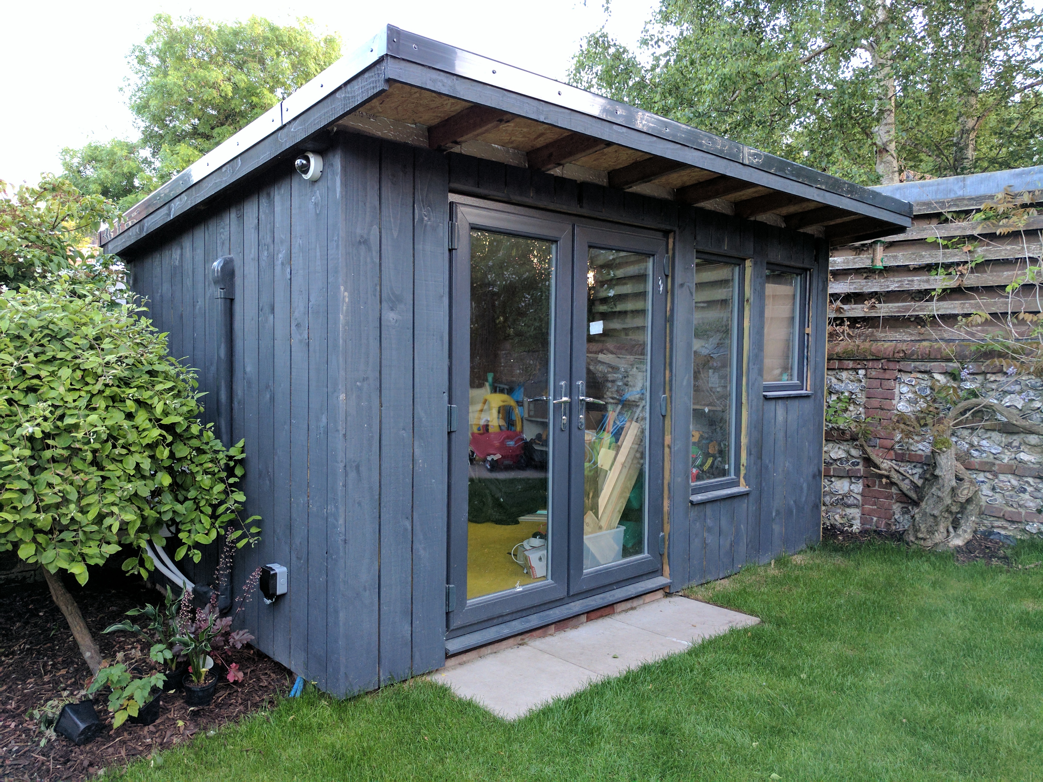

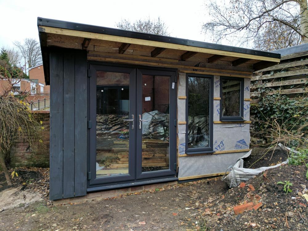

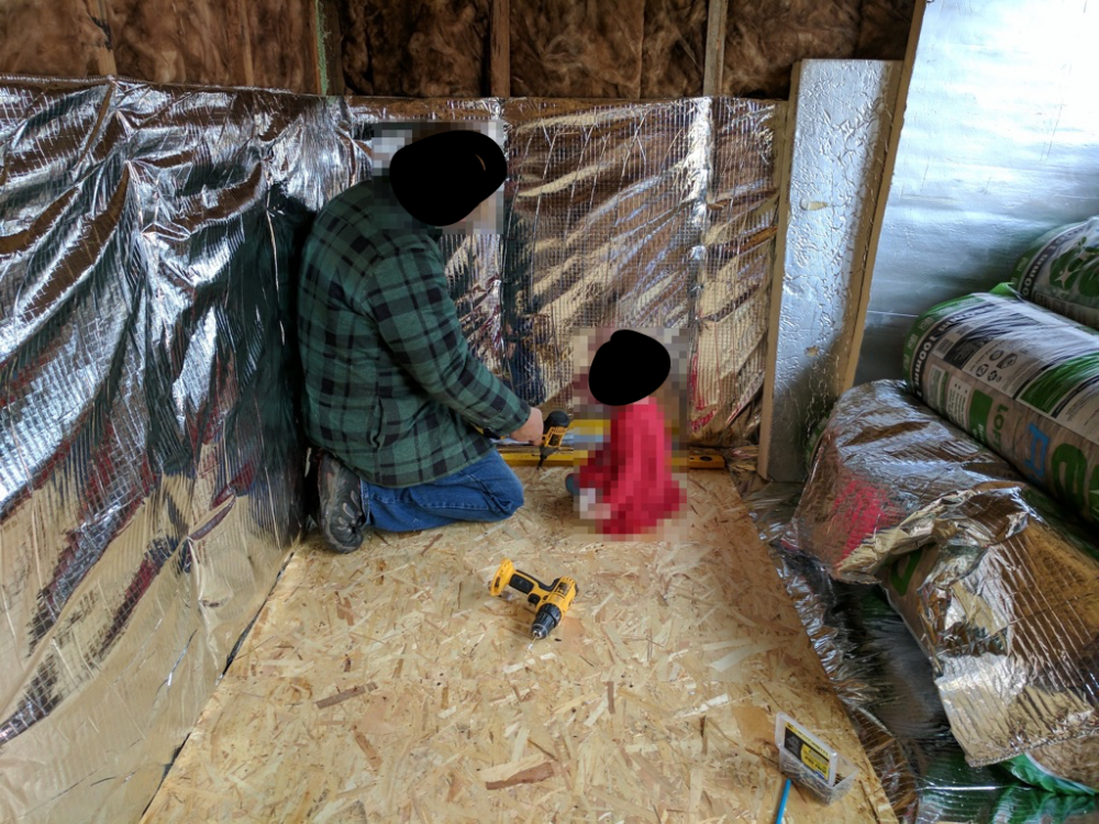

MrMagic Posted June 1, 2017 Posted June 1, 2017 For info/inspiration here's something that I'm just in the process of finishing up - my garden shoffice (half shed, half office) Wall construction was (inside to out) - - 11mm OSB - Multifoil insulation (I was curious to see how well it worked..) - 4x2 stud filled with 100mm Knauf Ekoroll - 9mm OSB - Breather membrane - Horizontal batterns - Vertical cladding (gravel boards "good" side facing out) (there should be more air gaps and such, but it's a shed at the end of the day...!) Roof is EPDM on 18mm OSB, 4x2s @ 600 centers, mix of ekoroll and celotex, 11mm OSB internal finish Floor is 18mm OSB on 6x2s @ ~400 centers. Ekoroll supported by breather membrane looped over the joists Costs add up surprisingly quickly but saved money by sourcing all the joists from a nearby bungalow that was being scalped and turned into a house - the builder said it's a shame as it all treated, slow grown, dead straight wood but because it isn't graded he has to burn it or skip it. All the joist wood cost me £20 + labour for denailing etc. Smallest 9000btu ASHP for heating Still needs some finishing touches and another coat of paint/stain (Cuprinol Shades) but otherwise it's probably very close to what you're trying to achieve. 6
