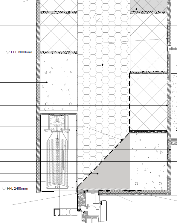

Mr Blobby Posted July 8, 2022 Share Posted July 8, 2022 (edited) I'm told that Internorm have a 6 month lead time for aluclad upvc and that I should order windows now before building my block house even starts. But what about sizing the windows? How is that done if there's no house to measure? My architect tells me that formers are used to create a dummy reveal for the bricklayer's to build against to get the window sizing correct. I've not seen this before, is this correct, and anyone got any pictures? (have told architect not to assume that internorm are the only horse in the race) Edited July 8, 2022 by Mr Blobby Link to comment Share on other sites More sharing options...

joe90 Posted July 8, 2022 Share Posted July 8, 2022 Dead easy to create a “false” window or former for the brickies to build around in timber, just make sure the dimensions are accurate. 1 Link to comment Share on other sites More sharing options...
Mr Blobby Posted July 8, 2022 Author Share Posted July 8, 2022 19 minutes ago, joe90 said: Dead easy to create a “false” window or former for the brickies to build around in timber, just make sure the dimensions are accurate. What about cavity closers to make the formers like this... https://www.eurocell.co.uk/data/downloads/eurocell cavalok brochure_lr.pdf Good idea or oversold crap? Link to comment Share on other sites More sharing options...

Miek Posted July 8, 2022 Share Posted July 8, 2022 8 hours ago, Mr Blobby said: What about cavity closers to make the formers like this... https://www.eurocell.co.uk/data/downloads/eurocell cavalok brochure_lr.pdf Good idea or oversold crap? I'm using Cavalok closers, 300mm cavity. Got them premade from Subframes. They work . I ordered windows off the drawings and did a lot of double checking. They are not load bearing however so don't sit the windows down on them. I'm going to hang the windows from their sides with metal straps. Link to comment Share on other sites More sharing options...

Mr Blobby Posted July 10, 2022 Author Share Posted July 10, 2022 On 08/07/2022 at 14:50, dpmiller said: and remember we do check reveals over here like Scotland so make sure you're sizing the right skin. I'd really like check reveals. Architect is less enthusiastic. Not sure if check reveals would work with external blinds 🤔. Anyone done this? Link to comment Share on other sites More sharing options...
craig Posted July 10, 2022 Share Posted July 10, 2022 You would use check reveals, you need an unobstructed opening, so that the guide rails and the box can be attached. You could but they’d most likely present problems. However, hiding the rails and box is the whole idea behind it. Which is achieved with your external finishing. Link to comment Share on other sites More sharing options...

Mr Blobby Posted July 10, 2022 Author Share Posted July 10, 2022 35 minutes ago, craig said: You would use check reveals, you need an unobstructed opening, so that the guide rails and the box can be attached. Do you mean 'you would not use check reveals' I can see how the guide rails wither side of the window would need to be at the width of the blind wich is likely the width of the window? 35 minutes ago, craig said: You could but they’d most likely present problems. However, hiding the rails and box is the whole idea behind it. Which is achieved with your external finishing. So we think the blind box would go in the outer leaf, which would need to be 140 block to match the (modulo P) blind box depth. The outer leaf would be constructed higher than the inner leaf to accomodate the blind box height. Like this: So the wndow formers on the South/west windows with external blinds would be different heights for inner/outer leaf of course. AFAICS check reveals wouldn't work at the sides because the blinds require the full width of the window? Link to comment Share on other sites More sharing options...

craig Posted July 10, 2022 Share Posted July 10, 2022 Different systems, different requirements. Roma system, is 20mm narrower than the width of the window. It allows a check reveal but it does mean everything has to be spot on. 1 Link to comment Share on other sites More sharing options...

Mr Blobby Posted July 18, 2022 Author Share Posted July 18, 2022 (edited) On 08/07/2022 at 21:43, Miek said: They are not load bearing however so don't sit the windows down on them. I'm going to hang the windows from their sides with metal straps. Where the cavities are closed, and the window is in the cavity then what do you attach the straps to? The inner leaf reveal? Edited July 18, 2022 by Mr Blobby Link to comment Share on other sites More sharing options...
saveasteading Posted July 18, 2022 Share Posted July 18, 2022 1 hour ago, Mr Blobby said: what do you attach the straps to? The inner leaf reveal? Nordan have shown us to fix metal straps to the sides of the frames, then bring them interally and screw to the (stone) reveal. Then they have to be concealed. Surprisingly they don't supply straps, and a helpful fitter showed us that he seems to use any old strap that is handy. But then to use expanding foam to really take the load as well as seal. Link to comment Share on other sites More sharing options...
Mr Blobby Posted July 18, 2022 Author Share Posted July 18, 2022 (edited) 1 hour ago, saveasteading said: Nordan have shown us to fix metal straps to the sides of the frames, then bring them interally and screw to the (stone) reveal. Then they have to be concealed. Surprisingly they don't supply straps, and a helpful fitter showed us that he seems to use any old strap that is handy. But then to use expanding foam to really take the load as well as seal. Thanks for this. Others on this forum have attached the window to the outer leaf of a cavity bllock construction, which I like but I think would eliminate the cavity closers. Which is probably not an issue. Edited July 18, 2022 by Mr Blobby Link to comment Share on other sites More sharing options...
