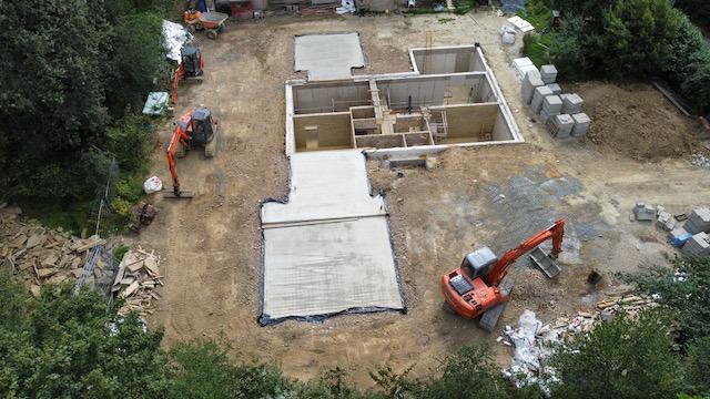

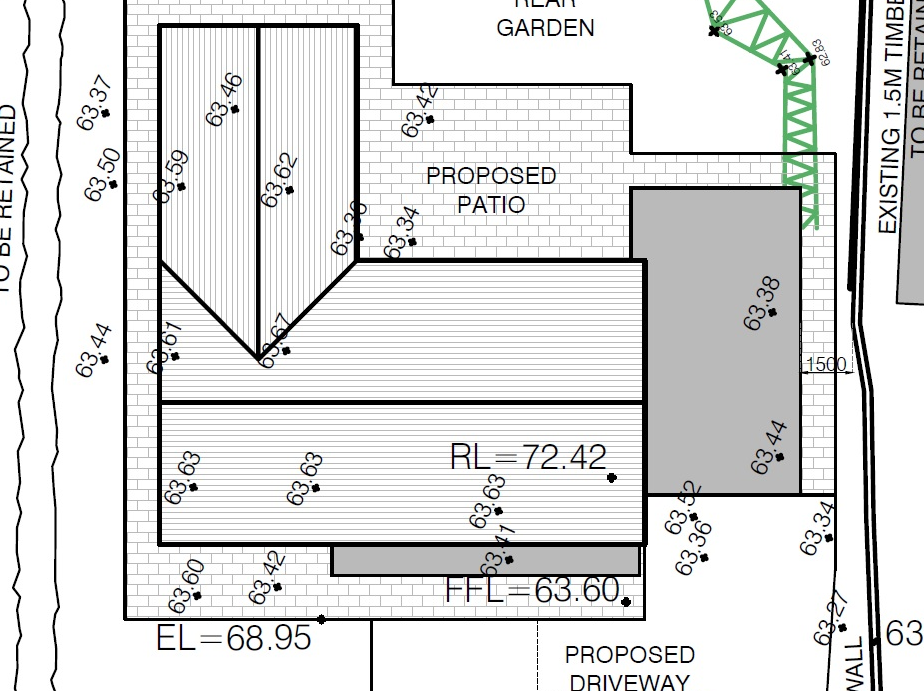

Mr Blobby Posted July 27, 2022 Author Posted July 27, 2022 So things have moved sideways a little. Builder on site has suggested excluding the garage from the KORE slab to build the house first and then add the attached garage on a strip foundation afterwards. His reason is that this would leave room for a telehandler to get round the back of the build and remove the need for a crane. That side of the site also slopes away a little (about 500mm) and appears not to be on such a firm rock base as rest of site. Image in earlier post above shows garage attached to right hand side of house. On the face of it, building the garage on a strip foundation seems like a good idea. Is it? Has anyone else built a block structure with part strip foundation, part KORE foundation? Of course I will raise this with my SE but very interested in feedback here as I have no idea if this is a stupid thing to do.
Thorfun Posted July 27, 2022 Posted July 27, 2022 1 minute ago, Mr Blobby said: Of course I will raise this with my SE this is the important step! definitely run it by the SE. we have 'arms' attached to our main house that has a basement underneath and those arms are also insulated slabs but are sitting on strip foundations. so there's no reason why you can't have the garage on an insulated slab and 'attached' to the main house later if you want to. obviously if it's ok with the SE! 😉 some might say that there's no need to insulate the ground of the garage but for the cost of the insulation I'd do it as you never know if you want to convert it at a later date to a habitable room or not. will be easier if it's insulated now.

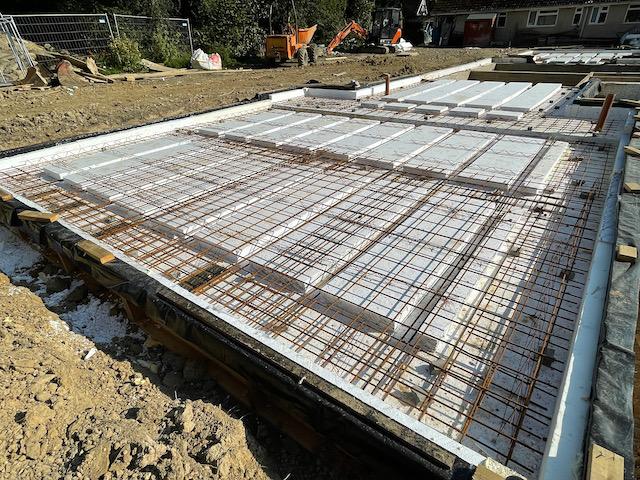

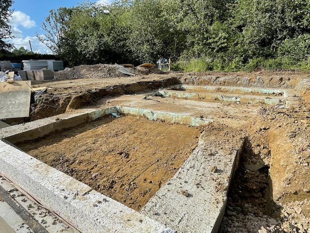

Thorfun Posted July 27, 2022 Posted July 27, 2022 here's a photo of our 'arms' on insulated slabs which sit on 2m deep trench fill foundations. here are the trench fill foundations for the 'arm' closest to the camera in the photo above. and with the insulation and rebar on top ready to pour the slab. hope this helps! 🙂 1

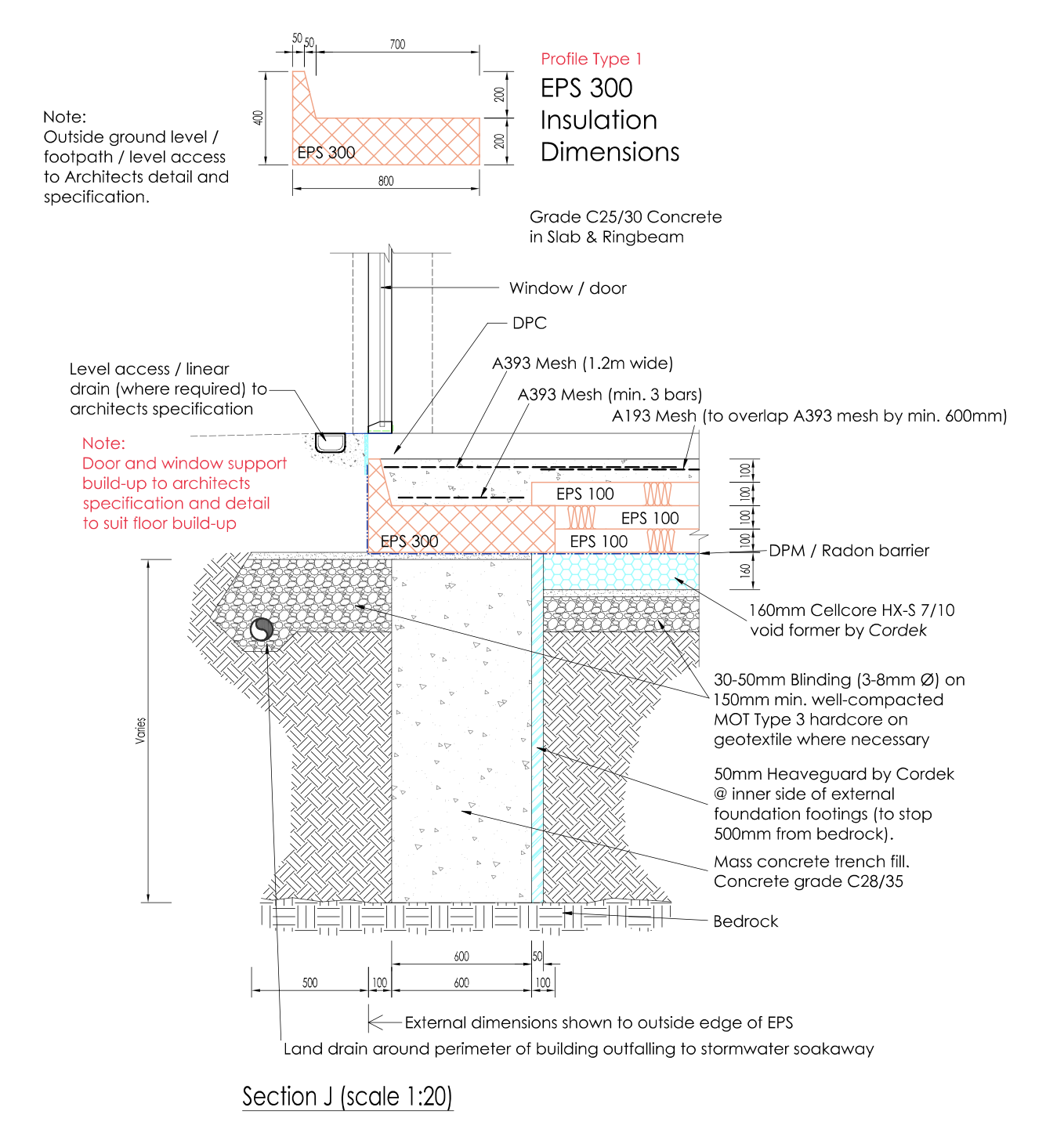

Mr Blobby Posted July 27, 2022 Author Posted July 27, 2022 So, if I understand this, you put in a traditional trench foundation and then an insulated slab on top of that? So no hard core under the insulated foundation for drainage, just around the outside? 9 minutes ago, Thorfun said: ...some might say that there's no need to insulate the ground of the garage but for the cost of the insulation I'd do it as you never know if you want to convert it at a later date to a habitable room or not. will be easier if it's insulated now. ... I agree on insulating the garage floor, but had thought the only option was to go the traditional route of concrete subfloor and then insulation and then screed on top.

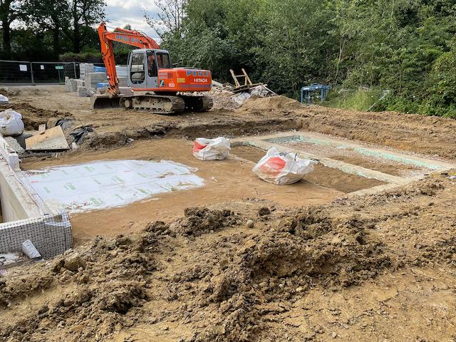

Thorfun Posted July 27, 2022 Posted July 27, 2022 1 hour ago, Mr Blobby said: So, if I understand this, you put in a traditional trench foundation and then an insulated slab on top of that? So no hard core under the insulated foundation for drainage, just around the outside? we have Cordex under the insulation laid on a bed of sand laid on hardcore. here are our SE drawings for that detail. and here it is in-situ 🙂. you can see the three stages in one photo! the far bit has hardcore, the next has the layer of sand blinding and then the cortex in the bit by the basement wall. we used TSD for our foundations who are excellent with insulated slabs. you definitely don't have to do it the old school way. obviously all depending on the correct SE calculations!
