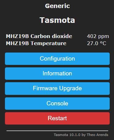

Radian Posted July 1, 2022 Posted July 1, 2022 CO2 Is also a good option I've not seen mentioned. Especially in a smallish room. They used to be very expensive but an IR one like this is similar in price to the microwave sensor. RS232 output and plenty of Rpi and Arduino libraries - although I use one with an ESP8266 running Tasmota to get MQTT from it... 1

Radian Posted July 1, 2022 Posted July 1, 2022 1 minute ago, MJNewton said: Do you monitor humidity levels too @Radian? I seem to recall reading somewhere that CO2 levels generally correlate with humidity level and whilst I couldn't quite see why that would necessarily be the case I did wonder if my humidity (only) monitoring might suffice for determining air 'quality'. At £22 I am tempted by that sensor you linked to though. I've never really tried using either as an occupancy sensor. The CO2 sensor is in a room that we tend to receive visitors in and gives me a silent reminder to open a window if levels go above 800ppm. Here's an old thread about CO2 sensors used with MVHR:
