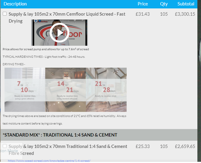

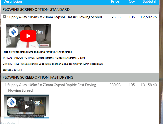

crispy_wafer Posted June 25, 2022 Posted June 25, 2022 I'd heard that a slight thicker slab will act more like a slow release heatstore but never experienced in practice so could not comment further. Here's some prelim prices I had for screed if it helps for comparison, I think these are a bit on the high side though 2
saveasteading Posted June 26, 2022 Author Posted June 26, 2022 Useful info thanks. I won't publish our quotes as it is a live discussion still. In principle though we have a bigger area and higher price. If we could do it in one pour then getting closer.

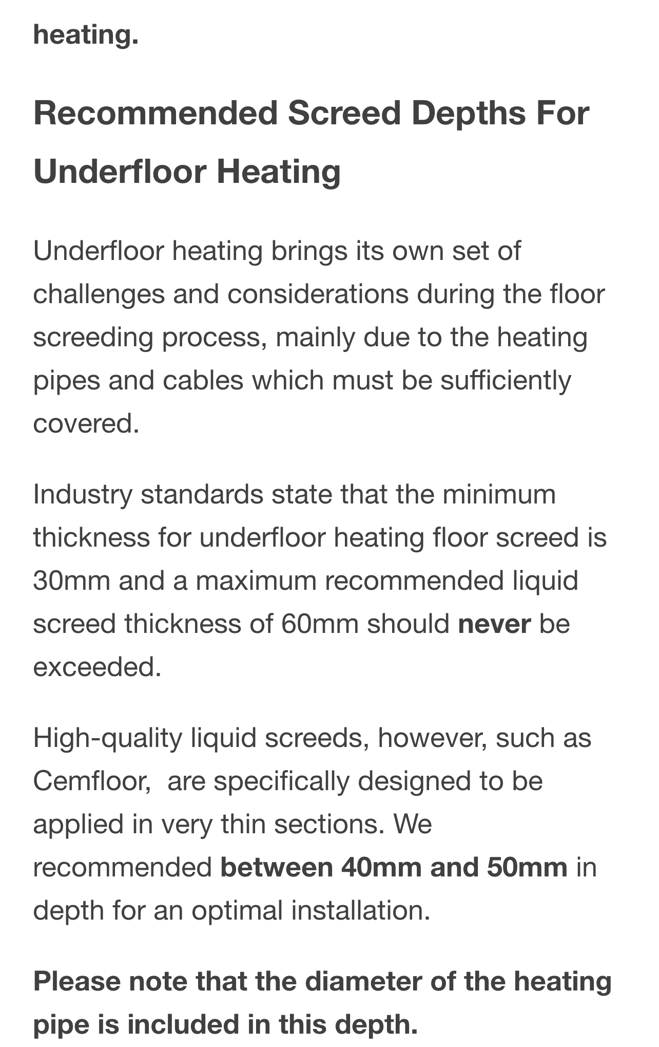

Kelvin Posted March 14, 2023 Posted March 14, 2023 I’ve got a decision to make on this coming up. We’re 200mm insulation. The build up is 20mm allowance for final floor material over 75mm screed (traditional sand cement) However reading the Cemfloor website it says that using it allows for thinner screed thickness with maximum depth of 60mm. Optimal depth between 40mm-50mm. If I go Cemfloor I’ll need to add more insulation and go to 225mm (150mm + 75mm), not a bad thing of course with 50mm Cemfloor Therm screed. Just interested why people have suggested going more than Cemfloor recommend?

Kelvin Posted March 15, 2023 Posted March 15, 2023 28 minutes ago, Dave Jones said: As long as your inside FFL to outside is still ok i'd go for 75mm screed. Sure but why do Cemfloor state that 60mm should never be exceeded? That’s pretty emphatic. I’m going to call them anyway.
JohnMo Posted March 15, 2023 Posted March 15, 2023 1 minute ago, Kelvin said: Sure but why do Cemfloor state that 60mm should never be exceeded? Possibly due to shrinkage cracks? If they say don't exceed and you do and something is not right after, they will just say you exceeded the max depth, the problem is yours to sort out.

Kelvin Posted March 15, 2023 Posted March 15, 2023 Just spoke to Cemfloor. They said the information on their website is incorrect and you can install thicker depths than 60mm with no problems. They recommend you don’t just for performance reasons. They are going to update their website with the correct information. 1

Kelvin Posted March 15, 2023 Posted March 15, 2023 6 hours ago, Kelvin said: Just spoke to Cemfloor. They said the information on their website is incorrect and you can install thicker depths than 60mm with no problems. They recommend you don’t just for performance reasons. They are going to update their website with the correct information. Cemfloor have updated their website already and removed the incorrect information. 1
