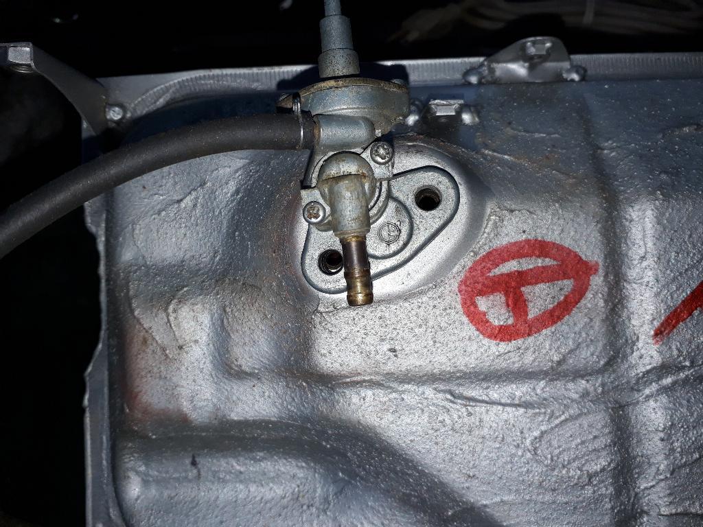

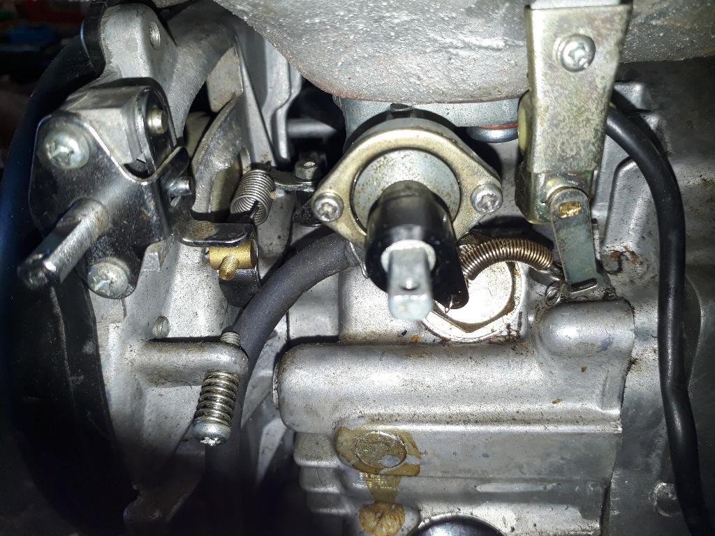

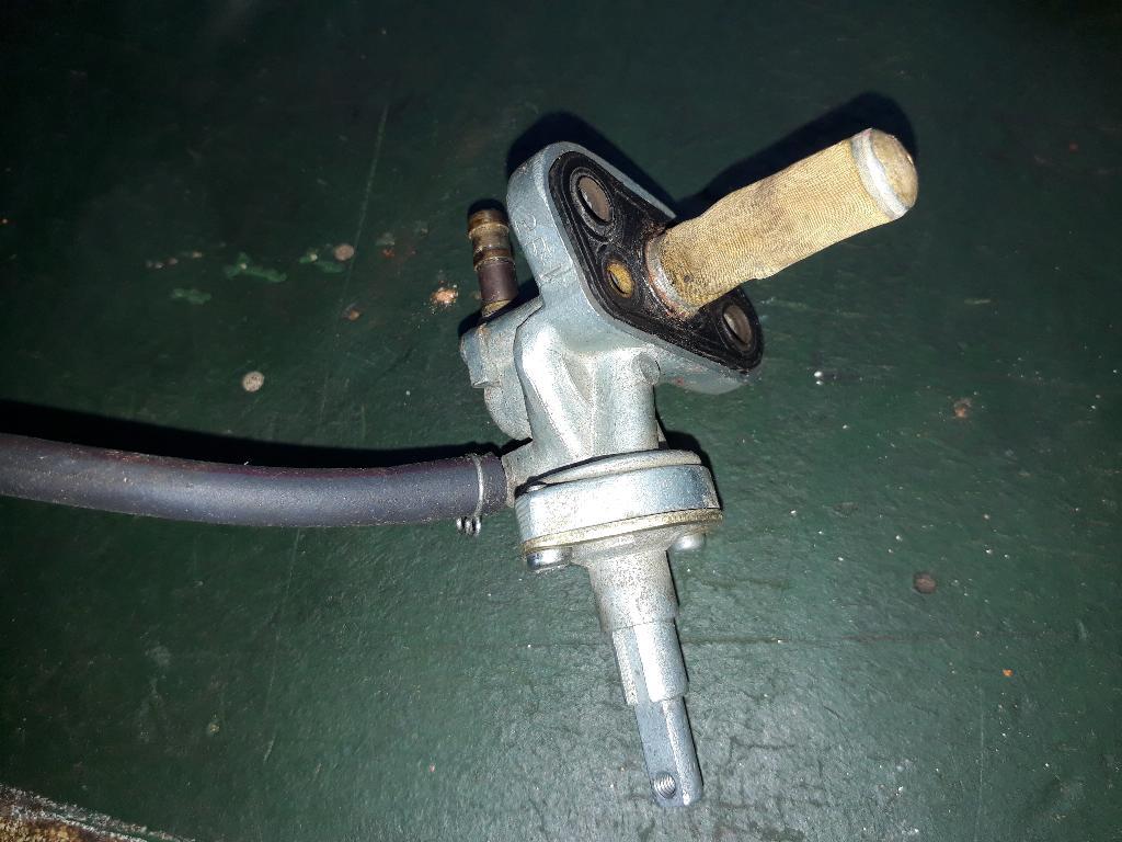

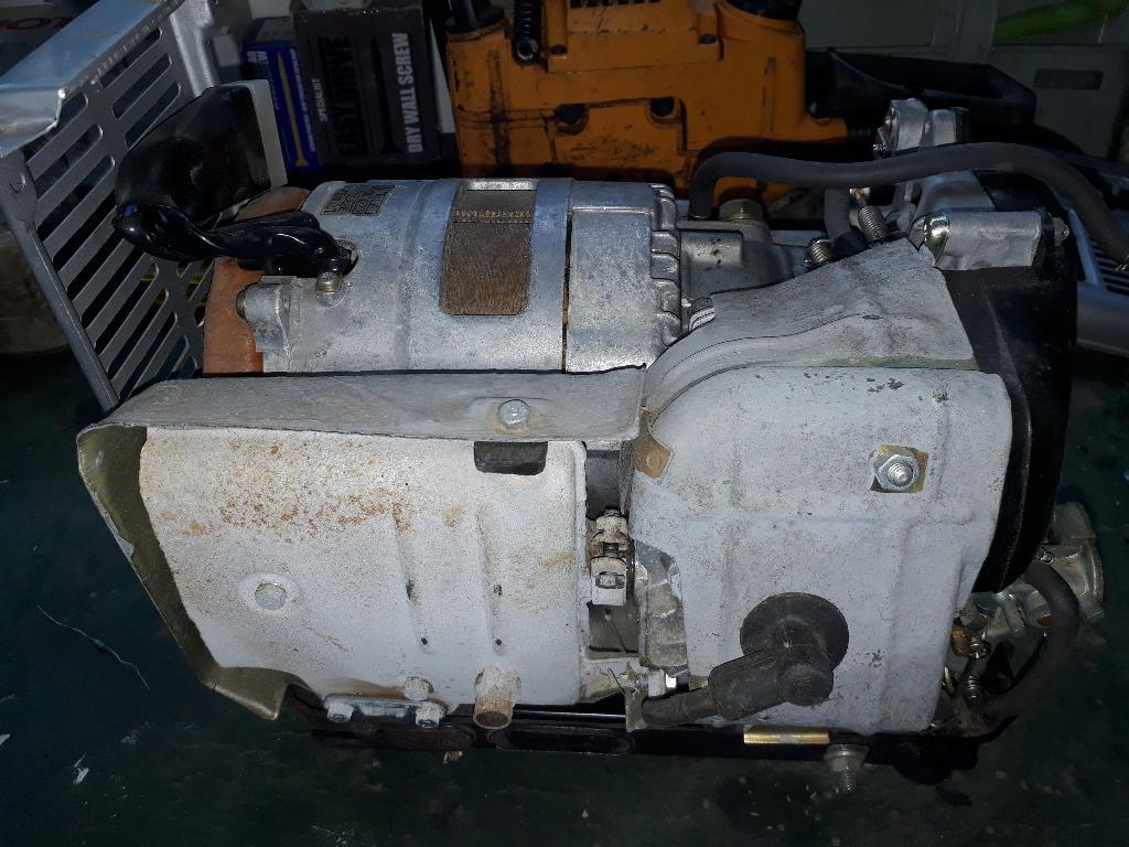

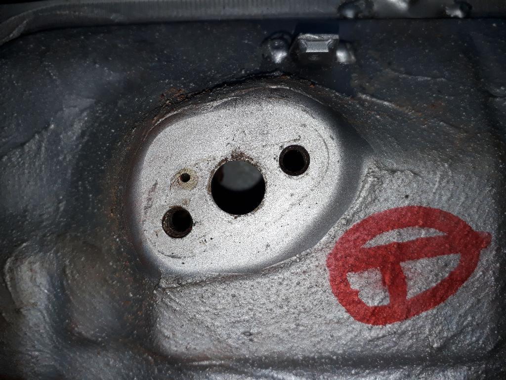

ProDave Posted June 22, 2022 Author Posted June 22, 2022 The long awaited photos. Sorry annoying things like having to go out to do some work have got in the way. The bare generator with all the casing and tank removed. This bit works fine. The petrol tap, in the tank (though fixing screws not inserted) The holes in the petrol tank, fixing holes are 30mm centres. Note the extra tiny hole as well as the main one. And the tap on it's own. So here is what I think is happening. The petrol tap is in fact two taps. The main fuel is picked up through the big hole in the tank, through the petrol tap and out via the large hole, the one without a hose currently fitted. The tiny hole, appears to connect inside the tank to a tiny pipe that goes right high up in the tank. That when the tap is on, connects to the small hose that is still connected to the tap. This I believe is the tank vent. But since dismantling the tap to de crud it, as soon as you turn it on, petrol comes out of this vent pipe. It never used to. I need to dismantle the tap again and photograph the individual components and work out what is going on. I think it very unlikely I am going to get a replacement tap so fixing the one I have looks the best hope. Even if a different tap that fitted could be found, I can't see how it would ever function properly unless the spindle exited in exactly the same place.

SimonD Posted June 23, 2022 Posted June 23, 2022 16 hours ago, ProDave said: connects to the small hose that is still connected to the tap. Where does this still connected pipe go to on the engine or does it simply vent to atmosphere? When you took apart the tap originally was there any sign it could be a vacuum or pressure mechanism?
ProDave Posted June 23, 2022 Author Posted June 23, 2022 The small pipe just goes down past the engine and out of a small hole in the casing. My theory is the little pipe in the tank is a vent pipe that goes high in the tank, so no petrol will come out. and the tap is in fact 2 taps, one opening the fuel and one opening the vent pipe. I think what has gone wrong is petrol is bypassing between the 2 either I have put it back together wrong, or there is something damaged. I will investigate more and take pictures when I do.
dpmiller Posted June 23, 2022 Posted June 23, 2022 does the valve rotor fit in 180deg out? is there a seal or is it metal-metal? can you see a pipe rising inside the tank as a vent? No chance it's actually a tank drain?

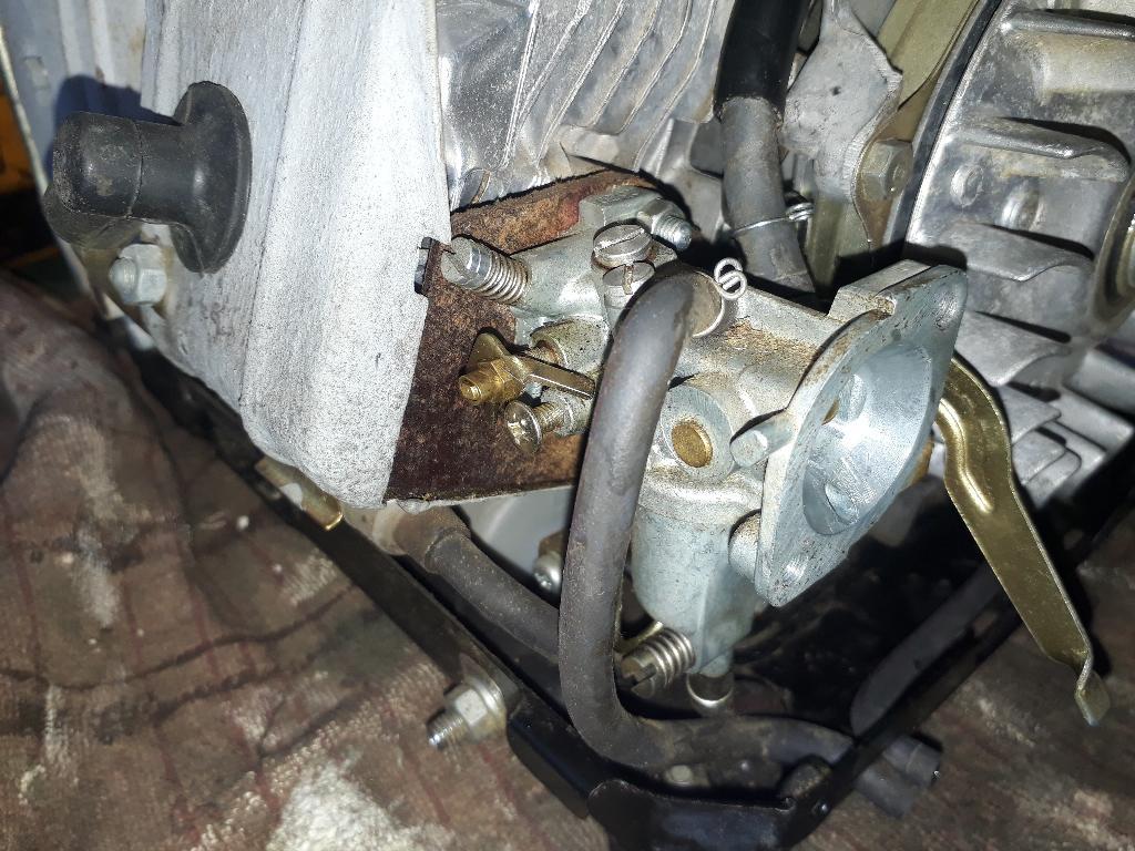

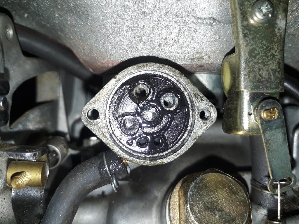

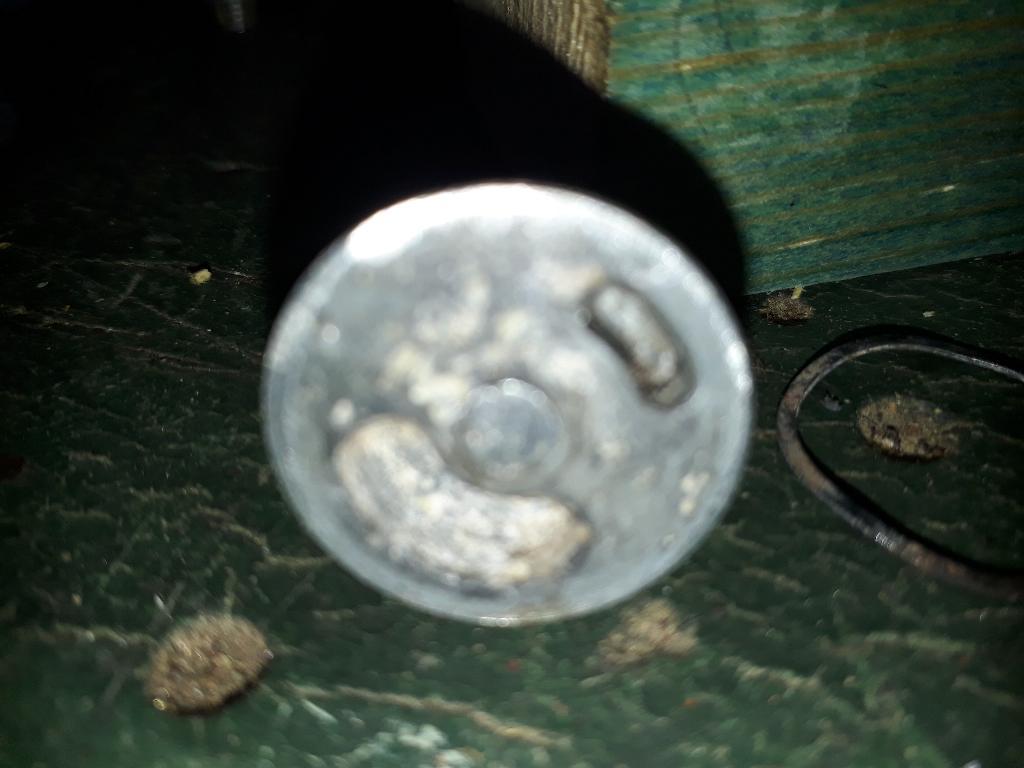

ProDave Posted June 23, 2022 Author Posted June 23, 2022 So some progress. I had another look at the fuel tap. There is a fixed part and a rotating part, and between them is a ported rubber washer. When you offered the rotating part into the fixed part, it did not seem to fit flat, it wobbled about it's centre, that did not seem right. These are the two parts In the centre of each part is a "pip" which seems to serve no useful function, but it appeared these two pips were touching and preventing the 2 halves pushing together and sealing against the rubber washer. So I ground some off the rotating part, and now they mate together and don't wobble. My guess is over time the rubber washer has compressed and it is not as thick as it once was. Here is the tap back together on the tank on the generator with the engine kill switch fitted So that's the tap working shutting fuel off and not leaking. Time to crank her up All looks well in the picture but it is not a happy bunny. It will only run with at least half choke and when you stop the engine, fuel then starts dripping out of one of the jet holes next to the air inlet. Lets just say fuel flow through the carb is not right. So that will be the next job, take the carb off and investigate. Here it is. it looks easy to remove, in particular the throttle mechanism looks easy to detach which can be difficult on some engines.
PeterW Posted June 23, 2022 Posted June 23, 2022 Hallmarks of a sticking float valve and one of the jets full of crud. 2
ProDave Posted June 24, 2022 Author Posted June 24, 2022 Looks like Peter was correct. The bottom of the float chamber was full of similar crud to that I cleaned out of the petrol tap. Every other jet I inspected looked clean and free of blockages. Back together again and it still flooded. I then had to adjust the float height, don't ask me why I should have to, but it was simply not shutting off in time even though the valve was clear and working. First try at that resulted in too little fuel in the float chamber to pick up. So somewhere between the two and no petrol pouring out and she purrs like a kitten with no choke, running nicely. Just got to clean things up and put it all back together and then change the engine oil. 1

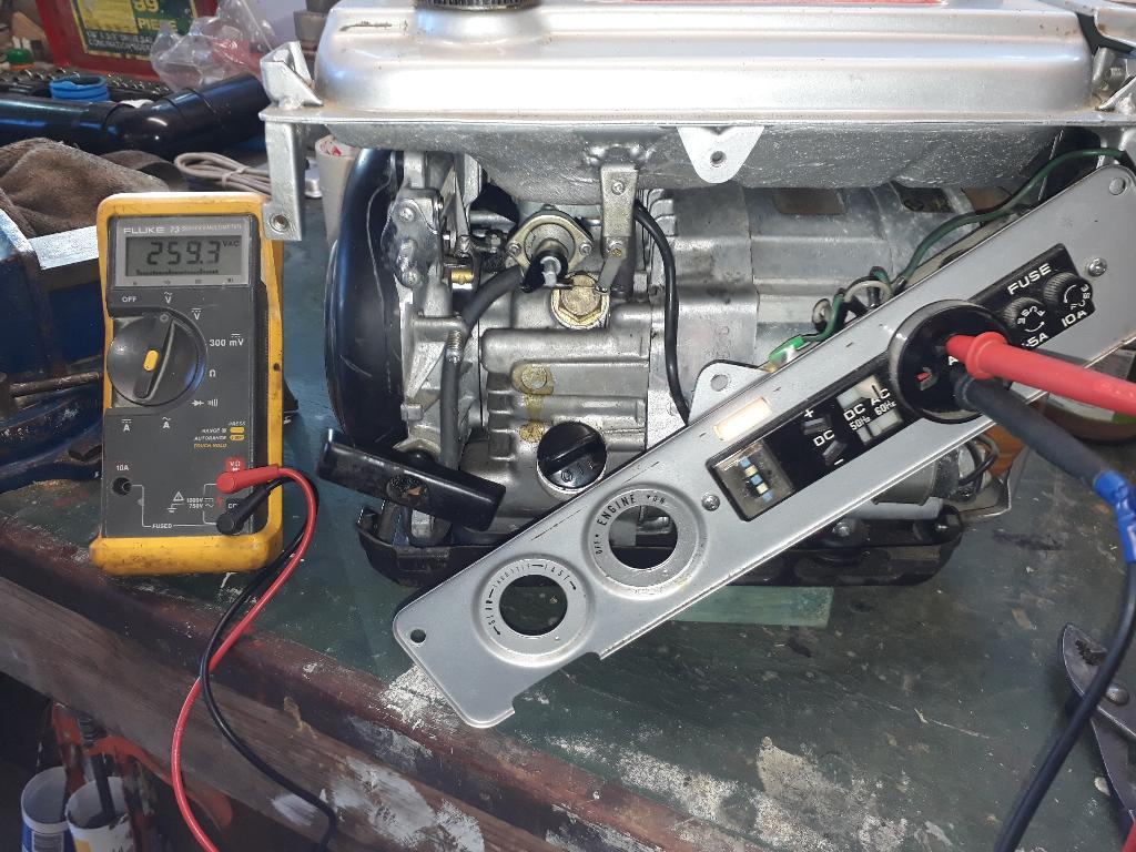

ProDave Posted June 25, 2022 Author Posted June 25, 2022 That's it all back together and running nicely. I load tested it. It's rated at 300W ac and the smallest power tool I have is a 350W jig saw. It runs that, but the start up current nearly stalls it. Last thing left is i need a new air filter. It's only a foam filter and the original has turned to dust. I found once person selling the original. but £15. https://www.ebay.co.uk/itm/154823546691?hash=item240c33d743:g:DKcAAOSwtJhh-nq2 It's just a square bot of foam with a hole in it. I could buy this for £2.33 https://www.ebay.co.uk/itm/203106988816?hash=item2f4a1eb310:g:2QMAAOSwSw1gW1wT I can cut 2 the size I need from that so very tempting. Anyone tell me why not?
