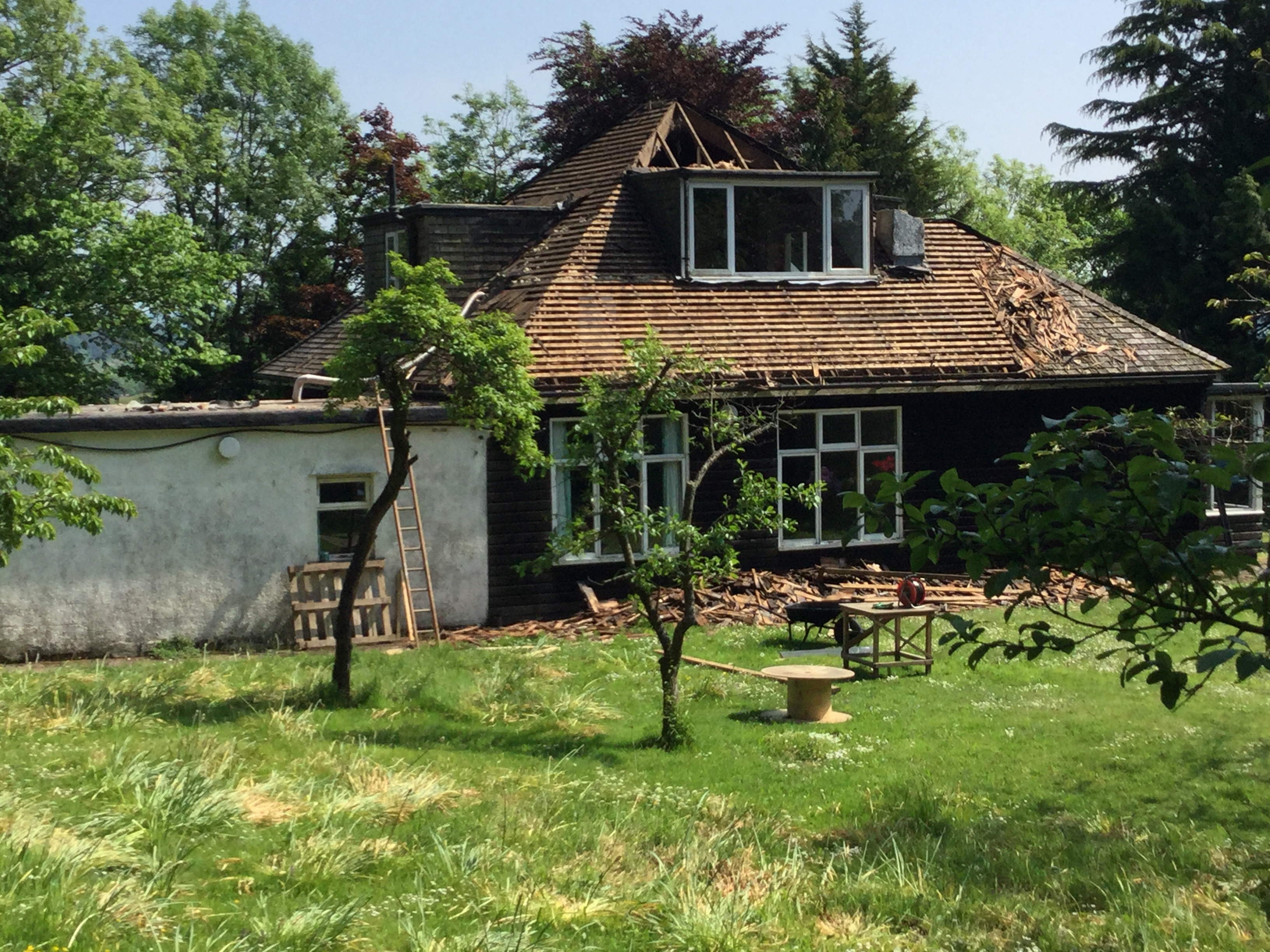

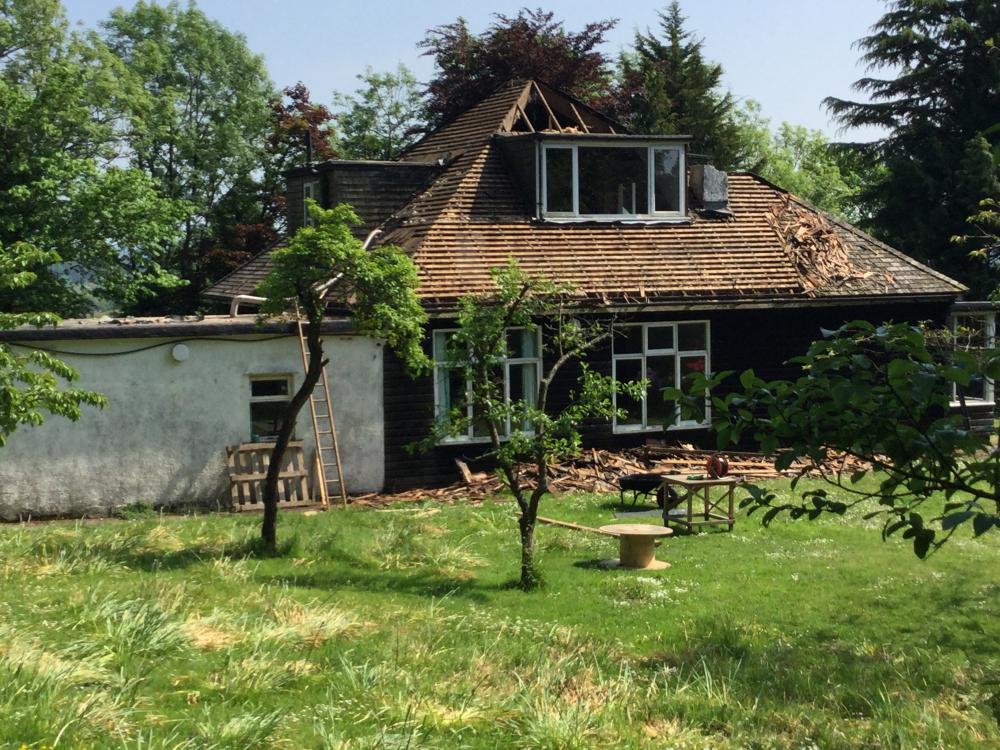

Triassic Posted May 25, 2017 Share Posted May 25, 2017 Land around where we are self building is very expensive, so we looked around for old property we could knock down and replace. As I type this I'm looking across the garden at our donor property with its partially stripped roof. Back to work!! 1 Link to comment Share on other sites More sharing options...

Triassic Posted May 26, 2017 Share Posted May 26, 2017 I'll second don't buy a wreck thinking you can renovate it. The last two "self builders" were renovation jobs. In both cases it was a roof off and strip back to the brickwork/stonework jobs. You will spend more, way more, than you budgeted, mainly due to then unknowns. If you've done your sums right you walk away with a profit. It's always best (and cheaper) to buy a donor property and knock it down and start again. As others have said, self Build is a team sport and your partner is an essential part of that team. If they are not committed to the vision, it won't work. Link to comment Share on other sites More sharing options...
