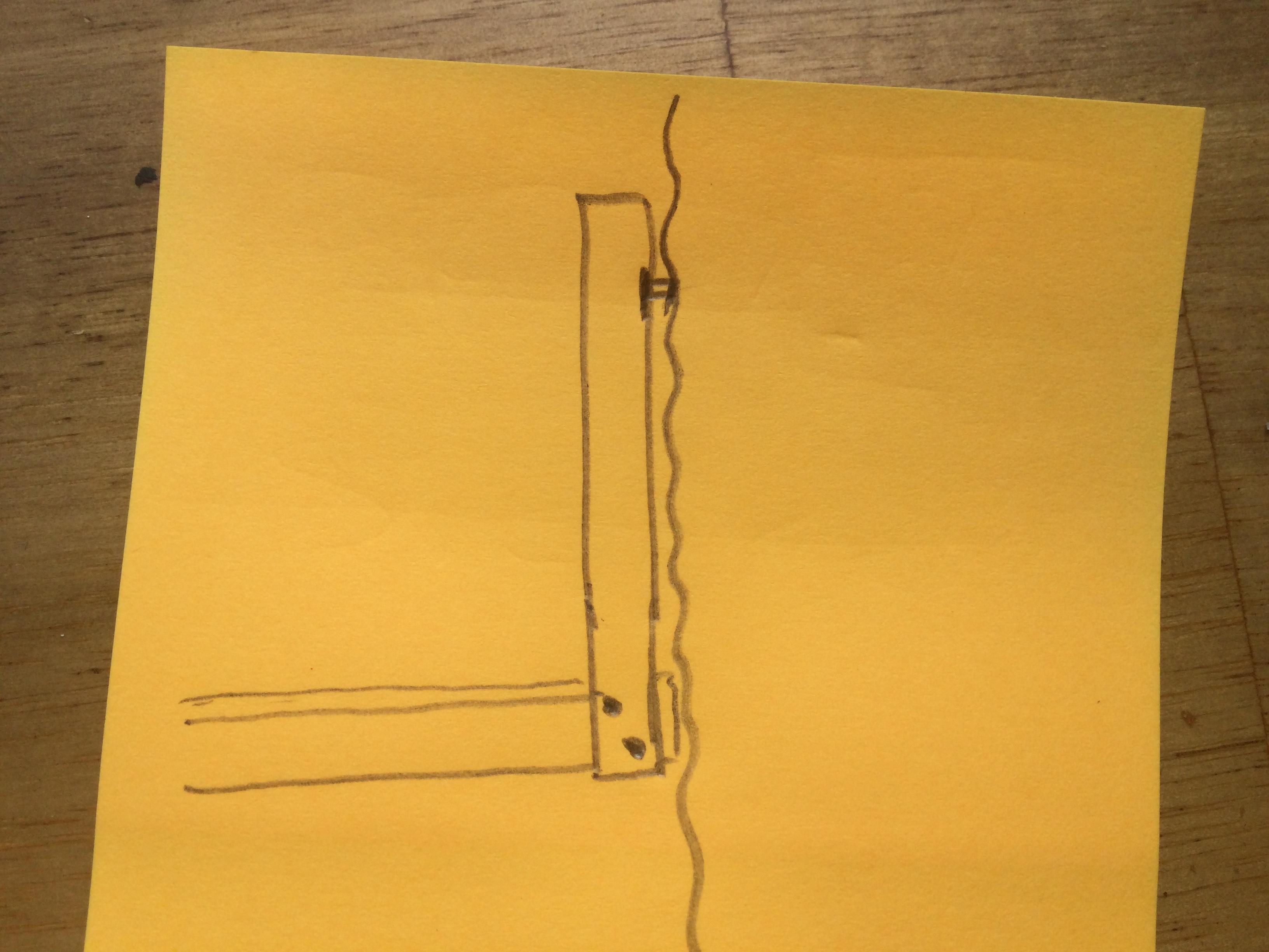

Onoff Posted September 6, 2022 Posted September 6, 2022 6 minutes ago, zoothorn said: Hi Onoff, fab of you.. in fact I've got 3 spare: so if the btm of posts ( notched) is fixed to frame with 2 screws, then 1 of your tubes say 2ft above/ a super solid fix to wall.. might mean a vg solid 'back' upright support post? Thanks, zh The most solid fix would be near the top of the handrail I think? So do you need more tubes or not? I've also some 50mm dia stainless tube with a 6mm thick wall here but not much. Might look better?

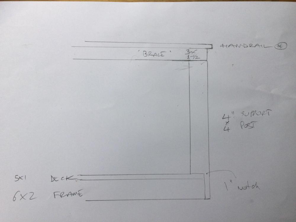

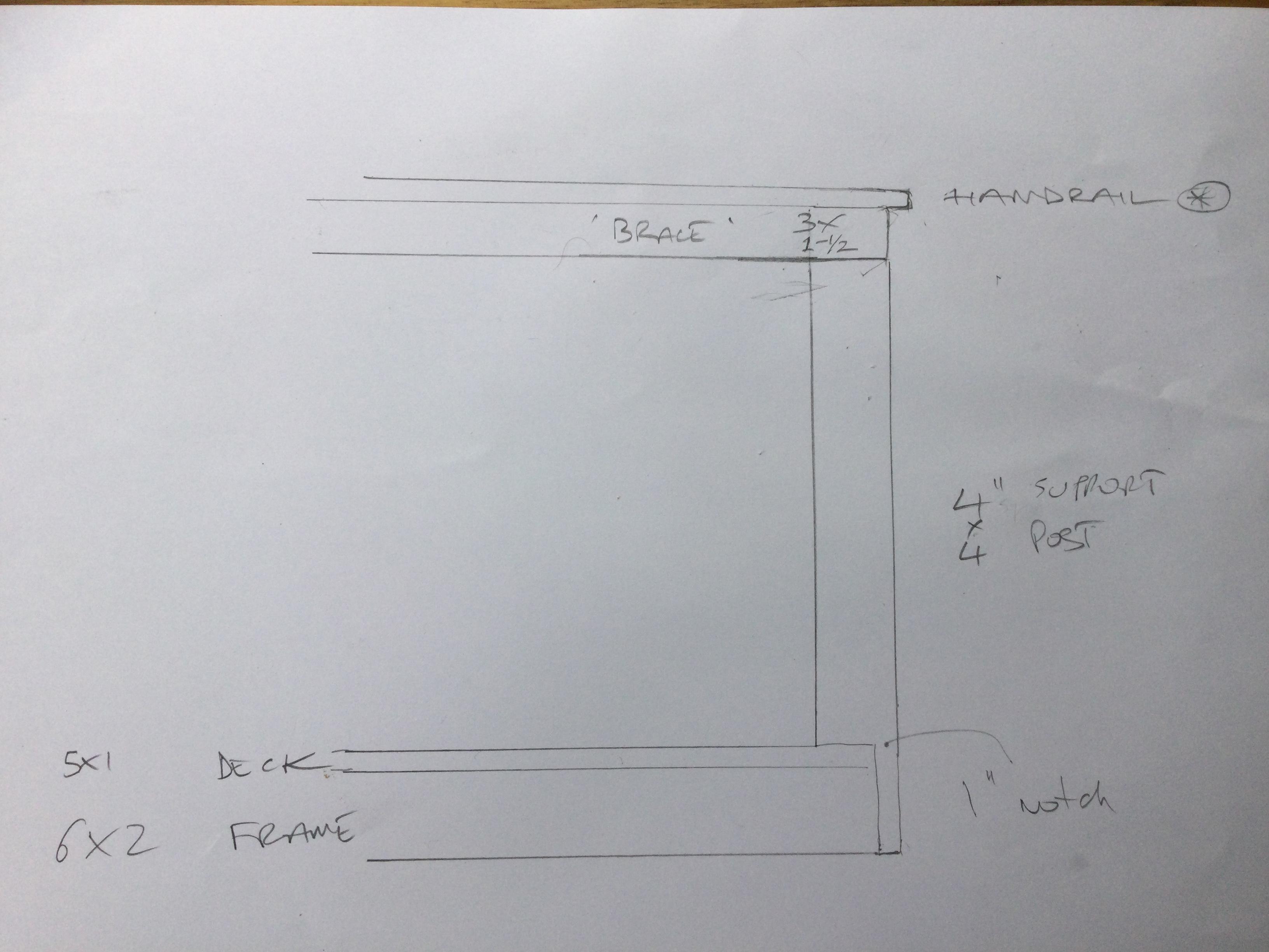

zoothorn Posted September 7, 2022 Author Posted September 7, 2022 (edited) 13 hours ago, Onoff said: I've heard that's why kids fall over a lot, because their heads are disproportionate to their bodies. Haha. Bloomin kids.. Onoff I think I'm ok, & my sketch shows the plan.. so I'd surely have thought, with a strong btm fixing to the frame ( say 2x bigass turbo screws in) that just one upper resin 12mm bolt fixing (near the top) should be ok? I'm thinking if I have another lower down too.. then getting the damn thing plumb, with three fixings to juggle, becomes alot more tricky, for me/ with this wavy render. Separate Q: my fisher resin VL 300T.. I've half the tube left, with last nozzle left on, obviously greyed & solidified, but only half the nozzle. If I get a spare new nozzle & swap on.. is this tube useable? Thanks, zh Edited September 7, 2022 by zoothorn

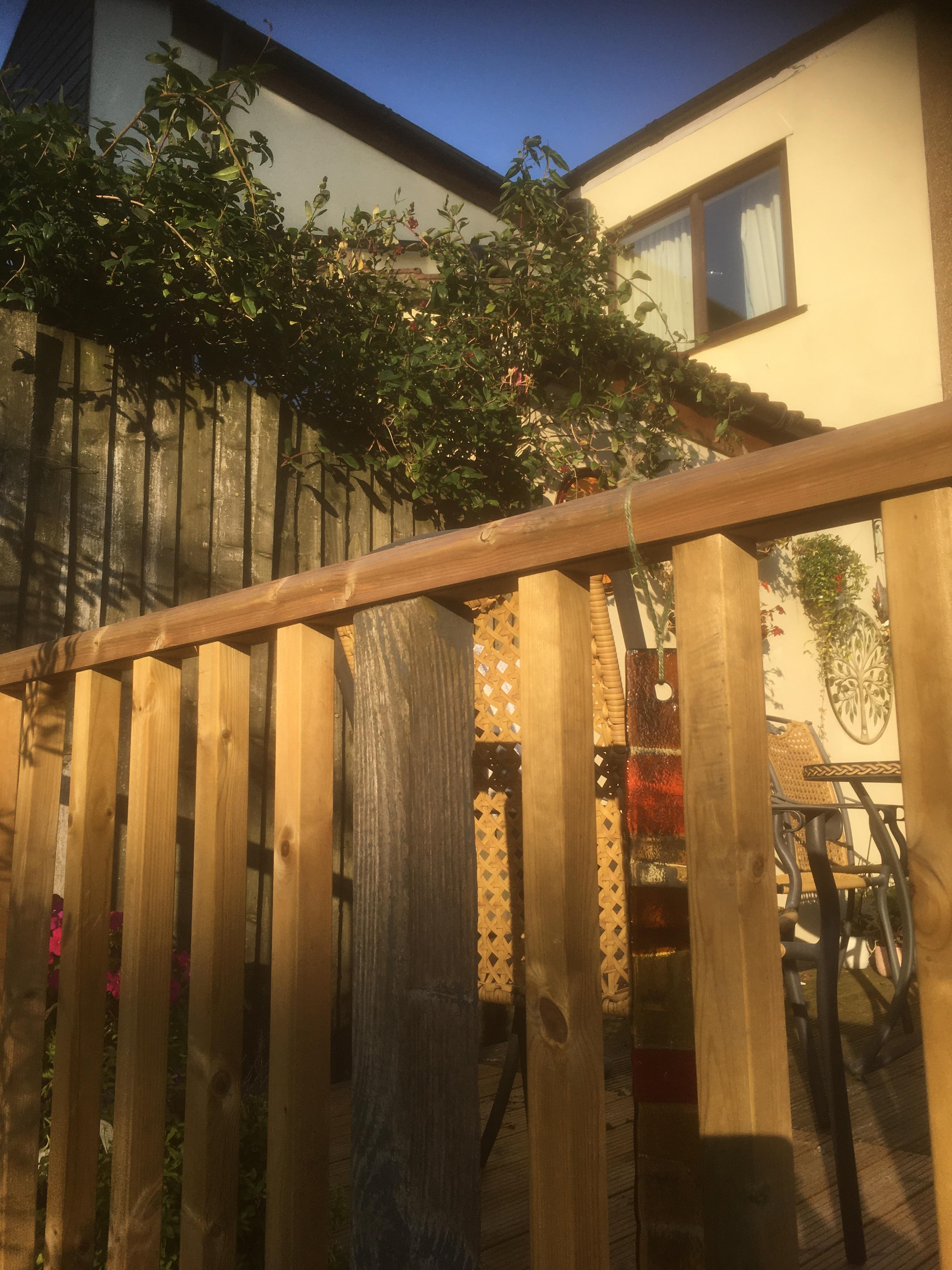

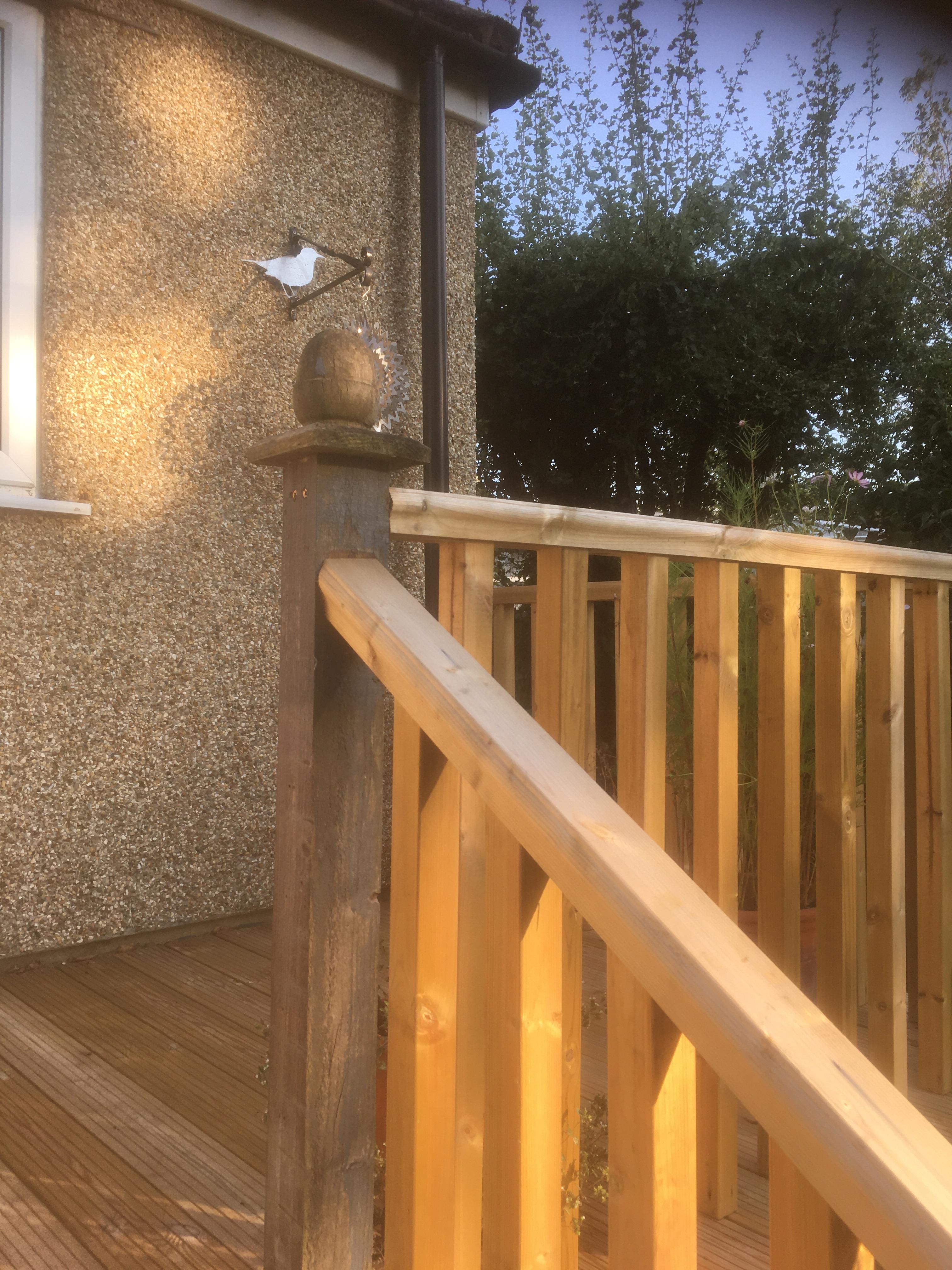

joe90 Posted September 13, 2022 Posted September 13, 2022 I recently built my brothers decking and handrail and spindles like @PeterW says above is the best/easiest way, the handrail comes with spacers as well, just modify the corner posts to sit the rail on, my brothers posts were also 4x4 👍

TonyT Posted September 14, 2022 Posted September 14, 2022 Your posts are 4x4, so you want something to cover the end grain, and have a bit of reveal so 6x2 is off the shelf giving 1” either side of the post.
zoothorn Posted September 14, 2022 Author Posted September 14, 2022 6 hours ago, TonyT said: Your posts are 4x4, so you want something to cover the end grain, and have a bit of reveal so 6x2 is off the shelf giving 1” either side of the post. Hi TT, I got it wrong.. I'm gonna be using 3x3 ( I forgot joe90 thought 4x4 a bit chunky) as an afterthought. I think I'm narrowed to a deck board as choice then, being 5 wide. Not bad if I upside-down it: it's got many more smaller ridges than the top's 10x or so. What would you suggest I attatch the notched thin bit of these posts, to the side of the frame with? Turbo jobs, or a bit unsightly-? Thanks
Onoff Posted September 14, 2022 Posted September 14, 2022 The flat deck board will fill up with sh!t, water will lie in/on it and it'll go green. It needs a chamfer for water to run off. If using 3" posts I'd use 5x2, so 1" overhang. Me being me I'd chamfer the top. Tbh buy from a wood yard and they'd do for a couple of quid if you can't. I'd sit them on the 3x3 posts, draw around them underneath and route a 3/8" or so deep pocket. Thus the handrail locks onto the upright. Secret screw from above using some stainless screws.

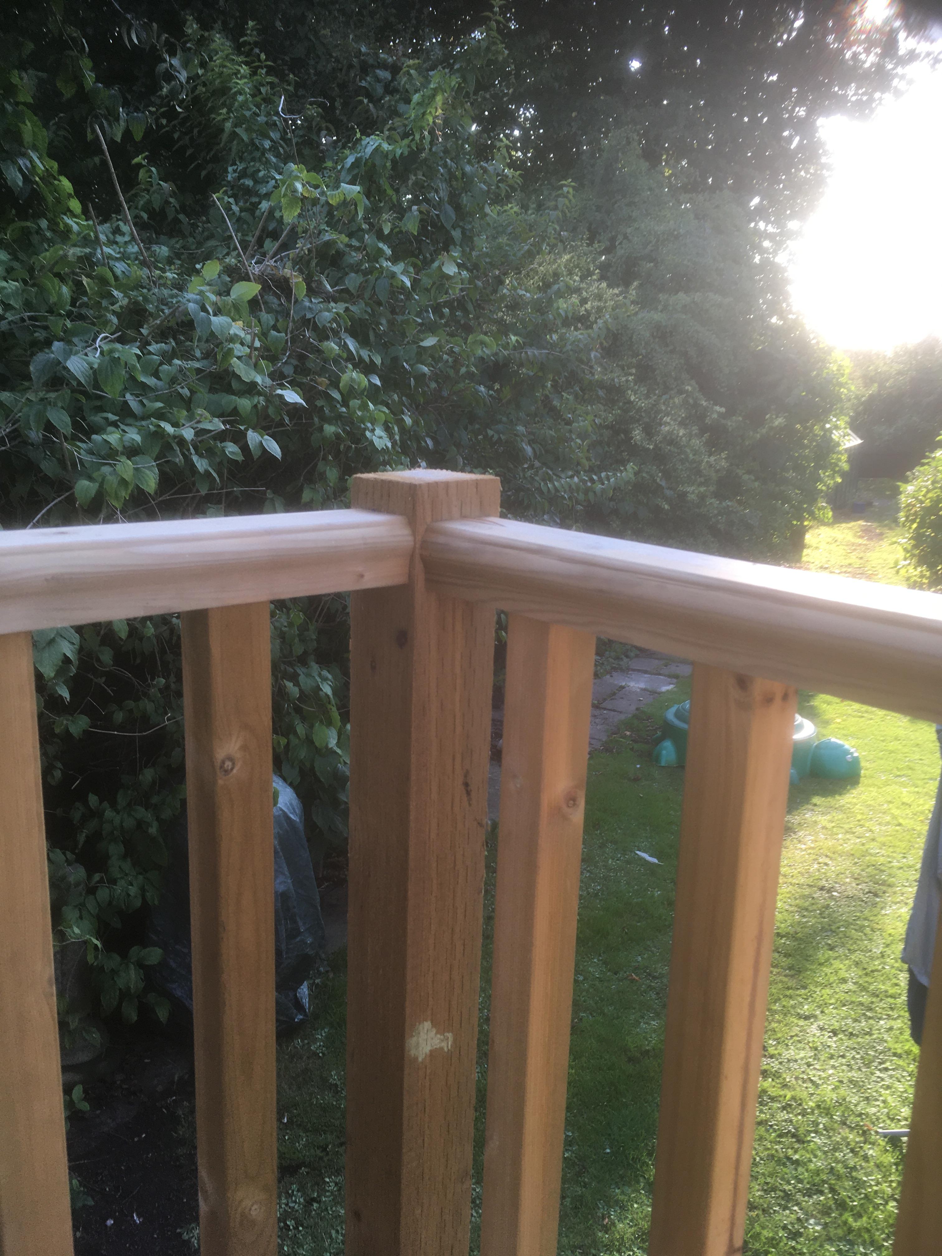

joe90 Posted September 14, 2022 Posted September 14, 2022 Just visiting my brother and thought I would show @zoot some photos of the posts/rail etc. ( still not finished the post tops yet). 2

zoothorn Posted September 14, 2022 Author Posted September 14, 2022 28 minutes ago, TonyT said: 5x2 for me then. use a https://www.screwfix.com/p/erbauer-plug-cutter-countersink-set-4-pieces/6418V?kpid=6418V&ds_kid=92700055262507123&ds_rl=1244066&gclid=EAIaIQobChMIlLSdqYCV-gIVSrDtCh2BBA07EAQYASABEgIBU_D_BwE&gclsrc=aw.ds so drill a hole, screw down as normal, make a plug, glue plug in hole, chisel/sand flat. l get the idea of the plug cutters etc. Good idea. Actually I have both these cutter & countersink whatnots too. @joe90 useful pics thanks, & would look best. I was looking at these in the yard today, with the spindles made to fit the recess too. Thing is though.. spindles were 900mm, the handrail ontop like your pic say 80mm, means I'm 120mm short for building regs. This is the reason for having to think otherwise, IE I need spindles 1020mm for this handrail, plus in between bits for the deck to fix them too. Its alot more complicated. And costly. I think its gonna have to be 4x2 ( fix onto 3x3, should be ok) & chamfer the edges. I think @Onoff right that a deck board will warp @only 1" height. Thanks, zoot
