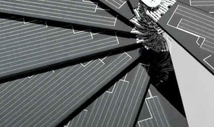

Siochair Posted May 31, 2022 Posted May 31, 2022 Just came across this set-up and thought it looked interesting. It’s not available in the UK yet but I imagine it will be available in due course. https://smartflower.com/
SteamyTea Posted May 31, 2022 Posted May 31, 2022 Fantastic, they show the built in shading. All we need to go with it is a wind turbine that has blades designed similar to a sycamore seed.
Carrerahill Posted May 31, 2022 Posted May 31, 2022 Gimmick. No tech spec in sight. Don't see this taking off. Bet it costs more than the equal power density installed on the roof out the road which will look better and can be upgraded using off the shelf panels. 1

Ferdinand Posted June 1, 2022 Posted June 1, 2022 There are a lot of strange solar proposals around in response to the increased electric prices, quite often puffed by bits of media as Gee-Wizz products. The ones I have seen are usually less than half efficient than basic panels. Isn't this one similar?
SteamyTea Posted June 1, 2022 Posted June 1, 2022 2 minutes ago, Ferdinand said: There are a lot of strange solar proposals around in response to the increased electric prices, quite often puffed by bits of media as Gee-Wizz products. The ones I have seen are usually less than half efficient than basic panels. Isn't this one similar? There is 3.2 kW for 18m2. So 178 W/m² A good module a decade ago would have been about the same (285W, 1m by 1.6) For the same amount of unshaded area a roof mounted system would take up 11m2. A circle of modules would have a diameter of about 3.7m (almost as wide as my house). 1
