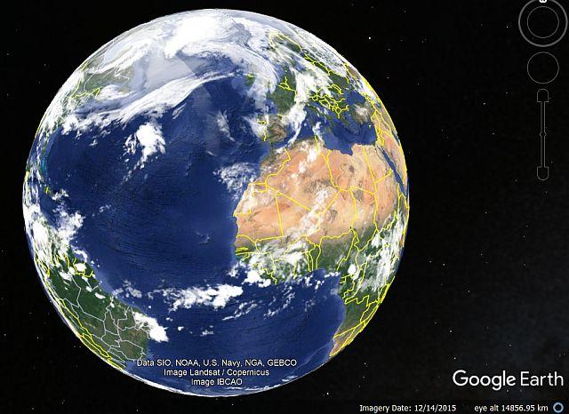

Not strictly true as in the UK, which is in an odd location, we are more affected by sea surface temperatures and wind direction.
The reason that solar irradiation is reduced is because the sun's photons have to pass though a longer path through the atmosphere due to the tilt of the Earth, and they then hit the land/ocean at an oblique angle, which, in effect, spreads the power out over a larger area.
Cloud cover also makes a huge difference, clouds can form in a number of ways, but are usually a combination of tempratre,, air pressure and humidity (why exceptionally warm oceans can cause more clouds and rain at higher latitudes). The solar constant, 1.361 kW.m-2 does not vary much (actually goes up slightly during the Norther Hemisphere winter, and is not a constant in the true scientific term, just an average, adjusted to 1 AU). This is why having a steep angle on the roof can be useful for winter PV production.
The reason that solar irradiation is reduced is because the sun's photons have to pass though a longer path through the atmosphere due to the tilt of the Earth, and the then hit the land/ocean at an oblique angle, which, in effect, spreads the power out over a larger area.  This is why having a steep angle on the roof can be useful for winter PV production.
My comment was meant as a general observation about winter (you're right about the reason why).  In the UK there are mitigating factors due to our proximity to the Gulf Stream; otherwise winters would be even colder!
I wish the Gulf Stream would stop, cloudy this morning.
Atlantic Meridional Overturning Circulation is the posh term.
Clouds are interesting as we think of them as cooling the UK, they cool between the tropics more, and we would be in real trouble if there was less of them.
