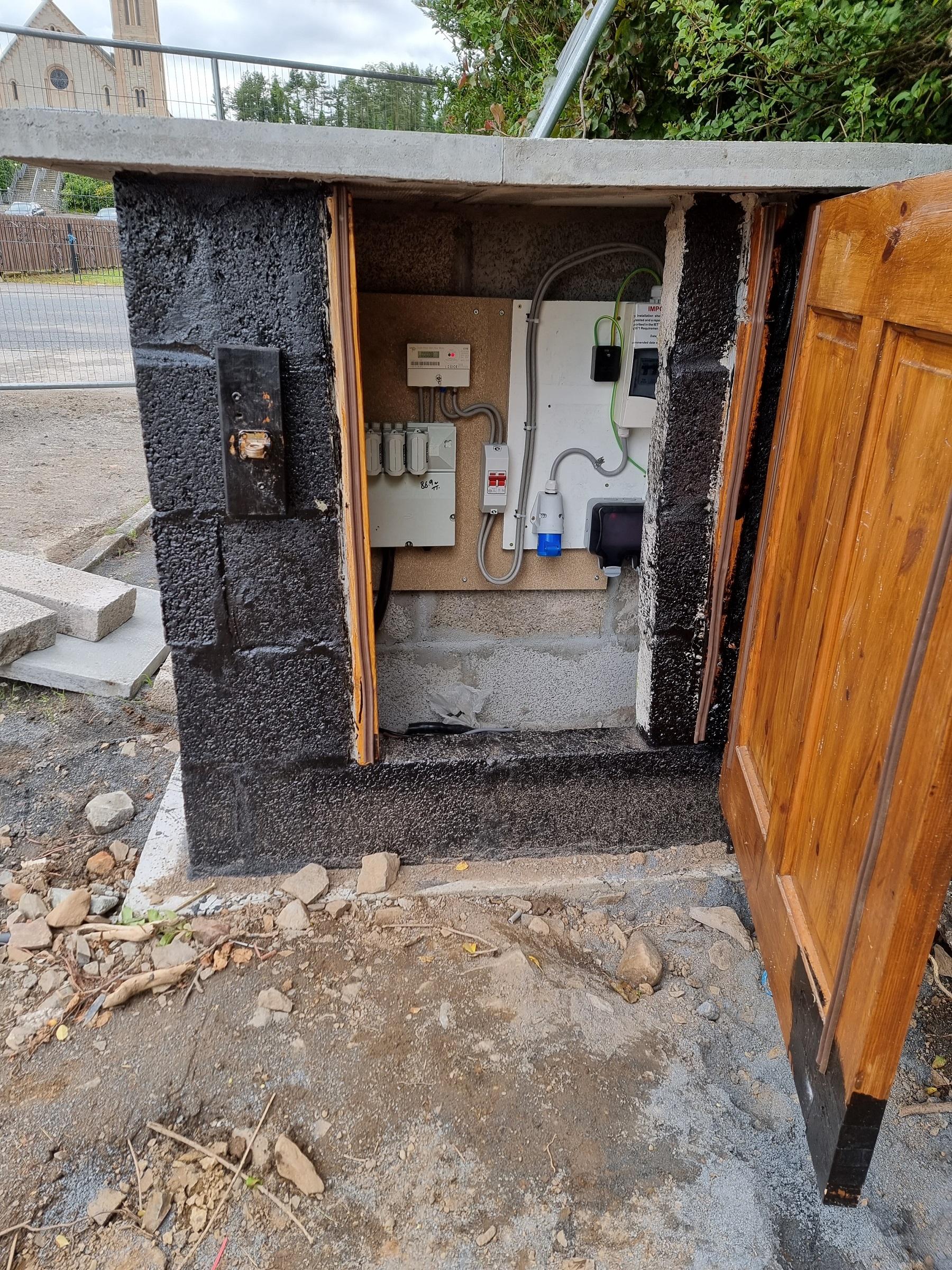

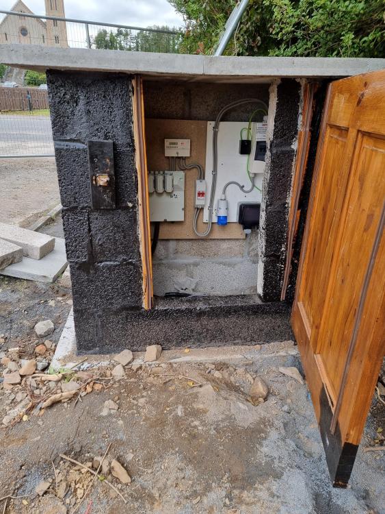

The spark needs to have everything done - rcbo, main fuse, earth, meter tails etc in place before NIE install the meter and energise your connection. They'll still pull and connect the cable cable even if you haven't got the earth in.
This was how ours looked after the cable was pulled but before the meter was installed.

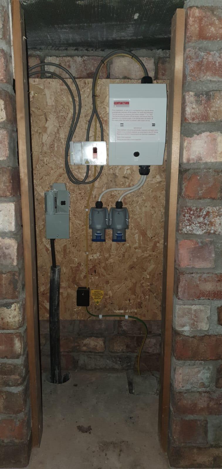

.. and thanks for the pics inside your 'kiosk'.  NIE rules are harsh for commando sockets and brick barbies.

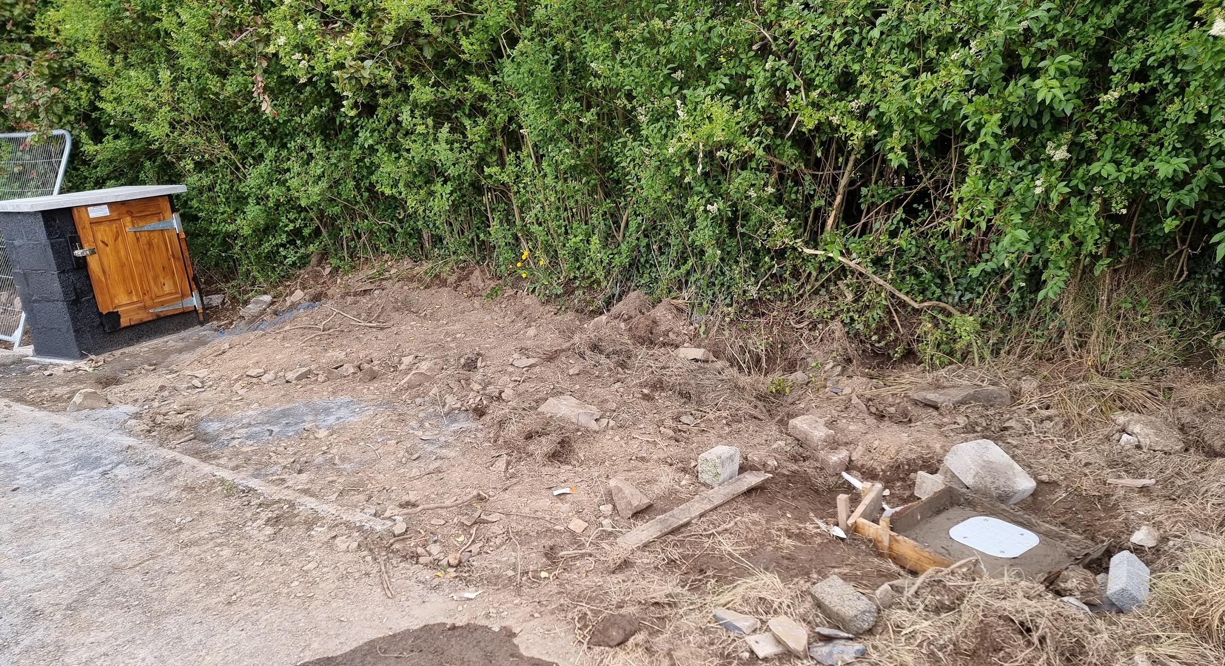

Just to wrap this up, my electrician dismissed my concerns about getting the earth rod in. It will be a piece of cake he said.
I didn't feel quite so foolish however when he tried and failed to drill into the ground anywhere along the front and side boundary, hitting rock every time.
The only option was to get the demo firm to break through the rock to dig a big hole near the tardis to sink a rod.  Even this proved a challenge but we got there in the end with a hole about 6 metres from the meter box.
Power was finally connected at the end of June.
