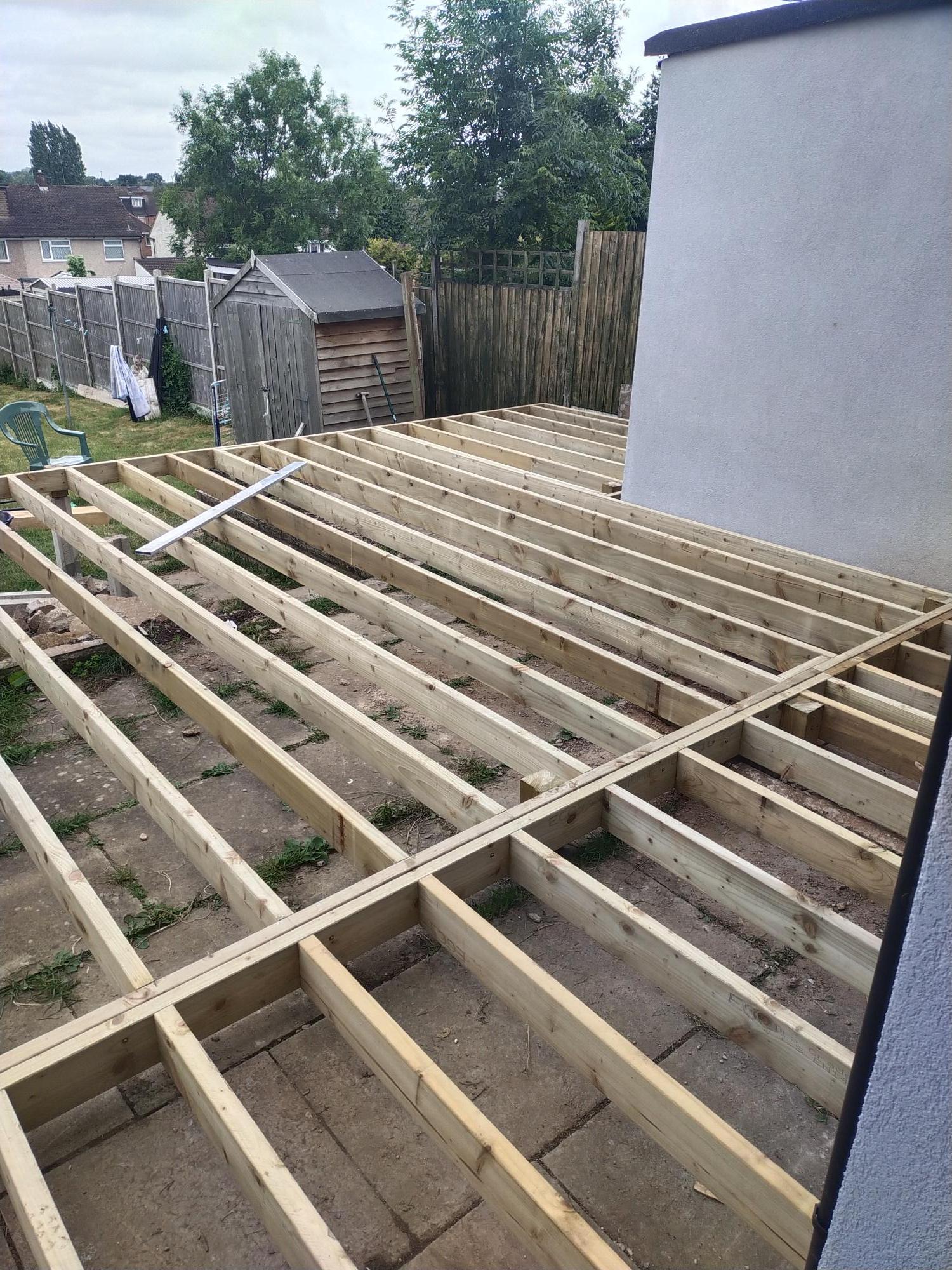

bar2345 Posted May 14, 2022 Share Posted May 14, 2022 Hi all, I will build composite decking at the beginning of June, 52m2, will be installed on the existing patio on slabs. Slowly preparing everything. Frame will be wooden, joists 6x2 treated tanalised c24, my question is: Is there anything I can use to extend the life of joists? Will use decking tape on top, but what about the rest? Bitumen paint doesn't have good recommendations, maybe some wood preserver? pine tar oil? or maybe normal fence paint goood enough? Link to comment Share on other sites More sharing options...
Temp Posted May 15, 2022 Share Posted May 15, 2022 Welcome to the forum. There are composite joists as well but quite expensive.. https://ecodek.co.uk/product/ecodek-super-stiff-composite-joists https://build4less.co.uk/products/composite-decking-joists-plastic?variant=31679927976032 If it doesn't need to be 150mm tall there are cheaper lower profile composite battens for use where decking is going something like an existing concrete slab. Lower height also avoids needing planning permission. Link to comment Share on other sites More sharing options...
Conor Posted May 15, 2022 Share Posted May 15, 2022 Plenty of air circulation underneath and dpc under the joists where they rest on top of the support pads. Fyi 4x2 is normally more than enough for a deck, as you can put plenty of support pads in. Link to comment Share on other sites More sharing options...

Radian Posted May 16, 2022 Share Posted May 16, 2022 On 14/05/2022 at 21:57, bar2345 said: Hi all, I will build composite decking at the beginning of June, 52m2 Are you going to take out a Mortgage to pay for that? 🤣 I keep meaning to start a topic on the eye-watering cost of composite decking and how the financial side stacks up. But yes, as Conor mentions, good air circulation is probably the most effective measure for preserving the 6x2s. But are you planning to rest them directly on the patio slabs or space them off with something? Link to comment Share on other sites More sharing options...
bar2345 Posted May 16, 2022 Author Share Posted May 16, 2022 3 hours ago, Radian said: Are you going to take out a Mortgage to pay for that? 🤣 I keep meaning to start a topic on the eye-watering cost of composite decking and how the financial side stacks up. But yes, as Conor mentions, good air circulation is probably the most effective measure for preserving the 6x2s. But are you planning to rest them directly on the patio slabs or space them off with something? Yeah it will be expensive 😀 It will be directly on slabs, unless you know better solution? Link to comment Share on other sites More sharing options...
markocosic Posted May 16, 2022 Share Posted May 16, 2022 Keep it dry. Airflow underneath it. Don't rest it in "waterproof bowls" of supports. Do rest it on a piece of DPC where the supports are porous (e.g. concrete) and ensure that the DPC is 'n' shaped not 'u' shaped. Cut ends to hang in "fresh air" - you support the beams some distance back from the cut edge so that the bit that might be touching water is side grain. Consider something on top of it - especially the cut edge - such as a strip of roofing felt (easier than DPC as sticks in place) again in an 'n' shape to shed water. Other than being kept dry you shouldn't need to do anything with tanalised timber. Here's ours (my wife has since been introduced to the concept of a straight edge) with some leftover acrylic facade paint (got frozen in winter so not much good but very sticky) holding the bitumen down until the deck boards are fitted. Water falling through the gaps in the deck drip-edges off bitumen onto either the floor or another piece of bitumen and then the floor. (noggins make an enormous difference to stiffness; install near the bottom so that they're clear of your deck boards) If you have any posts that are just in compression the threaded feet are excellent for keeping them dry and levelling them. Consider cleaning. How are you going to hose cat / fox piss and shit out from under the deck when they move in? Leaves that blow in under the deck? You might want some 1/2" mesh dug into the ground and fixed to the bottom of the deck edge to keep the wildlife and leaves out. 1 Link to comment Share on other sites More sharing options...
markocosic Posted May 16, 2022 Share Posted May 16, 2022 Directly on slabs - no. Adjustable feetsicles make life easy: https://timberfixings.com/store/Eurotec-Adjustable-Decking-Pedestal-ECO-M-Adjusts-from-35mm-up-to-65mm-p50614257 Or slice up something that doesn't rot with chopsaw and stick a piece of DPC on top if you're being cheap. Timber doesn't sit on paving slabs directly. Link to comment Share on other sites More sharing options...

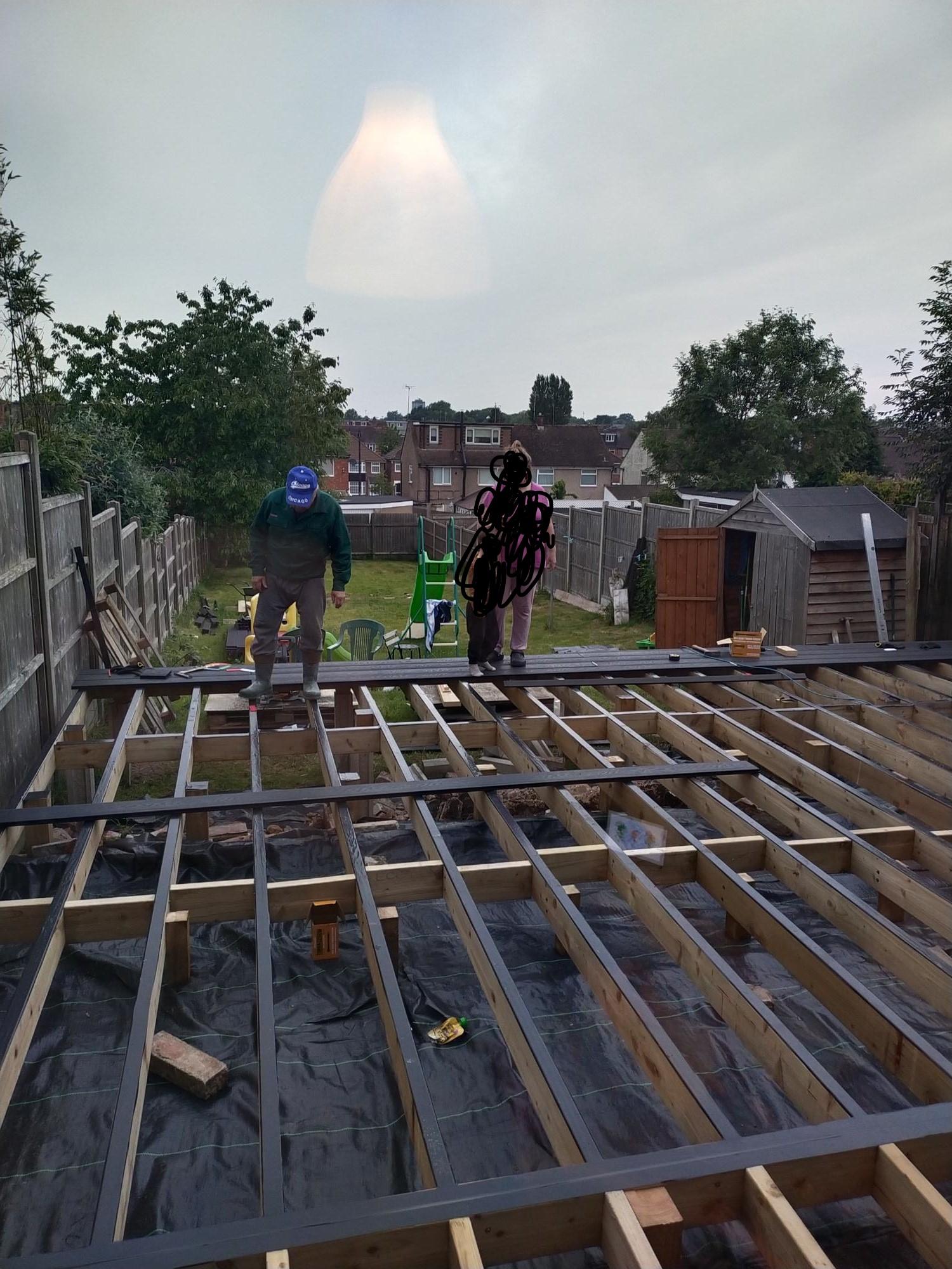

bar2345 Posted May 28, 2022 Author Share Posted May 28, 2022 What lenght of structural screws will be good to attach joists to ledgers? 100mm or 150mm? or 125mm? Link to comment Share on other sites More sharing options...
Dave Jones Posted May 29, 2022 Share Posted May 29, 2022 19 hours ago, bar2345 said: What lenght of structural screws will be good to attach joists to ledgers? 100mm or 150mm? or 125mm? use galv nails they are stronger. 90mm Link to comment Share on other sites More sharing options...
JohnMo Posted May 29, 2022 Share Posted May 29, 2022 21 hours ago, bar2345 said: What lenght of structural screws will be good to attach joists to ledgers? 100mm or 150mm? or 125mm? You be using hangers according to most design guides I have read. design_a_deck_planning.pdf Link to comment Share on other sites More sharing options...

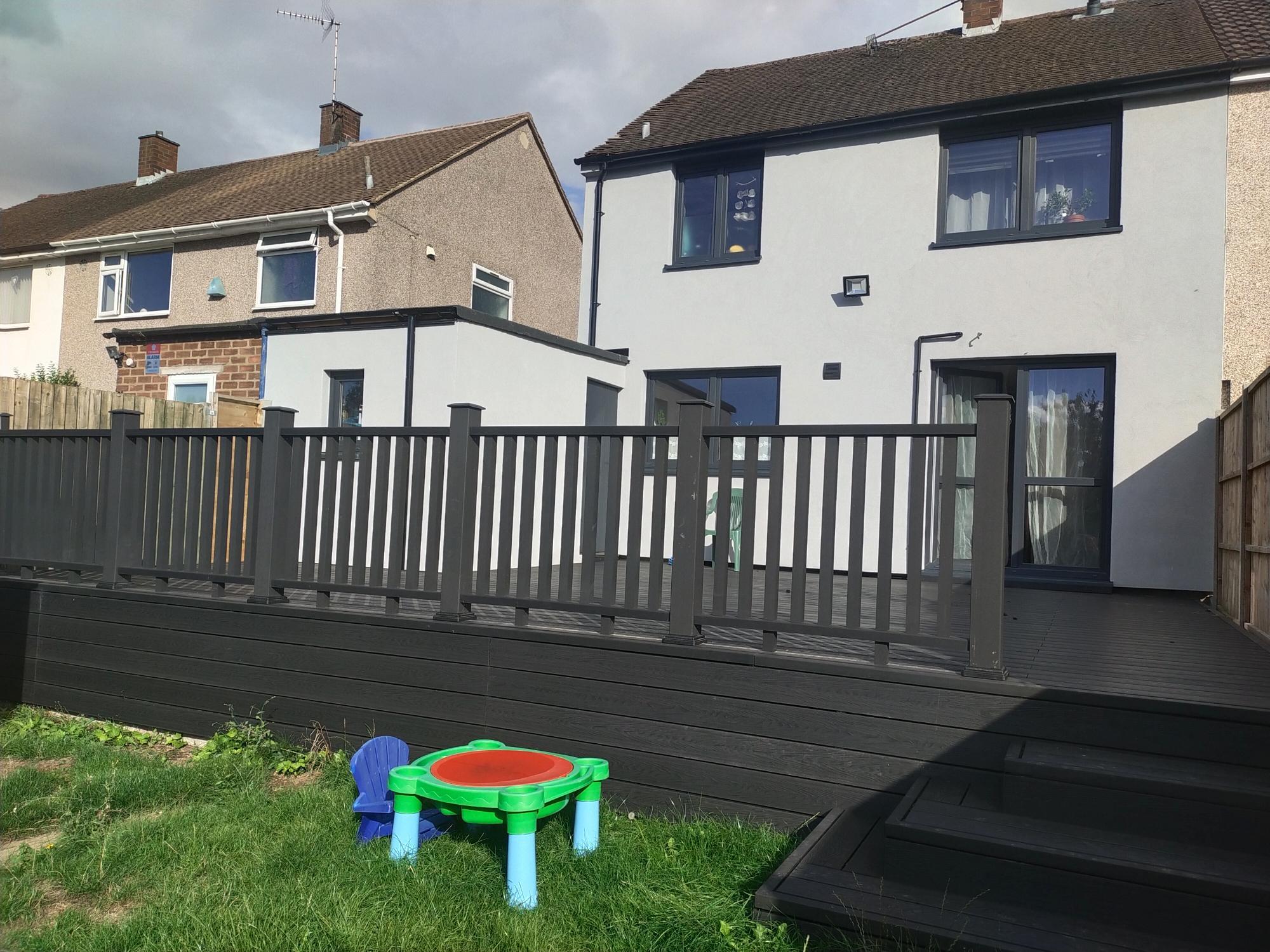

bar2345 Posted September 10, 2022 Author Share Posted September 10, 2022 Project done!!! Took 2 weeks, a lot more effort than I expected but was worth it. 1 Link to comment Share on other sites More sharing options...
Radian Posted September 10, 2022 Share Posted September 10, 2022 Looking good! How do you rate the Dura-tec composite deck boards? They seem a fair bit cheaper than others I've looked at. Link to comment Share on other sites More sharing options...
bar2345 Posted September 10, 2022 Author Share Posted September 10, 2022 25 minutes ago, Radian said: Looking good! How do you rate the Dura-tec composite deck boards? They seem a fair bit cheaper than others I've looked at. This is my first decking ever done so hard to say, I didn't have any issues with it. Probably need a few years to make a judgement. One thing that I notice is when you walk on it without shoes you will have your feet black, don't know if that is normal for composite decking Link to comment Share on other sites More sharing options...
