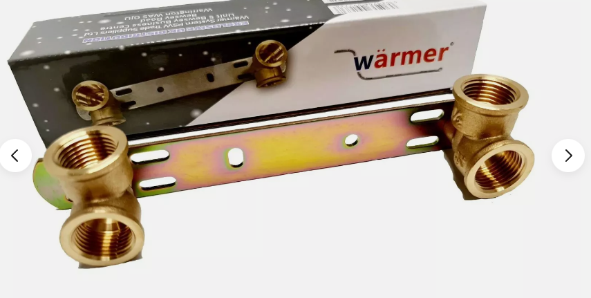

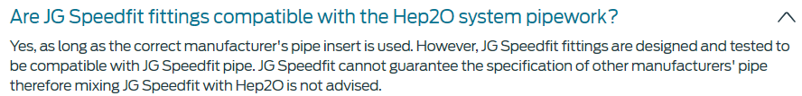

A major weakness in the Hep2O system is the lack of a brass wall plate elbow. They use to do them, but now only do the plastic ones (£7.90) which just aren't up to the task in my mind. JG Speedfit do a brass wall plate elbow (£11.23) and I have seen installations that use these with everything else being Hep2O. JG Speedfit make a slightly mixed statement about compatibility, but that feels like the lawyers got involved when in reality they are compatible.
image.png.d993d94bbc747ec62754b979274e1573.png  image.png.e66a502ebd21f4b76177377c1d606e88.png
An alternative would be to use a Hep2O straight coupler onto a short length of copper pipe and then a brass wall plate elbow (e.g. compression). That's extra joints and expensive if you're buying copper pipe just for that bit. If you have lot's to do, then you would be looking at:
  • Hep2O Plastic Push-Fit Equal Coupler 15mm £1.75
  • 100mm of copper pipe £0.30
  • Brass Compression Adapting 90° Wall Plate Elbow £2.80
So £4.85 total which is £3 cheaper than the Hep2O plastic wall plate elbow. It has two extra joints though which is not ideal as adds two extra potential failure points.
I used a Hep2O Plastic Push-Fit Adapting Male Coupler 15mm x 1/2" (£4.85) into a 1/2" x 1/2" wall plate elbow (~£4) which was hard to find.
Edited by MortarThePoint
Add other JG Speedfit image (toolstation)
4 hours ago, Russell griffiths said:
Why the compression wall plate, end feed and solder it.
then straight coupler.
Yes, could do that way too. Probably better as I have just seen that some people advise against inaccessible compression fittings which makes sense.
What exactly is this wall plate for?
The only thing I've used one for is an outdoor tap and then it's been MDPE.
transitioning from hep to copper and bringing pipework out of the wall neatly at a guess.  Well it was when I was playing at plumbing!
When fitting these in bathrooms, I use the compression ones with a short piece of copper and then Hep2O on to the copper. The pressure there is low because it’s feeding an open-ended outlet, so it’ll never see static cold mains pressure anyways.
I use brass for strength, but I’ve also used a brass compression 15mm tee with a 1/2” centre Link with a 4-6” piece of copper in each side. One side as the feed, and then the other end to a hep cap end with 2 clips either side of the tee to hold it all steady. That was for a heavy shower arm where I wanted a bit more ‘beef’ to the fixing methodology.

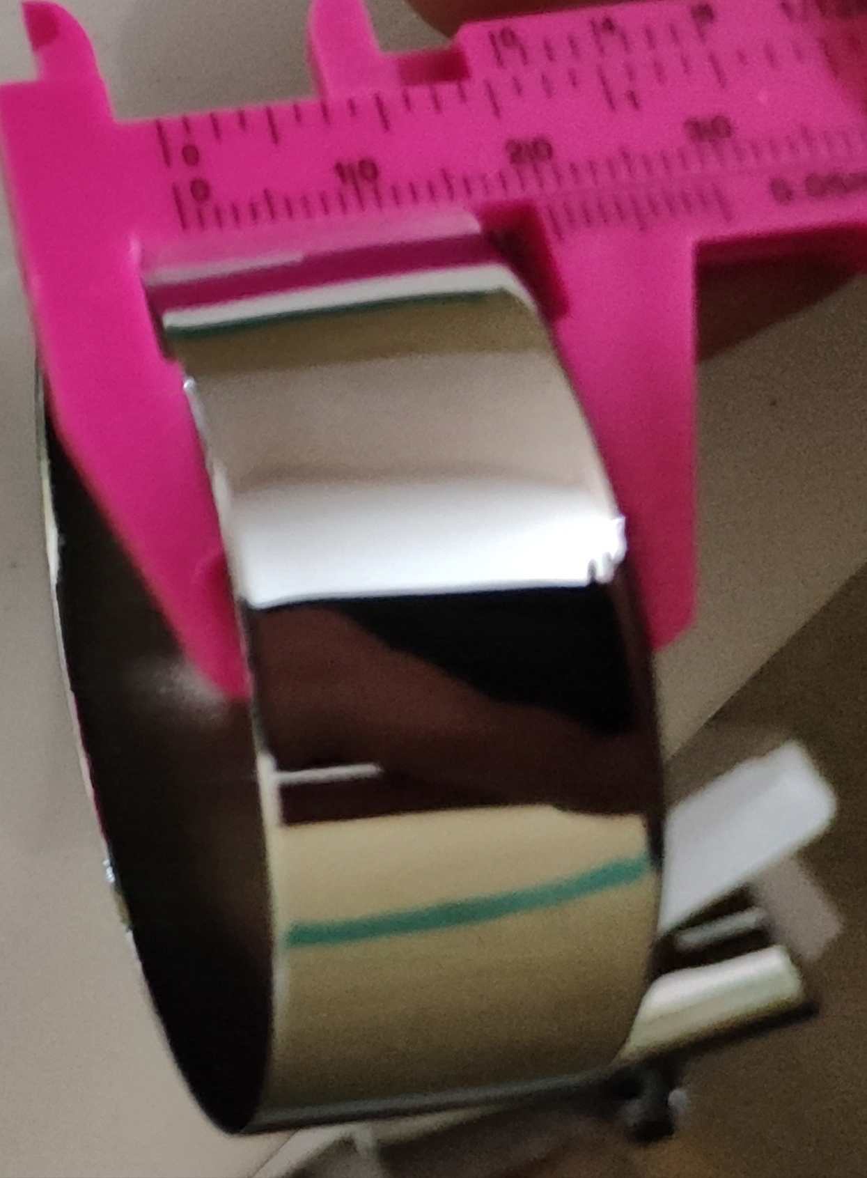

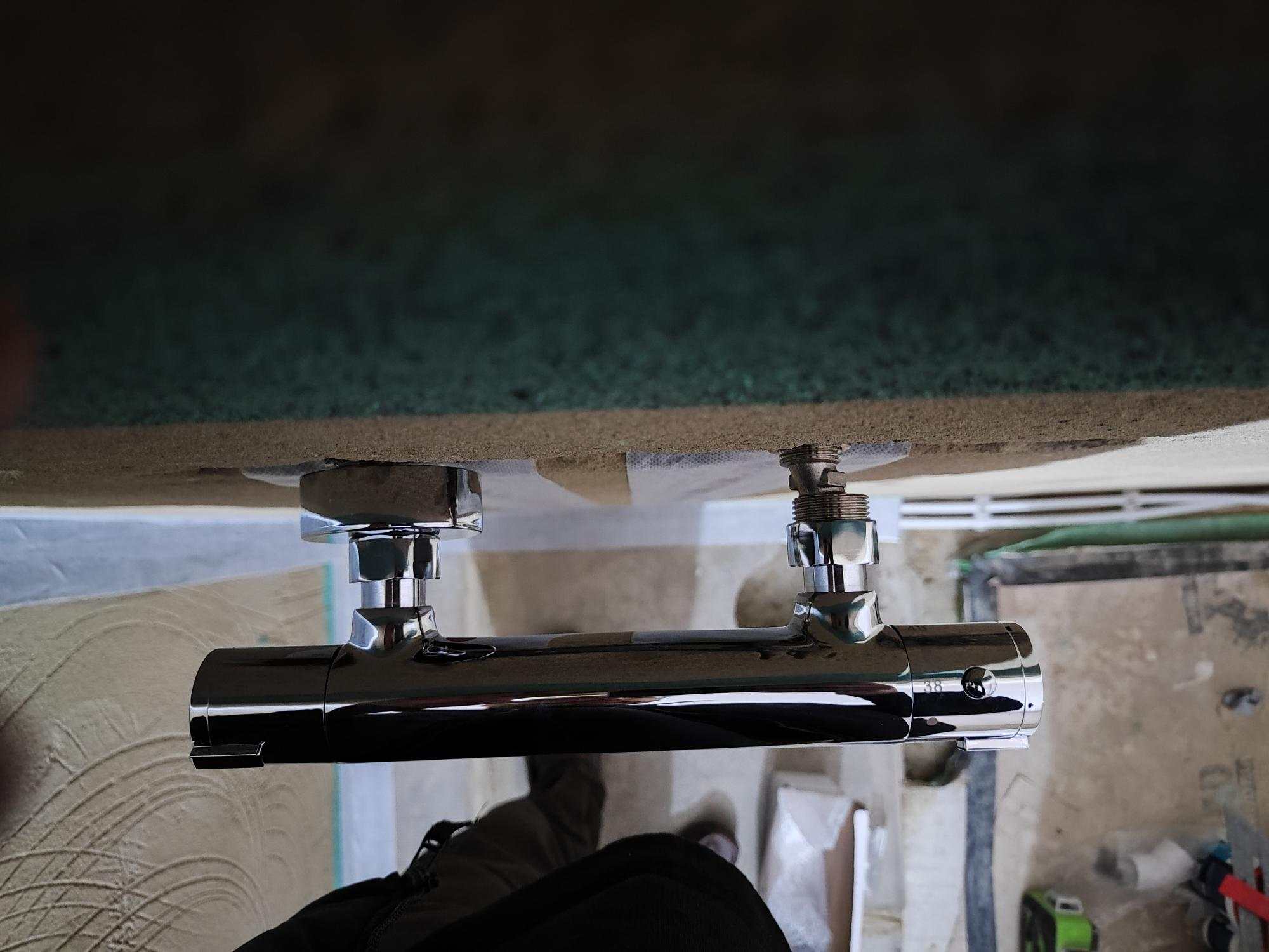

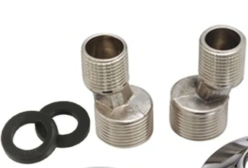

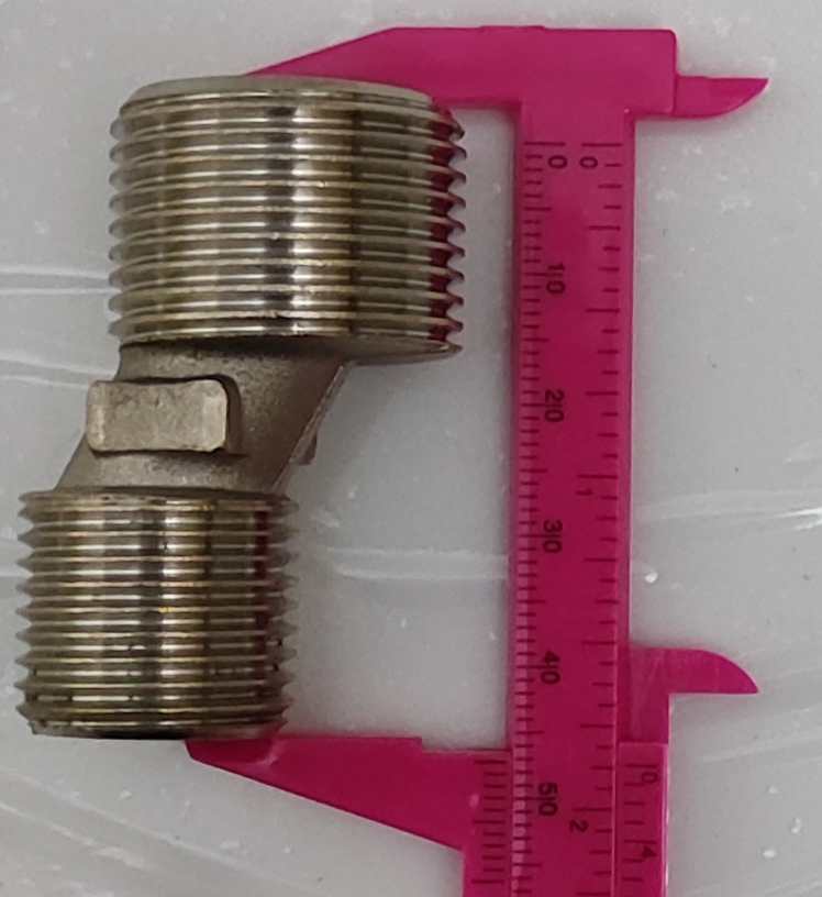

Using this with the Hep2o fittings / pipes at or below the surface of the blockwork means that the female thread is about level with blockwork surface. That means once tile is added, the thread is recessed quite a bit (10 - 15mm). How do you hand that so that you can then use a standard mixer bar with its offset connector thingies (shown below)? The ones I have don't accommodate going much behind the included cover.
Here's a photo of it screwed together and the cover is tight to blockwork so no space for tiles
For my shower handset connection I used the Alfie fixing which I saw on a Skillbuilder promotional video with Robin Clevett. There is an option for Hep20 compatible connection.
Edited by Nick Laslett
I had exactly this issue !
it was a pita and I brought the entire fitting forward in situ just to gain a few mm for the tiles .
