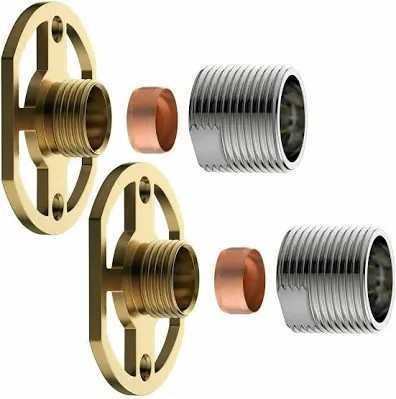

October 29, 20242 yr Author 10 minutes ago, Onoff said: Would these give more length? https://www.screwfix.com/p/tesla-brass-compression-adapting-flexible-tap-connectors-15mm-x-1-2-2-pack/2665r I wondered about going that route and then using a tails connection kit (image below). I'm not confident there is enough meat in the blockwork around this though to get the securing screws in for that though.

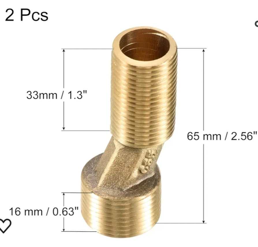

September 3Sep 3 Author Somewhat amusingly, I have now ended up with the opposite problem. The offset connectors supplied with the mixer are 46mm long and it all now sticks out too far for the threads to get fully covered. The face of the brass BES extension is flush with the surface of tile and they have a short thread section so don't allow the offset connector all the way in. That leaves two options: PREFERRED: shorter offset connector of around 40mm or 35mm. https://www.amazon.co.uk/HanOaki-Connector-S-Adapter-Adjustable-140-160mm/dp/B0G2S1W4DQ/ deep covers like the image in the post just before this one. (NB: the Aliexpress link doesn't work anymore but a reverse image search on their site finds similar).
September 3Sep 3 Author 11 minutes ago, Nickfromwales said: Cut them down to length? That’s what I have had to do on some previous retrofits. With an angle grinder?
September 3Sep 3 32 minutes ago, MortarThePoint said: With an angle grinder? Belt sander would make relatively quick work if you want something more precise. Flap disk also probably less intimidating if you have a vice to hold the part. Lots and lots of options depending on your comfort level.
September 3Sep 3 4 hours ago, MortarThePoint said: With an angle grinder? I always use a hacksaw and file for things like that. More forgiving.
September 3Sep 3 10 hours ago, MortarThePoint said: With an angle grinder? That’s what I use, but you need to have a straight cut and then file the face flat afterwards. Rubber seals are quite forgiving tbh.

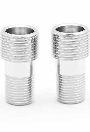

September 30Sep 30 Author Well I thought I was on to a good thing. I used a 1/2 brass nipple and the 1/2 ID 3/4 OD silver adaptor from the setup @Iceverge suggested. cover plate screwed on beautifully. Annoyingly, the threads are too close together! I used the back plate below so the spacing should be perfect, but something hasn't worked out right (checked that two shower mixers don't fit). I don't know if the bar got bent slightly and has the threads angled towards each other? I guess it's back to the blasted cranked connectors. Edited September 30Sep 30 by MortarThePoint
September 30Sep 30 14 hours ago, MortarThePoint said: Well I thought I was on to a good thing. I used a 1/2 brass nipple and the 1/2 ID 3/4 OD silver adaptor from the setup @Iceverge suggested. cover plate screwed on beautifully. Annoyingly, the threads are too close together! I used the back plate below so the spacing should be perfect, but something hasn't worked out right (checked that two shower mixers don't fit). I don't know if the bar got bent slightly and has the threads angled towards each other? I guess it's back to the blasted cranked connectors. What are the pipe centres that you have? 150mm is the target, so how far out are you?
October 1Oct 1 Author 9 hours ago, Nickfromwales said: What are the pipe centres that you have? 150mm is the target, so how far out are you? I measure 148mm at the threads in the wall and then 147mm when I add the nipple&adapter: Edited October 1Oct 1 by MortarThePoint
October 1Oct 1 6 minutes ago, MortarThePoint said: I measure 148mm if my tape measure Ok. So is this just because these are not parallel and are not pointing ‘straight out’? If so, you can buy a piece of metal bar with a 1/2” BSP thread, and screw that into the brass fitting. Something like THIS with a large screwdriver poked into it for some more leverage if necessary. Then use that to strong-arm the fittings into compliance. Tweak a bit of one, then a bit of the other, and you’ll get it to work.
October 1Oct 1 Author 3 minutes ago, Nickfromwales said: Ok. So is this just because these are not parallel and are not pointing ‘straight out’? If so, you can buy a piece of metal bar with a 1/2” BSP thread, and screw that into the brass fitting. Something like THIS with a large screwdriver poked into it for some more leverage if necessary. Then use that to strong-arm the fittings into compliance. Tweak a bit of one, then a bit of the other, and you’ll get it to work. I think that's right, they are at a slight angle to each other. They're obviously tiled in and there is tile adhesive around them which makes me a bit nervous of strong arming them Edited October 1Oct 1 by MortarThePoint
October 1Oct 1 Author I tried it will a 100mm long version (no screw driver) and applied quite a lot of force and there was zero movement unfortunately
October 1Oct 1 Reverse a clamp head and use it as a spreader between the two? Couple of pieces of softwood against the threads to protect them? You may need to pick away at any visible adhesive and/or grout if they are really bedded in, but strange if they are. Edited October 1Oct 1 by garrymartin
