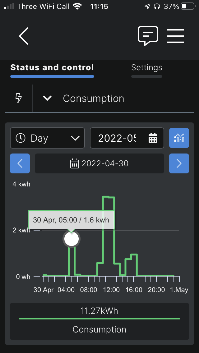

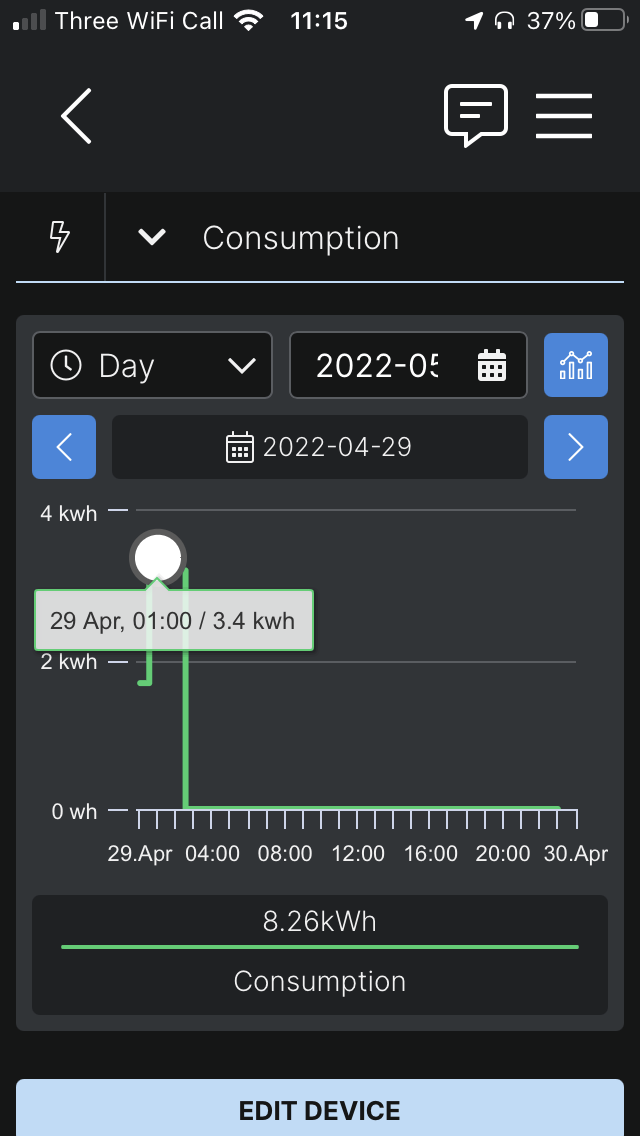

Russdl Posted May 3, 2022 Author Posted May 3, 2022 @PeterW This is a ‘normal’ days charging: Below is Saturday, I woke up early to find that the Shelly had tripped off for ‘over power protection’ every time I turned it back on (via the app) the kW’s increased rapidly from 3.1 to 3.5 at which point it tripped off. The same happened a bit later in the day until it finally stayed on to complete the charge: it’s back on now, supply voltage is 248.6V and the Shelly is registering 3.4kWh

joth Posted May 3, 2022 Posted May 3, 2022 4 hours ago, Russdl said: it’s back on now, supply voltage is 248.6V and the Shelly is registering 3.4kWh Partway through there you jumped from talking about kW to kWh. Which do you mean? The line graphs don't help explain much as they are (non accumulating) kWh against time which is mathematically befuddled
SteamyTea Posted May 3, 2022 Posted May 3, 2022 1 minute ago, joth said: The line graphs don't help explain much as they are (non accumulating) kWh against time which is mathematically befuddled CUMSUM is needed. @pocster claims it is terrific fun. 1
Russdl Posted May 3, 2022 Author Posted May 3, 2022 58 minutes ago, joth said: Partway through there you jumped from talking about kW to kWh. Which do you mean? I think I meant kW. My understanding of the line graphs is that you can see how much power was being consumed at a point in time and underneath the x axis it shows how much power was consumed in total.
