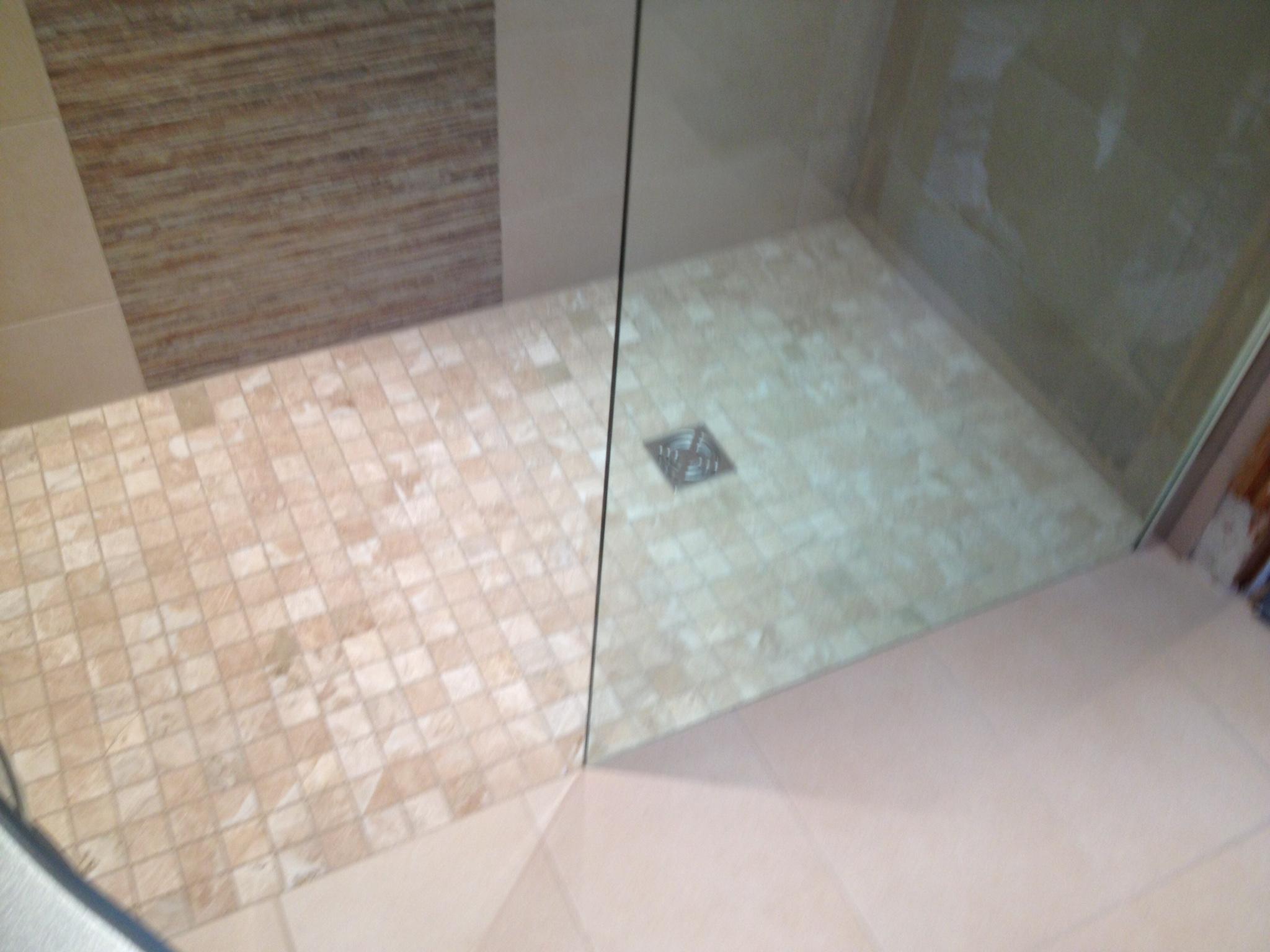

Nickfromwales Posted May 2, 2022 Posted May 2, 2022 (edited) 23 minutes ago, Mr Punter said: I have used CT1 instead of silicone for a worktop. It is a pain to finish nicely. It also discolours if you use clear or white. I have done many bathrooms with the shower screens bonded with the clear CT1 and never had any issues with discolouration. All very much on show so I'd have been pulled over it by now. The white does discolour, and should never be the finish left on show. Around the backs of WC pans etc I use the clear CT1 for fundamental sealant, wiped back slightly with baby wipes to leave a gap for a microban / forever white silicone sealant to go atop. When that gets a bit funky, it is very easy to strip and refresh. Edited May 2, 2022 by Nickfromwales 1
