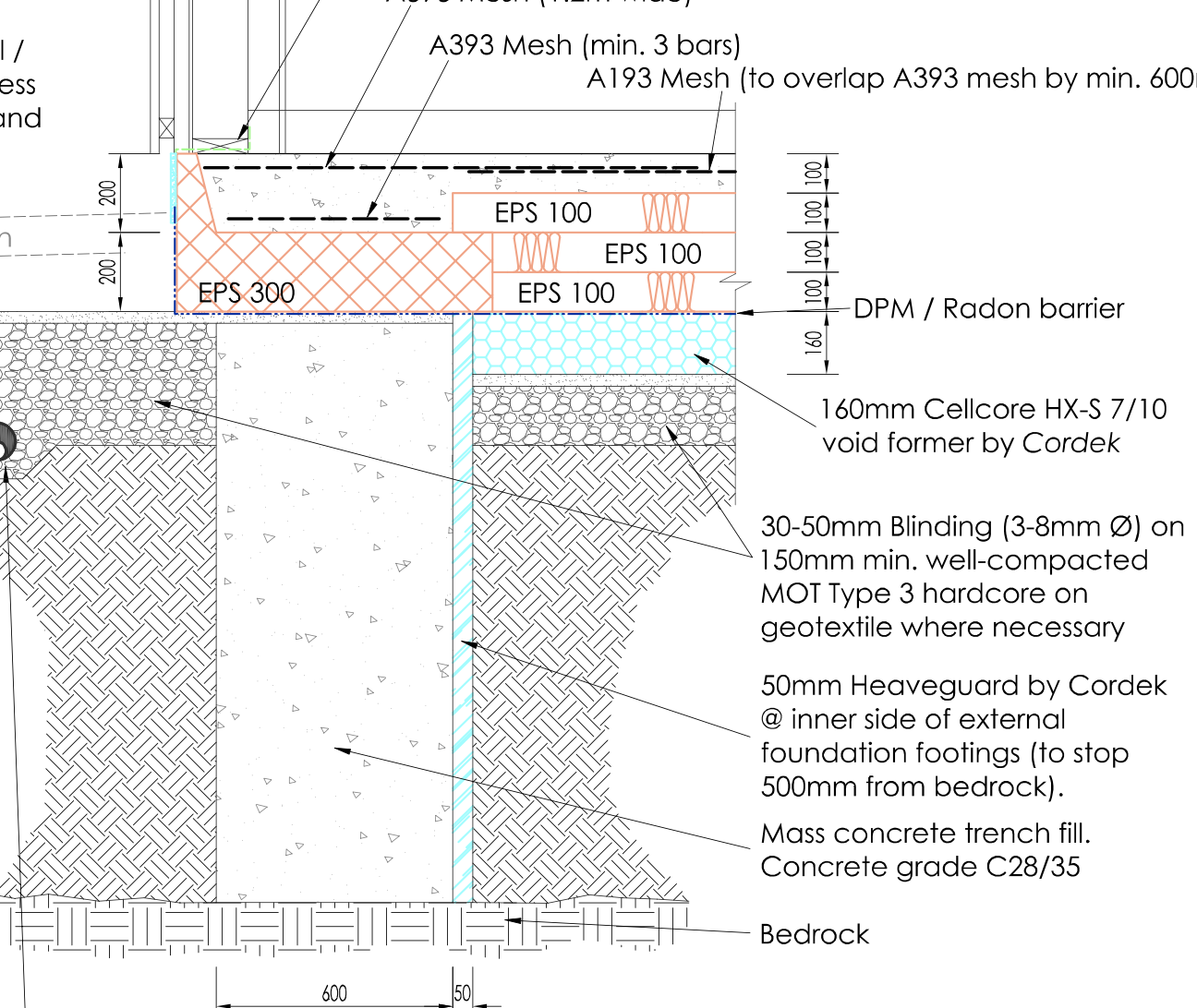

DannyG Posted April 26, 2022 Share Posted April 26, 2022 (edited) Hi all Due to our ground conditions (clay and nearby trees) our structural engineer has said we need a suspended floor and has specified traditional beam and block (we're going with a masonry build). I was really set on having a poured reinforced concrete slab so this is very disappointing . My main concerns are obviously the cold void underneath sucking heat away, lack of intrinsic airtightness in the blocks and also the "hollow" noise issue which I've had in previous houses with suspended floors. From looking around the forum I can see two potential options but I'm not sure how viable they would be in terms of cost and performance: 1. Insulated beam and block system like readytherm - we'd still have the void but the beams will be insulated and I assume this would also provide some sound proofing too. Would we still need a layer of PIR on top of the beams if using this? 2. Slab on top of Cellcore (https://cordek.com/products/cellcore-hx-plus) - this seems like it would completely solve our issue and allow us to continue with poured concrete. I'm not sure why my SE was adamant that there was no other option than traditional B&B when there clearly is but I don't want to go back to him with suggestions if these are deemed to be poor solutions. Edit: does Cellcore get tied into the slab somehow? I'm wondering what happens if the ground sinks rather than heaves and pulls it away from the slab. Edited April 26, 2022 by DannyG Link to comment Share on other sites More sharing options...

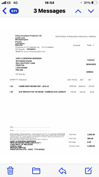

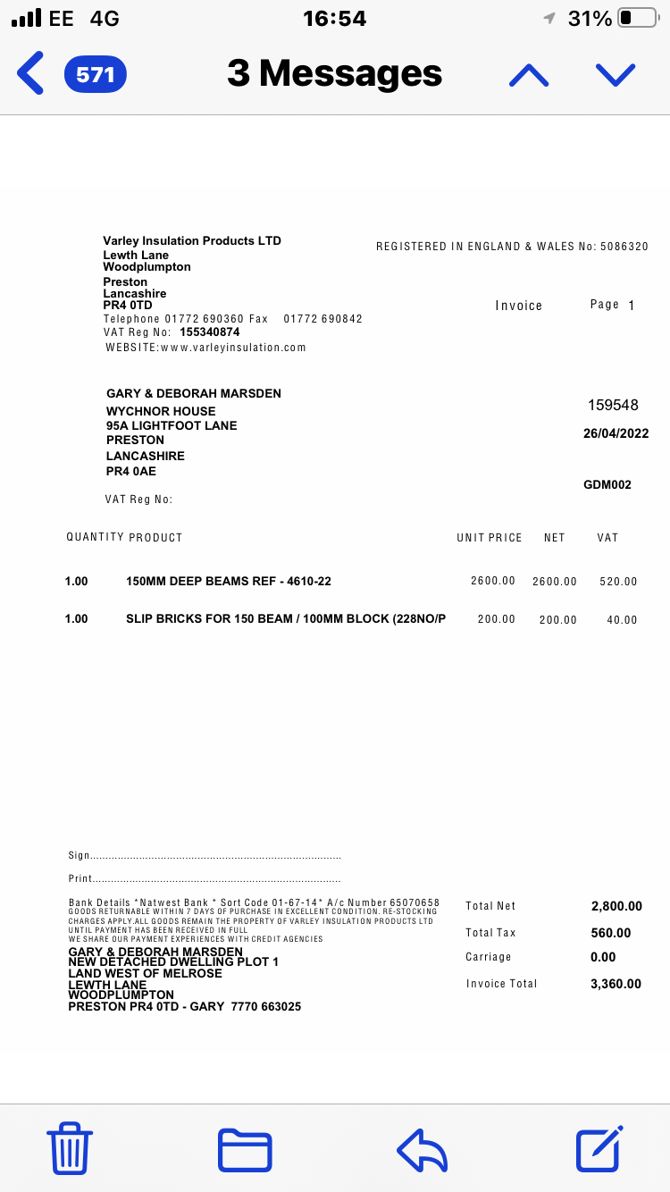

nod Posted April 26, 2022 Share Posted April 26, 2022 I’ve just paid this for BB today plus’s 1500 blocks @£1.05 each Link to comment Share on other sites More sharing options...

Dreadnaught Posted April 27, 2022 Share Posted April 27, 2022 (edited) 22 hours ago, DannyG said: does Cellcore get tied into the slab somehow? I'm wondering what happens if the ground sinks rather than heaves and pulls it away from the slab. I have a cellcore-alternative in my build. With screw piles, as I have, then it doesn't get attached, no. And it does need to be. And it doesn't matter if it sinks anyway so long as it stays in place until the concrete sets. The cell core is there to create a void while the concrete sets. Afterwards, it does not really do anything other than "be a void". The concrete & piles holds the building up. If the cell core sank, it wouldn't matter. You'd have a bigger void. However is it is unlikely to sink. In reality, when ground is excavated to make space for the cellcore the soil will slightly heave anyway, quite naturally, as the pressure of the overlying soil has been removed. This is not the major tree-based heave you are guarding against, just a very slight reactive heave. Edited April 27, 2022 by Dreadnaught 2 Link to comment Share on other sites More sharing options...

Dreadnaught Posted April 27, 2022 Share Posted April 27, 2022 Dwelling footprint is 125 m² approx. A bungalow. Prices from 2020 through to mid-2021. Foundation design: £1,762, no VAT. Screwpile design was £780 ex. VAT. 26x screw piles were £7,886 ex. VAT. inc. delivery. Screwpile installation was £3,840, no VAT. Raft installation was £16,240, no VAT, including the concrete & steel, etc., but excluding the insulation and heave protection panels. Insulation (PIR): £3,421 ex. VAT. Heave protection panels: £2,400 ex. VAT. Hope that helps. 3 Link to comment Share on other sites More sharing options...
