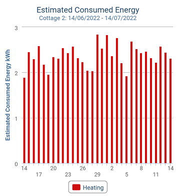

BEJB Posted July 18, 2022 Share Posted July 18, 2022 I've come to this discussion very late. The hot weather has meant that my ASHPs have not been delivering heat for a month or so, so I've ended up looking at Melcloud reports that only show 'standby' figures (accepting these are just 'indicative'). And I've been quite shocked. Our house used to be two small cottages, so it has two systems. Cottage 1 was installed in 2015 and the outside unit is a PUHZ-HW140VHA2-BS. This is a larger system, and has 2 zones (rads and UFH for the kitchen) and DHW with a pre-packaged cylinder (for both cottages). There are solar panels and a solar diverter (which has allowed me to turn off the DHW recently, so I can see the standby for this system. Cottage 2 has a much smaller system that was installed in 2020 with a PUHZ-W85VAA outside unit. This just heats a few rads - nothing complicated. In recent days, when I have been able to have both systems 'on standby' the Melcloud reports show the larger Cottage 1 system (PUHZ-HW140VHA2-BS) has a daily energy consumption of 0.45kWh (equiv average power 19W). The smaller Cottage 2 system (PUHZ-W85VAA) has a daily energy draw of 2.5kWh (equiv average power - 104W). I have been in email contact with Mitsubishi and they have directed me to the Melcloud developer, to see if the reports are wrong. I think it may be possible that the PUHZ-HW140VHA2-BS report is wrong because Melcloud doesn't recognise that model number, whereas it does recognise the newer smaller system. I'll try and use my old 'smart meter' and get a clamp on some power feeds to measure more accurately. Link to comment Share on other sites More sharing options...
JamesPa Posted July 18, 2022 Share Posted July 18, 2022 There is some evidence that the PUHZ (R410 - older) models perform differently to the PUZ (R32 - newer) models. Attached a document posted by another contributor with PUHZ data, purportedly from Mitsubishi (although Mitsubishi have subsequently denied it) and an extract from the Mitsubishi R32 ATW datasheet (for the 11.2kW model and others) which (for the 11.2kW model at least) is pretty consistent with measurements reported on this forum. Basically I think the overall conclusion is that its model and generation (in reality - presumably compressor and FTC model) dependent. Standby Power Consumption.pdf wm112xx_001_001_uk .pdf Link to comment Share on other sites More sharing options...

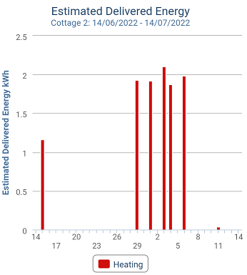

BEJB Posted July 27, 2022 Share Posted July 27, 2022 (edited) Many thanks for those comments. I have been in discussion with the Melcloud team over the reports for my PUHZ-W85VAA system. The consumed estimate report shows a 'standby' estimate (ie no heat being generated) of just over 2.5kWh/day which is shocking, particularly at the cost per unit now. I have been able to turn off all other circuits in the house, so the only thing running is the heat pump (and FTC etc). Then I watched the power meter for the house (a bit like watching paint dry, and the meter kept ticking over overnight when I wasn't looking, so it has some inaccuracies). It took between 45 and 37 hours to consume 1kWh. I calculate that a steady standby usage during that time would be between 0.65kWh/day (27W) and 0.53kWh/day (22W)? This is very similar to the figures in the Standby document for a 'similar' ASHP. Interestingly, I also have my own clamp ‘smart meter’ attached and that shows a much higher figure of about 160-450w or a total of 7-11kWh/day – again as the Standby document says it would. So my conclusion s that, as it stands neither clamp meters or the Melcloud reports are accurate ways to measure the standby power usage. I confess that I had missed the fact that the estimate is actually made in the heatpump itself and just collected regularly by Melcloud. I had rather assumed that the Melcloud system itself calculated the estimate. That feels like it will make it more difficult to alter the estimation routine to make it more accurate. I'm hoping they will take this information and come out with an improved estimate. Edited July 27, 2022 by BEJB Link to comment Share on other sites More sharing options...

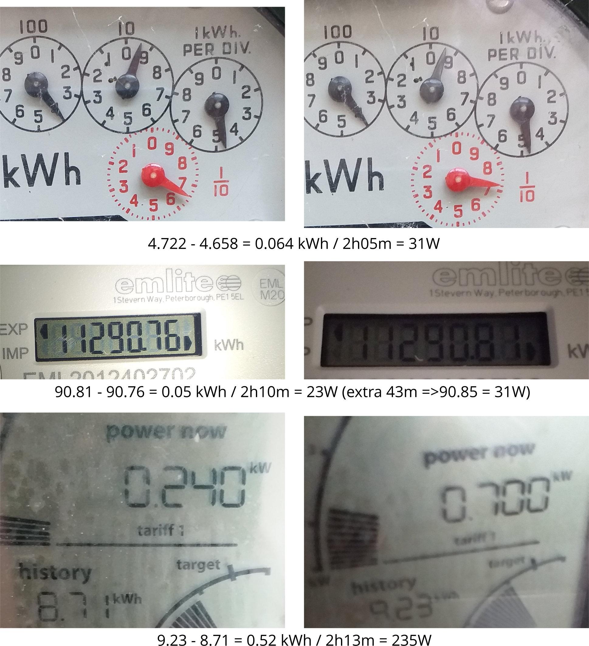

AdrianP Posted August 27, 2022 Share Posted August 27, 2022 I found this website after the antique NPower supplied clamp on power meter showed that we had about 240W usage, with hot water and heating off, even with all of the breakers switched except for the ASHP. We have a PUZ-HWM140VHA i.e. 14kW R32 single phase. According to the meter (originally installed with the unit and looking very similar to the picture on a previous page) it went from xxx87.57 kWh at 1025hrs to xxx88.09 kWh at 2028hrs. That is 0.52kWh over 10 hours or 52W. I also found a document online, called Ecodan ATW data book V5.3 (72 Mb so cannot upload) which gives all of the tech data for current machines and it lists a hermetic scroll compressor for the 11.2 and 14kW units, but hermetic twin rotary for the 5.0 and 8.5 kW units, which may explain the differences between unit types. I may, if I can persuade my wife to go out for a few hours due to lack of internet, repeat this for three hours tomorrow and check the meter reading outside. Link to comment Share on other sites More sharing options...
Radian Posted August 27, 2022 Share Posted August 27, 2022 1 hour ago, AdrianP said: antique NPower supplied clamp on power meter You may be aware that it almost certainly doesn't take into account Power Factor, so may over-report. You have the right approach in using the utility meter to check consumption as these do account for PF and truly represent your billed usage. 1 Link to comment Share on other sites More sharing options...
PhilT Posted August 28, 2022 Share Posted August 28, 2022 11 hours ago, AdrianP said: That is 0.52kWh over 10 hours or 52W. That's about right. My 11.2 version is similar Link to comment Share on other sites More sharing options...
AdrianP Posted August 28, 2022 Share Posted August 28, 2022 I was unsure how accurate the digital counter would be for the ASHP so (at great personal distress due to lack or internet access over 2 hours 😞) I opened all of the fuses except for the ASHP and photographed the silly clamp on joke, the digital meter and the consumer meter outside over around two hours. Bearing in mind that the digital meter is only changing one digit every 26 minutes it was not massively accurate at this low power usage but the digital and consumer unit were similar and the clamp on device was away with the fairies. An extra (unphotographed) measurement made the digital and consumer results match. The recorded usage was 31 vs 31 vs 235W for the consumer unit, the digital meter and the clamp on device. The digital meter is therefore accurate when measured over a reasonable time. This was over a reasonably warm mid day period, and is lower than my results yesterday (mid-day to late evening), so it may be that the unit is trying to minimise power through some form of monitoring. Overall, the power usage is much less than I originally thought from the joke monitor. Link to comment Share on other sites More sharing options...

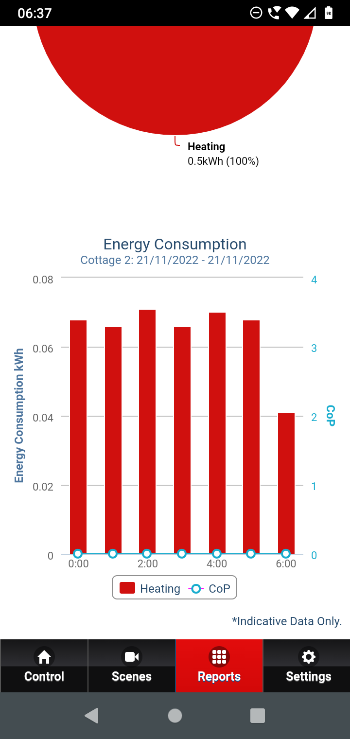

BEJB Posted November 11, 2022 Share Posted November 11, 2022 OK, I have a bit of an update. I contacted Melcloud to ask why our smaller system (PUHZ-W85VAA) had a standby figure of about 2.5kWh/day but our larger system (PUHZ-HW140VHA2-BS) had a standby usage of only 0.4-0.5 kWh/day. Apparently Melcloud just takes the estimated data from the FTC5 controller, so I checked that, which confirmed that that figure was the 2.5kWh/day. So they spoke to one of their engineers, who said the figure should not be that high. They decided that they wanted to install one of their standard monitoring systems on the W85VAA to see what its actual use was. They have done that and I ran a standby test yesterday (as it was very mild). That showed that the actual standby usage for the whole system was only about 0.3kWh for the day - or between 10-15W. I've reported that back to them. I'm hoping that it allows them to check their firmware and improve their standby estimates for people without monitoring systems installed. So all I can suggest for the moment is that if you see very high standby usage, take it very much with a pinch of salt. I've included some pictures. The first is BEFORE – estimated with no monitoring installation – standby on 13th July. The second and third are AFTER – with monitoring installed – standby on 10th November. Cheers Eric Link to comment Share on other sites More sharing options...
joth Posted November 11, 2022 Share Posted November 11, 2022 19 minutes ago, BEJB said: So they spoke to one of their engineers, who said the figure should not be that high. They decided that they wanted to install one of their standard monitoring systems on the W85VAA to see what its actual use was. They have done that and I ran a standby test yesterday (as it was very mild). That showed that the actual standby usage for the whole system was only about 0.3kWh for the day - or between 10-15W. I have the same model, and my own energy metering reported the same number you see. But useful to have it confirmed the melcloud numbers are vapourware. I was in the middle of writing sidebar details of a PH+ article based on it, I'll have to think again. Link to comment Share on other sites More sharing options...
SteamyTea Posted November 11, 2022 Share Posted November 11, 2022 24 minutes ago, BEJB said: So they spoke to one of their engineers, who said the figure should not be that high. They decided that they wanted to install one of their standard monitoring systems on the W85VAA to see what its actual use was 3 minutes ago, joth said: I have the same model, and my own energy metering reported the same number you see Just goes to show how useful proper energy monitoring and basic analysis can be. And it only cost a few quid. 1 Link to comment Share on other sites More sharing options...
