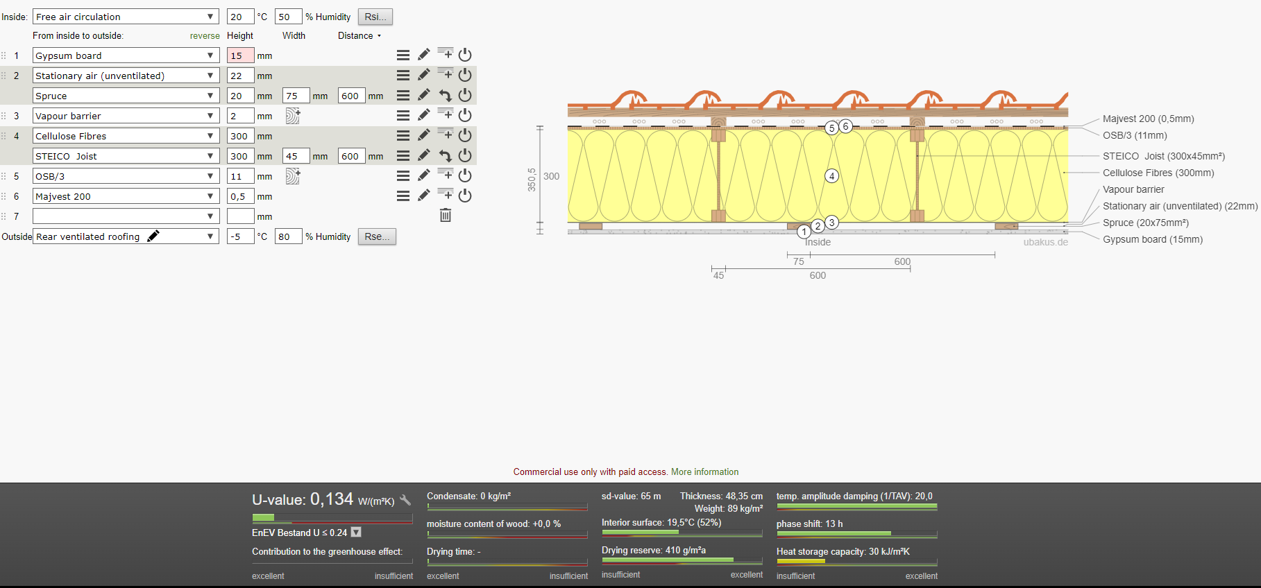

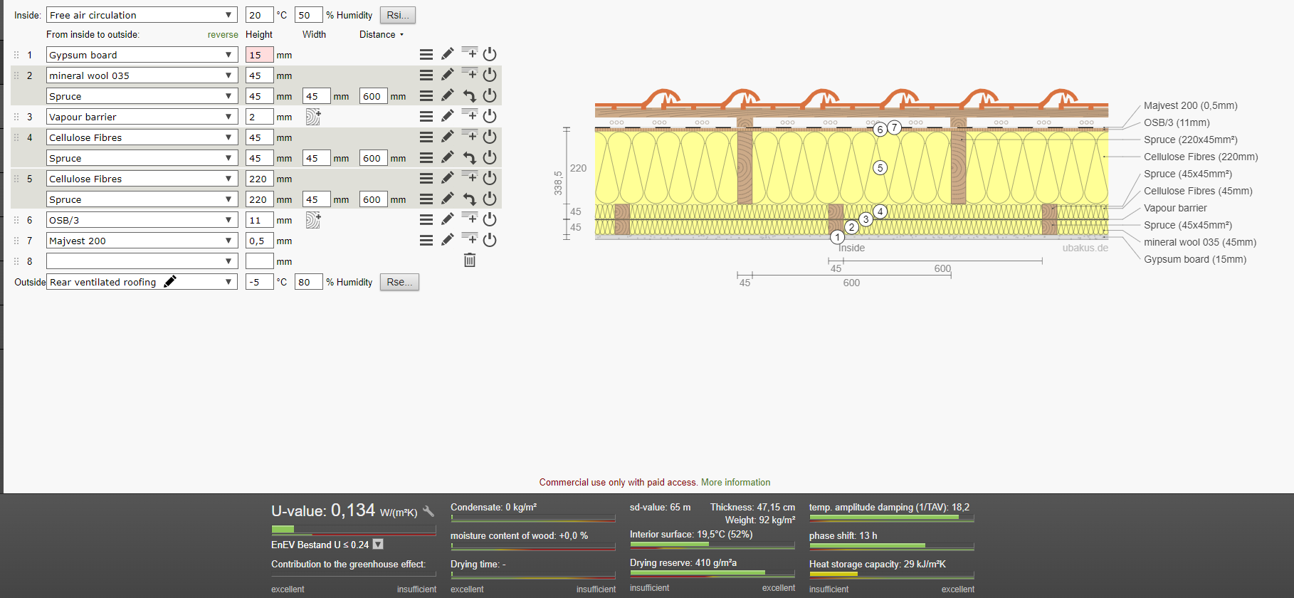

matthyde83 Posted May 11, 2022 Author Share Posted May 11, 2022 On 21/04/2022 at 08:20, joe90 said: Sorry all dealt with by my builder. So I think we’re looking 300mm I joists with rockwool between. My architect has never used these before though so I need to tick a few boxes somehow. build up : OSB, 300mm rockwool between joists, air gap (50mm? - to avoid felt touching rockwool?), breathable felt, tiles I can speak to the SAP people to confirm it’ll meet what I want in terms of insulation but how about condensation calcs to satisfy bc? Link to comment Share on other sites More sharing options...

matthyde83 Posted May 11, 2022 Author Share Posted May 11, 2022 5 hours ago, Iceverge said: What U value do you need? In any case I would not ventilate below the membrane. Use battens and counter battens to and ventilate above the membrane with all joints taped. Windtighness is important, especially with batt insulation. With batts between the I joists you may have issue with the corners compressing in the flanges. I'm not sure how significant this is but green building store changed the ijoist/batt detail on Golcar passivhaus to fill the webs flush with PIR. You'll need an airtight layer somewhere too. Im checking with SAP calc people to find out. Original was 0.16 on some sections and 0.11 where there’s a loft. So 0.14 on the whole thing may work. (I’ve upgraded other areas too). Concern re air ventilation is felt touching the rockwool? Builder is concerned about it becoming wet there like in other applications, you always keep the felt away. Airtight layer would be OSB on the inside. Link to comment Share on other sites More sharing options...
Iceverge Posted May 12, 2022 Share Posted May 12, 2022 I can understand your builders concern but their thinking is based on old housing standards with no internal vapour control layer and impermeable membranes like bitumen felt. The moisture from the house would pass through the ceiling (almost entirely through air gaps not diffusion) and condense on the back of the felt. The way to resolve this was to allow the wind to blow behind the felt but this brings it's own problems. The wind also blows through the insulation making it perform poorly, think woolly jumper on a very windy day. With a plastic anorak and the zips open. Sweaty and cold. A better solution is a proper sealed vapour control layer internally (also airtight layer) and a sealed breathable windtight layer outboard like tyvek supro or protect vp400 or similar. Think a woolly jumper with a Gore-Tex anorak over the top on a windy day. Warm and dry. Here's a screenshot from the Tyvek Supro agrément cert. Note figures 6-8 have the insulation touching the membrane. You need to incude a counter batten to avoid any moisture pooling behind the tile battens however. 10 hours ago, matthyde83 said: Original was 0.16 on some sections and 0.11 where there’s a loft. So 0.14 on the whole thing may work. (I’ve upgraded other areas too). That's not to onerous. If sticking with I joists this would be a nice buildup. I'd be tempted to move the OSB racking to the outside and replace with a airtight membrane/vapour control membrane inside. It'd be easier to lay the OSB outside and would provide more protection against any critters that fancied making their home in your roof! Alternatively as I joists are more expensive than plain timber this would be cheaper for materials (but dearer for labour) Stick build a 9x2 roof with OSB outboard. Counter batten inside initially with 2x2, (I can't show battens at 90deg on the calculator). This would give extra insulation depth and thermally break the rafter cold bridge. Then a vapour membrane creating a 45mm insulated service cavity with battens laid over the top of the initial counterbatten. This would pinch the membrane between the two battens making it more robust. I've used cellulose throughout as it's a fantastic product, guarantees a full fill and really boosts airtightness and decrement delay (phase shift) and hand fitting mineral wool is not pleasant. 1 1 Link to comment Share on other sites More sharing options...

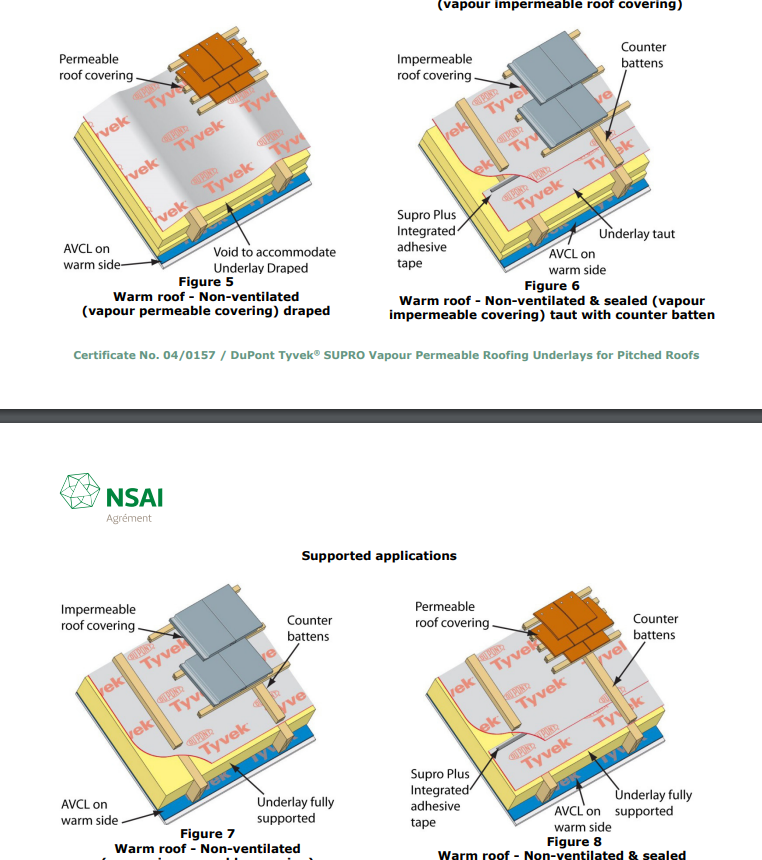

Radian Posted October 5, 2022 Share Posted October 5, 2022 On 12/05/2022 at 09:04, Iceverge said: Here's a screenshot from the Tyvek Supro agrément cert. Note figures 6-8 have the insulation touching the membrane. You need to incude a counter batten to avoid any moisture pooling behind the tile battens however. Why are Tyvek calling those "Warm roofs"? I thought the insulation had to be on top of the rafters to count as a warm roof. Link to comment Share on other sites More sharing options...
Temp Posted October 6, 2022 Share Posted October 6, 2022 (edited) 17 hours ago, Radian said: Why are Tyvek calling those "Warm roofs"? I thought the insulation had to be on top of the rafters to count as a warm roof. Its the old confusion between.. "Warm Roof" or "Warm loft" - insulation between rafters rather than on the floor of the loft. and "Warm Roof Construction" - meaning the structural members are on the warm side of the insulation. Edited October 6, 2022 by Temp Link to comment Share on other sites More sharing options...
Temp Posted October 6, 2022 Share Posted October 6, 2022 Eg Valid options are.. Cold Loft with Cold Roof Construction Warm Loft with Cold Roof Construction Warm Loft with Warm Roof Construction 1 Link to comment Share on other sites More sharing options...
