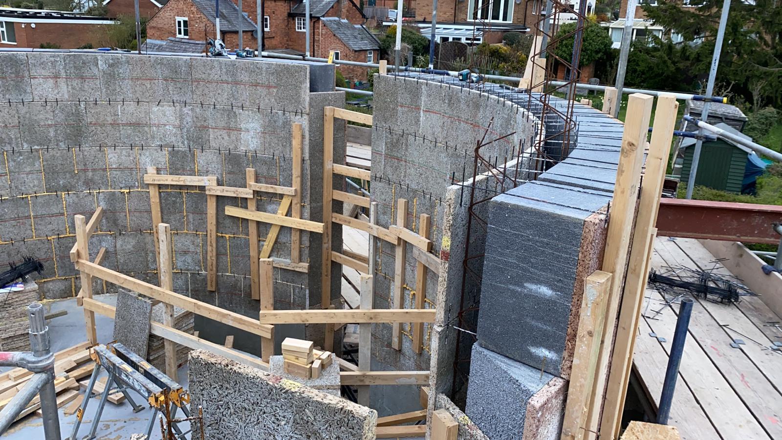

Nic Posted June 12, 2023 Share Posted June 12, 2023 (edited) On 16/05/2022 at 14:38, FM2015 said: Not all woodcrete or EPS or XPS blocks are born equal. As someone has previously stated, the devil is in the detail. @JohnMou Surely the presence of rebar is a structural discussion almost entirely unrelated to the block type or manufacturer? @FM2015 So if you were going to build with a woodcrete block which is top of the list and why ? @JohnMo your reasons are the same I came to the conclusion for consideration to use for my first self build next year Edited June 12, 2023 by Nic Link to comment Share on other sites More sharing options...
FM2015 Posted June 12, 2023 Share Posted June 12, 2023 37 minutes ago, Nic said: @FM2015 So if you were going to build with a woodcrete block which is top of the list and why ? @JohnMo your reasons are the same I came to the conclusion for consideration to use for my first self build next year Personally, I wouldn't build with woodcrete. I e if it was mine. Professionally, we have little to no desire to get involved. Recent history plays a part in that. A great self build product but it's not for us. It's less so that woodcrete has disbenefits and more that EPS/XPS alternatives have more benefits. A very specific example? Build a curve with woodcrete. Link to comment Share on other sites More sharing options...
Nickfromwales Posted June 12, 2023 Share Posted June 12, 2023 18 minutes ago, FM2015 said: It's less so that woodcrete has dis benefits Woodcrete has a boat load of them!! EPS is a no-brainer. 18 minutes ago, FM2015 said: A very specific example? Build a curve with woodcrete You can with Velox, but that only solves the issues of the shape. Then you are still left with the list of cons / caveats. 18 minutes ago, FM2015 said: Professionally, we have little to no desire to get involved Absolutely. The only future woodcrete builds I will get involved with will be the ones where the clients know about, and can find a budget to sort out. If you build during the winter / rain then the internal stuff goes on ice as you'll literally have rivers flowing out of the internal face of the blocks. Only at the windows / door reveals & heads with Velox, but the other offerings (Durisol & Isotex) have a woodcrete bridge joining the exterior teabag to the internal teabag. It takes MONTHS for these to dry out afterwards too. Add to that the micro-format blocks (vs Nudura's 8 FOOT LONG ones) and then getting verticals and straights to be vertical and straight, and your then into a hell of a lot of additional prep work (inside and out as the blocks mirror the internal faults externally, and the huge amount of additional AT work, and that should be enough negatives to take you to EPS. 10 minutes ago, Nickfromwales said: You can with Velox, Link to comment Share on other sites More sharing options...

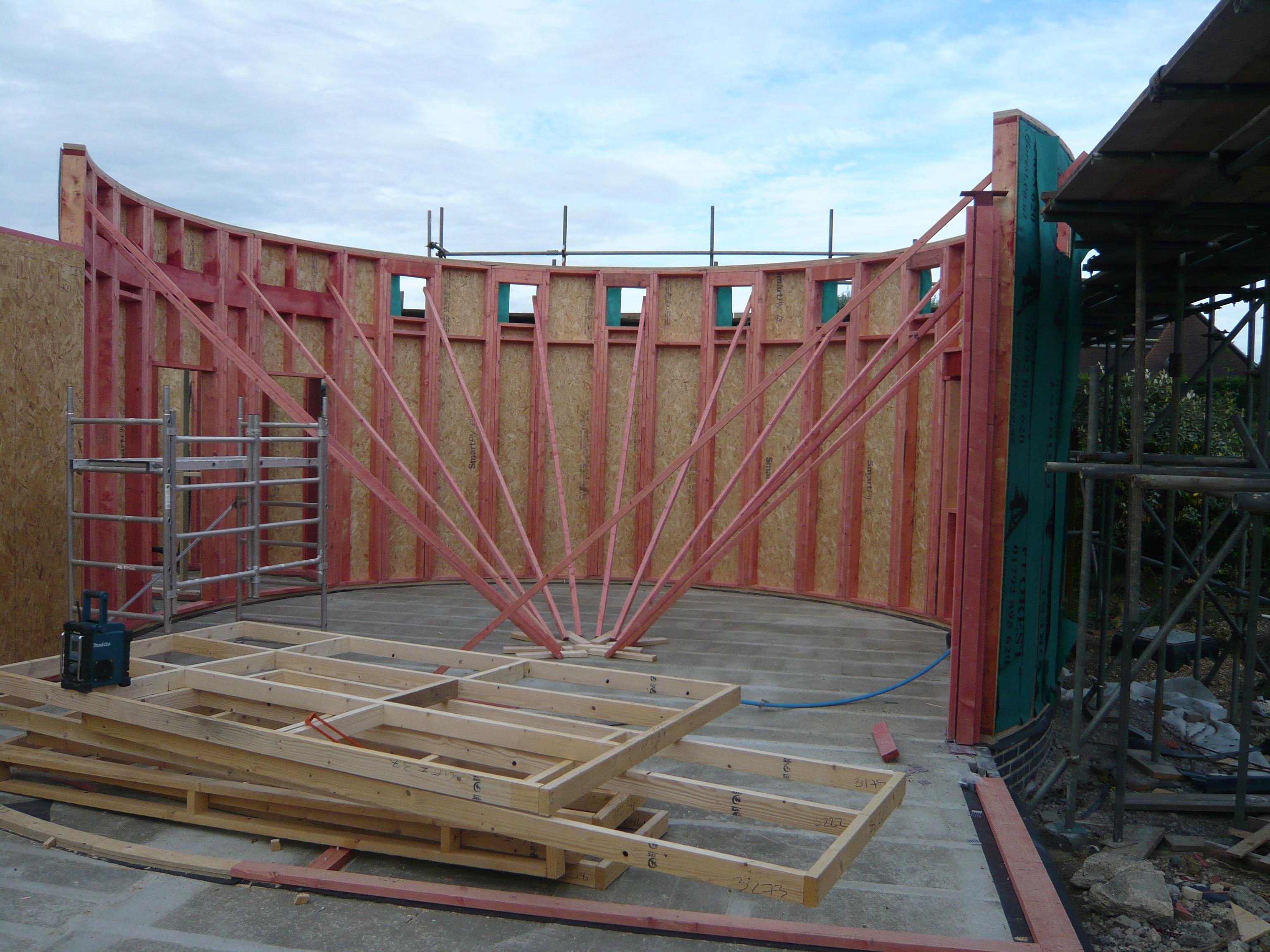

Mr Punter Posted June 12, 2023 Share Posted June 12, 2023 29 minutes ago, Nickfromwales said: Even simpler with timber frame: 1 Link to comment Share on other sites More sharing options...

Nickfromwales Posted June 12, 2023 Share Posted June 12, 2023 1 hour ago, JohnMo said: Certainly not my experience, windy rainy hill side site, zero rain through wall, were actually living in the house prior to external walls being sealed. Walls went up in Dec, followed by roof, windows not in until April. We had an issue once with water ingress, but that was because the outside ground level was higher than the dpc, nothing related to Durisol. Then you were very lucky indeed. What I wrote was entirely 'my' (clients) experience, and no exaggeration whatsoever. On both the Velox project, and the Isotex project, the uplift to get rainproof and airtight was "significant". 5 figures for each project. The Isotex was marketed as being ready to take plaster directly.......wtf?! Whilst installing the UFH I was literally kneeling down and getting soaked by a series of mini-rivers running over the sub-floor, and that was with a meticulous builder installing the Velox! Woodcrete is absolutely definitely porous, so don't expect the same results with that as you'd get with EPS (which is pretty-much rain-proof and AT by default) as you won't. I would be surprised if anyone could demonstrate otherwise, maybe not the rivers but there is no way on this earth that rain doesn't get through / soak into the woodcrete systems. I've done enough to know. 2 Link to comment Share on other sites More sharing options...
Nickfromwales Posted June 12, 2023 Share Posted June 12, 2023 1 hour ago, Mr Punter said: Even simpler with timber frame: There were 3 stories of ICF on that project (4-storey house if you count the basement), hence the choice. Link to comment Share on other sites More sharing options...

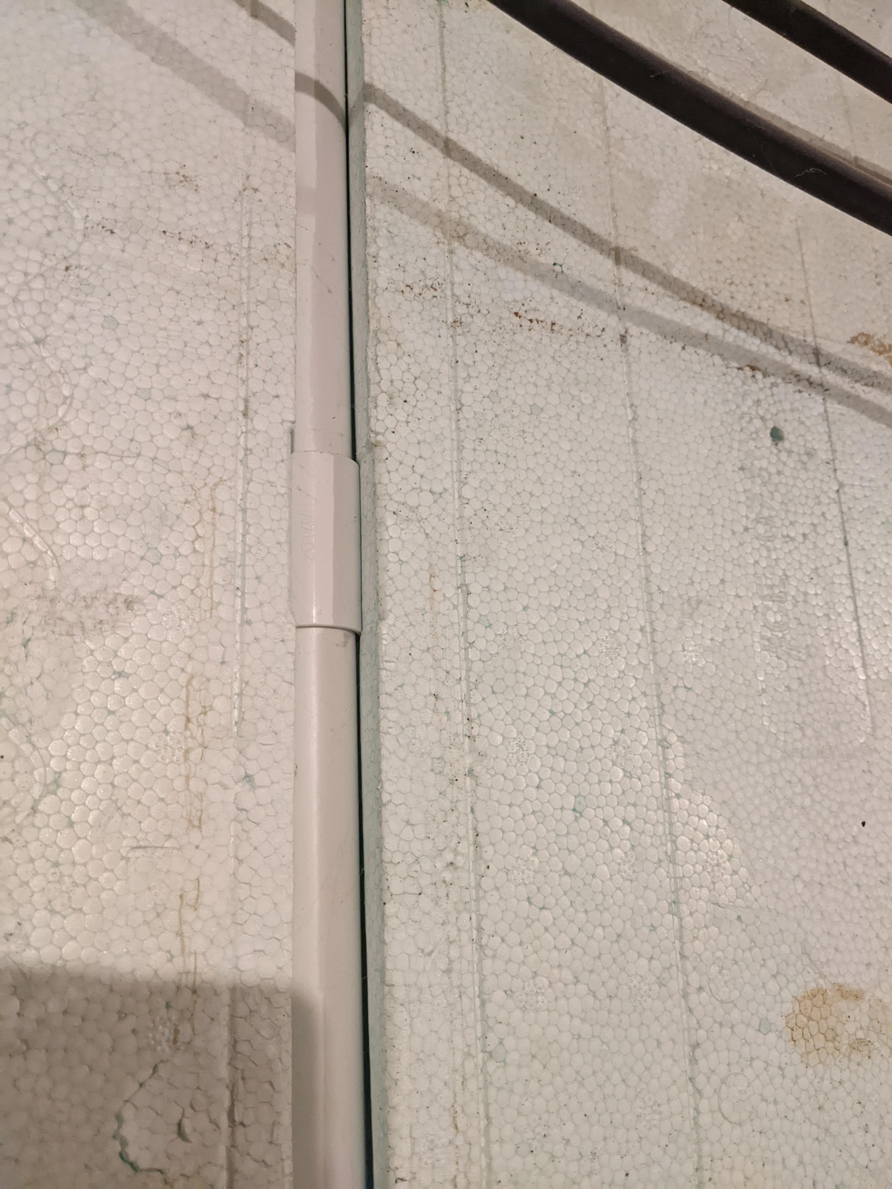

BotusBuild Posted October 23, 2023 Share Posted October 23, 2023 On 22/05/2022 at 18:48, FM2015 said: On 22/05/2022 at 15:33, BotusBuild said: I certainly am using ICF - Nudura, and received delivery of next floor kit before it went up 15%. Not sure exactly when it will be going in place. But I am happy and wiling to provide a film set when I want channels cutting in EPS for my low smoke cabling and water pipes 🙂 Is that low smoke cabling so as to avoid conduits? Come across a few jobs where this was the case only to fall foul of protection measures. Unless you put them deep enough, you'll still need protection. Cost of cable over normal will be in the same ball park as normal plus conduit. You can form a channel that is almost key hole shaped so the conduit 'clips' in. I am at the time to install cabling, and conduit and "normal cable" it will be having consulted a number of electricians. Once I have sourced the materials are @FM2015 and @SteamyTea still good for tea, cakes and filming 🙂 Link to comment Share on other sites More sharing options...
