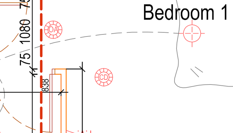

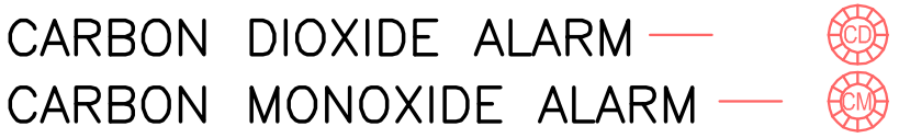

April 13, 20224 yr Specified on our house plans are: x2 heat alarms x6 optical alarms x2 ionisation alarms x1 carbon dioxide alarm Alarms would need to meet the new Scottish regs since we're north of the border. All the wires are in for mains powered. Aico seems the generally accepted brand here. However, am I being daft? It doesn't seem that Aico sells a carbon dioxide alarm or am I looking at the wrong thing? There are several listings found on Google that claim to be a CO2 sensor, but the packaging shows Carbon monoxide sensor in the image on the product listing. Aico also launched an environmental sensor, which does include CO2 sensor, but it seems a little OTT and doesn't appear to interlink with the rest of the alarms.
April 13, 20224 yr Carbon monoxide is what you are looking for not dioxide.. aico do a neat unit combined with heat.
April 13, 20224 yr Author @TonyTIt is Carbon Dioxide that has been specced... Edited April 13, 20224 yr by djcdan

April 14, 20224 yr 52 minutes ago, TonyT said: Sorry mate the spec is wrong Are you sure you are correct stating that. You need CO for any combustible appliances, gas boiler wood stove etc. It is also mandatory to have a CO2 if your airtightness is better than 15. This is a stand alone monitor mains powered. https://www.gov.scot/publications/building-standards-2017-domestic/3-environment/314-ventilation/ Section 3.14.2 applies
April 14, 20224 yr 8 hours ago, djcdan said: @TonyTIt is Carbon Dioxide that has been specced... The post 8 hours states CO2, you then said the spec was wrong without further explanation. Scottish Building regs require a CO2 monitor not CO2 alarm. So the word alarm is incorrect. 8 hours ago, TonyT said: Carbon monoxide is what you are looking for not dioxide.. aico do a neat unit combined with heat. Also in Scottish Building regs the use of combined heat and smoke alarms are not allowed, as only a heat alarm is allowed in a kitchen. It even makes a comment about combined units in a kitchen will not comply with the regulations.
April 14, 20224 yr As far as I'm aware because it's not an alarm and does not need to be linked you need to get something like this https://scotlandhomesafe.co.uk/collections/carbon-dioxide/products/domestic-carbon-dioxide-monitor These seem to be what most people have around here and I have the same one, wall mounted so you can see the screen.

April 14, 20224 yr Author 2 hours ago, JohnMo said: Scottish Building regs require a CO2 monitor not CO2 alarm. So the word alarm is incorrect. Ah, ok. Thanks. So perhaps Aico's enviromental sensor would be appropriate? https://www.cef.co.uk/catalogue/products/5052860-temperature-humidity-and-co2-environmental-sensor?gclid=Cj0KCQjwjN-SBhCkARIsACsrBz5kb3egrkVB4o1nqsl6x22rocvOr89GhsoF50ehfLp4Tu8_lOClOq8aAhEUEALw_wcB&gclsrc=aw.ds 2 hours ago, Ralph said: As far as I'm aware because it's not an alarm and does not need to be linked Right now, there is a loop of cable coming down from the ceiling for mains installation. If it isn't to be mains installed/linked, I presume pushing the cable back above the plasterboard and installing the environmental sensor (powered by battery) in it's place would be sufficient here.
April 14, 20224 yr Not sure that complies with the regs, as you would require a gateway and full time display also. So more like this. https://scotlandhomesafe.co.uk/products/carbon-dioxide-and-temperature-monitor
April 14, 20224 yr 20 minutes ago, djcdan said: Right now, there is a loop of cable coming down from the ceiling for mains installation. If it isn't to be mains installed/linked, I presume pushing the cable back above the plasterboard and installing the environmental sensor (powered by battery) in it's place would be sufficient here. It still needs to be mains operated, have a visual display and be capable of logging C02 data for the last 24 hour period. That would rule out the Aico Temperature, Humidity and CO2 Environmental Sensor. unless it can connect to a visual display. It looks like that would mean getting the Ei1000G SmartLINK Gateway and connecting it to a laptop. I'm not sure that would meet the easy to use and understand part of the requirements, it's also more expensive than just getting the standalone monitor and having it wired in somewhere on a wall.
April 14, 20224 yr 12 hours ago, djcdan said: @TonyTIt is Carbon Dioxide that has been specced... The CO2 alarm doesn't need to be part of the fire alarm, it is just a monitor/warning alarm if the CO2 ppm gets too high, you get staged alerts then a danger level. Maybe if houses were built with proper ventilation rather than stupid sealed boxes. I have just finished a residential development of 36 flats just outside of Glasgow, we omitted the CO2's a design stage because we could prove the MVHR system would provide suitability fresh air. Edited April 14, 20224 yr by Carrerahill
April 14, 20224 yr 5 hours ago, TonyT said: Sorry mate the spec is wrong No, to be fair it is right. Common to have a CO2 in master bedroom in Scotland, it does not need to be on the interlinked fire alarm system though as it's not a fire alarm. CO for combustion appliances, usually done with a combined CO/optical head. Edited April 14, 20224 yr by Carrerahill
