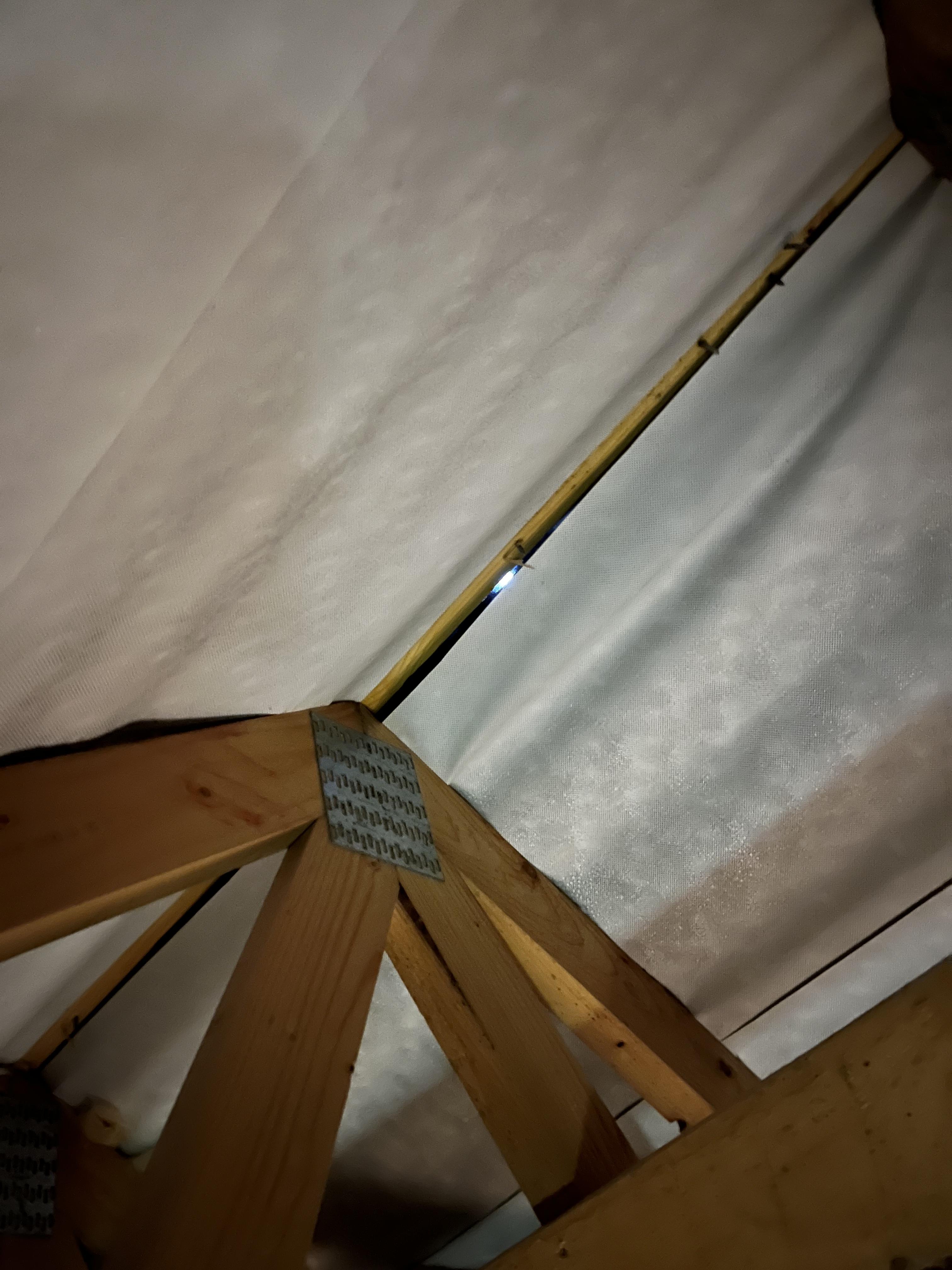

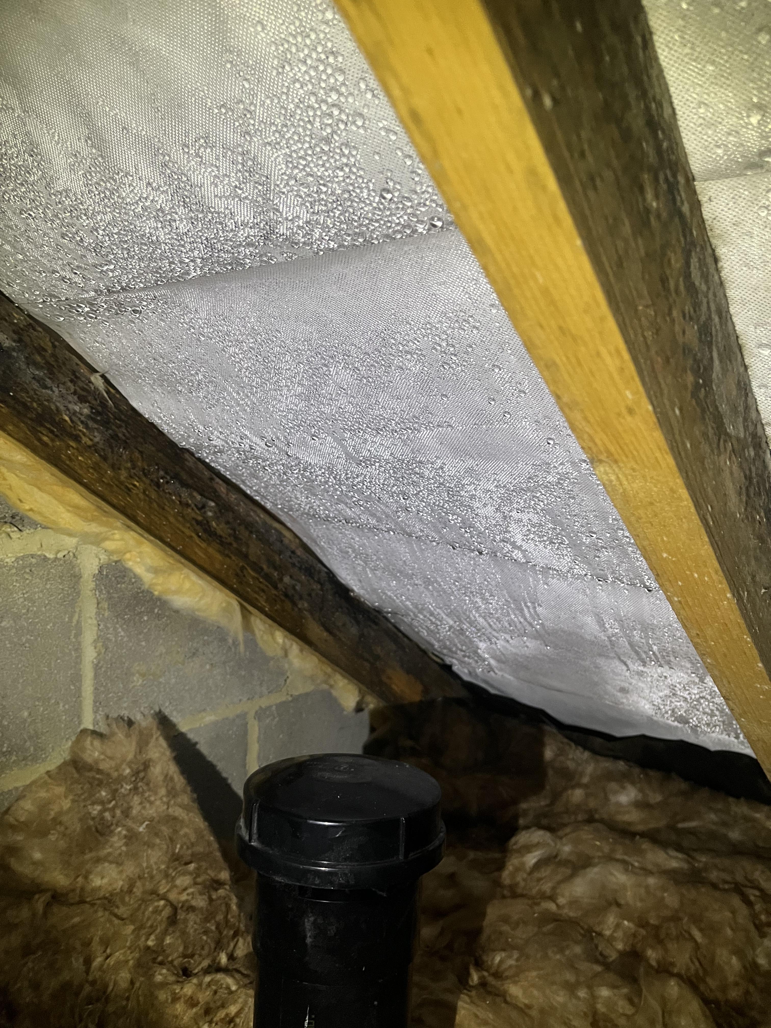

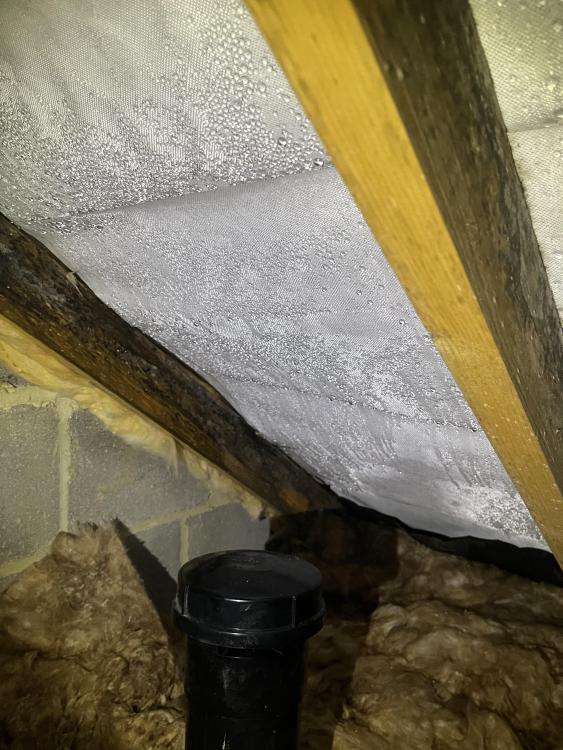

Littlebig Posted December 11, 2022 Author Posted December 11, 2022 So I decided to have a look into my loft today just to see what is going on up there. I have managed to balance the temp. in the house by setting the heating to come on automatically twice a day for a total of about 120-150mins otherwise the house gets way to warm. What I noticed was a lot of condensation on the roof (across the full width above the bathroom and 2nd bedroom) which in my opinion is the answer to my issue. Looks like all the heat is escaping through the roof and I can’t work out why. If anyone has any suggestions as to what could be the problem please let me know. I am in the process of getting someone to come and do a full survey as I’m fed up with the builder and after the inspection will decide which to go based on the findings.
Littlebig Posted December 11, 2022 Author Posted December 11, 2022 Also I guess seeing daylight through the roof is not a good sign either?
Roundtuit Posted December 11, 2022 Posted December 11, 2022 Heat will escape; insulation just slows down the rate. Looks like you need more ventilation in the loft space to get rid of the condensation. Perhaps check the eaves are not blocked with insulation. 1
Radian Posted December 11, 2022 Posted December 11, 2022 49 minutes ago, Roundtuit said: Looks like you need more ventilation in the loft space to get rid of the condensation. Perhaps check the eaves are not blocked with insulation. That's a serious amount of condensation right there - I think mould has formed on the rafters. That needs treating. But this is a cold loft with vapour permable roof membrane. My understanding is that these don't require ventilation at eaves level, with sufficient evacuation taking place on the upper side of the membrane. The gap in the membrane at the apex doesn't look intentional given the sloppy bunching. Again, ridge vents aren't always required for permeable membrane but they seem to be provided by default with dry ridge. I'm spouting all this in the hope that someone will step in and correct me if I'm wrong.
AliG Posted December 12, 2022 Posted December 12, 2022 Daylight through the roof is ok as it might well be ventilation. Your insulation is on the ceiling and it is then cold above it. “A cold roof”. In a cold roof design there should be adequate ventilation to stop condensation forming in the roof space. It can be in many places - eaves, ridge and tile edge for example. There should maybe be a vapour barrier at ceiling level to stop moist air getting up into the roof from the house, but if it is adequately ventilated I don’t think this is necessary. So you definitely have something wrong there! Looking at the picture of the house, my guess is that you have eaves ventilation(actually the spec says you do). Do you have grilles you can see in the underside of the eaves? If so the insulation should not go all the way into the edge of the roof as it would block the ventilation. I would also be checking that you don’t have an extractor fan from the bathroom that is not ducted all the way to outside. Quite often builders forget to connect them up.
MikeGrahamT21 Posted December 12, 2022 Posted December 12, 2022 Wow i've not seen that much condensation in a loft for a very long time. I would imaging a lot of it will have dripped down onto your insulation, making matters even worse. If you have a window vac, might be a good idea to suck as much of that water up as possible. Check extractor fan connections, this is a common issue as has been said. There are also other options which you could look into, increase ventilation into the loft, some breathable membrane is better than others at releasing moisture, a couple of vent tiles wouldn't go a miss in yours. Bathroom will clearly be a major source of moisture, its highly unlikely you'll have a vapour membrane above the bathroom ceiling, you could remove the insulation and paint the back of the plasterboards with a liquid vapour membrane, something like black jack DPC may well work, just slowing down the rate moisture can escape through the plasterboard into the loft. Make sure there are no gaps from bathroom to loft, where light fittings are, if your extractor goes into loft etc. Any there, seal them up with good quality silicone. Rafters without doubt need treating with anti fungal.
Littlebig Posted December 12, 2022 Author Posted December 12, 2022 Thanks everyone for the replies. It is eaves ventilation according to the specs. I only had a look because of the ongoing heat loss issue and when I noticed the amount of condensation I knew something is not right. I am currently expecting a report from the builder investigation as to why reported issues had not been resolved but marked as complete. Once I have a look at the report and what they have outlined as their next step, then I will make a decision on how to proceed with the urgent repairs.

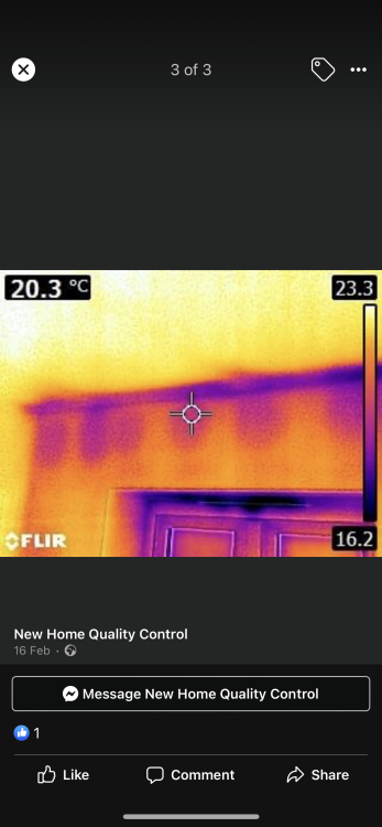

Andehh Posted December 12, 2022 Posted December 12, 2022 (edited) On 11/04/2022 at 22:48, Russell griffiths said: There are companies that specifically look at faults in new builds. Look one up and get them to investigate. it’s a shame it’s getting warmer. Get a thermal imaging camera thing, crank the heating up and stand outside to see where it is escaping. or set up a home made air test, set a fan to suck air out of the room and stand in the room hunting for the cold draught. 100% rent a thermal camera, and crank the heating up for an hour to so and then go exploring! Should only need it for an hour or two. Edited December 12, 2022 by Andehh

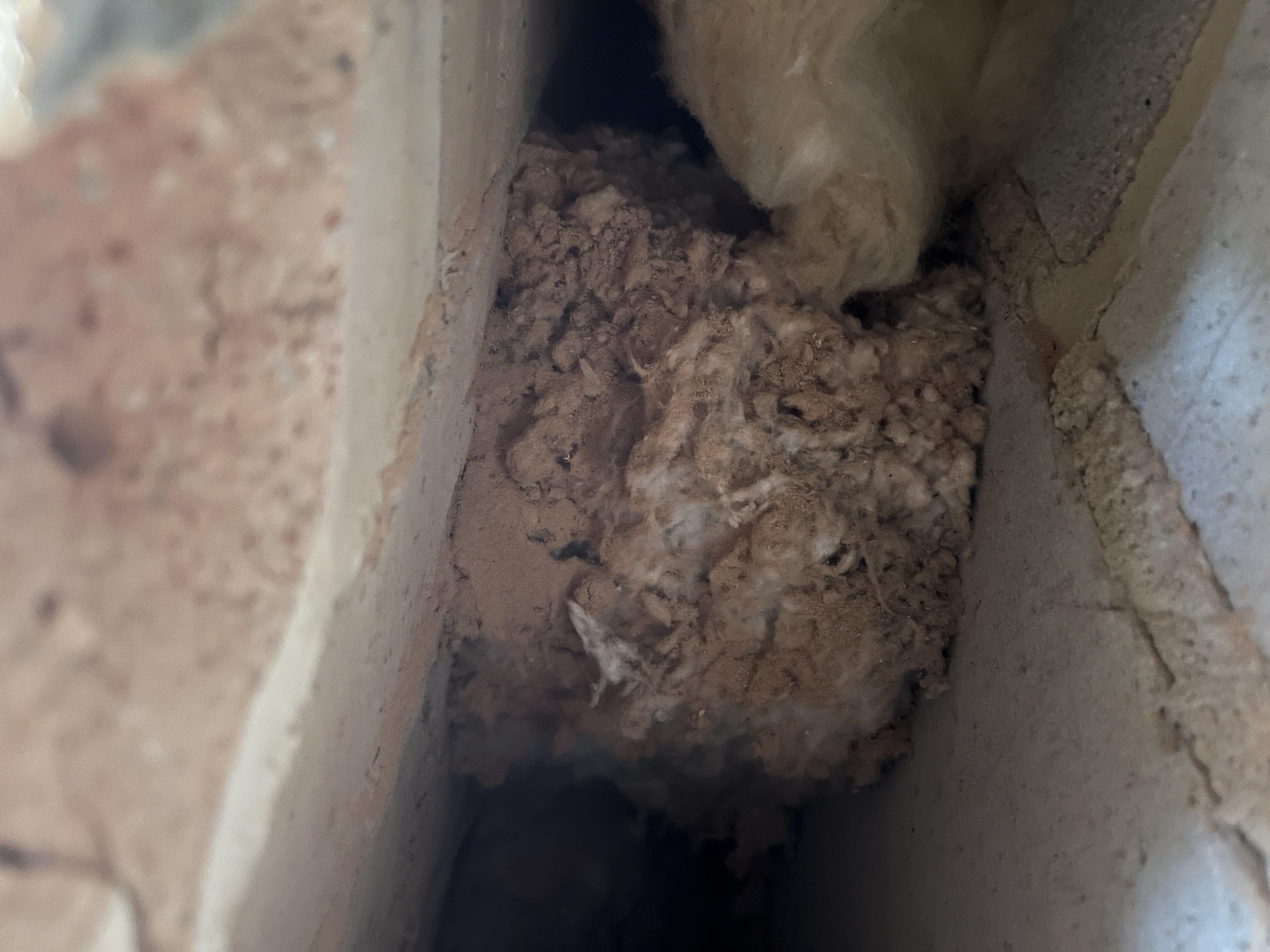

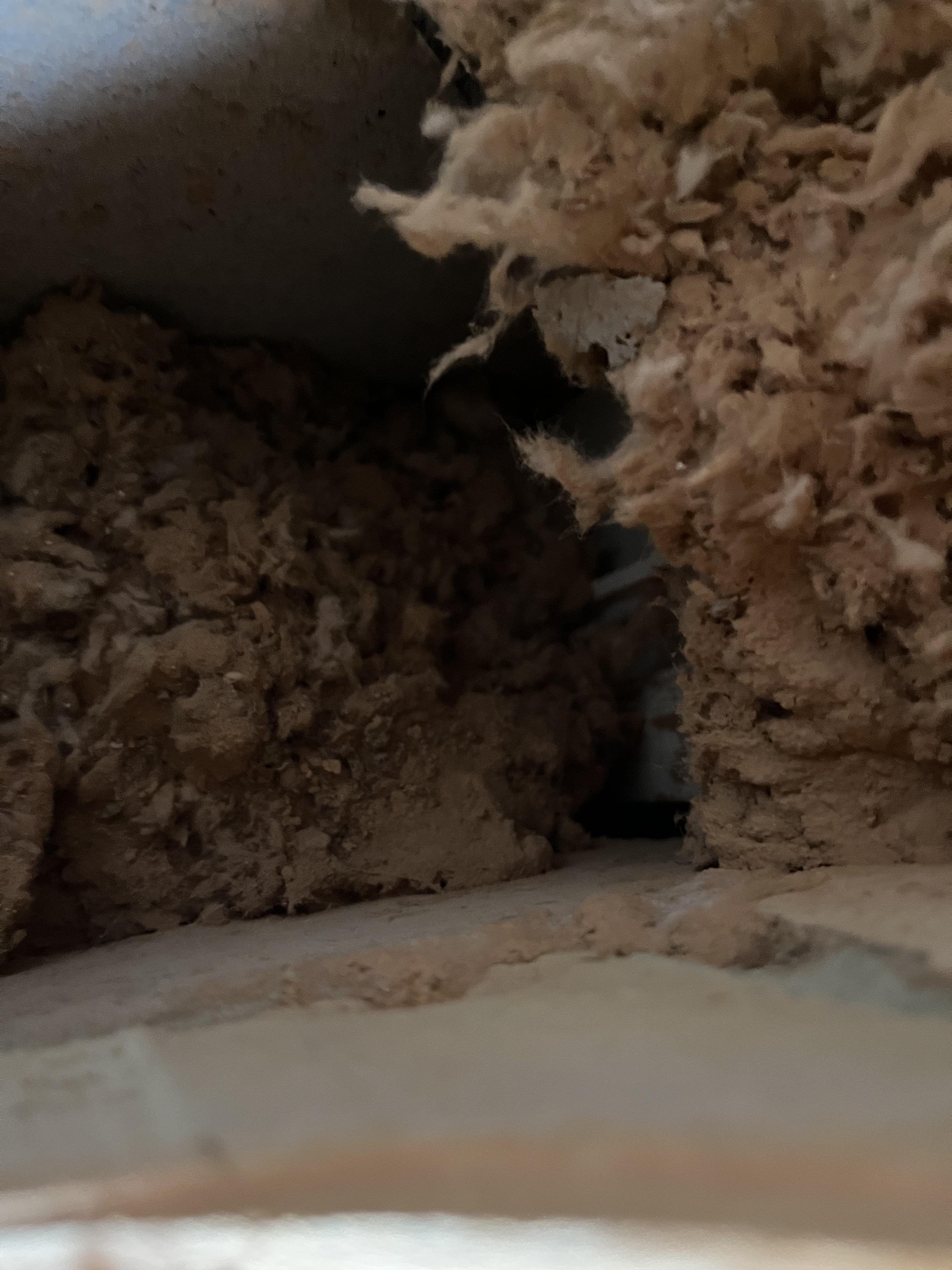

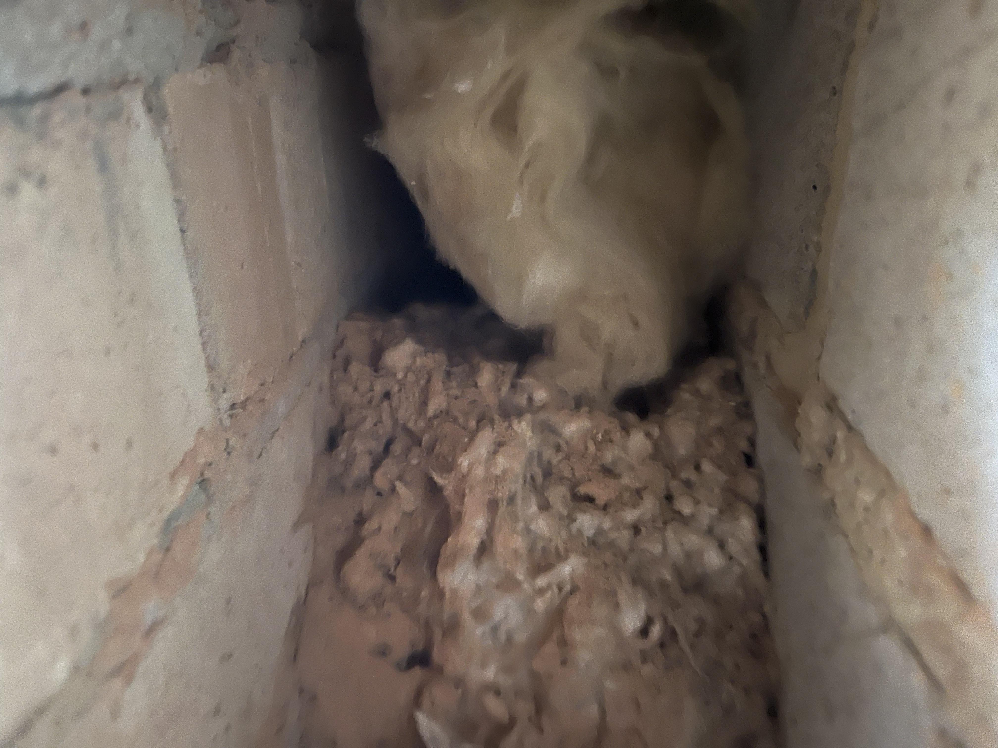

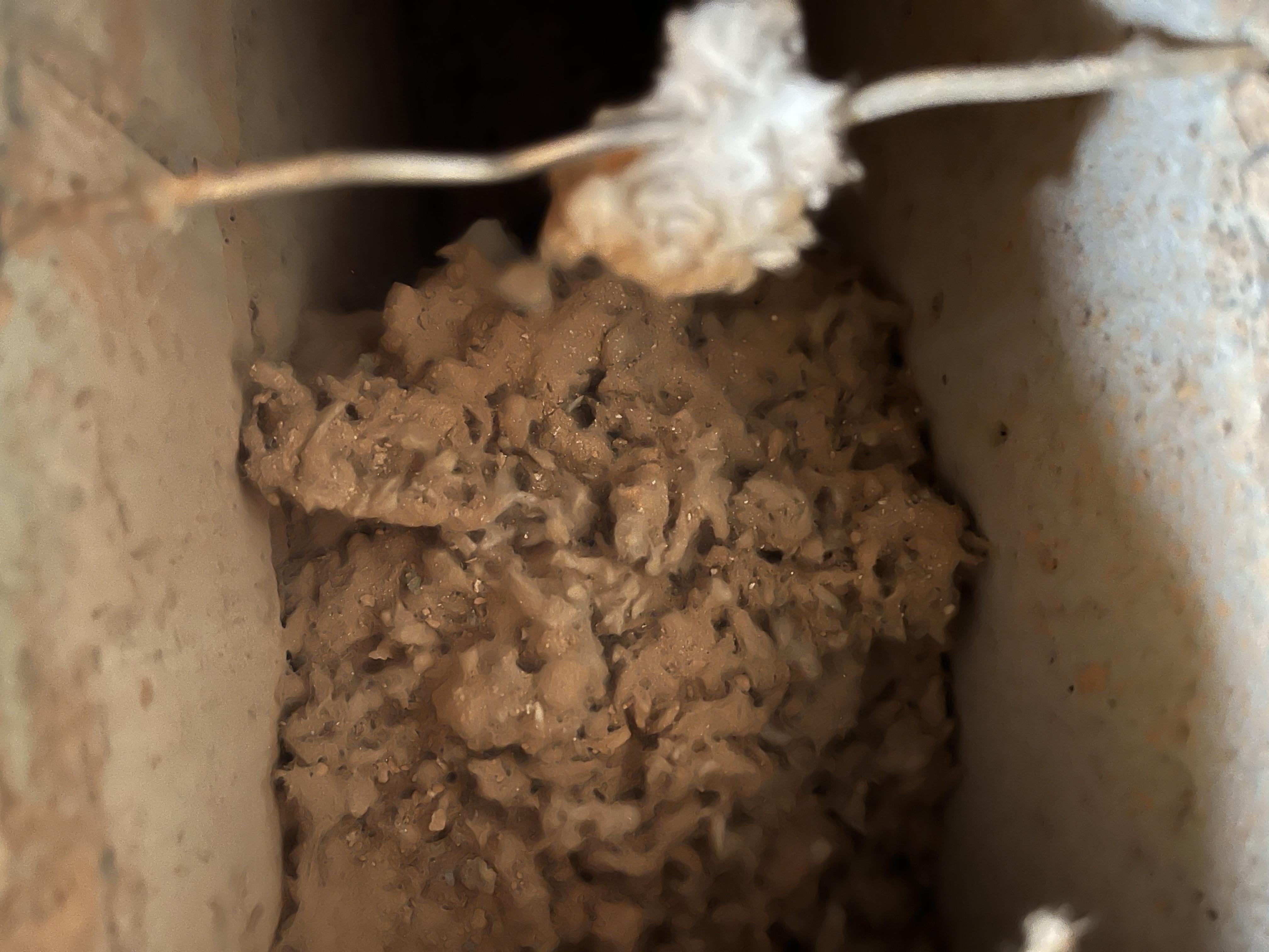

Littlebig Posted February 27, 2023 Author Posted February 27, 2023 Hi everyone, just a little update on the issues mentioned above. We finally managed to get the builder to do a heat survey and get a bit more details on what is going on with the insulation. Survey was conducted by the company blowing the cavity insulation in and the attending contractor gave a detailed explanation of his findings. The highlight of all was that he concluded there is a problem with draughts more than anything, so the report was sent to the builder and now awaiting repair. In the meantime I changed the extraction fan in the bathroom and put a new external vent with a non-return shutter flaps to prevent cold air coming through. When I did that I was able to have a look in the cavity and took few pictures for someone knowledgable to say whether this is OK or not as I am not sure it is. 1
Littlebig Posted February 27, 2023 Author Posted February 27, 2023 Just now, Littlebig said: Hi everyone, just a little update on the issues mentioned above. We finally managed to get the builder to do a heat survey and get a bit more details on what is going on with the insulation. Survey was conducted by the company blowing the cavity insulation in and the attending contractor gave a detailed explanation of his findings. The highlight of all was that he concluded there is a problem with draughts more than anything, so the report was sent to the builder and now awaiting repair. In the meantime I changed the extraction fan in the bathroom and put a new external vent with a non-return shutter flaps to prevent cold air coming through. When I did that I was able to have a look in the cavity and took few pictures for someone knowledgable to say whether this is OK or not as I am not sure it is.
PeterW Posted February 27, 2023 Posted February 27, 2023 Definitely not ok !!!! Should be full to the top..!! installation will be warranted by the CWA (Cavity Wall Association) so they should take this up
Radian Posted February 27, 2023 Posted February 27, 2023 48 minutes ago, Littlebig said: Survey was conducted by the company blowing the cavity insulation in and the attending contractor gave a detailed explanation of his findings. The highlight of all was that he concluded there is a problem with draughts more than anything, so the report was sent to the builder and now awaiting repair. So the cavity insulation guy is saying draughts coming up through the empty cavities isn't their problem? 😵
