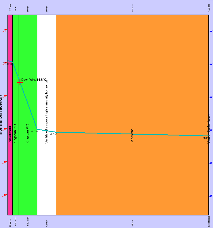

nostos156 Posted February 19, 2023 Share Posted February 19, 2023 Interesting topic to read, especially re: breathability of solid walls + risks of using solid PIR. In my own case, I'm insulating an attic space room exterior wall. I've battened out roughly 30-50 mm from the wall (uneven, as they just threw whatever stones they could find together, lol). I then put up 2x2 timbers and will put a 50mm PIR in between, likely them putting 15mm PIR over the top of it all to minimise any cold bridging (20-25mm is starting to eat away the room space too much for my liking, and 15mm seems like it'll do more than enough to prevent cold spots). As this is in an attic space where the roof is still original slates without a felt layer, it can get quite windy in there (and thus, in the cavity I created). I'm presuming this is more than enough 'breathability' to not worry about condensation risk behind the insulation, as was talked about earlier? Link to comment Share on other sites More sharing options...
jayc89 Posted February 19, 2023 Author Share Posted February 19, 2023 5 hours ago, nostos156 said: Interesting topic to read, especially re: breathability of solid walls + risks of using solid PIR. In my own case, I'm insulating an attic space room exterior wall. I've battened out roughly 30-50 mm from the wall (uneven, as they just threw whatever stones they could find together, lol). I then put up 2x2 timbers and will put a 50mm PIR in between, likely them putting 15mm PIR over the top of it all to minimise any cold bridging (20-25mm is starting to eat away the room space too much for my liking, and 15mm seems like it'll do more than enough to prevent cold spots). As this is in an attic space where the roof is still original slates without a felt layer, it can get quite windy in there (and thus, in the cavity I created). I'm presuming this is more than enough 'breathability' to not worry about condensation risk behind the insulation, as was talked about earlier? The felt, or lack of, shouldn't provide the ventilation (originally I suspect the underside of the slates would have been lime torched), the ventilation should be coming from the eaves, so providing there's a clear path to/from them, you should be fine. Conversely, somewhat playing devils advocate, that ventilation could also be considered thermal bypass, you're essentially building a PIR tent. Link to comment Share on other sites More sharing options...
nostos156 Posted February 19, 2023 Share Posted February 19, 2023 2 hours ago, jayc89 said: The felt, or lack of, shouldn't provide the ventilation (originally I suspect the underside of the slates would have been lime torched), the ventilation should be coming from the eaves, so providing there's a clear path to/from them, you should be fine. Conversely, somewhat playing devils advocate, that ventilation could also be considered thermal bypass, you're essentially building a PIR tent. I've been doing some quick reading on thermal bypassing and that looks like another minefield. Ultimately, there's only so much you can do within a given budget for an old house. The outside walls are solid breathable stone meant to wick away moisture from any ingress and so on, and it's probably far riskier to stop that on one side by not bothering with a cavity. It'll render the PIR not as effective as you say, but trying to retrofit modern standards meant for completely different housing types in much older construction is always going to less efficient. As long as it doesn't lead to condensation and rot risks by having the ventilation then I'll take that as a win. Link to comment Share on other sites More sharing options...

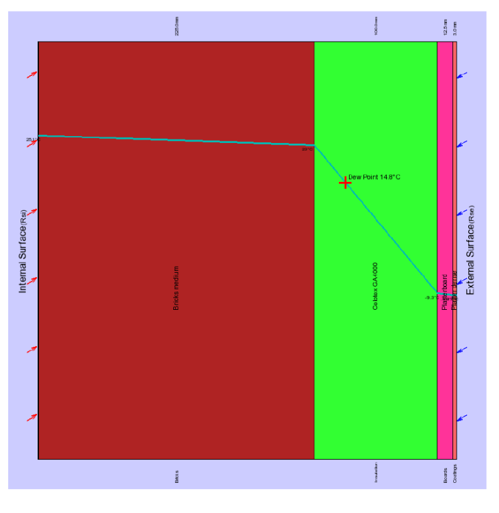

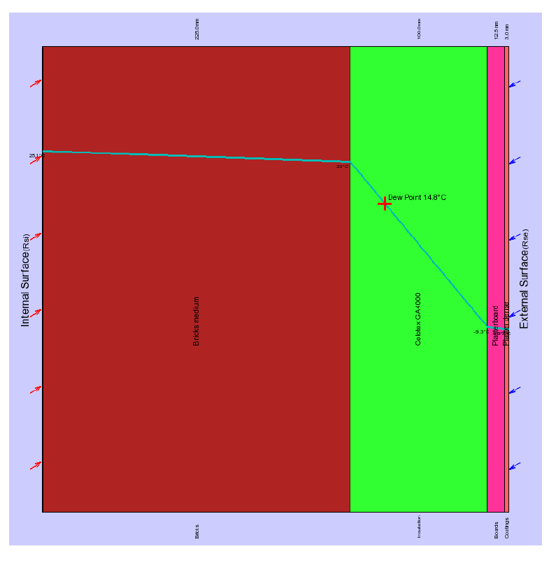

Dave Jones Posted February 19, 2023 Share Posted February 19, 2023 running the values for my solid wall buildup (225 brick,100mm celotex, plasterboard, plaster) through the calculator using -10c external 26c internal still puts the dew point well inside the insulation so I don't think any air gaps between the bricks and insulation is needed. Link to comment Share on other sites More sharing options...
Iceverge Posted February 19, 2023 Share Posted February 19, 2023 That looks like external insulation? Link to comment Share on other sites More sharing options...
Dave Jones Posted February 19, 2023 Share Posted February 19, 2023 well spotted, its internal but the calc had it wrong way. 1 Link to comment Share on other sites More sharing options...

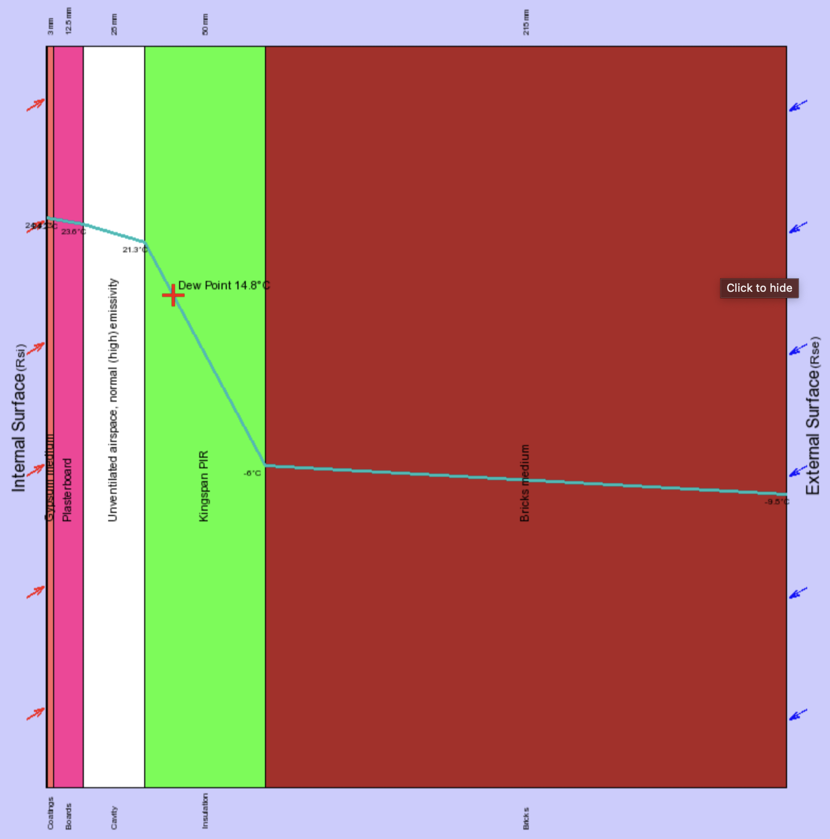

jayc89 Posted February 19, 2023 Author Share Posted February 19, 2023 4 hours ago, Dave Jones said: well spotted, its internal but the calc had it wrong way. Very similar to mine, but I have a 25mm service void too Link to comment Share on other sites More sharing options...

nostos156 Posted February 19, 2023 Share Posted February 19, 2023 Gave the calculator a go, I presume the dew point being inside the insulation layer is what you want? Interesting that I can't add studwork within the thicker PIR layer either. Link to comment Share on other sites More sharing options...

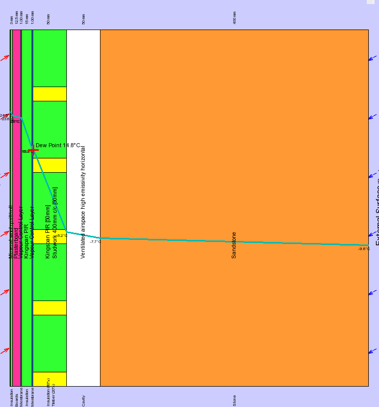

nostos156 Posted February 19, 2023 Share Posted February 19, 2023 Okay I figured out how to add studwork properly, so it has changed the values a bit. Link to comment Share on other sites More sharing options...

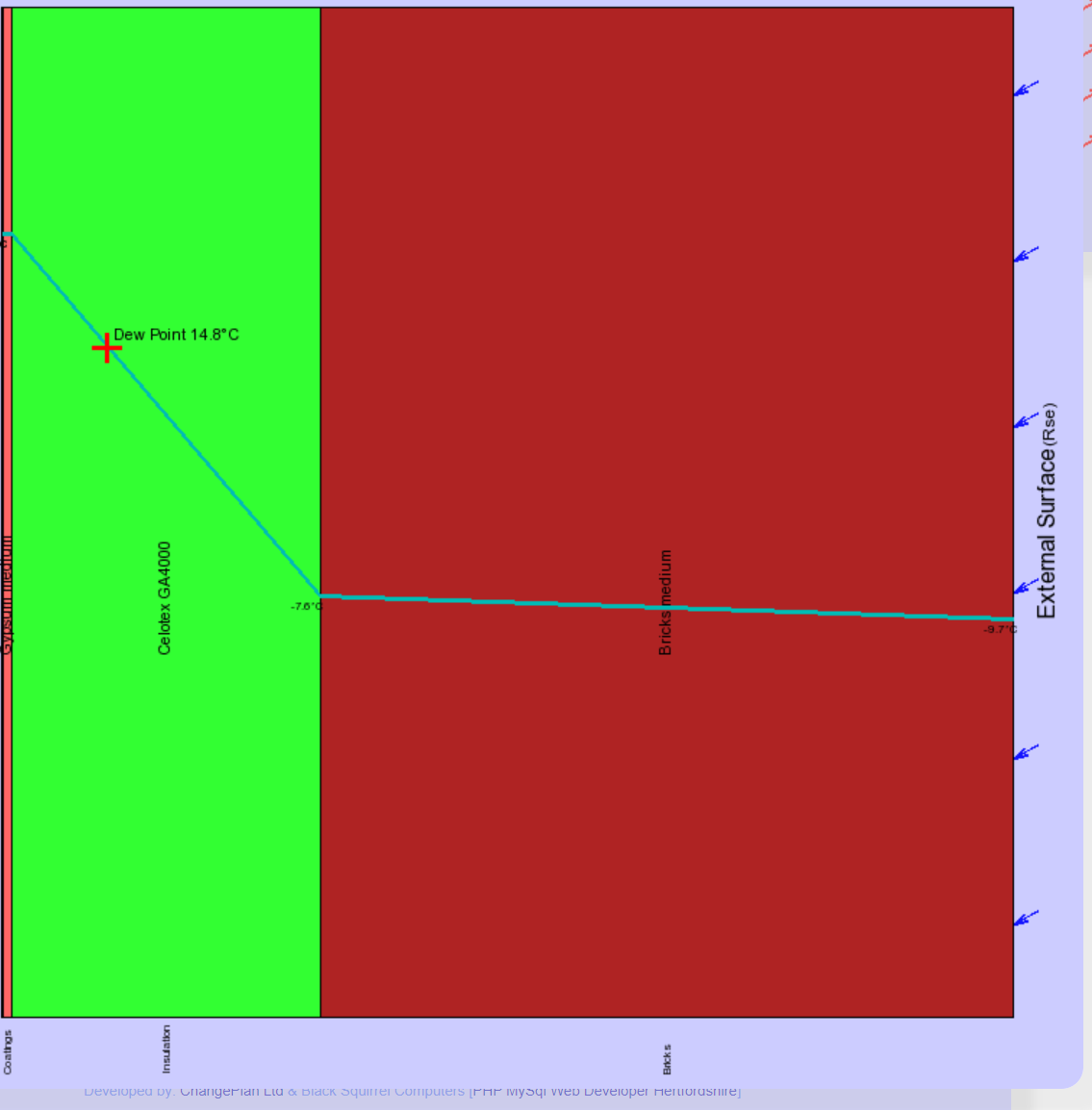

jayc89 Posted February 21, 2023 Author Share Posted February 21, 2023 8 hours ago, nostos156 said: Yeah, honestly I think this site is better as it will tell you exactly if you are getting condensation and how much: https://www.ubakus.de/en/r-value-calculator/? I've modelled my detail on both sites and both look pretty similar to me. I think the dew point on change plan is accurate. Link to comment Share on other sites More sharing options...
